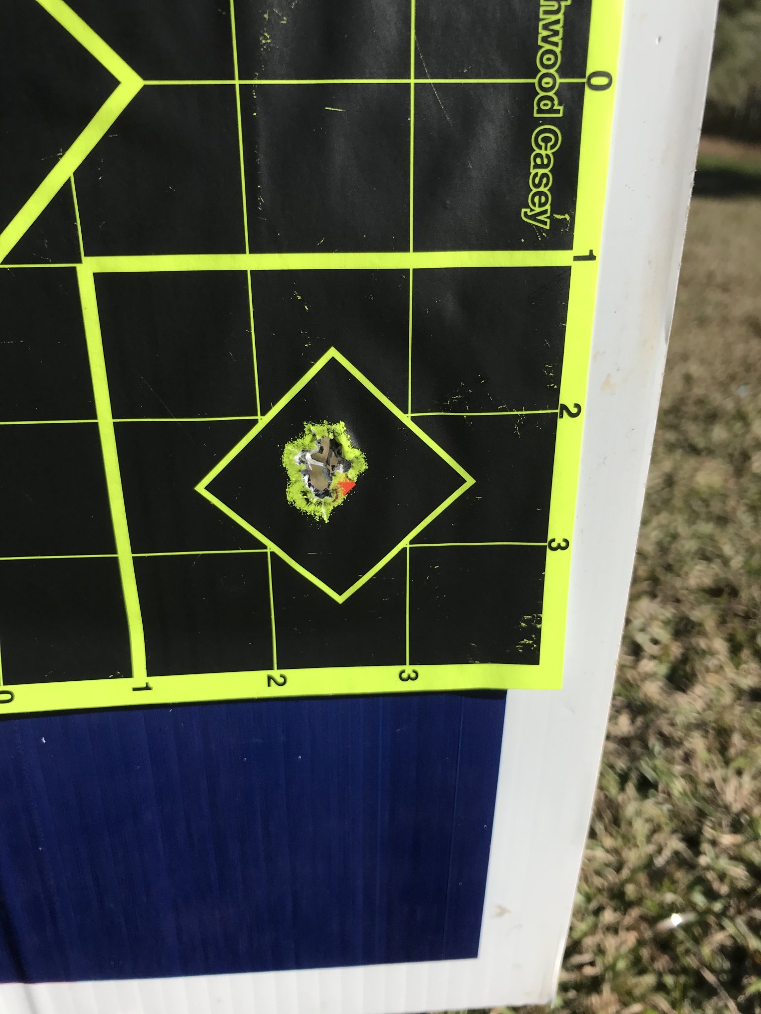

My vudoo is only ever shot with a Mask on, here’s a 10 shot 50 yard group. If the can affects accuracy, it’s marginal at worst.
The can does get FILTHY pretty quickly though. I usually clean the rifle every 300-500 rounds or the bolt will get hard to close. I take the bolt apart every other cleaning and take the crud out too.

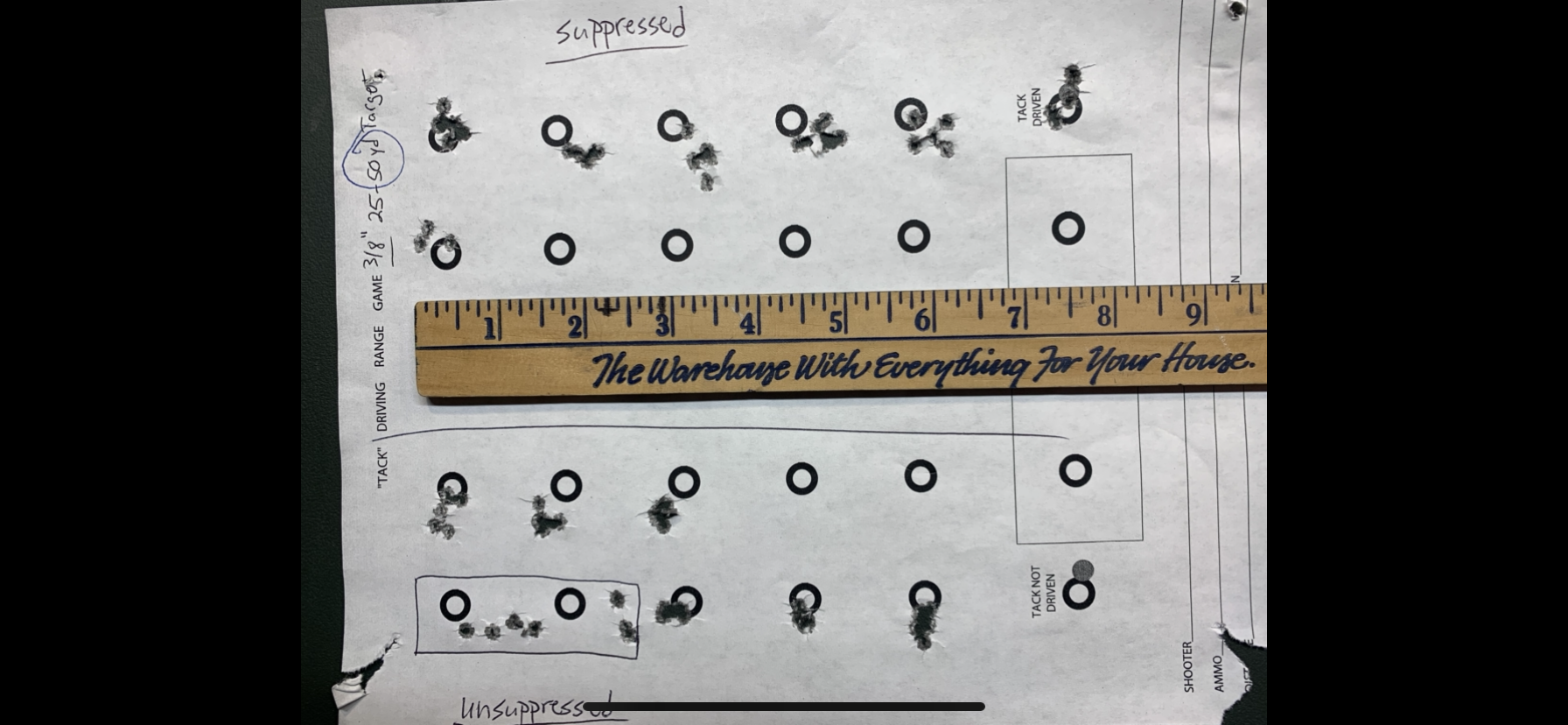

I tested my Vudoo at 50 yards with my Spectre II (has click together K baffles like the Mask) and the same lot of Center X with multiple 5 shot groups. Like others have said previously, the suppressed groups were right around 1/2" larger than unsuppressed (.28" vs .47")
For backyard critter control and wowing first time shooters, can on. For matches and medals, somebody else better shoot it :LOL:

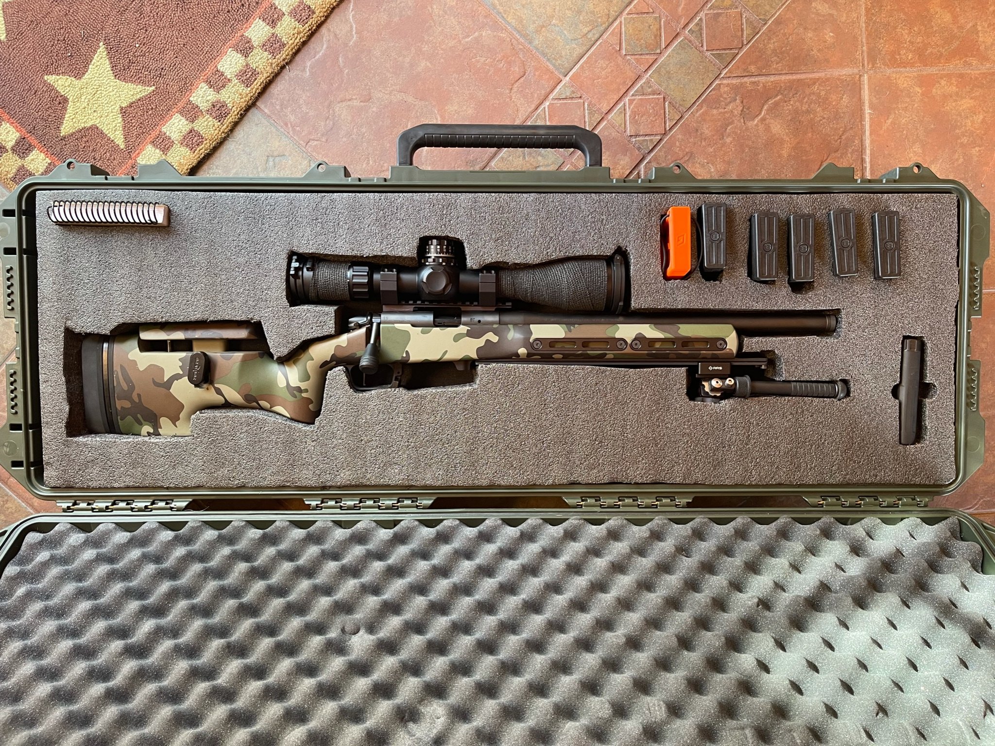

I don't see any accuracy drop with the Mask on my Bergara, just a slight shift in POI. I could not be more happy with that suppressor. It runs on Ruger MKIII's, MKIV's, a bunch of 10/22's, and a PWS Summit. Heavy duty, low maintenance, and Hollywood quiet. Probably my best firearms purchase ever.
