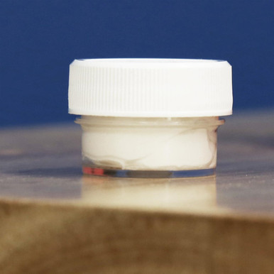

    So it's been a minute but in case anyone has the same issue... I grabbed a tub of ST-3A from Griffin Armament. This stuff is legit (and should last the rest of my life)! Apply a thin coat, let it dry for an hour, and screw the suppressor on. Good to go! If you apply it too thick (I did trying to match coating apperance on NDs website) it comes off easily. ND Ind. suggests a soak in hot soapy water followed by a light brushing with a wire brush. Easier method is to soak a rag in hot water, run it around the threads to get the bulk off, and then a very light brushing with a stiff nylon brush to get the remainder.
