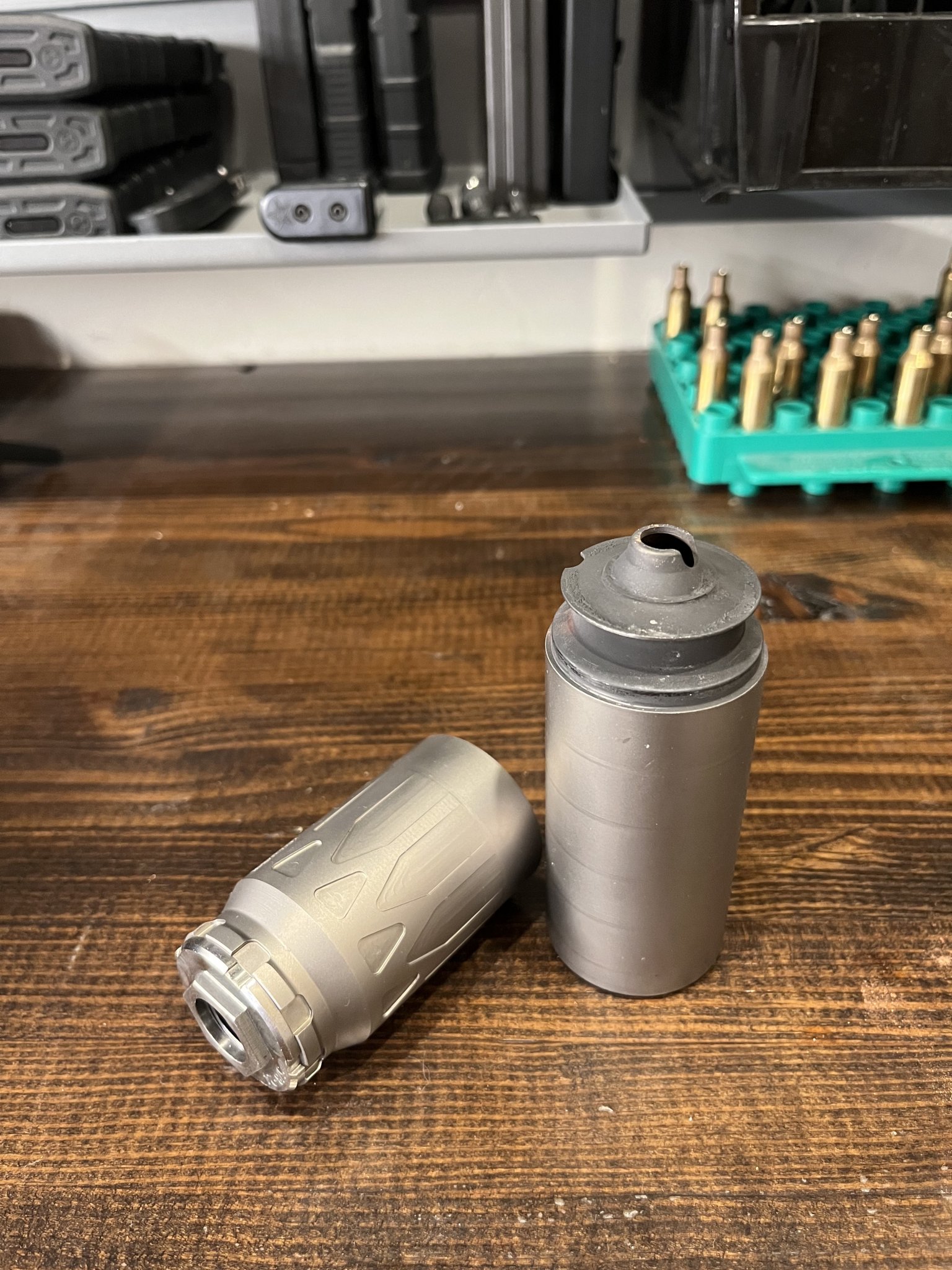

Had an interesting day at the range this past weekend. I had taken my 7 saum out to shoot a few rounds and was running it with the Dead Air Nomad-Ti that I have had for about 9 months. I normally hunt with a TBAC but like the size and tone and had recently switched to the Nomad-Ti. It is only used on bolt actions and never abused. Honestly it has never been too hot to take off because my rifles are so expensive to shoot (dang saums....) that I rarely shoot more than 5-10 round through it per session. The first two shots printed a nice little group at 200. Shot number three was violent with excessive recoil and an obvious problem. It took a second or two to make sure I still had 10 fingers etc and then noticed my suppressor was about 4" shorter. The base of the can was still firmly attached (direct thread mount) but the final 3.5 inches was missing in action. It took 4 of us looking to find the other 5 ounces of titanium roughly 65 yards downrange!! A pic of the now two piece can is attached. So to answer the questions that will be asked
1) There was no baffle strike (the bullet actually impacted 1" high on target)
2) Yes it was a hand load but was a proven load and brass looked perfect after firing (ADG, Fed 215m, 143 Ham Hunter, H4350 (58.5gr) at 3020)
3) Rifle was a Gunwerks Magnus chambered in 7 saum with a 20" proof barrel
4) I have submitted a warranty ticket and fully expect Dead Air to make things right.
5) No person or rifle was harmed from this failure
Just curious if this was a fluke with a weakness in manufacturing or if others have had any issue like this. Curious to hear others thoughts.

Same thing happened to a buddy of mine when a 308 was shot through his titanium suppressor. His failed at the direct thread point and it was in the first 1 shots through that suppressor.
I’m sure dead air will make it right, fortunate the serialized part is still in tact

Hi David,
First off, I'm really sorry this happened! It appears from the picture that the weld seam on that second baffle was not perfectly aligned. The plant does tens of thousands of welds a month and it seems this is one they didn't get right. The can is definitely rated for what you were doing so don't worry about that.
I understand we have a new batch of material coming in so this will be repaired and right back to you with a new stack. The serialized blast chamber is something we can't replace, but it's designed to easily take a whole new stack.
Our CS guys are really slammed and understaffed at the moment, so reach out to me if they're not getting you taken care of.

Same exact thing happened to me. And the exact same location. Took about 4 months to fix but the company gave me a nomad for free for the inconvenience, so now I have 2.

Update…..I received my prepaid shipping label on May 25th and sent the can back to Dead Air. Roughly 2 months later I had a box on my porch with a new baffle stack and new welds. Everything was very smooth and I am happy with the result. I wish there would have been some sort of email communication during the process of how long to expect as I had no idea my suppressor was sitting on my porch a week ago until I opened the box. Another thing that doesn’t bother me but might some people is the end cap and 5/8x24 adaptor were both lightly polished on on my original but came back a very matte almost unfinished look on the fix. It looks fine just something I noticed. Overall, good job to dead air for making it right.

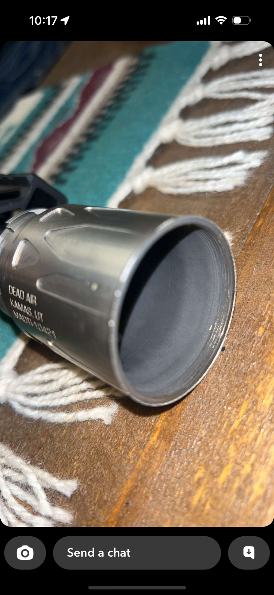

I've seen a lot of posts about KGM made Nomad TIs failing but has anyone seen a KGM branded can fail? I find it interesting that I haven't seen one pictured or even mentioned.

Since this was my original post. It was due to a missed/faulty weld. Dead air was great and quickly fixed the problem. I received the Nomad Ti within a month of sending it in with a brand new baffle stack and correct welds this time. Haven’t had an issue with it since! The problem is that I have purchased more suppressors since then so the addiction is still present. Wishing everyone a Happy Easter and safe shooting!
Or there was a process issue during manufacturing that then got rectified. Not everything is a conspiracy.
The likelihood of this being a conspiracy is next to zero. You'd have to believe both that KGM is willing to sabotage one of its largest customers, and that Dead Air was dumb enough to let it happen.
What's far more likely is the myriad of issues that arise with a contact manufacturing relationship. No need to go into details because anyone who's lived with that situation has experienced enough and anyone who hasn't is probably incapable of understanding, but safe to summarize the situation by stating that there are many reasons to manufacture stuff under your own roof and most of them come back around to human nature.

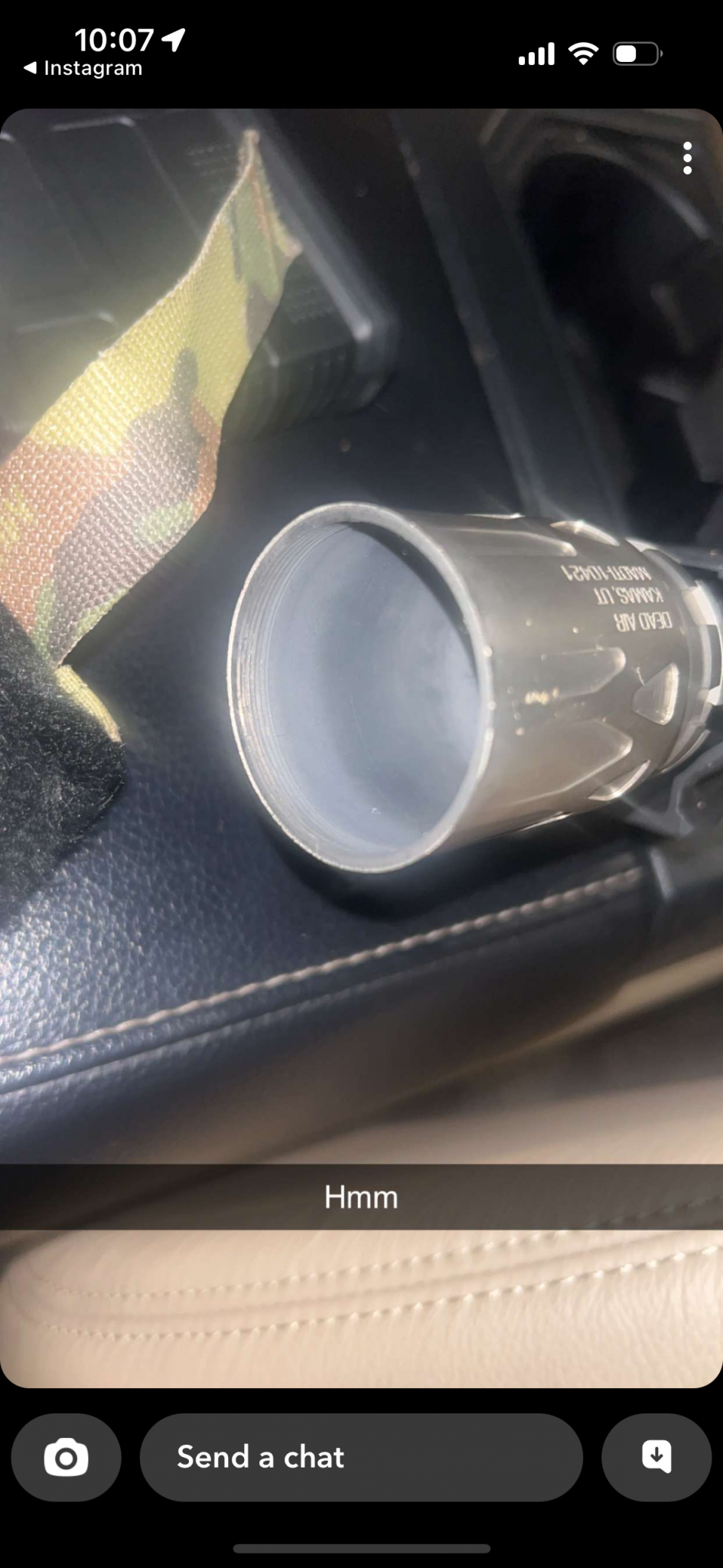

Not super rare apparently this is my friends and I’ve got one in jail third shot of the evening with factory .308 ammo

I personally think 99% of baffle strikes are user error, but Dead Air fixed my Sandman S for free. The only questions they asked me were diagnostic in nature and my address for the shipping label.
I agree with baffle strikes…..my failure was a missed first weld which is exactly what the above appears to be. There was not a baffle strike during my incident. BUT dead air was great and had it fixed quickly. I have no problem if things happen as long as the company stands behind the product which they did. I have been shooting the fixed can for a while now and it is performing well.
