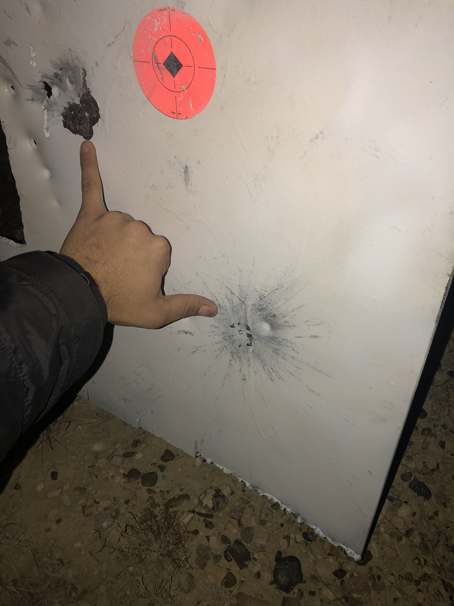

I’ve shot my 300WM Weatherby out to a mile with a 20 MOA base on a XTR II with 15x. Could see some marks on white target but it’s not very convincing with that distance/scope combo
You saw marks on paper at a mile with 15X?
Nooo. Lol shooting white steel. Could barely see gray splatter but it wasn’t a very convincing sight once it was all said and done had to check target to actually confirm 35A1DE54-B5E3-493D-99CA-9CAB4455819E.jpeg
