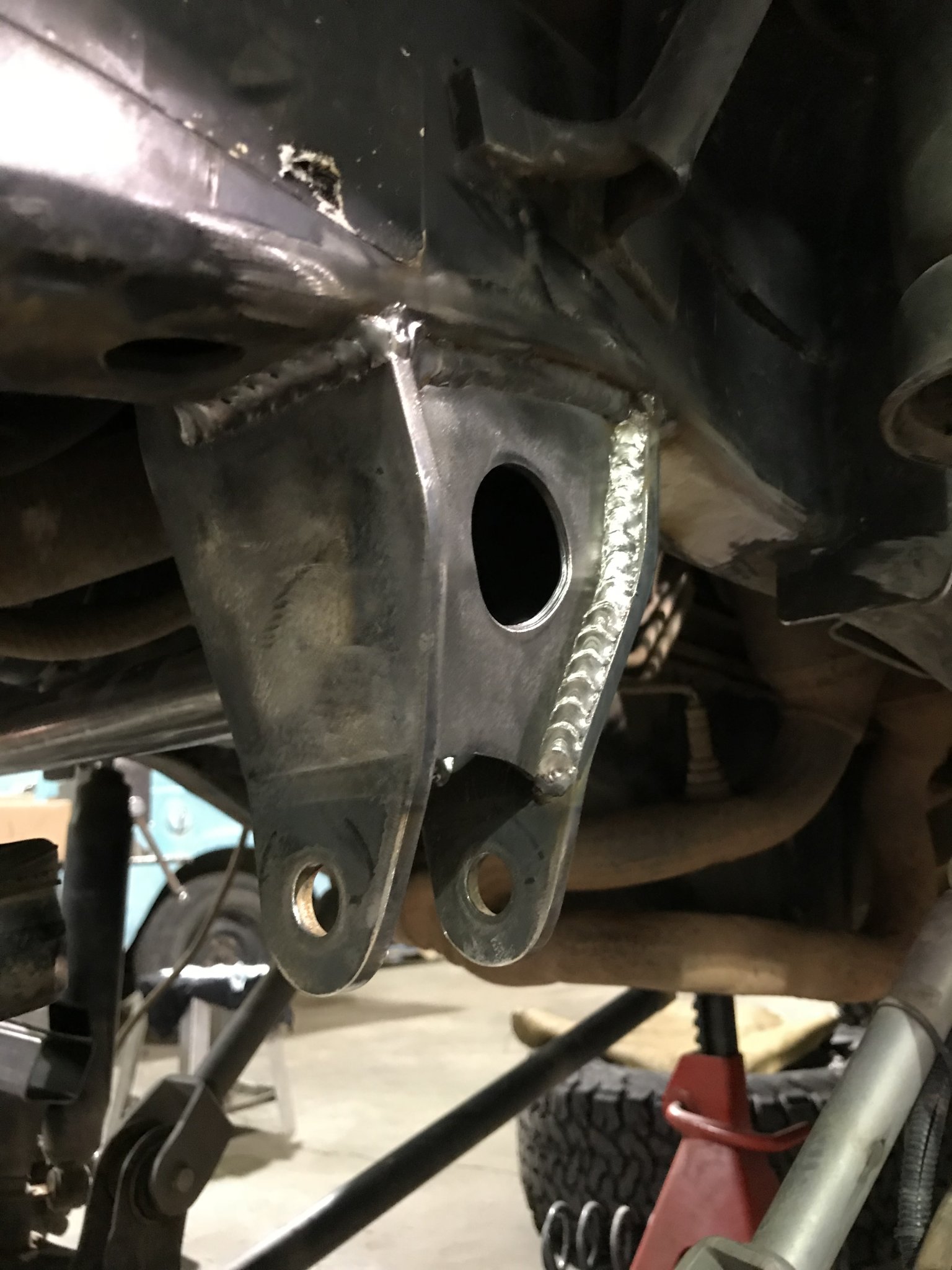

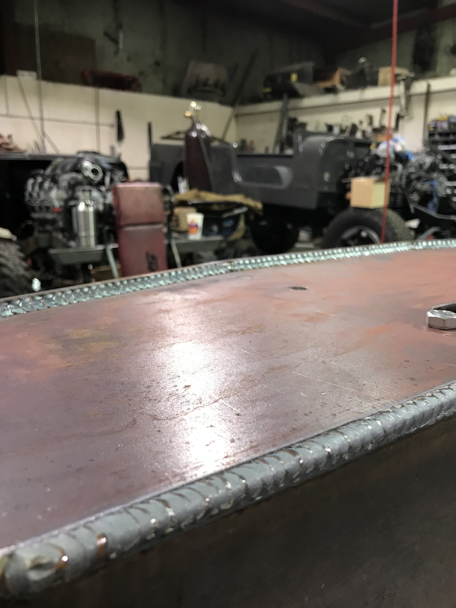

If you really want a stick welder get one but Id recommend a small mig welder. I run a fence and gate shop all my field welders are flux 125 harbor freight welders. They weld gate with flux wire and are super light for how powerful they are. Stick welders are for pipe fitters and old guys that don't like mig...

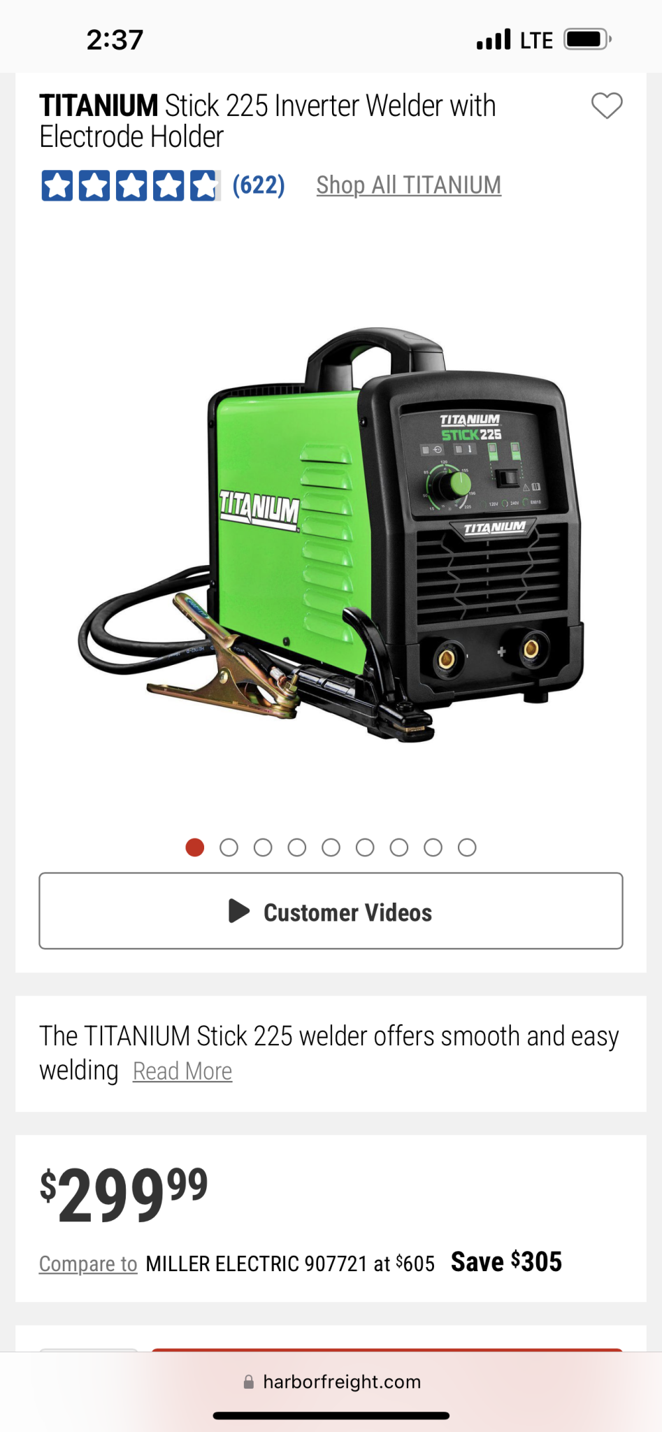

I picked up the harbor freight titanium 225 to weld up a MOVE heavy bumper kit for the 1 inch thick material(tow lugs and frame mounting brackets). I used 220vac. It worked awesome. Lots of good reviews on YouTube. I used wire feed on the thin material.

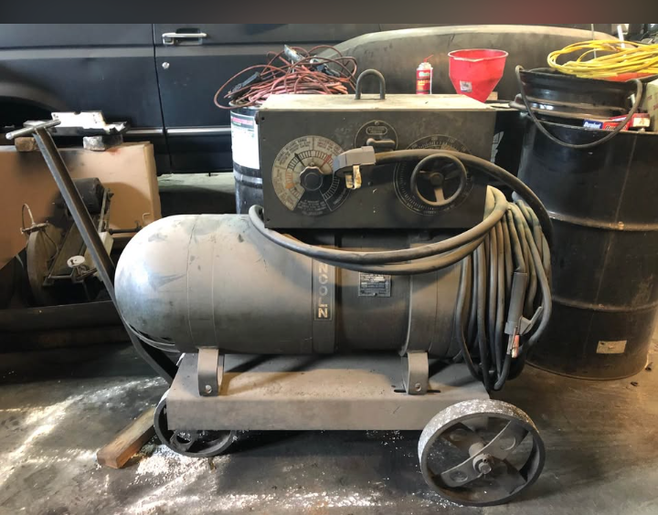

There is a really old Lincoln stick welder, I believe it is call the Tomb to Tomb marker, because of the shape. It welds exceedingly smooth. However probably weighs 400 lbs.

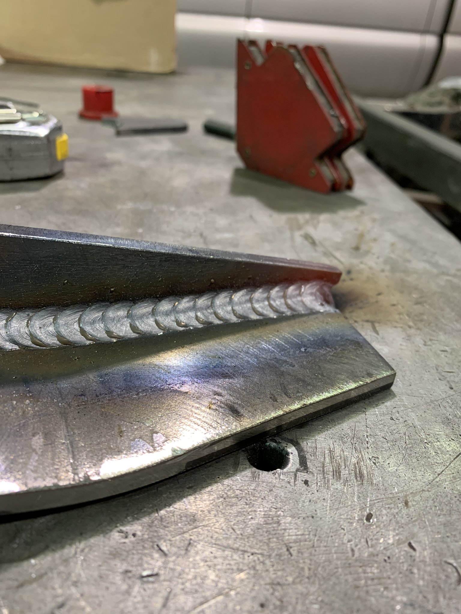

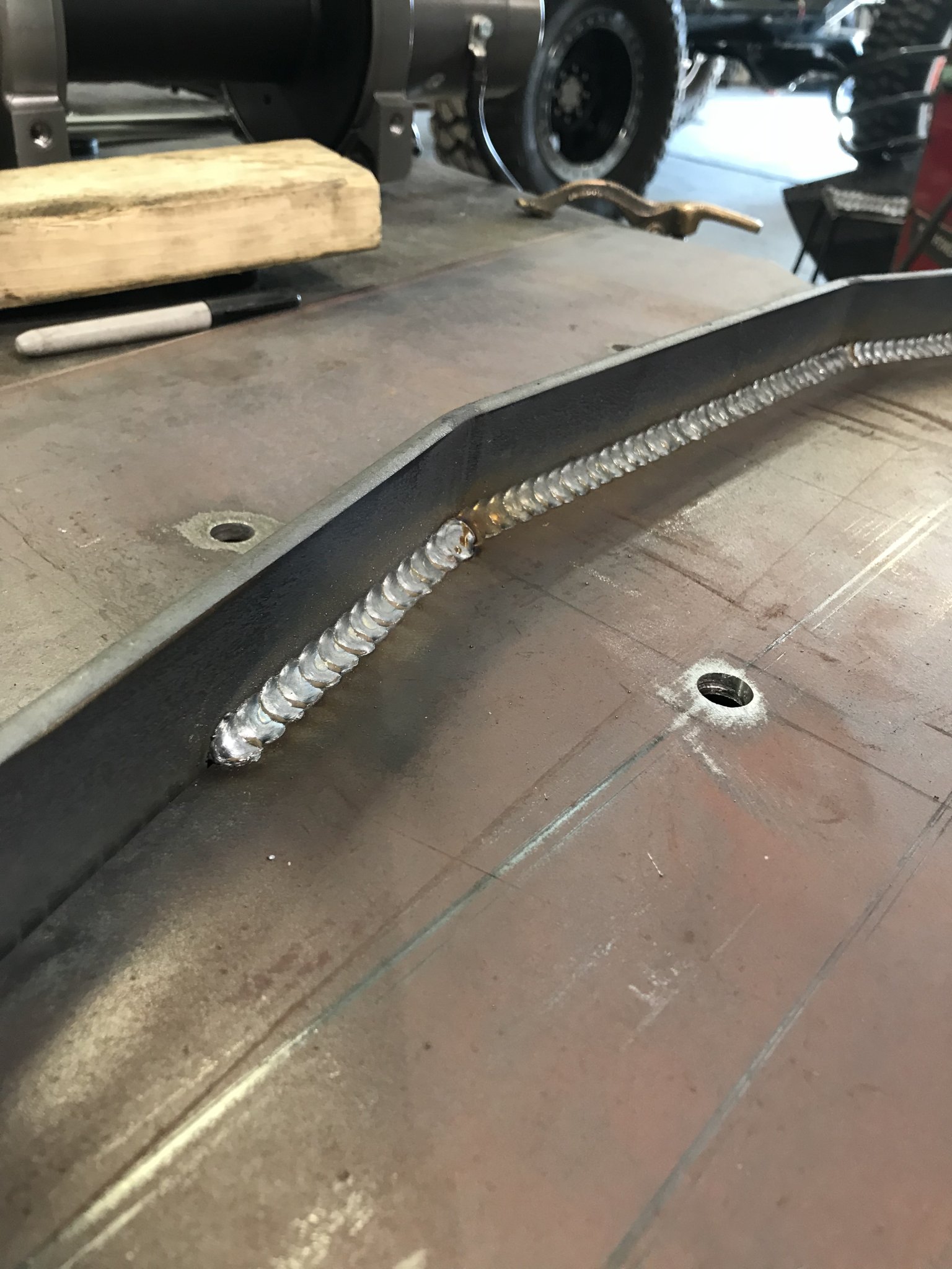

Ive built everything from tube chassis race vehicles to gates. A normal mig welder is all that is needed in almost all cases.

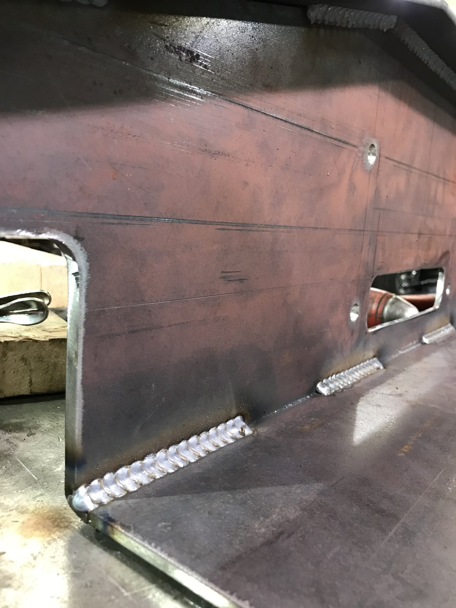

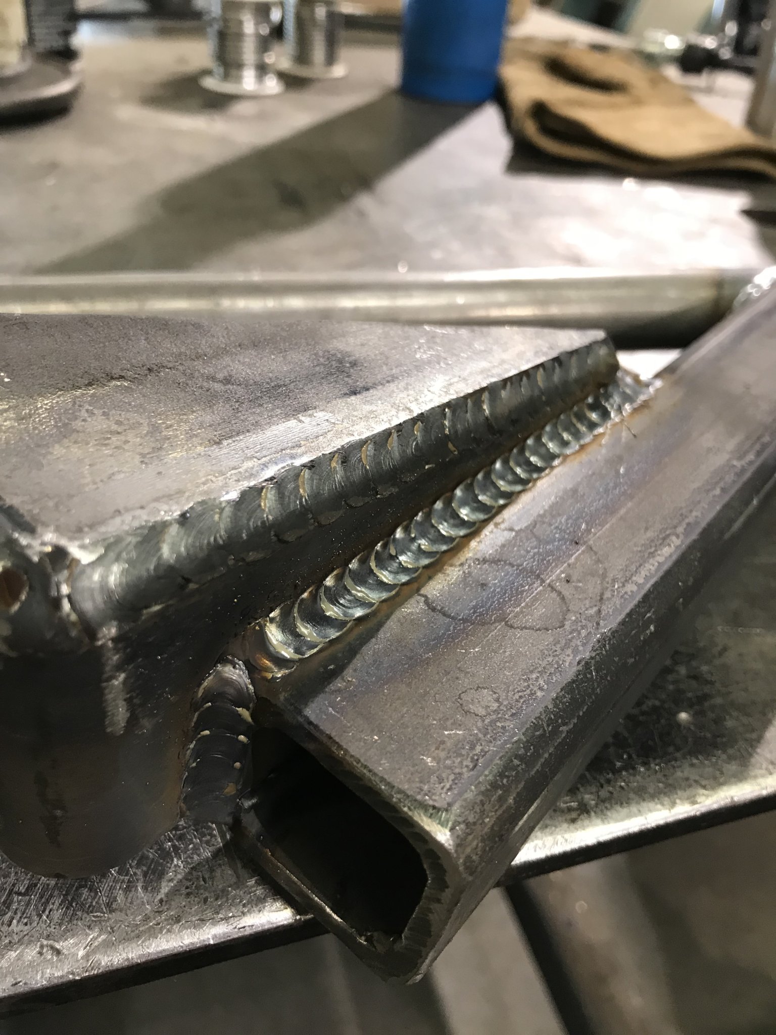

I've built everything from machine guards out of 5/8 expanded metal and/or 16ga sheet metal on 1" square tubing frames to farm implements, sprayer booms, liquid and dry fertilizer spreaders to ram racks, bucksaw frames, broke knuckle boom frames and log trailers for loggers, welded grouser bars on bulldozer tracks, built, repaired and hard surfaced the cutting edges on buckets for wheel loaders, track loaders, excavators, ect. in the last 46+ years all with a stick welder.

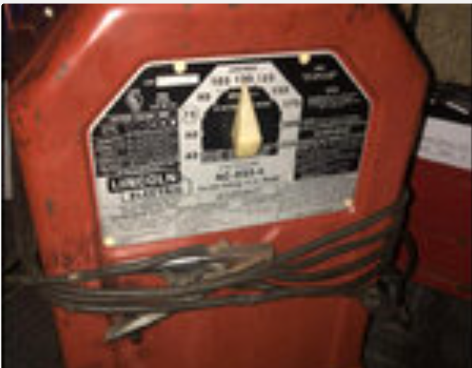

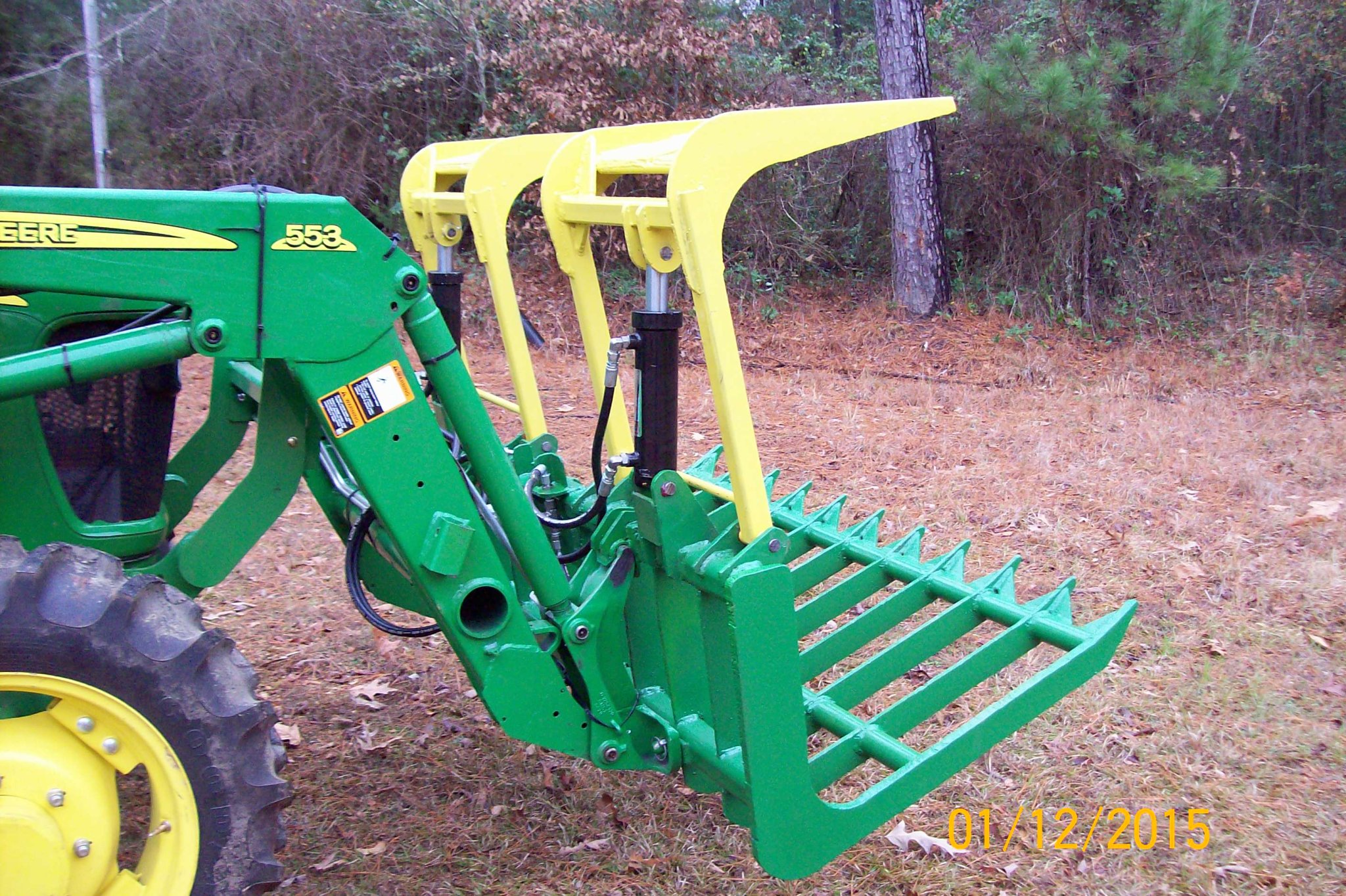

I have one of those, but it's AC only. That's what I built the grapple in my previous post with. Bought 7018's made specifically for AC welding, although I don't seem to have any trouble running normal 7018 with that machine. Don't know what the difference is.
That machine has a lifting padeye on it for a reason. Made back when America was strong with copper windings.
