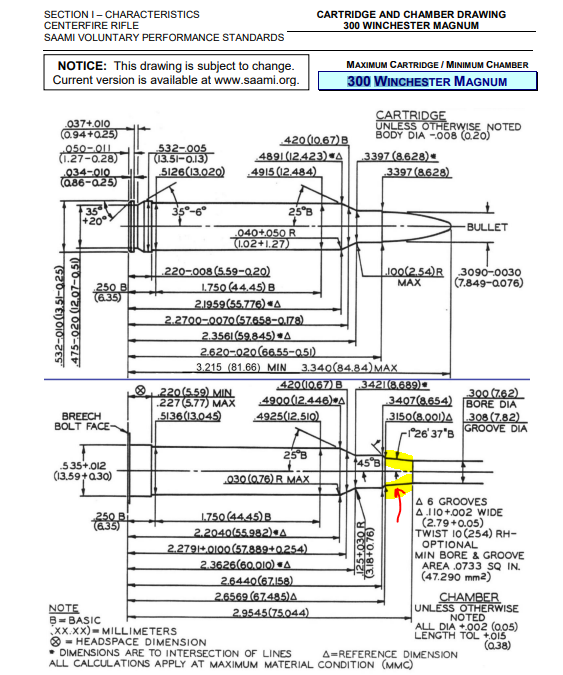

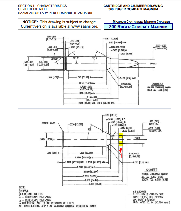

For those not in the know:
Lots of old saami chambers dont have "freebore" -243, 270 etc- they have a long coned transition that starts wider and pinches down.
So its not a clearanced cylinder with 90 degree corners but they cut the corner at an angle and split the difference.
It starts wide at .315 at the end of the neck and tapers down to the .300/.308 bore and groove.
Here is a more modern design with a cylinder of freebore before the shallower leade angle.
It immediately cuts down to .309 and then is free for .1241 before it starts the leade angle at the .300/.308 bore groove.

Thanks for posting. I didn't have time to get that put together. Another point about SAAMI is that they allow for variations for various reasons as long as the variations do not increase the pressure. Adding free bore or additional free bore to a cartridge decreases pressure so it is still consistent with SAAMI as this is minimum Chamber dimensions.
"SAAMI does not “approve” or “certify” firearms or ammunition products. SAAMI creates the voluntary standards for performance, dimensions, and other characteristics. In order to determine if a particular product was made in accordance with those voluntary standards, contact the manufacturer."
-saami.org
Saami doesn't control anything they just provide some standard measurements whether the mfg wants to follow them is totally up to them
