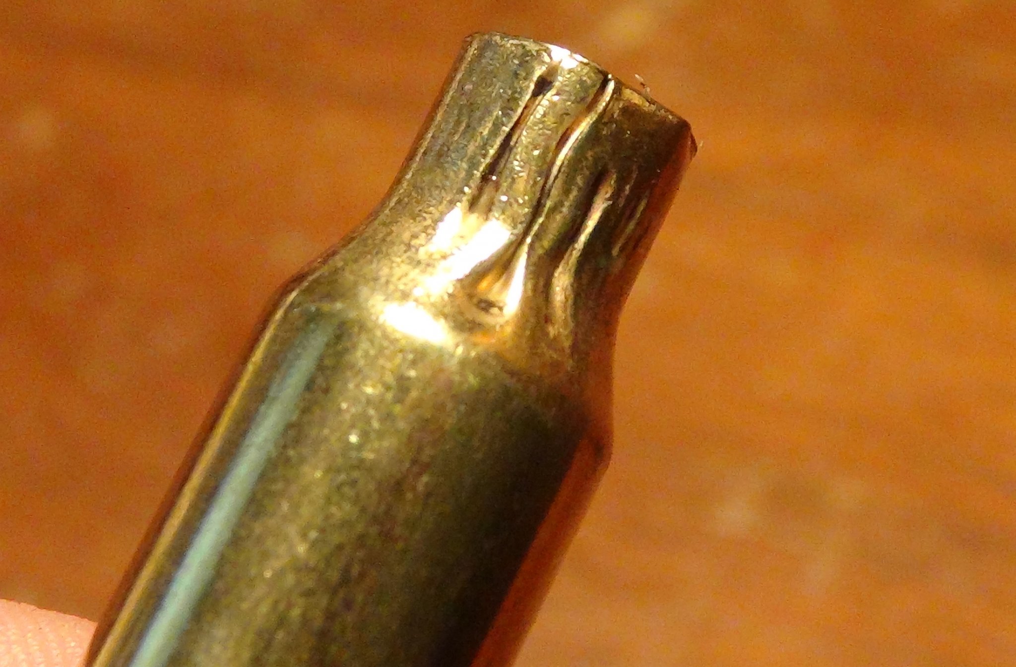

I bought 200 Winchester cases (in the bags), and of those, 66 were defective. There were folds and crimps in the shoulder-neck area. Some had only one pinch, others had many. Anyone else seen this? What can I do to get these replaced?
If there were only dents in the shoulder, or case wall, this would be over. I don't mind using brass which is slightly dented due to over-lube. But that isn't what we are dealing with here.
I don't believe fireforming would work with necks and shoulders which are so severely deformed or folded-over. The neck on some of these looks pleated. Sometimes there is one fold, sometimes several. I don't think fire-forming of brass that is this badly deformed will do anything but weaken it to an unacceptable degree. If I did get a bullet into that neck, I think the resulting diameter would be too large for the cartridge to chamber properly. I'm not going to even try. It's not worth the risk of my weapon, or my body.
I bought the brass from MidwayUSA, and I am relying on their express and implied warranties to remedy the problem. Their warranty says I can return any defective items for either a replacement or a refund. The Uniform Commercial Code implied warranty of fitness for particular purpose provides for the same remedy. I selected replacement. I made my election of that remedy clear from the outset. I have never varied from that position, although I gave them the option of replacing the defective cases with Hornaday or Remington brass, if they wished.
I have been going round-and-round with them on this. I did return all 66 defective cases to them, although the law says I can keep them until they give me replacements which are good. I am showing good faith. They can look for themselves to see the defects. There is now no excuse for replacing the defective brass.
In the last week, I have been exchanging emails. They have now passed me through three successive customer service people, and so far none has been willing to give me a piece-for-piece replacement, as I have requested, and as their warranty says is an option I could choose.
They have told me that they don't keep loose lots of brass from which they can make such a replacement. I suggested to them that the inconvenience on their end of complying with their warranty is not my concern, but I expect them to send me 66 replacement cases which are good, as their warranty said I could elect. Their warranty doesn't have a disclaimer that says, "Unless we'd just rather not honor what we said we would do, because we find it inconvenient."
I have showed them their own warranty. I have directed their attention to the really bad reviews of this brass on their own website, some going back 5 years. I have suggested that they cannot be ignorant about this problem. It seems clear that they were knowingly sending out defective brass to people like me. I have further suggested that they should stop selling this brass immediately (since it might be a safety issue), and start tearing-open a few bags of Winchester brass themselves to see just how pervasive this problem is. Then they should send the whole lot back to Winchester demanding replacement with good brass. I have cited to them the proper sections of the Uniform Commercial Code which govern all this, to help them along. I told them that during this internal quality-check process, they could sort-out 66 pieces of good brass and send those to me. Everybody wins.
So far, all I have gotten is incremental assistance. One fellow said he could send me another bag of Winchester brass, and refund the pro-rata price of the additional 16. I told him that would be silly, since the new bag of Winchester brass would likely contain just as many defective cases as all the others did, and we'd be hung in an endless loop of delivery, rejection, delivery, rejection, and so on.
The last person contacted me telling they would give me a pro-rata refund of all 66 pieces, which is NOT what I have chosen as my remedy under their warranty. I have written back to them telling them that I never asked for a refund. I don't want a refund. I want replacement, which is what I am allowed to elect. And I shouldn't be forced to go out and spend my time and probably more money buying replacement brass when their own warranty gives me the right to get replacements for the defective pieces.
I don't know what it will take to get the attention of someone there who actually believes that customer satisfaction is their 1st priority, as their slogan suggests. Maybe my next step will be to print-out all the materials I have gathered, together with all the unsatisfactory communications with MidwayUSA's people, and send that all in a packet directly to Larry Potterfield. Maybe he can top-drive a solution here. If it were my company, I could fix this in a heartbeat, and some people in the customer service department would be re-trained on the concept of "customer service".
I am a long-time customer, and have spent a lot of money at MidwayUSA. I always shop their site for whatever reloading supplies I need. I don't think the people I have been corresponding with so far understand the long-term cost of ticking-off even one single customer. Why someone there hasn't already torn open a few bags of Winchester brass, and sent me by hurry-up delivery 66 pieces of good brass demonstrates how out-of-touch those in their customer satisfaction department really are with the concept of "customer satisfaction".
I'm not ok with being jerked-around over all this much longer. MidwayUSA needs to honor its warranty, as written. I will keep you posted.
Reactions: Smokey3

b6graham, Winchester brass (when made right) is very good brass. It has a larger case capacity than almost all others, and it is affordable.
I have bought lots of Winchester 308 brass, from a couple of sources (mostly from MWUSA), and never had a single complaint. So, I expected that 300 WM brass coming from MWUSA would be of high quality too. It wasn't, and I didn't see the reviews until I started having problems with MWUSA. Then I looked on the internet, and even on MWUSA's own website, and found LOTS of defects with Winchester 300 WM brass identical to those I experienced, going back a while. The bottom line is that MWUSA was informed through reviews on its own website multiple times recently about the high numbers of defective brass in every bag. In spite of that, MWUSA was sending out more of it to consumers like me, with a statement that it was of high quality. That's a false promise.
I figured that if MWUSA is selling it, it is good stuff, right? Their commitment to quality on their website, and other advertising, made me feel I could trust them. Winchester has known about this problem for years. MWUSA has known about this problem for many months. Why MWUSA continues to buy (and sell) any more 300 WM brass from Winchester after being informed about this issue is beyond me. The law doesn't require me to do quality control checking before purchasing what MWUSA advertises as good brass. It's the job of MWUSA to do that quality checking before selling it to me. That's the law.

Wanted to add my Win brass experiences. I was getting ready for a prairie dog trip and needed a couple hundred pieces of 22-250. This was a few years ago and brass was still really hard to find (still is in certain calibers). Anyway, Cabelas had Win brass in bags of 100. I ordered 3 bags. I had several pieces of brass that looked like the original photo and were totally unusable. Several more were improperly formed and split upon the first firing.
When I got back from my trip I contacted Winchester directly. They were actually very helpful. I wanted to let them know about my experience to (hopefully) improve their quality control. I didn't ask for anything but they offered to send me a shipping label and I wound up sending back the defective cases, which was about 20 out of the original 300. I also returned the original Win bag with the lot number on it. About 2 weeks later I received a check for approx $55.
I have never had this type of deformed case problem with any other brand. I think it's a QC issue.
Will I buy Win brass again? Pretty much only as a last resort. Too many other options now that are much higher quality. For my Creedmoor it's Lapua and Starline,
Just be aware what you may run into if you try to save a few $'s with bulk Win brass.
