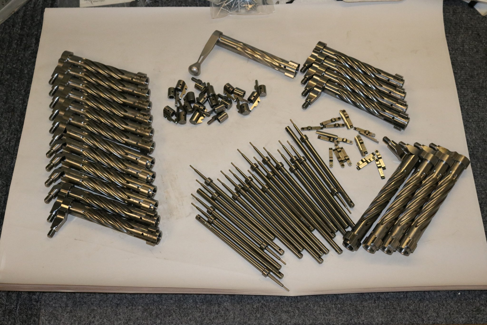

I use a variant of the Deviant in all of the SENTINEL and LongSword rifles. When I receive the actions, they are measured (headspace and all other pertinent info needed to do the breech work on barrels) then stripped. All components get the last 4 digits of the SN engraved. The bolt body, extractor, firing pin and cocking piece then goes to IonBond in North Carolina.
This is a few getting put in plastic sleeves for the trip to NC.

The bolt bodies get aluminum oxide blast for a matte finish and everything else keeps a polished surface.
Experience with wear on these parts has been extremely positive.
IonBond does give a corrosion resistance that far exceeds bare steel but is not on par with CeraKote, hard chrome, NP3 or melonite in preventing rust. IonBond does outperform all of them as far as showing wear in my experience. Bolts on duty guns coming in for rebarrel hardly show any wear.
I used melonite services for about a year. The people were great to work with and the finish was consistent but I would not send small/low mass parts or parts with thin peripheries due to concerns with brittleness. Melonited parts would show wear pretty quick although there was likely still a residual protective quality to the surface.
For me, the wear properties and consistent black visual signature of the IonBond make it my personal choice. Others may have different needs or priorities that make other treatments preferable.
