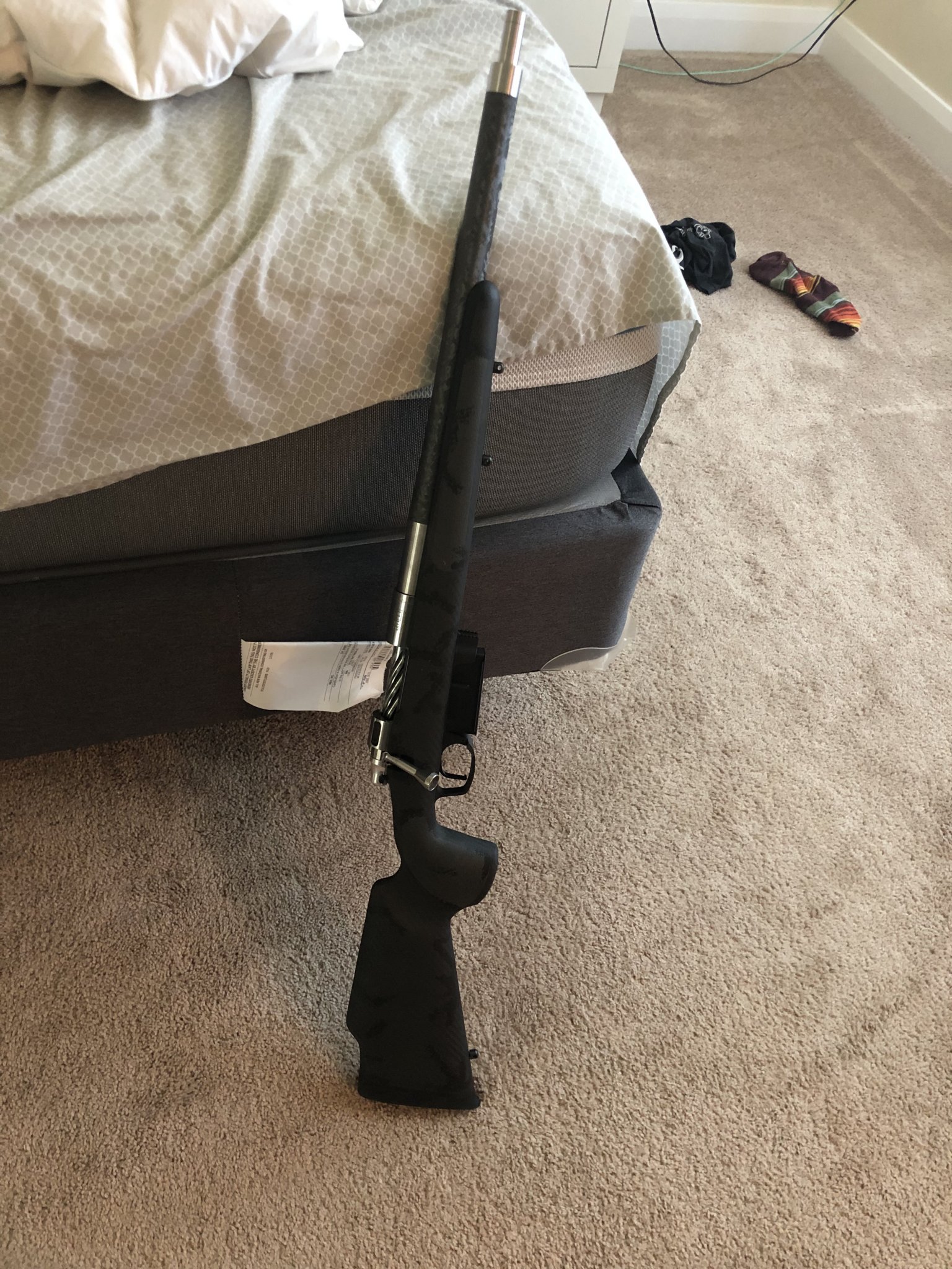

I finally got mine in a couple weeks ago, then the barrel. It’s at Altus now getting all buttoned up. I will update more when it’s complete.
The stock is the Mesa precision altitude, feels amazing. The rifle should come out about 5.7lbs. With the Hawkins hybrid rings and vortex razor lht it should be around 7 lbs scoped
