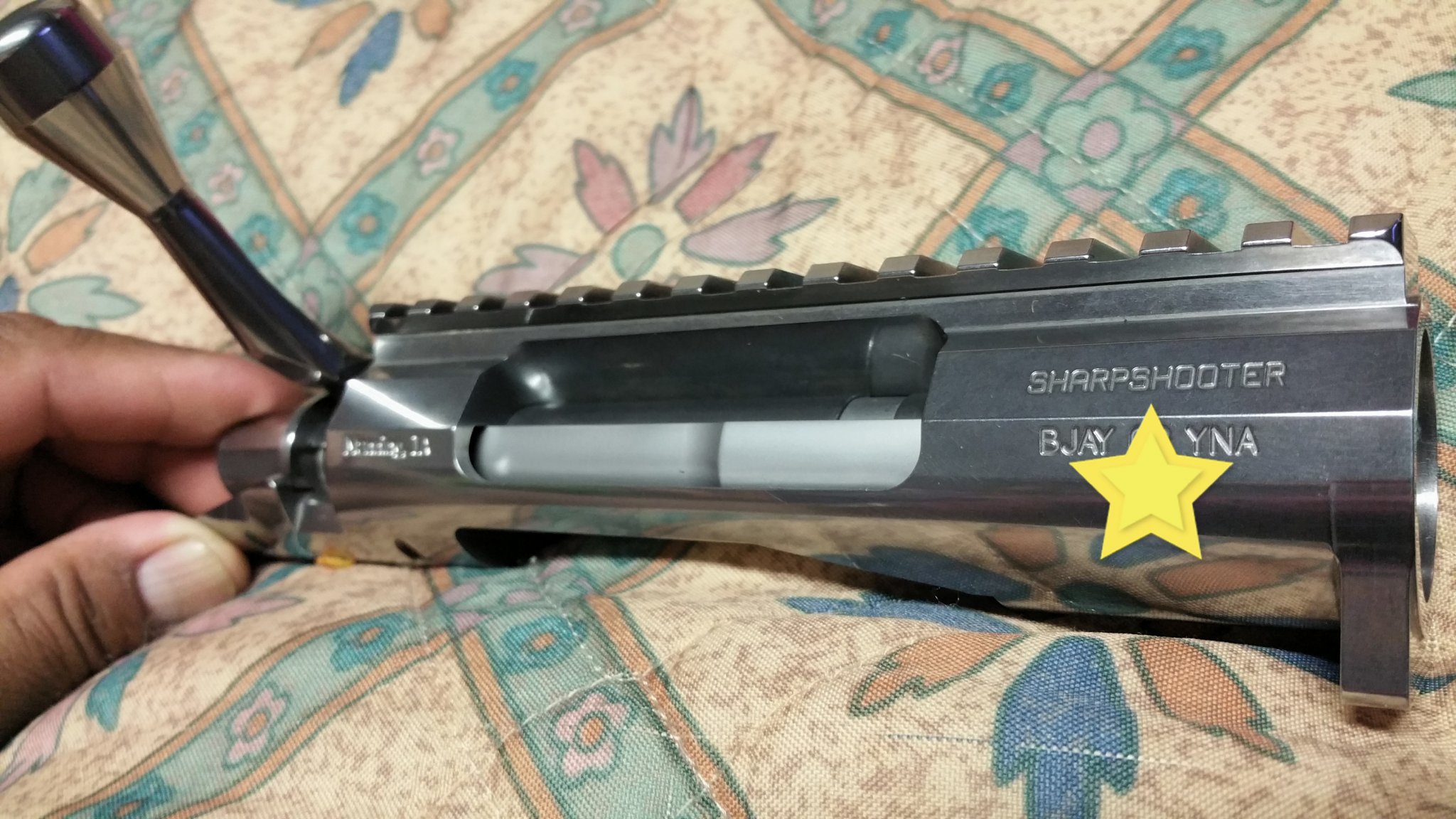

For tactical shooting/prs and prone shooring with JAE chassis...all actions nitrated no plans on switching barrel so the option on vector "quick switching barrel" dont matter.prefer shoulder one time torque up barrel and integrated rail/lug...the 60 vs 90 degree bolt dont really matter much either..
And im talking about the extended tenon elite mechanical ejevtor deviant..
Which should you pick?
watched the curtis custom crew do very well last weekend. being able to change a barrel without a gunsmith is an intrigueing idea. you do alot of shooting and need a new barrel very easy to change with minimal or no shift of zero. I do love my deviant and hard to talk me out of giving it up. i ran a gap tempest for the first time in that match. if time was a factor i would not recommend a tempest. mine is still new and still a little rough to cycle. From what i saw the curtis is smooth and i would buy one.
I'm not sure how big of a deal the quick change of the vector is now that we have barloc/switchlug etc especially if you don't plan to use it, it will always be an option down the road. If I didn't have a nucleus on order and was picking up a Mausingfield tomorrow it would be an impact
Impact l..is just a standard rem ie.surgeon right? What does this action offer vs. standard custom rem action (defiance,surgeon etc.)
The elite has this new firing pin system extended tenon,mech ejector (CRF) like big horn.
Im using deviant crf at the moment and its very smooth and doesn't bind like the standard deviant.
Axiom has 3 lugs 60bolt so these two not your standard rem clone...am i missing anything on IMPACT?

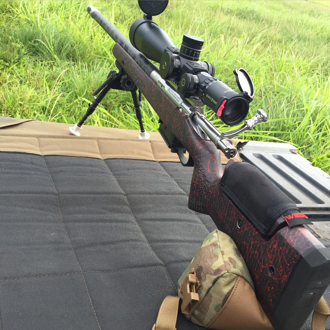

Just sold barreled action deviant CRF..and just wanna make sure the next action is an UPGRADE

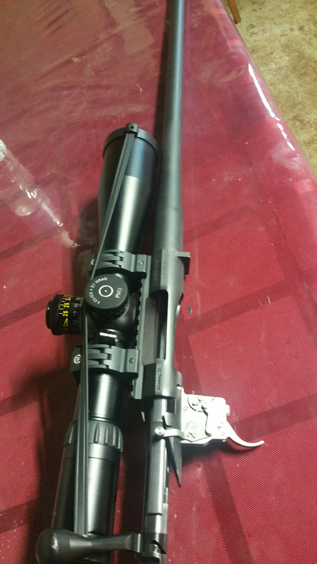

I have a TacOps Rem700, a new DLC'ed Defiance Deviant, older Defiance Rebel, Mausingfield, had a TL3 for a hot minute and have a Lone Peak Fuzion on the way for the wife. I'm really impressed with the Mausingfield - it's a tier above the other actions, very well thought out and built. My gunsmith says I will be even more impressed with the Lone Peak Fuzion over the Mausingfield.

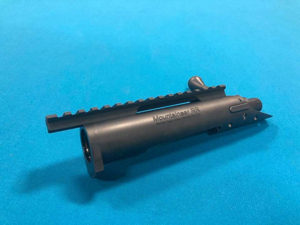

I think there's a new Mountaineer "PRS" though I think its a multiflat integral lug and rail?
That's good to know I'd be curious as well I'm sure it will be an excellent action just wonder how it will do in the field.

I found this early drawing on Jim's facebook. This is what I was talking about multiflat action with integral lug but I was pretty sure it's gonna be available with integral rail too
