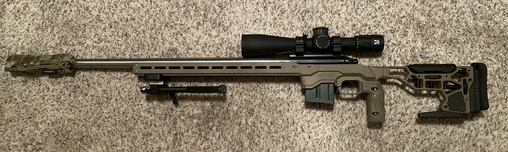

    Thanks for all of the input. I decided on a Fuzion, but couldn’t find one in stock. Ended up grabbing a Ruckus…..about a week later received an in-stock notification from Altus for a Fuzion 🤦🏻‍♂️😂
    How you liking the fuzion? I just bought one with ab bartlien off the px, new never fired. Gonna drop it into an MPA matrix. Chambered in 6 dasher. Very pumped about this.
    I ended up with a Ruckus. Work has been nuts, and I only have about a case of ammo through it. It’s fed, fired, extracted, & ejected well so far.
    Feels different than my Lone Peak Razors. Not necessarily better or worse, just different.
