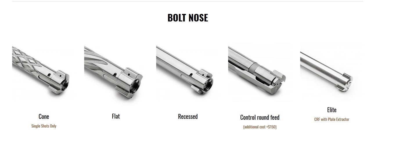

This is what I was referring to. defiance bolt nose.jpg They have plenty of options on their other actions.

By the way, all bolts are recessed nose, mini-16 extractors.
Firing pin size, cannot find any reference to what it will come with. Makes a difference if wanting to run small rifle primer cartridges like a Dasher or 6.5x47
Also, which extractor is used? Mini-M16 I hope.

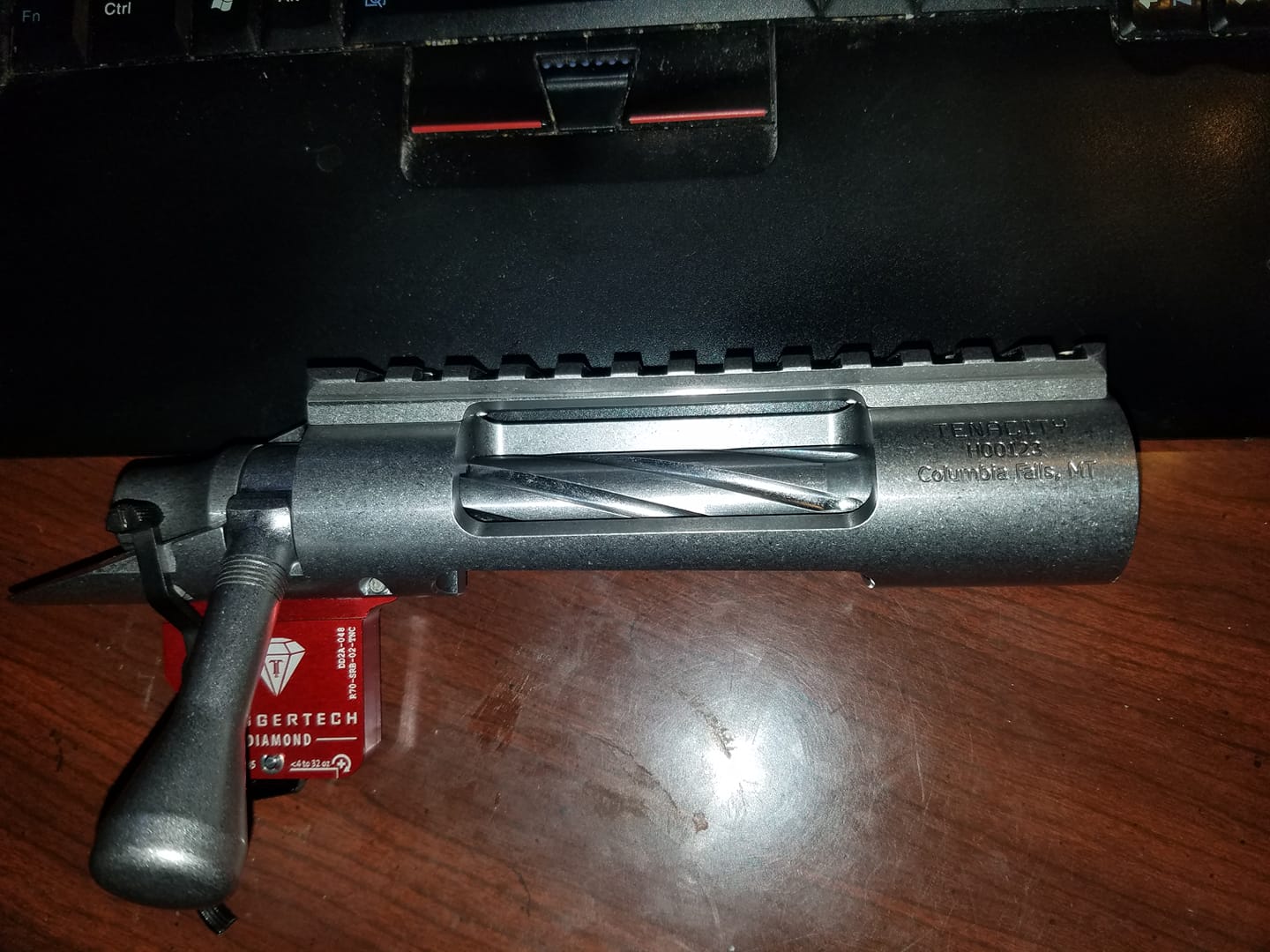

Mine shipped on the 15th, UPS forked up and it is delayed in chicago. Should still beat the nucleus and origin to my ffl. Noticed on my invoice that I got serial number 123, pretty neat. Well H00123. Can't wait to get it in hand though.
My serial number is 106. I will get pics up asap. I think I'm going to just have the barreled action bead blasted insted of CeraKote.[/QUOTE]

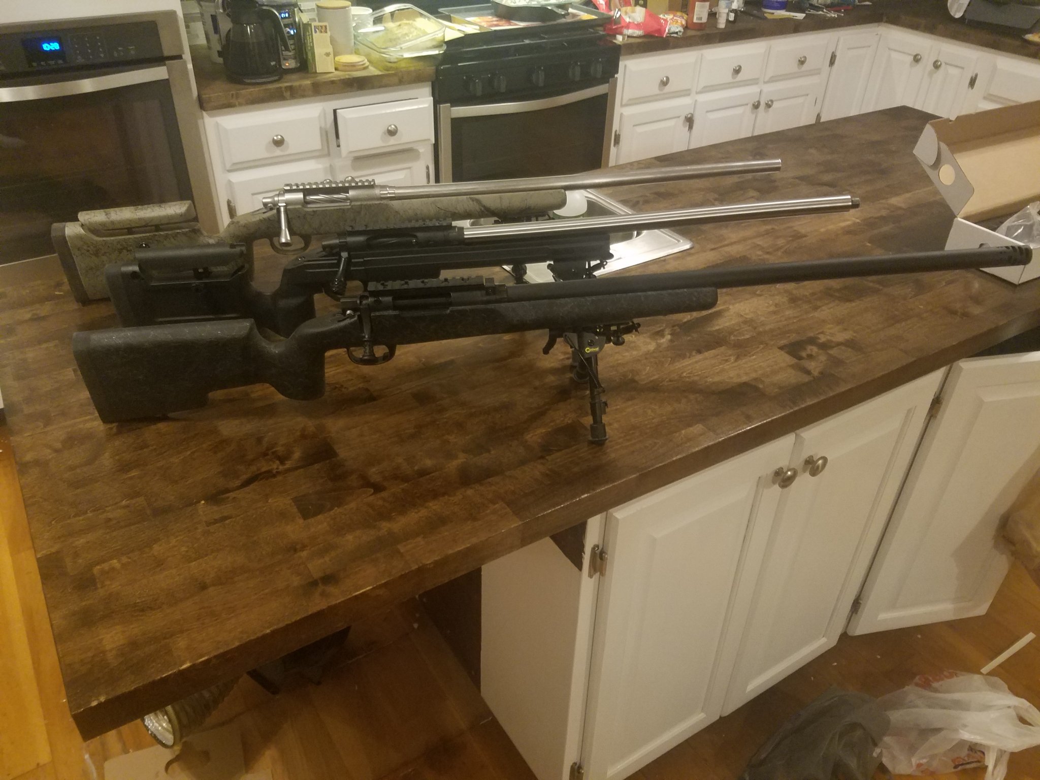

Sorry about the delay in response, life... I have had a little hands on time with the tenacity and origin, as well as the couple nucleus and kelbly black bear i got in. I ordered a second Origin, which should be shipping this week, as I think I am preferring it. The Tenacity is quite nice and the only issues I have had with it are with triggertech triggers. I can't run a diamond in it, and with a special it has to be set to a really high weight. Tacsports and other trigger seem to work just fine with the tenacity.
I think so far my favorite action is the Origin, which is why I have another one coming. Well not including the Black Bear which was quite a bit more. The bolt lift on the origin and the tenacity are both very smooth and neither seem to be much more than the other as far as weight. Fit and finish on both actions are top notch.
I am wanting to get a long action atlas tactical now to try out now, but might just pre-order the NSS Bat in long action.
Anywho, both the origin and the tenacity are great actions. I do think I prefer the origin over the tenacity though. With the Badrock rifle comming out and having control round feed and not yet released long action, the Tenacity line should be getting quite a few more options shortly (since the Badrock South Fork is based off a tenacity action), which could make me change my mind.

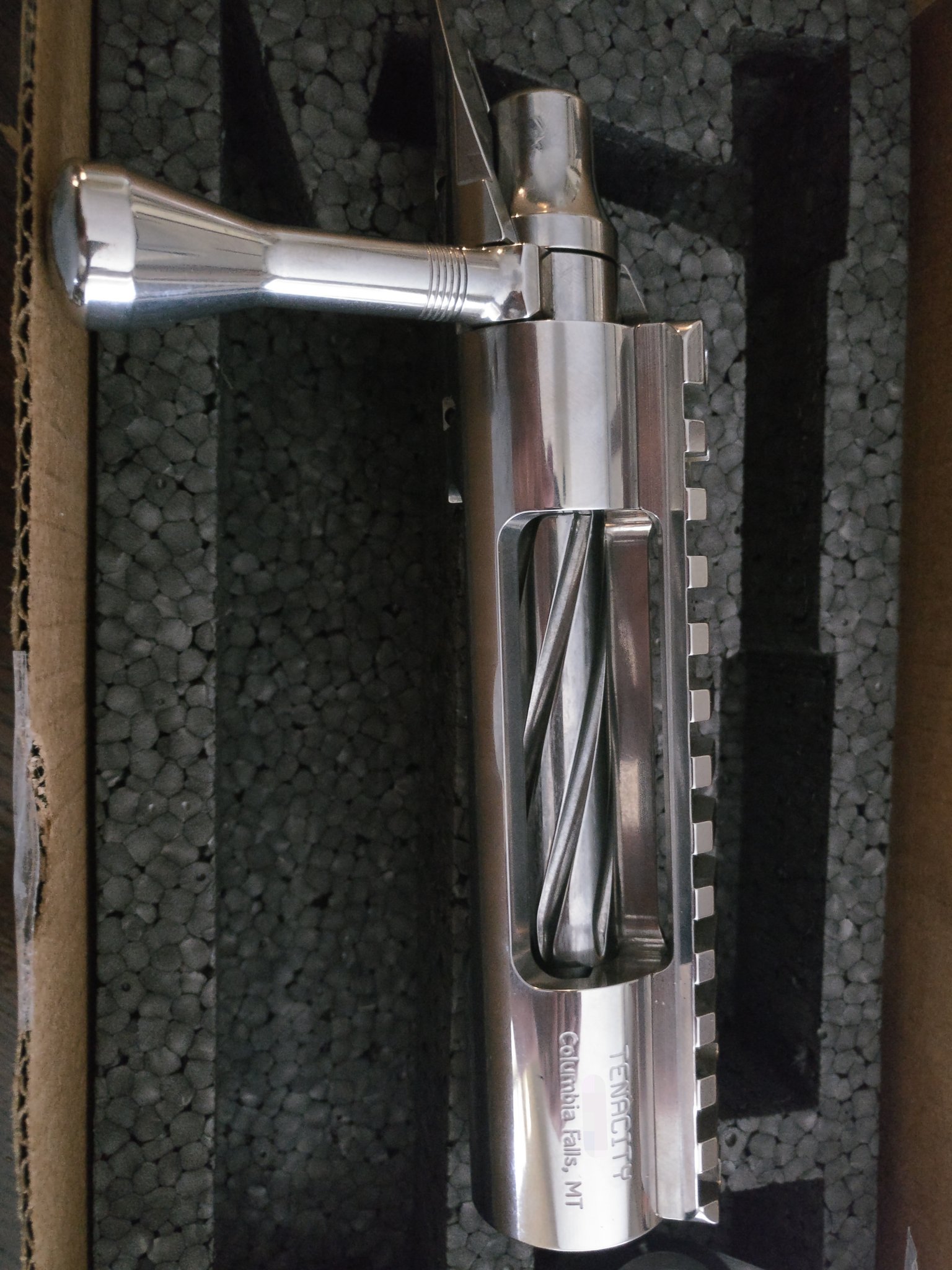

Im a little late posting this.. honestly didn't know the thread was here till now...
I originally called them up to ask if i could get a tenacity action polished or dlc coated they said at the time they aren't offering any coating options. I put in an order for one anyway. Figured i could cerakote it if i really didn't like the finish.. I think i ordered mine back in March or May when it was still preorders only. They happily took my money and told me it'll be about a month till they begin shipping..
A few months pass by it's now June and i didn't even receive a call from them asking for FFL info so i give them a ring. They put me on hold for about 5 minutes and they come back to tell me they somehow forgot to add me to a list. But they happened to have one action that was polished that they were "testing production times with". If i was interested i could have the polished one or i would have to wait for the 3rd production batch. I immediately jumped for the polished one i originally wanted!
I got my action in 2 days later. DROsed it immediately (and 10 day wait in comiefornia).. then sent to LRI as soon as it was out of jail. Took about 3 weeks with LRI and i had my rifle fully assembled mid July.
I'm super happy the the action. Easily the smoothest action I've ever felt. And in holding a nice consistent ⅓" at 300yrd with Hornady American Gunner 6.5cm 140gr. Still need to do hand loads but no time. Best part is, I believe this is still the only factory polished tenacity.

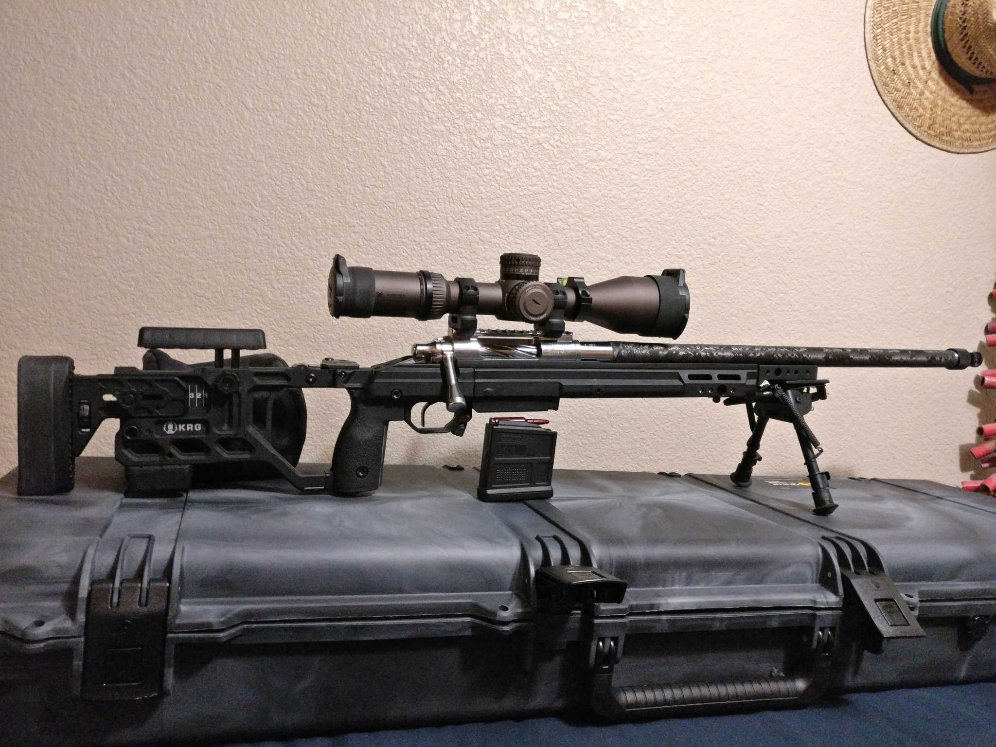

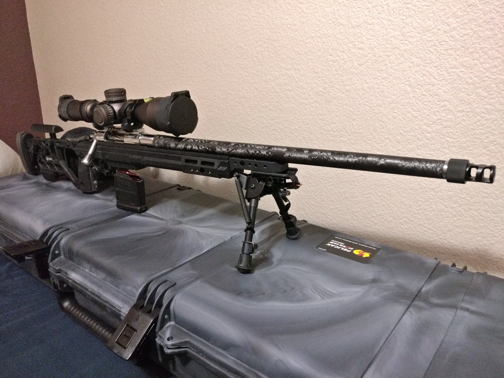

Kinda hard to see but my tenacity build is the FDE w/ black webbing in the back. Bix-n-andy tacsport, Grayboe renegade (3d printed and built the adjustable cheekpiece riser myself), PTG battle worn bottom metal (don't like it that much but was on sale for like $50 about a year ago so had bought 4 or 5 of them), and NSS Criterion 6XC remage barrel. Running an athlon ares on it and liking it quite well. Think I am liking the origin more than the other two actions (origin is in the middle in KRG bravo, from is my son's nucleus 6mm Creedmoor), but happy with the tenacity in general.
