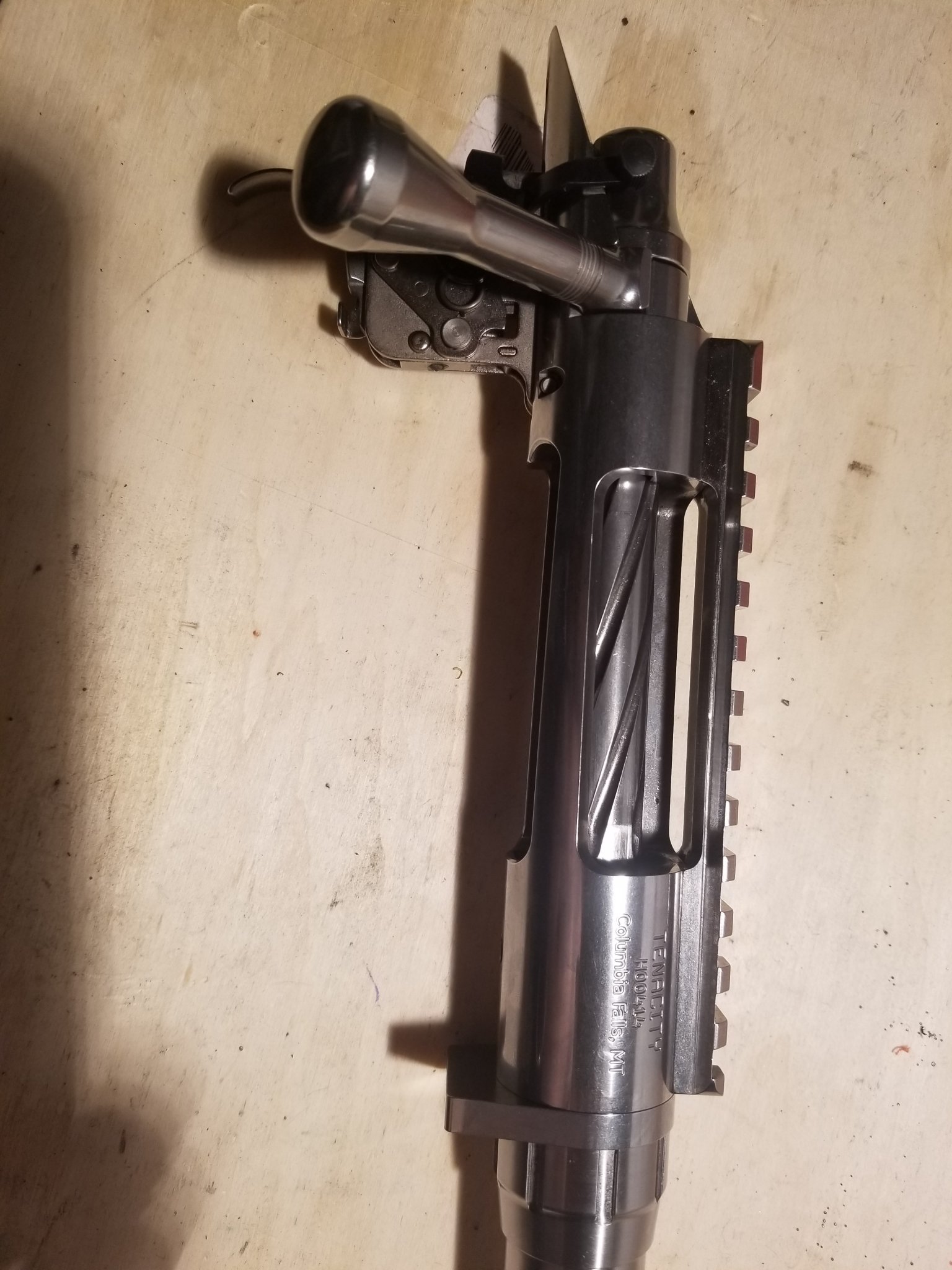

So I have been running Defiance Tenacity's since the season began. One in 260 and one in 223, both built by Area 419. Both have TT diamonds installed and neither action/trigger has had any issue of any kind. Both have been flawless and are sitting at close to 4000rds combined so far. I would highly recomend them for someone looking at a budget friendly custom action. Not sure where the TT rumor started in the Tenacity, but I can confirm that they do indeed work...
Mine is still running strong and accurate as ever.. running it had definitely smoothed out the bolt more.. I'm sure mine coming polished sped that up. I'm ocd about my bolt feeling smooth as glass.
