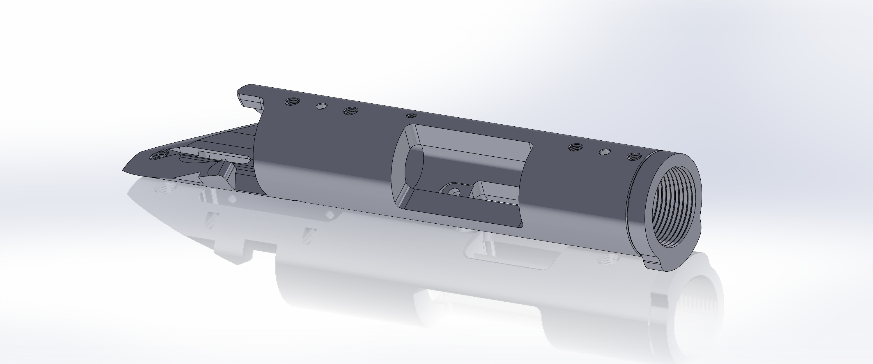

Ok, thanks to the responses from my weekend mass email, I have a solid handle on per generation inventory levels. Not surprisingly, the greater number of actions out there is the Gen 3, Three60 Repeater. So that's where I'm building inventory first.
I'm now going part by part in the SolidWorks Assembly Models to validate all eight configurations of the Gen 3 (four for the repeater, four for single shot). As I validate a part, it gets placed into manufacturing engineering and validation and then production. This might sound like a lengthy process, but not really.
The thought struck me as I've been reviewing files, I could start making these things today if I took a notion to do so.
The thought struck me as I've been reviewing files, I could start making these things today if I took a notion to do so. View attachment 8690744

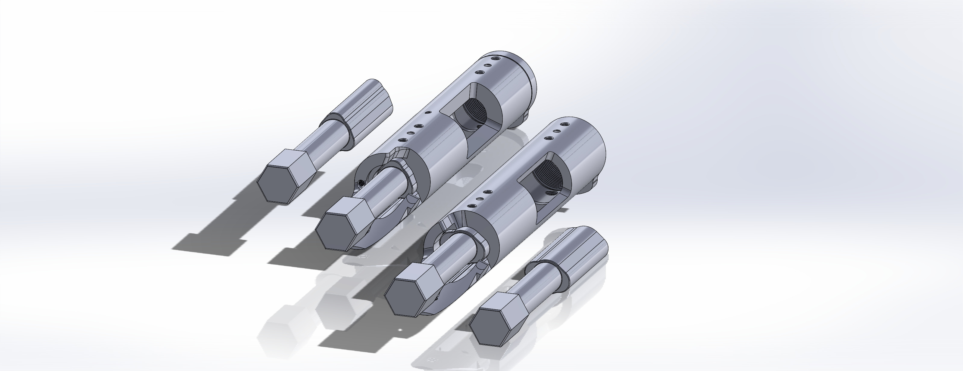

As I'm awaiting a bit of info on parts to complete the pricing structure, I'm working on tools; the first being the Three60 and Two Lug Receiver Wrenches.
The bolt disassembly tool for the Three60 will be made by @chutinlead, along with a couple of other things I have in mind if deemed feasible. The disassembly tool for the Gen 1 and Gen 1.2 will be a bit more involved due to the threaded bolt shroud.

As I'm awaiting a bit of info on parts to complete the pricing structure, I'm working on tools; the first being the Three60 Receiver Wrench, followed by the wrench for the two lug variants.
The bolt disassembly tool for the Three60 will be made by @chutinlead, along with a couple of other things I have in mind if deemed feasible. The disassembly tool for the Gen 1 and Gen 1.2 will be a bit more involved due to the threaded bolt shroud.View attachment 8692387View attachment 8692388

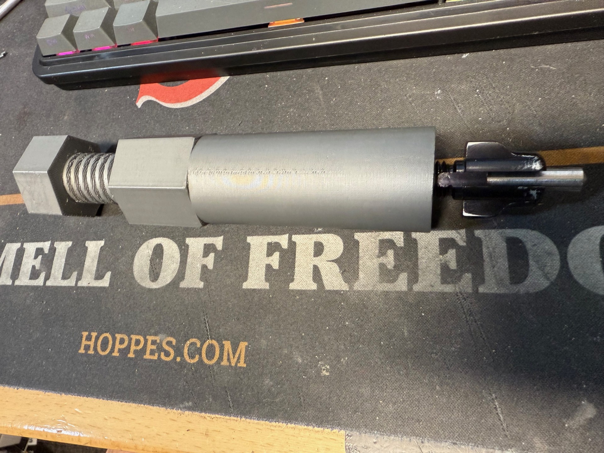

This is the 3D printed tool I made to dissassmble 40X type bolts with a threaded shroud.
