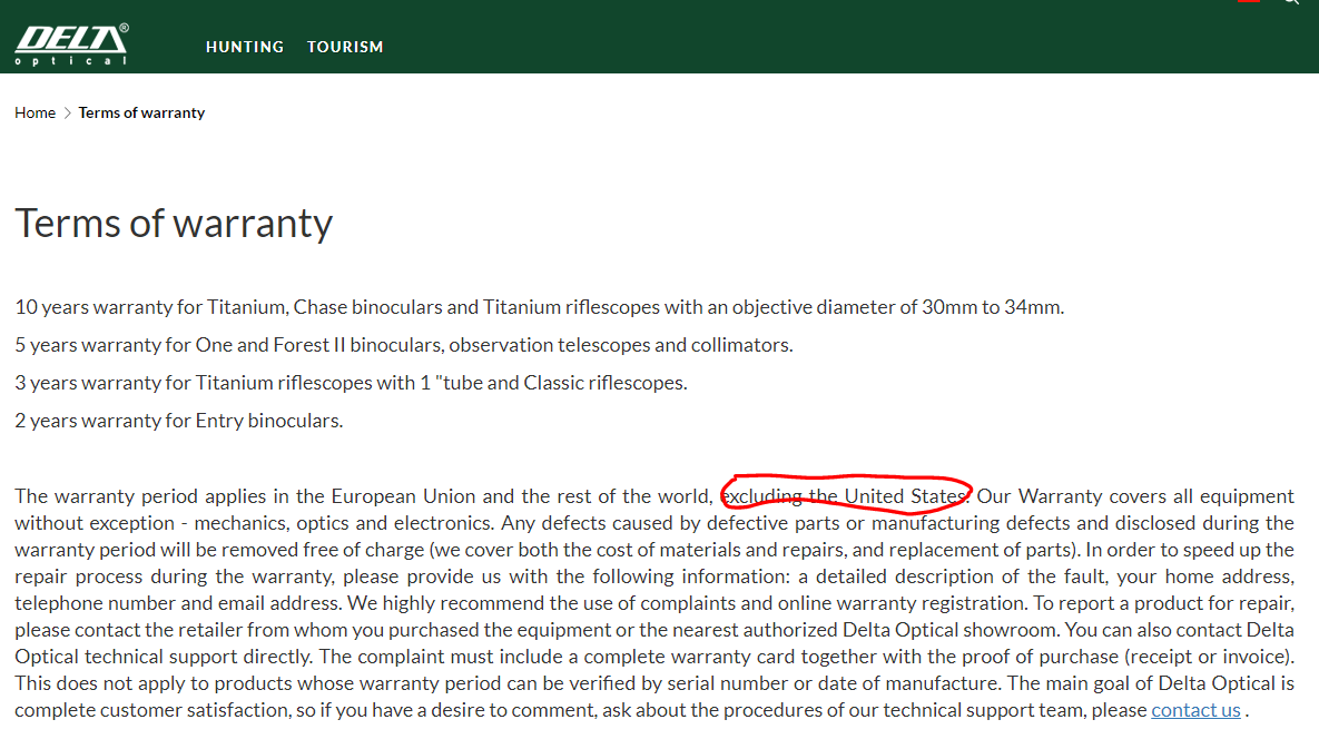

Is US not considered world?
Knowing someone with a Delta scope who had to have warranty work done, he had to work with his dealer who apparently sent it in. That could have been the dealer being courteous and it not actually being a requirement, but... the hell with that. I'm sending it straight to the company and not bothering my dealer. If I can't do that, then not interested. So hopefully there's a US warranty location for Delta. If there isn't, why bother buying one?

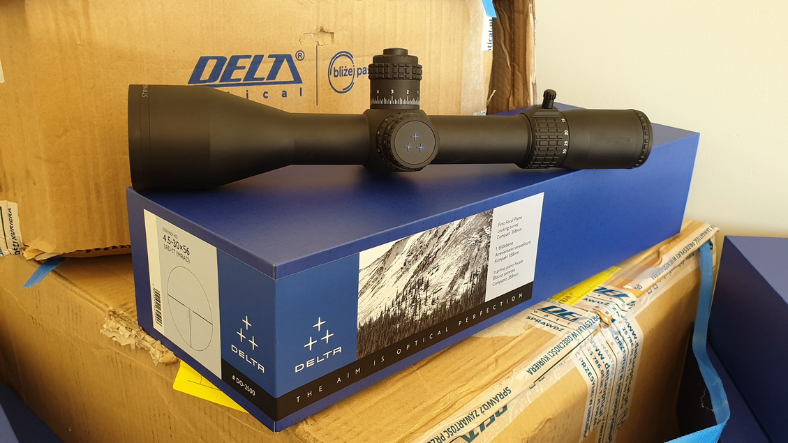

Since my regular glass-store is selling the Delta Stryker HD at a pretty good dicount I could not refuse. Its the older generation with non locking turrets and the DLR-1 reticle, and I figured it would suit me just fine.

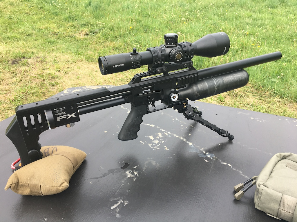

Right as it is, it is bolted to my FX Impact PCP rifle, with a Spuhr ISMS mount. When the competitions starts up again after all the Corona crap, I plan to move to scope over to my TRG22. I have had a few high end scopes like Hensoldt, Razor G2, Schmidt PM2 and a few others and looked though and fingerbanged a whole lot more of them.
Anyways, this will be more of a first impressions type of deal, take it for what it is.
Out of the box,
The scope comes with some tools, a "cat tail", a battery, a bikini lenscover and a sun shade. Pretty much what you are used to seeing in the box. I have added a pair of Vortex Defendor lens covers to it, since the picture above was taken.
Fit and feel,
The scope feels good in general. The finish is excellent. The turrets are a bit mushy, not terrible but kind of on par with Nightforce NXS, and no where near the awesomeness of S&B. The parallax wheel is stiff as hell out of the box, smooth, but still extremely stiff. It has loosened up a bit after I cranked it back and forth a lot of times. I am sure it will get even better with time. The included "cat tail" for the magnification ring is a nice touch. The elevation turrets markings seems to be a smidge of center, or maybe its just me needing new glasses. The zerostop is super easy to set.
Glass,
The glass is good. Very good. As you can guess I have only shot with it out to 100 meters, but I have looked through it out to about 300 meters on my local range. There is very good contrast, good definition, but a pretty shallow depth of field, so proper parallax adjustment is key. I hardly get any CA at all, and to my eyes, the glass is well above the Vortex Razor G2 4.5-27x56 and not that far behind a Schmidt 5-25x56 PM2.
Reticle,
Very well thought out and designed. I feel that the later versions of the LRD guys reticles are less intuitive, but thats just the oppinion of one.
Time will tell. But for the price I payed, its an awesome scope for sure. I plan to run this for at least a year or two. We will se how it works out.

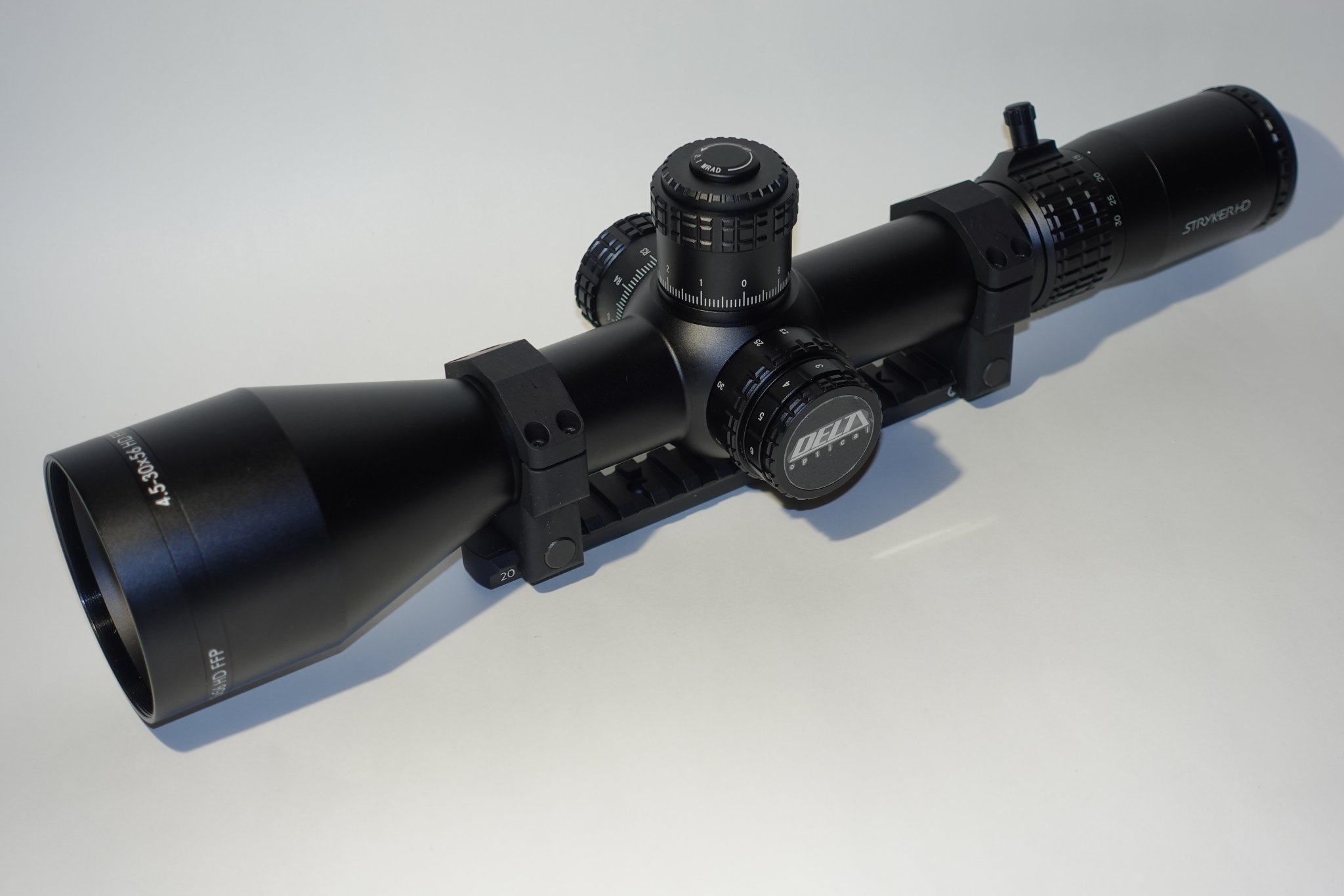

Looks like Delta has had a facelift.
Quite like the matte finish and new look.
Turrets seem to have different hash marks and the illumination dial sports the new Delta blue stars logo.
Gen 2 for comparison

Well the warranty part sucks I never saw that when I ordered mine , also it may be on there never really looked , but so far I have not needed it thank god and I own two of them except the 5x50 's.
