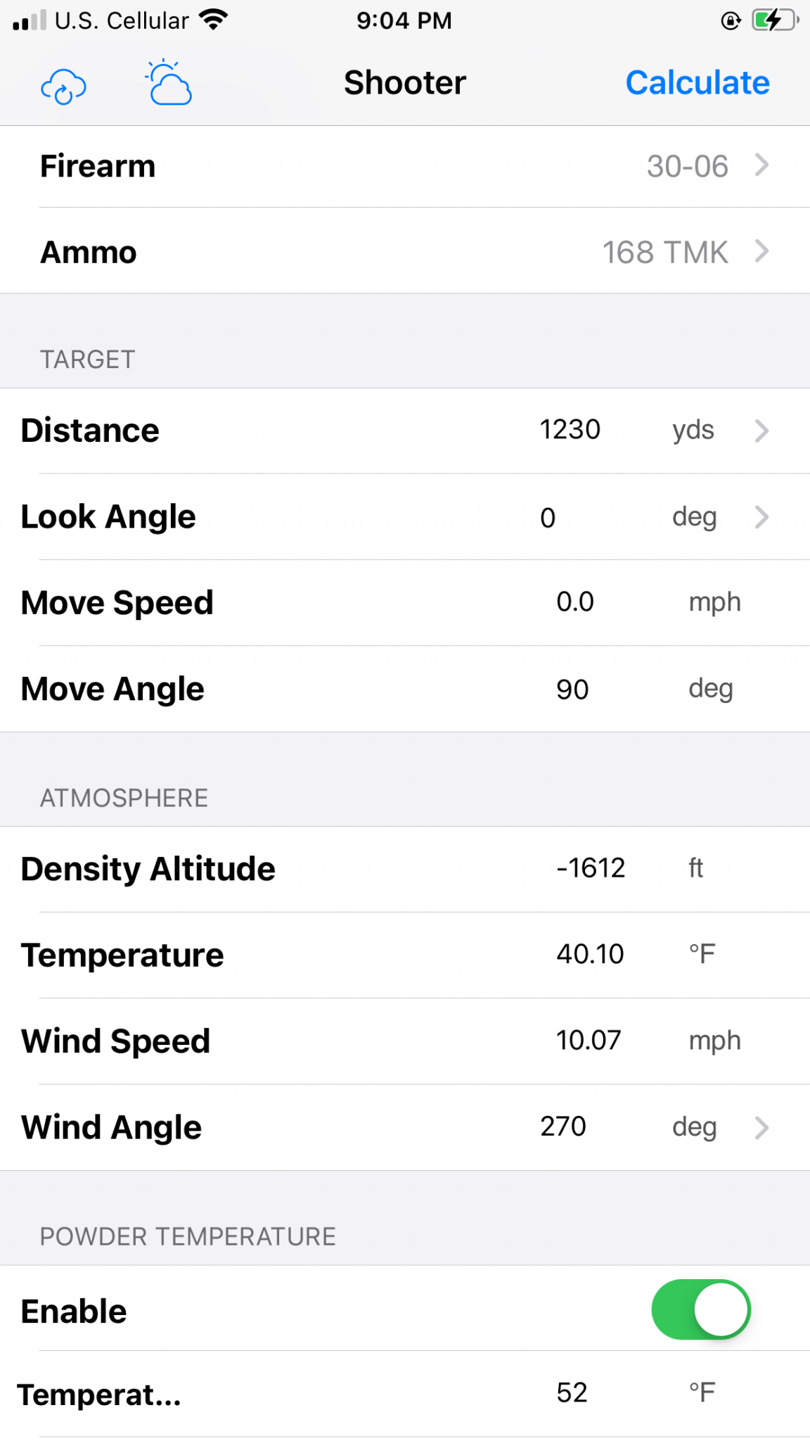

out here in coastal NC I’ve seen it as low as -2000 during winter
Right now: 1FA2DE3F-5FAE-48F4-A20A-E862EB3D840A.png
