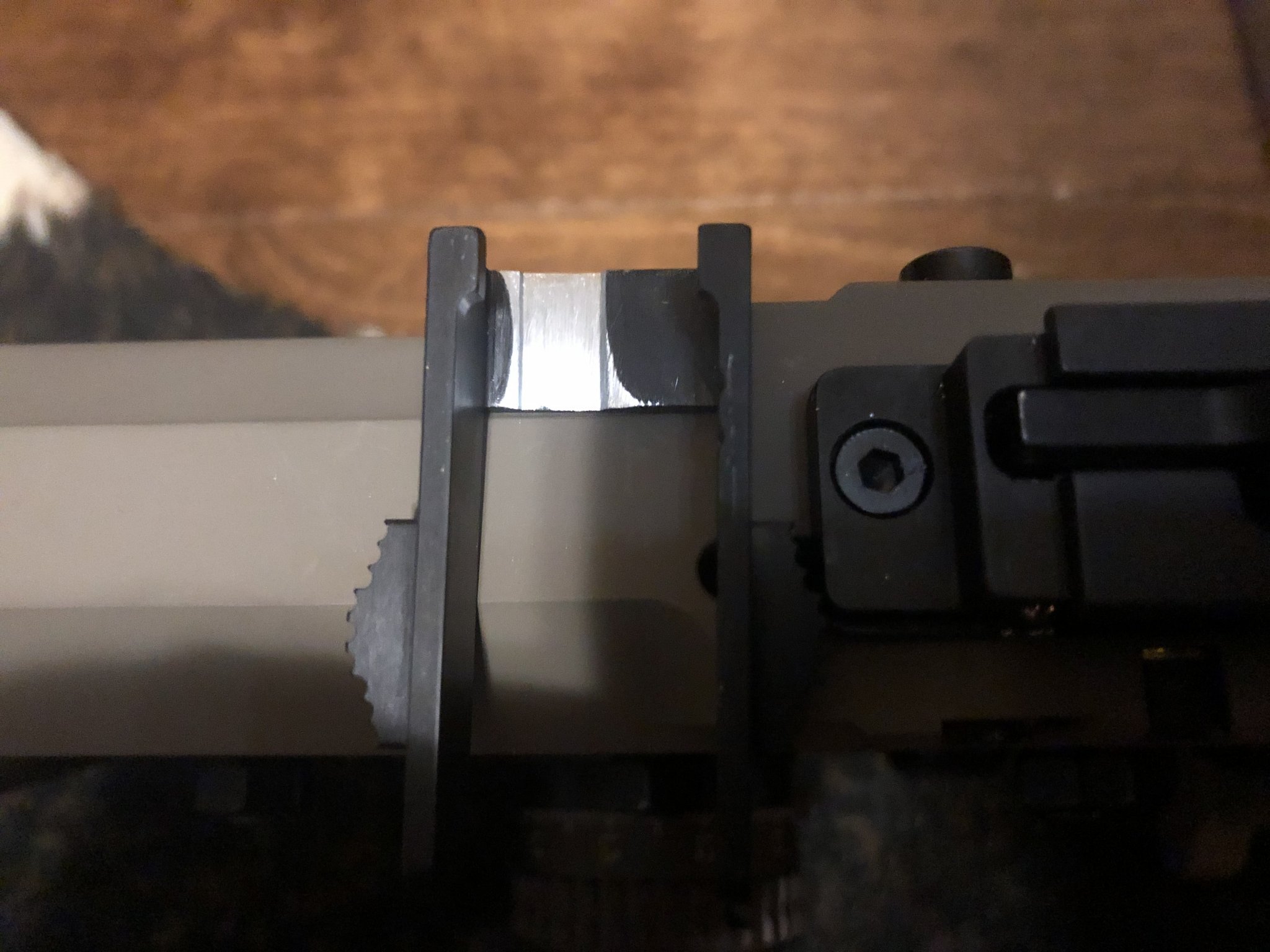

I read about the Orkan mod in this thread. For anyone that has done it, is it a substantial difference. My trigger has quite a bit of creep and the creep adjustment screw is as far in as the safety will allow. It’s serviceable but if it can be improbed then I’m all for it.
Never mind. I adjusted the creep screw until the trigger dropped and backed it off 1/8 round. The safety doesn’t work now but the trigger is excellent. I just need to get in there with a file when I get time and fix that. This mod is a no brainer.
Reactions: deersniper
It makes the trigger sooooo good. Just go slow with the file so you don't remove to much material.
I got it done. Didn’t take but about 15 minutes. It’a a necessity as far as I’m concerned.
