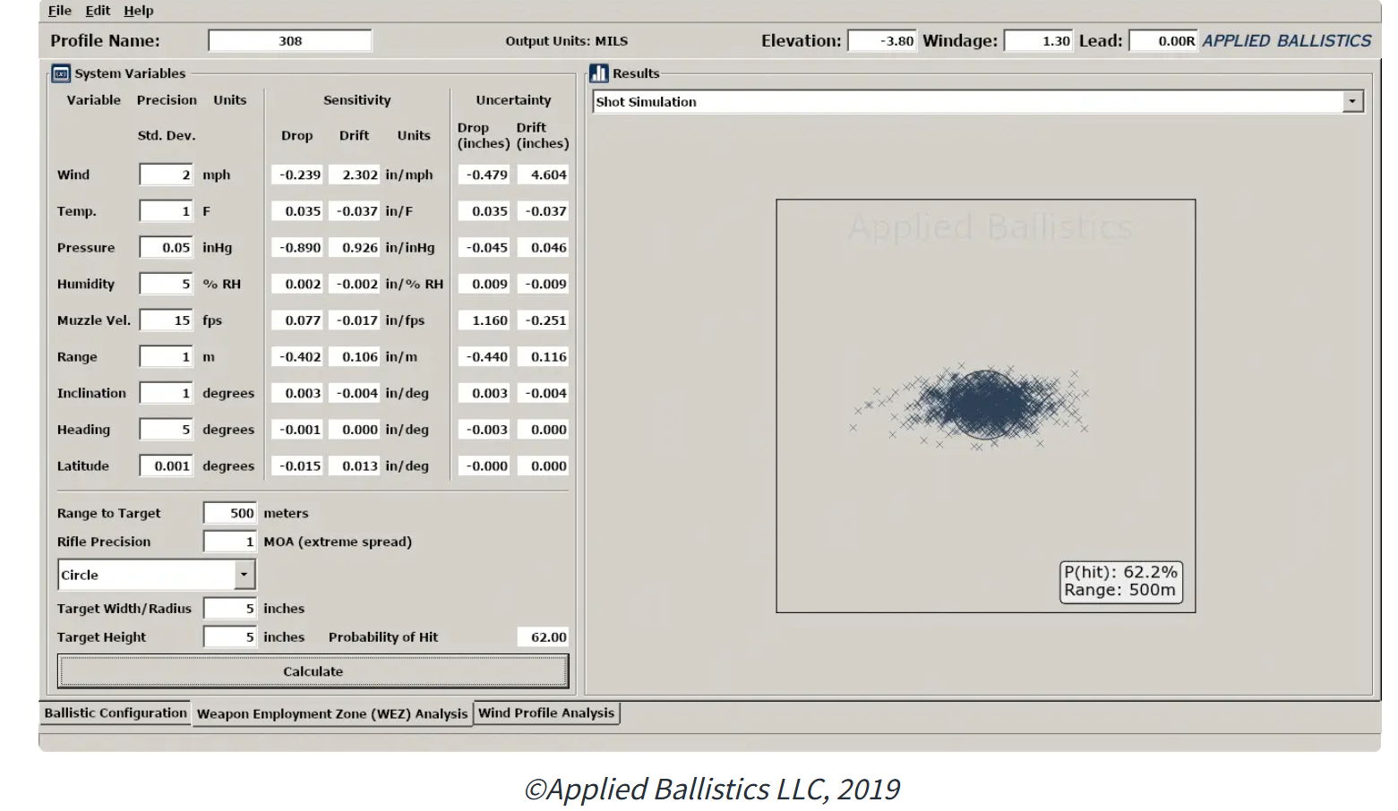

OP (@PRCslut), check out this video, this is how most folks are finding a specific gun number (or wind number, cartridge coefficient, whatever) for their specific rifle & ammo:
You will need to chrono your rifle and then build a profile in a ballistic solver (AB Quantum, 4DOF, Strelok, etc) to accomplish this.
