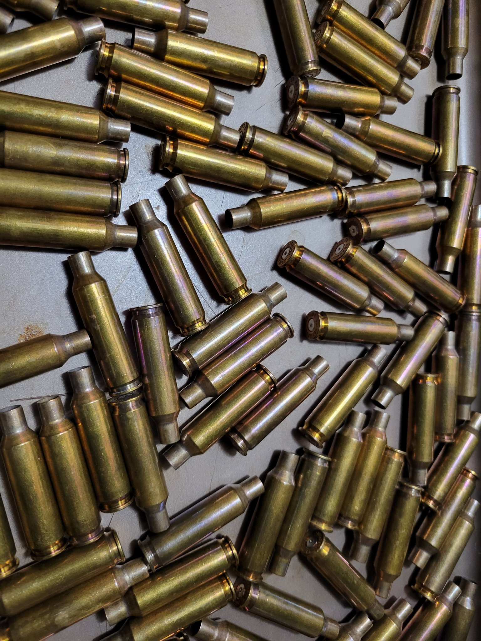

Hello everyone!
New reloader and I cleaned my brass by hand shaking it in a plastic jug filled with about 75% water 25% white vinegar, baking soda and a bit of dish soap and hand shaking it for about 15mins and then after rinsing them really good and getting the water out of the inside of the case (mostly) putting them in the over @350 for about 20mins to dry.
I didn't notice any blue in the water which I know is a sign of the vinegar leeching the zinc out of the brass but when I pulled them out of the over they kind of have a rainbow hue to them.
do you think they are ruined?
You clean brass like me. I use a 5 gallon bucket and pour boiling water over it with dish soap. Let it sit for a few minutes and then shake it around. I don’t put it in the oven though. I just shake it out and leave on a towel overnight to dry. My brass isn’t shiny but its clean.
I think your brass is fine BTW.
Good to know thank you!
Water and brass is not an advisable mixture since you have no idea what is in the water unless you use demineralized water. I know plenty of people use it but from a generic perspective it is not a good idea. The water you leave in the case that evaporated in the oven leave behindd concentrated deposits in the case.
. . . especially if the water is high in calcium (just looks at home water fixtures to see) ;)
Reactions: RTV

Yep trash
Reactions: RTV
What are the negative consequences?
They can range from simple calcium deposits to dezincification depending on the chemicals involved. In addition if pins are used the brass can (MAY revised per @straightshooter1 comment) work harden. It also removes the oxide coating that exposes bare metal which increases the likelihood of what is described as cold welding between the neck and bullet.
The OP has made an attempt to limit some of these issues by adding vinegar and sodium bicarbonate to his "soup" which is not necessarily a bad idea but without knowing what is in the water you don't know what the pH will be or other potential issues.
Many people wet table with pins. Whether or not it affects brass life is a hard issue to address but there are cases of issues. The engineering approach to the wet tumbling question is what is gained by doing it as opposed to not. The general impression is the inside of the case is cleaner and the primer pockets get cleaned. It is true that the inside of the case has combustion products cleaned but with current powders and primers these products in a dry state create a surface coating that has no detrimental effect on the brass. Properly cleaned with dry media it is simple a light surface coating.
The discoloration of brass in the OP's case is tarnishing/corrosion of the brass. It probably is not an issue. The different colors come from differing corrosion deposits due to the varying hardness along the body of the case.
As a sidelight to issues with brass the British learned a very hard lessen in WWII. They stored ammunition in barns in India. Of course India has a monsoon season and often gets more than 100" of rainfall. Being high humidity and with ammonia present in the barns from animal waste their brass cased ammunition became extremely corroded and unusable. There is a lesson here. Don't store your ammunition/brass near where you use ammonia based cleaners!
They can range from simple calcium deposits to dezincification depending on the chemicals involved. In addition if pins are used the brass can work harden. It also removes the oxide coating that exposes bare metal which increases the likelihood of what is described as cold welding between the neck and bullet.
Let's be clear . . .
Tumbling with pins or any other media does NOT "work harden" the brass; not the way some people think of it, for sure. Rotary tumbling does do some hardening on the surface of the cases, but it's only maybe a few nanometers of that surface, not enough to have any concern about any work hardening effect. And I might add, it's not really the pins that do it, it's the cases themselves tumbling against each other that's produces enough force to do that little hardening of just the outside surface.
Otherwise, you've made some excellent points. :giggle:
Reactions: RTV
Calcium deposits are easy enough to see (like what people often see around their faucets as the white course build up where there's a leak). IF you can see such deposits on your brass, it can produce issues with sizing or seating bullets. But if one is tumbling with steel pins, I can't imagine there ever being such an issue. Without pins or any media to work on the inside of the cases, a build up can occur in the flash holes and other interior surfaces as hard water from the tumbling is dried, which can effect ignition.
Reactions: RTV and Doom
You are probably right. I'm much more familiar with austenitic and ferritic steels which actually can use peening to stress relieve surface stresses from machining. How it plays into a cold work issue with brass is something I have not been able to determine. But if it does it would tend to be surface hardening. Far different from forming or bending the full thickness of the material.
Reactions: straightshooter1
