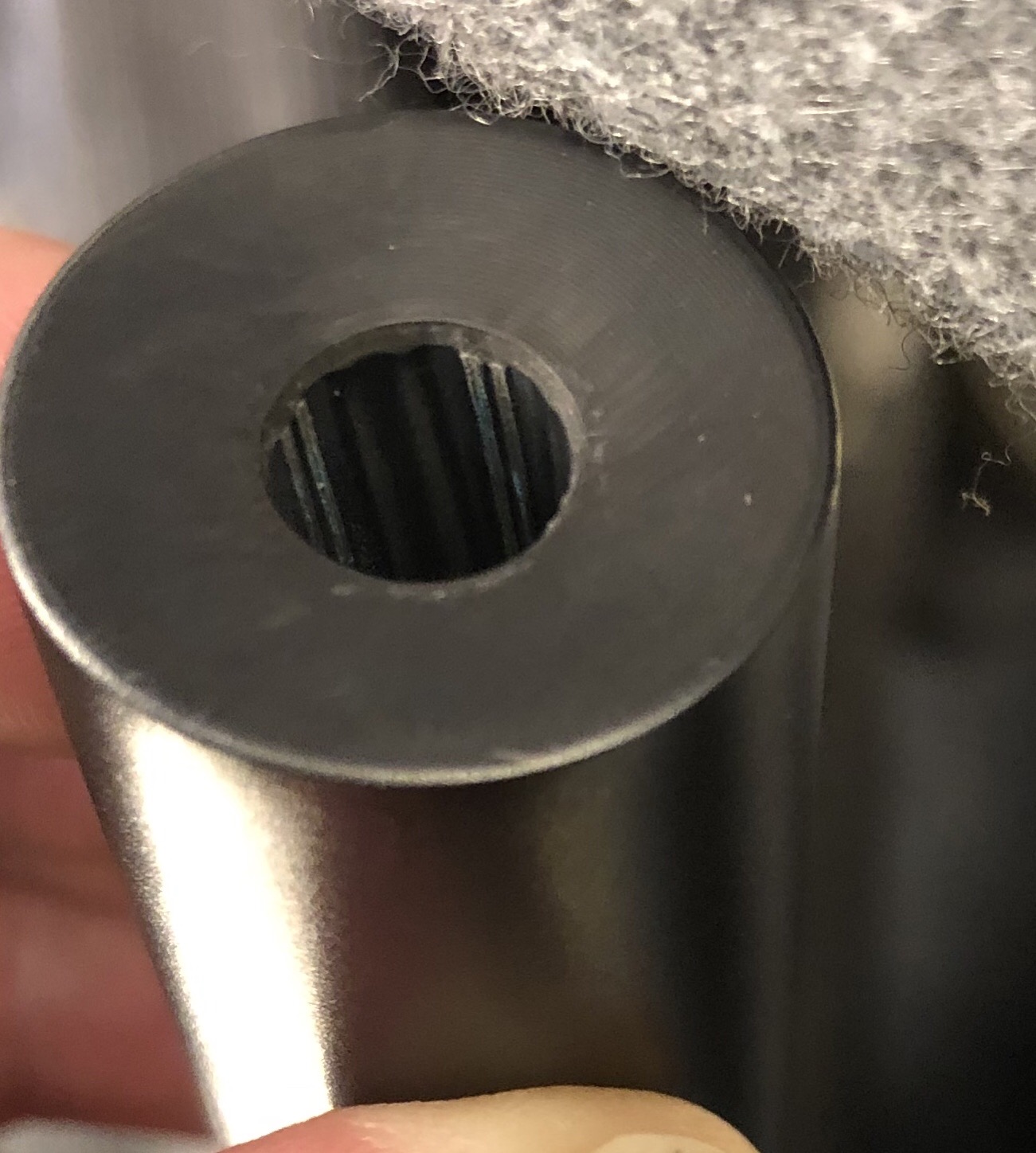

Sent my barrel out to get a brake installed and barrel threaded.
It comes back and now shoots 4in groups at 100yard.
Previously was about 1.25in groups with a bone stock factory sako a7 30-06.
But check out the chamfer on the end of the barrel. It looks like he put chamfer there on purpose.
For the life of me I cant recall if it was there before.
Does Any body have a sako a7 barrel to compare this to?
I don't see anything in the picture that would make expect that the gun would shoot that bad. There are many OEM companies that do a chamfer like that at the crown.
My first thought is the scope likely had to be taken off and re-installed in the process of threading. Maybe something didn't back on tight. Check the torque on the rings and mounts.
Also, it looks like you had a brake on it when you shot it. Did you shoot it without the brake on to see if the brake could be the problem?
Reactions: redleg1013
Once i got it back. It was 7 inches left.
Dialed it in best I could to 0.
Best I could get was about 4in groups.
Took the brake off. And its still shooting like shit.
Also It almost looks like there is a burr edge at the end of the lands.
Although I cant feel anything with my finger nail or little pick i used to check it.
But it sure looks like it in the pic and the little bit of galling on that chamfer looks terrible.

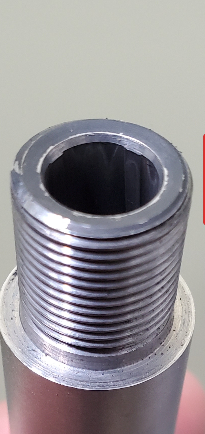

I'm no gunsmith, but compared to my Vudoo barrel and Krieger/Compass Lake Machine barrel the machining isn't ideal. Crown should be 11* with a very light chamfer at the bore and the section between the barrel and muzzle threads should be slight undercut.
Here's the stock crown on my T3x Varmint in .223. 11* with a slight chamfer.
Here's the Vudoo.
Inspecting with a bore scope may give you some insight. All reassembly methods and optics/ammunition related variables need to be confirmed. If barrel length was changed that could be an issue if the factory barrel blank muzzle length is cut base on a choke point.
I wanted to have my T3x threaded for my .30 cal can but it shoots so good I'm afraid to take the risk. It's a slippery slope.
1. That is the typical sako crown . It is unlikely he changed it.
2. This is most likely your scope being loose. Check the base if he took it off, which some lathes may have required.
3. Retorque your action on the stock and see if the barrel is now in touching.
4. Use a Teslong bore scope and check for interior damage.
5. Ask if the barrel was removed from the action - it may not be torqued back on right.
sorry, i guess i am wrong and will defer to you. it just doesn't look like anything factory in my armory. this didn't look right to me.
Most factory muzzles come with this surface feature. 45 Degree crown or a ball crown is what it’s commonly referred to.
Used to be ground with a crowning ball as it leaves no burr when done right.
The feature you see here that doesn’t look right is probably carbon from the bullet uncorking - it has a non-metallic texture in this picture, but this isn’t a great picture so it could be damage.
Better rifles (custom and semi-custom) typically come with the 11 degree crown shown in the pics above. Many of those also have a small chamfer there to eliminate the burr at the bores edge.

Possible cause:
Machinist turned the threads between centers. The 60 degree center only contacts the existing 45 degree crown at the smallest point of the taper. That being the lands. The pressure of the center on the small contact point, and threading operation has pushed a small amount of metal into the bore.
Look at the enlarged image theLBC posted. See that line at the junction of the chamfer and the lands? That would be the potential contact point of the center, and the chamfer.
Looking at the photo it looks like there's a tiny lip noticeable on the edge of the land visible on the right hand side of the photo (the enlarged portion). Take a q-tip, put it into the muzzle and pull it back out again, look to see if any spots around the chamfer catch fibers from the q-tip. Take a rigid, but softer than steel tool (brass, copper, plastic) with a sharp edge, and drag it gently from inside the bore out over the chamfer. Feel to see if there is a lip or ridge there.
As stated by the delicious Russian drink @Vodak (close enough to vodka), get a cotton tip (q-tip) and insert into the barrel, and hold ona a side and drag it out. It should not catch on any burr or imperfection. If it does, it will hold a little strand of hair and show you were the imperfection is.
What Vodak said.
Likely that your machinist ran the muzzle threads with the muzzle pushed into a live center.
That would have been the fastest way for him to set the barrel up and sorta, kinda cut threads that are sorta, kinda concentric with the bore.
I would not count on the Q-tip trick detecting damage even if it is there. If the live center rolled a bit of a disturbance at the edge of the muzzle, it would likely be smooth and semi-uniform enough to evade the Q-tip thing, yet the problem still exists.
Not all machinists are savy to correct handling of rifle barrels.
Not all gunsmiths are savy to correct machining methodology.
Best results come from the proper blend of both disciplines.
Judging by the last .100" or so.....the barrel has bell mouthed at the end. If you know anyone with precision ground gage pins.....this is an easy check.
I disagree with the "Re-cutting on a live center is bad"...….but you want to use a little grease on the nose of the live center (and use a quality live center....not chicom junk) and I like to take a skim pass before final assembly with a piloted form to leave perfect edges.
Indicating is a great way to make sure you are spot on......but it comes with measuring error. In my opinion and experience their is a big difference in measuring bore run out over a muzzle thread span (approx .600") vs 2" plus when chambering.
If you don't believe me.....take your .0001" indicator (actually .0002+" with 1.5" tip that most use) and solve for pure measuring error across a span of a 26"+ barrel. In this perfect scenario......it is common to get .020+" of bore runout (actually measuring error) at the muzzle end. This scenario also assumes you indicate the bore over the span of the cartridge EXACTLY......which never really happens......the needle always has a slight heartbeat.
And Grizzly rods......that's a whole 'nother story......I use them to get close but that's it. It's like sorting bullet diameters with calipers........
Just my $.02.......but I don't know shit about fuck.

Crown looks good to me. Probably cut with a center drill. I cut all my own crowns flat and break the edge with a sharp high speed steel center drill. I do 11 degree crowns, recessed crowns of all sorts. I haven’t seen an accuracy difference and I like the way I do it.

That's not a common precision crown. Typically precision crown is around 11 degrees. Reference Sieg's picture posts above. Doesn't look very uniform. ....buggers at 10 and 1 o'clock. Light reflections indicate roughness, lack of precision.

The size of that chamfer is IMO excessive and looks galled unless that's some carbon buildup. Look at the first 1/2" of lands to see if there are concentric tool marks as if he used one of those solid pilot chamfer tools vs. a turning tool. Concept of stress relieving and getting bell mouthed is interesting.
So what was the outcome on this?
I don't recall seeing what the thread size is nor what caliber it is. Not that it would make any significant difference other than this...
Is indicated above, when you thread a barrel and remove material the mouth can Bell out. This isn't a function of the barrel maker nor the gunsmith. That material that was removed previously was basically holding that Barrel bore parallel. Does it affect accuracy? Absolutely not. Will it make a difference between what load you can develop today versus the load that you had previously developed ... probably.
The good thing is that it's really easy to fix. If you have your appropriate gauges you can simply torque your muzzle brake to push it back in parallel.
That said, I seriously doubt that's the issue. But it seems on so many of these shooting forums there's an excuse for everything...so, maybe.
Personally I think if the barrel was separated from the action that it wasn't properly indexed / torqued properly when reinstalled.
Or, maybe it needs to be renowned.

A live center in the muzzle can cause that. Lots of gunsmiths thread that way with no regard. Some fix it afterwards with a cleanup pass on the crown, some dont. But that requires proper indexing of the barrel. And if they threaded it with a live center, they probably arent going to dial it in for the crown either and will just use a 3-jaw :cry: .
As already said, do the q-tip trick. Also look and see if the rifling is flattened at the very end from the pressure of the live center.
(Also try shooting it with no muzzle device and check the group. Sometimes it the brake)
