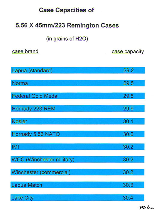

This is simple , if you have a .223, load using .223 recipes, if you have a 5.56 you can use .223 and 5.56 load recipes. Case external dimensions are the same for both, the difference will be the internal case volume . Lots of myths and downright BS about internal volume , only way to know is to measure .
That depends only on the brand of brass used.
As a general rule, military brass tends to run thicker walls than civilian brass giving a smaller internal volume. But that is not a hard fact, and in any case one can load to 5.56 CIP pressure with civilian brass.
The bottom line is that the differences are ALL external to the cartridge itself. The differences are all in the maximum average pressure and in the chamber dimensions.

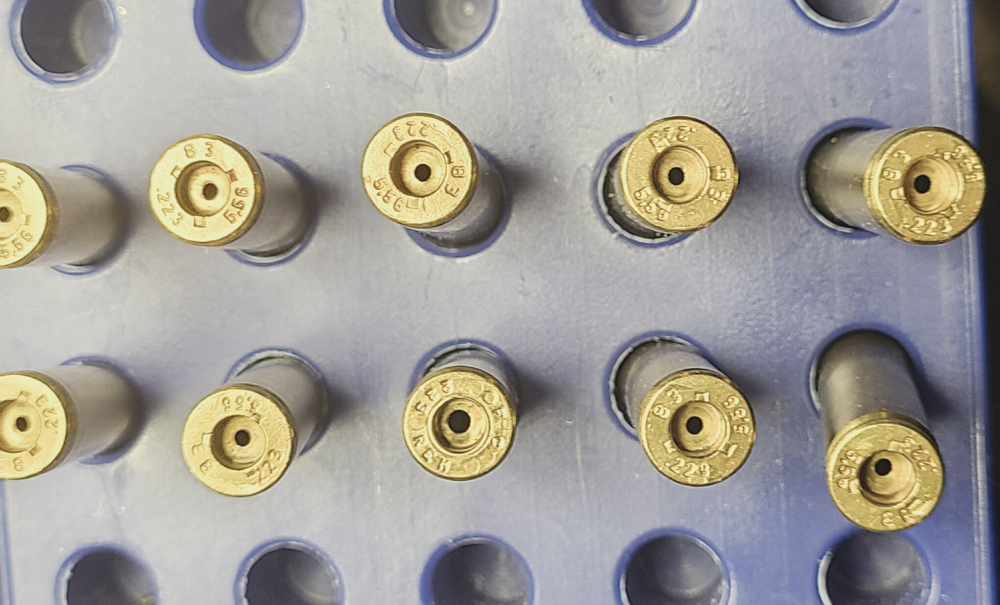

Yes, I have searched most other threads but never found the direct answer to my question. I guess my question is this...... when you full length size a 5.56 case, does it then become a .223 case? Also, if you only size the neck rather than full length size will the case remain a 5.56 case? Or, is the difference between .223 and 5.56 only in the barrel chamber and NOT anything to do with the case itself?
Dimensional specs for 5.56mm and .223 cases are identical.
Both tend to have similar capacities with variations being due to manufacturer rather than 5.56 or .223 designations.

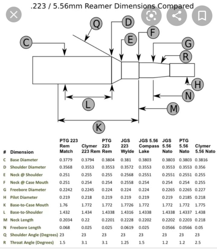

223 and 556 chambers are different. 556 chambers are larger. This allows the 556 round to be hotter. 223 chambers are tighter and the max pressure ceiling is lower. You can shoot 223 in a 556. The velocity will be lower because the larger 556 chamber will cause the 223 round to develop less pressure. But you should not fire 556 in a 223 chamber because the tighter 223 chamber will cause the 556 round to exceed the max pressure and you might have pierced primers stuck cases etc.
Reactions: acudaowner
That all depends....
I agree that in general the 5.56 will have an extra thou or two of space for fouling etc to ensure reliability and of extra freebore for the same reasons and used to be generally heavier and thus longer bullets.
These days with people tinkering and optimizing reamers and Wyldes etc and brass sorts there isn’t a whole lot of beans worth in difference. Keep your brass sorted to like lots and start low and work up.
