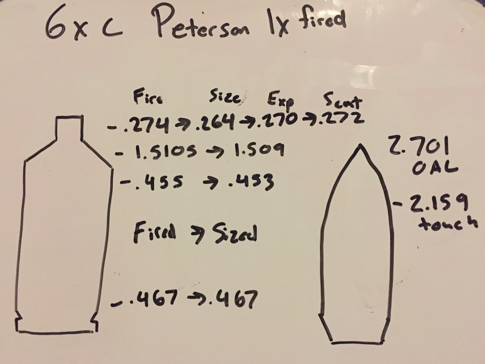

Measure the tight fitting cases in all their diameters, headspace length, and overall case length, and compare that to a properly fitting case. The point of interference should show itself. If you aren’t able to measure properly, mark a sized/tight fitting case with a sharpie and chamber it. Carefully extract and look for areas where the sharpie rubbed off due to interference.
Reactions: AIAW
Take these measurements, like they said above, it should reveal itself

Most reloaders on the hide are going to measure their brass with calipers and comparators. That is the only way to actually ensure that your rounds will work in a safe and reliable way. Blindly following the instructions that comes with the die is a good way to get yourself into trouble. Just because the press cams over does not mean you are getting a proper size. I have had to remove material from the bottom of a Forster die to be able to properly bump the shoulder on my brass.

Like supercorndogs stated, the OP has to provide the measurements for us to really know. These things are rather difficult to diagnose otherwise because of the number of variables.
