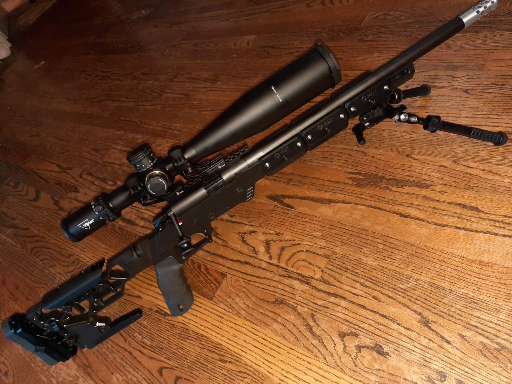

I had a Vudoo Gen 1 mounted in an MDT LSS Gen 2 Chassis. I also put my Bergara B14R, early model with the
square cut in the bolt, into the same chassis. I never had any trouble with the Bergara in any way either in
the factory stock or in the LSS chassis. I ran the polymer and aluminum magazines in the Vudoo and the gun functioned
flawlessly in every regard. I'm not a Vudoo or Bergara fan boy either. I simply never had issues with either gun
in terms of function or operation. IE: Never had FTF, FTE, Mag issues, stove pipes, etc. Both guns were really very nice.
My B14R was steel and cost about $975.00. The V22 was $3300.00 as shown below. Not counting the Trijicon 5 - 50 x 56
scope. That was about $2600.00 at the time.
As far as loading the mag into the chassis, I never had any issue with them either. They pushed in and dropped out.
