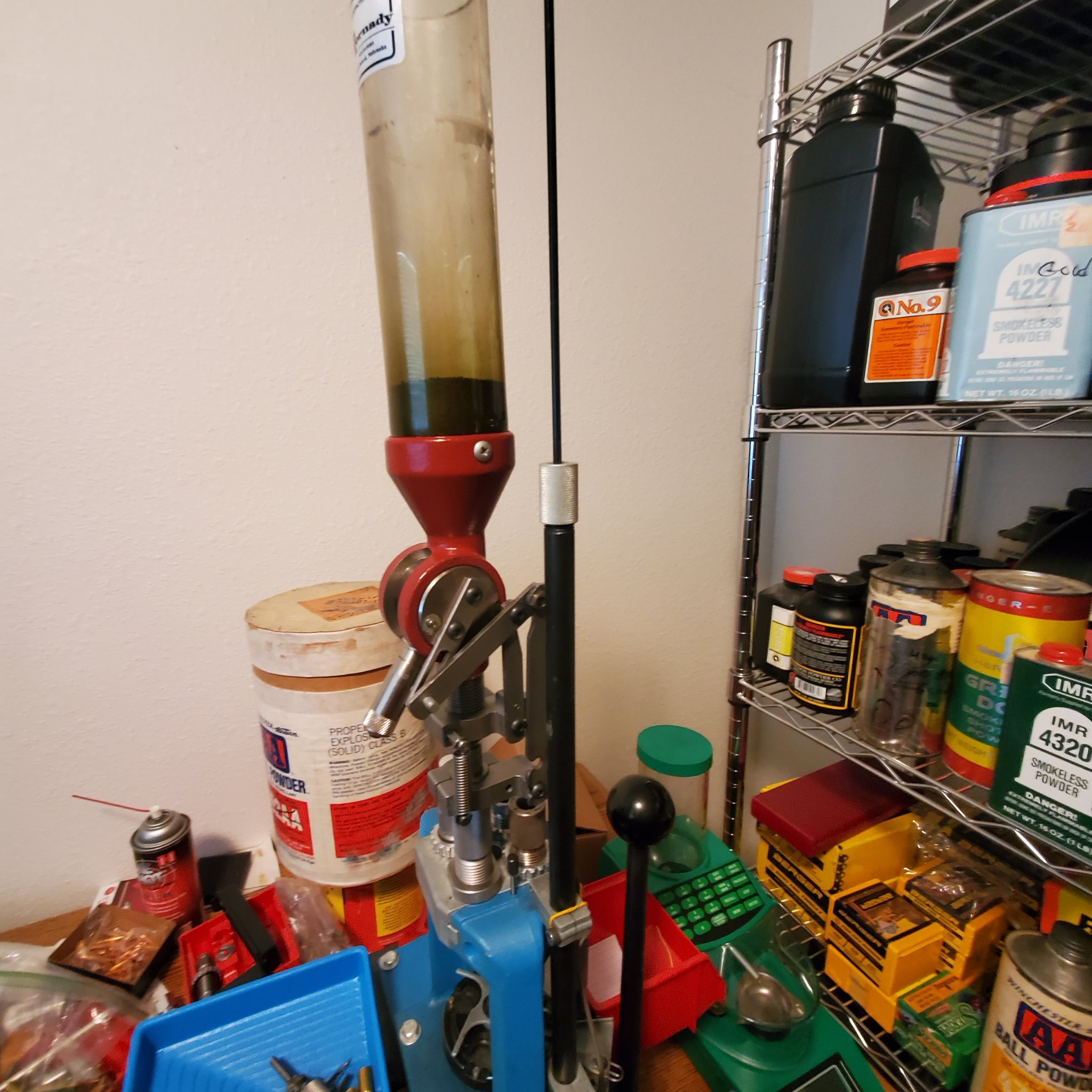

Here is a picture. Hornady makes the linkage to turn vertical motion into rotary motion. I have quite a few set up on Dillion tool heads.
Started using this setup around 40 yrs ago.
I used it for Varget and the 308 with Lapua 155 gr. Out to 1400 yds, 17,000 rds, before changing the recipe.
Not weighing every charge, but running the Dillion with a smooth rithum type moderate to slower speed. Any stoppage requires one to weigh the charge....I had excellent results.
