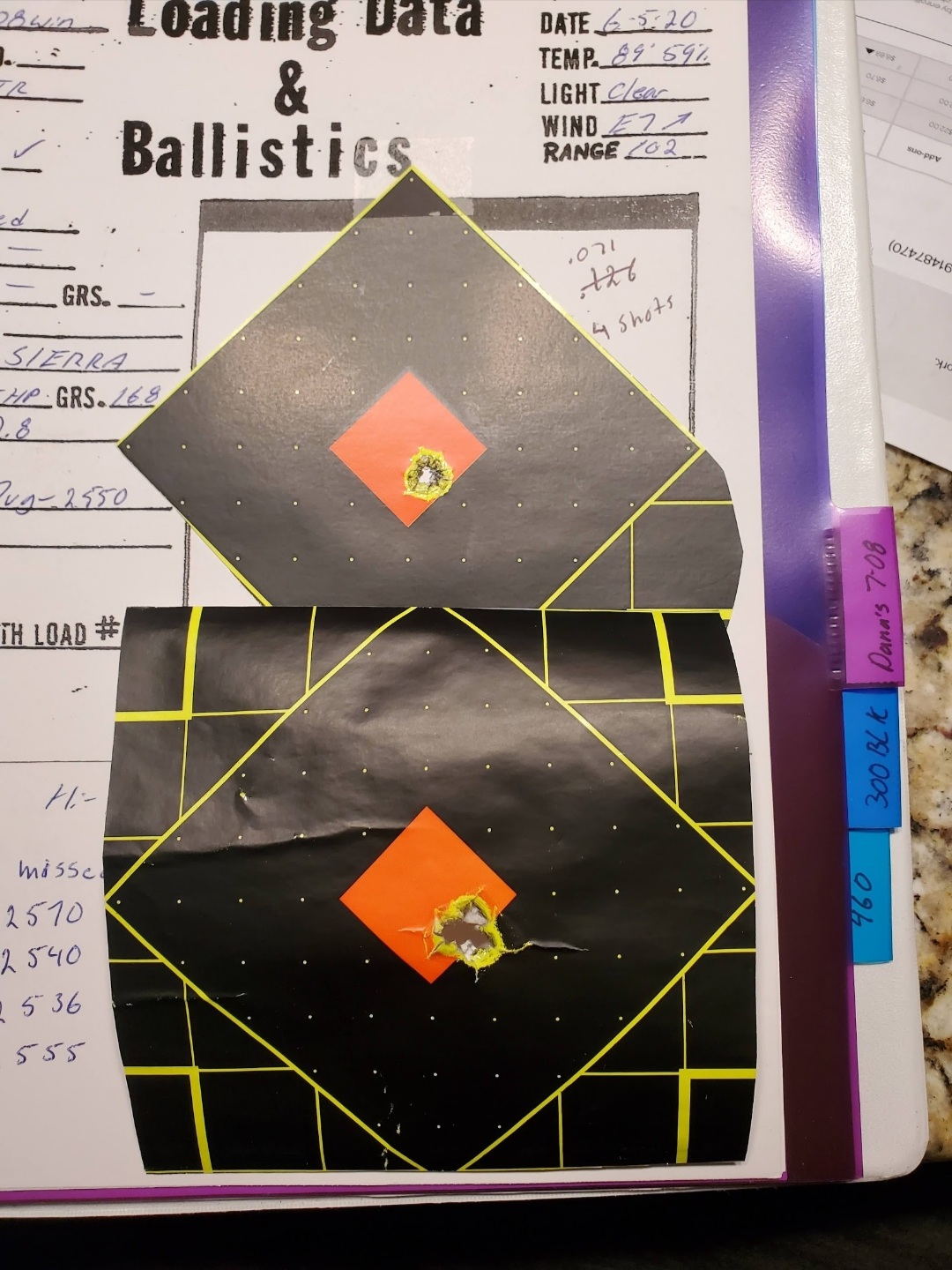

I've seen no issues with accuracy or repeatability with the asr brake and my omega on my 308.
These two groups are a year apart. Can had been off and on a few times. Top group is only four shots. First shot was a sighter after mounting the scope. The bottom group is five though.
I do have an issue with mine coming loose at times. It was stuck bad one time and was getting down on it pretty hard trying to break it loose. When it came loose I got on the locking collar some how and damaged a couple teeth on the collar and the brake itself. Never had a problem before that though.
