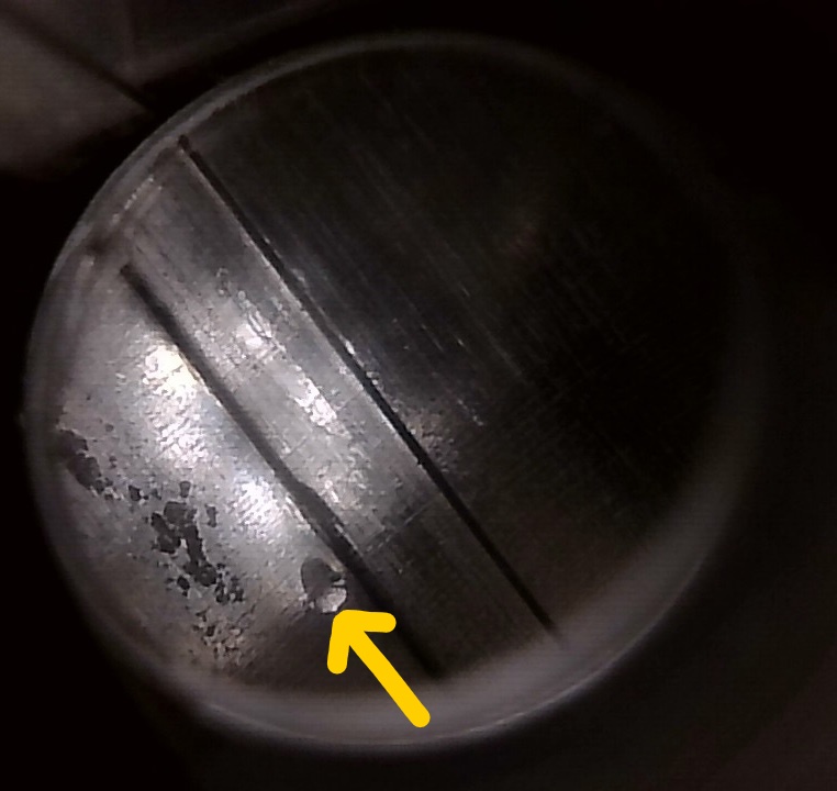

    So I bought this new bore-scope...
    And I found at least 2 of these little divots/pock-marks in the grooves of my Remington 700 .308. Just curious...anyone seen this before? Seems like it shouldn't be a 'normal' feature of a barrel.
    Barrel has just under 1000 rounds through it. What would cause that? I don't know if they affect accuracy much, but they sure don't do much for confidence.
    In my experience with (probably) the same borescope, there is a correlation between barrel price tier/purpose and flaws / machining marks in the bore such as what you see.
    I've seen zero such marks in my Bartlein and Vudoo/Ace barrels.
    Conversely, I put the scope in the barrel of a well-respected AR manufacturer's SS barrel mounted on a $1500 rifle, which holds consistent sub-MOA groups with match ammo. I was astounded at the cuts, chatter marks, and gouges. The rifle is built and marketed as a high-quality 3-gun/CQB/patrol platform, not a match rifle. Yet, it shoots doggone near match-rifle groups, despite the comparatively chewed-looking bore.
    So, I can comfortably say from experience - if your rifle is accurate, or isn't, that little divot has nothing to do with it.

    Go take a look in a good shooting Remington or savage barrel

    Obviously this cheap 700 barrel ain't a Bartlein. If it shoots to your expectations then just keep firing away.
    Yeah, it shoots fine. I was just surprised - had never seen anything like that. The bore-scope shows all...

    If you’re having issues a borescope can help diagnose them. Evaluating your cleaning routine, your borescope can help determine if you’re doing the right thing.
    Judging a gunsmith’s attention to detail and machining skills, the borescope will help (mass produced barrels may have chatter due to worn tooling or running at too high a rate for the fixturing or machine, but custom barrels like this are just sloppy work. They may shoot fine, but that doesn’t excuse poor worksmanship).
    Looking at a barrel that shoots great and seeing a flaw but not reasoning through potential impact isn’t good, though. A little chip missing out of a land somewhere in the middle of the barrel is unlikely to do a thing. Think about how the bullet is imprinting in the bore, and reason through what that little chip missing might do/not so.
    The throat matters, as does the muzzle/crown, but most of what you see in the middle, as long as it’s not a protrusion deforming the bullet, won’t cause any major problems. Tons of copper fouling or major defects can obviously cause an issue, but a little chip is unlikely to be causing any issues.
    PS - maybe I’m not seeing properly, but that looks to be a divot in the land, not groove. I also see a little deformation of the edge of the land. What do you use when cleaning? It’s more likely to be a manufacturing defect, but a steel cleaning rod or cleaning tool can do a number. It looks like something skipped there, or there was debris in the tool path.

    Yep seen em before. Seen worse in rifles that shoot pretty good. The worst barrel we have with that damage is a Winchester M100 308. It has been rode hard and used wet apparently.
    I was told the damage is caused by shooting the rifle with heavy condensation, or rain in the barrel. The theory goes that water is incomressible and the bullet sometimes doesn't displace the water but traps it where it 'explodes' against the steel and can blow a divot in it. I have heard the same re oil in the barrel too.
    Read something about this somewhere long ago too. The source I don't recall, but in an article I think. Anyways at the time I thought it was reputable and believable.
    I don't know if some steels would be more susceptible, or that this is even true. If so, H2O seems more likely than oil to do it.
    Regardless, wether it was made that way (seems unlikely) or not, the M100 shoots pretty good still, even after 59 yrs and many such divots. At least it's still minute of Deer (1.5 MOA) with the right combo, and what I use in the woods. I am keeping an eye out for a better one. Not to use in the woods, just to have. This one is still doing fine for what its used for.
    Maybe somebody here knows the truth regarding the theory. I would be interested in knowing the cause for sure. Even though they don't seem to be barrel life ending, not getting them would to be better if possible.

    A small pit in the lands/grooves mid-barrel will have negligible impact on the performance of the barrel. It's not going to deform or disturb the bullet as it travels down the barrel. If there were a raised burr, that would be a different story.

    At any rate, all kidding aside, on a more serious note, none of the previous posts are without merit. They all address poignant aspects regarding what we perceive as 'accuracy' when we shoot at a target be it paper, metallic silhouette, tin cans, milk jugs, etc.
    Ridge Walker made a comment that echoes what I heard/read some time ago also, something like the trapped moisture acts almost like a miniature plasma cutter. On a similiar line, but on a much larger scale, prop makers (boats) have to design their product in such a way that they are resistant to the effects of cavitation. The bubbles created by the spinning prop apparently 'explode' in close proximity to the spinning prop and create 'pits' in it. Not the same but food for thought.
    Several years ago at a match I was on the periphery of a conversation between Barrett Obermeyer, Mike Rock and John 'Jack' Krieger, who were on the ready line. Earl and Ken Liebetrau were on the firing line, Rudy Wadekamper and Norm Brux were in the pits and I was getting ready to score for Randy Gregory. The conversation between the three drifted in the direction of barrel finish and specifically smoothness of the bore.
    Both 'Boots' and 'Jack' acknowledged the importance of minimal tool marks in the drilling and reaming of the hole as well as the rifling, but some degree of imperfections were inevitable. To what degree remains open to debate depending if you are the consumer or the manufacturer.
    They did agree on throat erosion being more of a concern as well as some type of defect regarding the muzzle crown. Even went so far as to mention one shooter (no-one I was acquainted with) actually had his 26" barrel rechambered and had it 'set back' a bit to get rid of the throat erosion. This apparently worked to some extent as that shooter went on to shoot respectfully at Camp Perry that year
    Mike said something like 'the bullet shouldn't have to travel the distance of the Verrazano-Narrows bridge to engage the lands' to which elicited a belly laugh from both 'Boots' and 'Jack'.

    Yep we all agree with that. I am wanting to 'know' why the pits appear over time. The root and or stacked cause(s).

    Most likely from a cleaning rod caused the single ding. The black stuff is either carbon or pitting from (very light) corrosion.
    Your lands are presumably .003-.004" tall. That divot is well less than .001" deep. The effect on the bullet will be an extra subtle scratch mark down the bearing surface of a bullet... And whatever you stir up in your head. ;)

    Yeah you'd be surprised. Something as simple as un-sticking a stuck patch can easily ding the bore.
    I'll take your word on it, but I don't put steel in my barrels. Others may use steel cleaning equipment, and it maybe the cause of some damage in barrels. Not sure that it would look like that though, but maybe so.
    Pretty sure very few folks are using steel cleaning tools these days. I doubt that nylon, aluminum, brass, or carbon fiber are able to put a divot in rifle steel, but I'm willing to have it explained and admit I am wrong if it is possible. It seems unlikely, but hey I'm always willing to learn.
    Once again I don't think that a few divots are an issue re accuracy, I was just honestly hoping to learn of their origin as I have seen them before too.
    Inclusions in the steel. Impurities that sometimes won't be seen in a new barrel but can burn out with shooting. Seen it in befor steel sako barrel and my rem 700 221.could not see it in the 700 until I'd shot it I don't know how many times.it still shoots in the. 3s.
    If factory Remmy barrels are still hammer forged I would say this divot was always present and you are just now seeing it. It's very easy to miss (or re-find) little spots with a borescope.
    As for the forming of the divot.....in mass production I could totally see a shaving or trash get stuck in the bore or on the mandrel and then formed around.

    ... I would say this divot was always present and you are just now seeing it. It's very easy to miss (or re-find) little spots with a borescope.
    I don't doubt it. They could very well have been there when the rifle was first unboxed back in 2013, and I'm just seeing them now. Looking down the bore with the naked eye, it looks perfect. But run that borescope through and it looks more like the surface of the moon (I exaggerate...a little)
    I divotted a barrel exactly this way. To add insult to injury, I probably could have caught when the round before hand hang fired by a fraction of a second. JUST enough to tell me something was different. That bead was in the flash hole, and behind the bullet. The NEXT bullet did the damage, and I should have stopped after the hang fire. Live and learn. Shot my best group out of that barrel AFTER that incident mind you, but it seemed unpredictable.

    First time my Shooting Buddy and I were able to borrow a Hawkeye, we were astounded at what was lurking inside our bores.
    A big part of it was that we were not shooting anything like premium barrels.
    But the point was, some of the worst looking ones were shooting the best. I flatly could not comprehend how my beautiful Garand could have such ghastly cross cuts and gouges inside and still shoot like an N/M gun, using basic M-2 spec handloads. But it did, and does.
    I think we were discounting the benefits of good load development, and also missing some very basic machining facts as they apply to barrel interiors.
    Now I have my own inexpensive borescope and use it frequently, but I now accept that most barrel makers' QC is good enough. It may not look so hot, but what I'm seeing and cringing about is apparently not that much of a detriment to actual accuracy as I had once believed.
    It renewed my admonition to look at my target, Stupid; and don't sweat the stuff I'd need to be a professional to understand in the first place.
    I shoot well when I do my part, and critiquing barrel machining is not part of that job.

    Ok now there are a few possibilities on the table. Here they are in the order they appeared:
    1. Inclusions, and a witness. This seems like a rational possibility. If this is the answer we have some really crappy steel being used for rifle barrels. Do the premium makers get divots in theirs? Wouldn't Magetic Particle Inspection testing find these?
    2. We go from trash steel to 'Trash on the mandrel'. Again seems reasonable. But some barrels must have had some really filthy mandrels to get multiple divots.
    3. Next is the ceramic ball from cleaning media blown into the bore and pinched by the next bullet. Again we have a witness. Yet seems unlikely to be the cause of all of them. OP fxdrider hasn't said if he used ceramic beads.
    and then you end up with a ceramic ball getting sandwiched by a bullet somehow down the road.
    4. Now we have a name to give to the wet bore-incompressable liquid theory, 'Hydroforming'. Sounds good, but no references. Can't find much on it any where. Which of course is the reason I asked.
    Moisture in barrel. Oil or water and bullet hydroformed it into the steel.
    Not saying the 'hydroforming' is impossible, just highly unlikely. What actually would that process be I wonder. Water turning to steam is pretty powerful, and theoretically its crazy powerful, but powerful enough to melt metal?
    I think "hydroforming" displaces metal......so it would go somewhere. Maybe a minor bump on the barrel exterior? Maybe cratering around the divot that gets eroded away with multiple firings".
    Regardless of the cause....shoot it until it doesn't shoot, then rebarrel. If it happens on the new barrel......re-evaluate ALL your current methods 😁
    Reactions: Ridge_Walker
    take your bore scope......and throw it in the fucking trash.
    for 99.99% of shooters, they are fucking useless.
    if you have a good shooting barrel, how the lands and grooves look doesnt matter.
    if you dont have a good shooting barrel, nothing you can see with a bore scope is going to make it shoot any better.....that one bit of copper fouling isnt fucking up your groups.....that one bit of carbon isnt fucking up your groups...
    people see a small imperfection in the bore and think that is the cause of all their issues......its not.
    The hydroforming theory is just a theory. I would assume that a bullet hitting a small droplet of water would more than likely deform the projectile, but if it somehow didnt it would most likely make a tear drop shaped divot as the water moved forward of the bullet ever slow slightly. More than likely the water of fluid would be pushed out of the barrel ahead of the bullet by the pressure of the air infront of the bullet.
    I'll agree with if it shoots, just shoot it.
    I mostly just heard about it from a benchrest shooter. I have hydro formed parts in the past, and seen some accidentally when I build liquid storage tanks. Fill em to fast and they bulge, drain em to fast and the soda can...
    With my bore scope I found the reason that a 22-250 sporter barrel was not grouping for shit was that the last 1 1/4 inch of the muzzel end was burnt out. Zero lands and rough as hell. I cut off 1 1/2 and brought it back in. I like my bore scope
