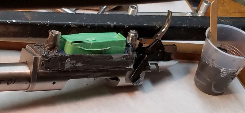

    Now ~ 40 rifles later, I make my own pillars and V blocks. I use Devcon steel putty so I will not have to fight time or gravity.
    Here is a pic of 20 degree V block and pillars I made for a short action Savage 2 weeks ago.
    It has Devcon Steel putty all over it.
