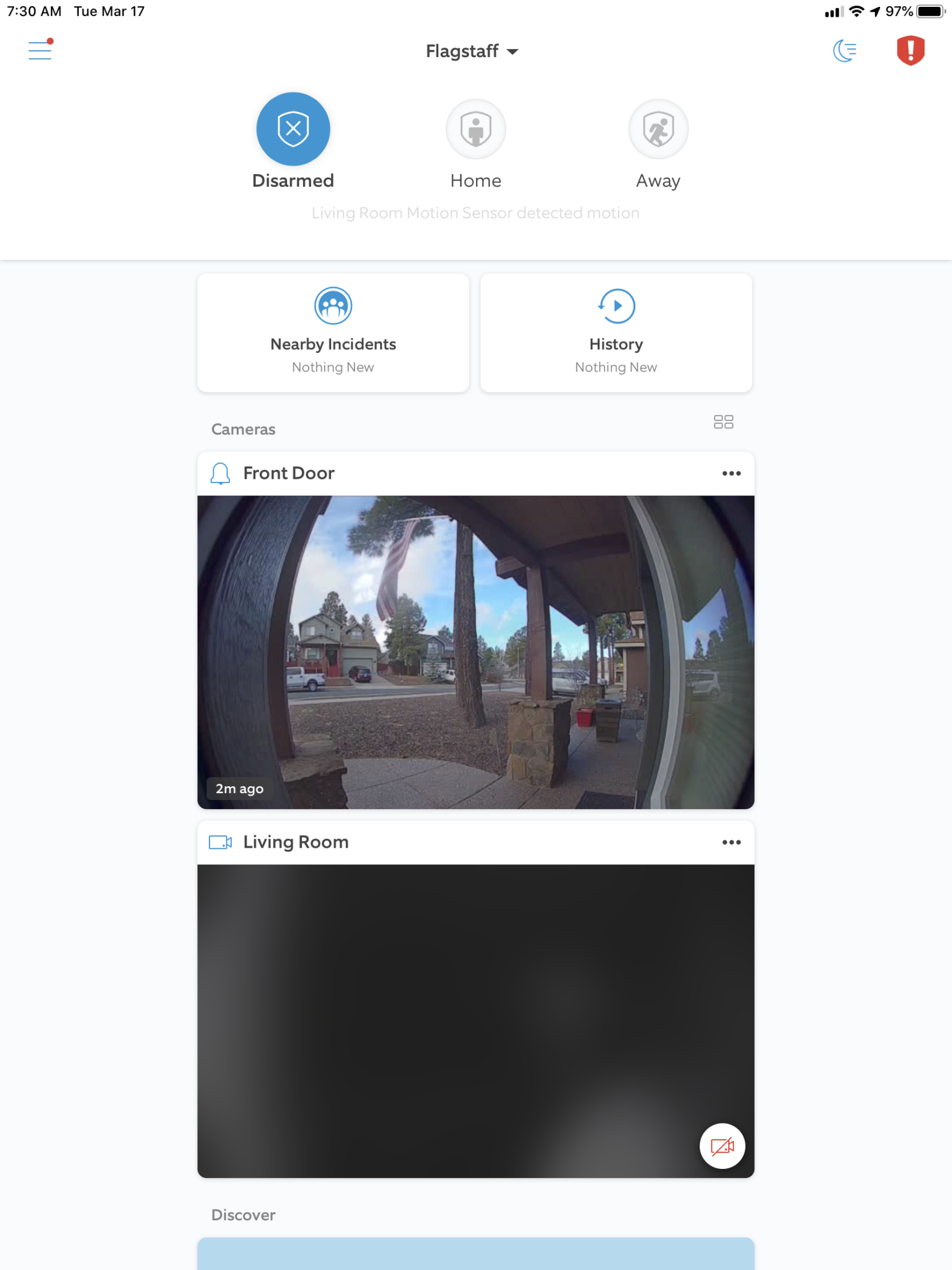

I've recently installed a couple of the Ring brand devices, and have about 90% coverage of my house. These alert me anytime someone/something is on my property. While that can be annoying occasionally (fox, coyote, turkey, deer, etc.) you can also set it up so it only alerts you to people. The software is honestly really impressive, though like anything, there's room for small improvements.

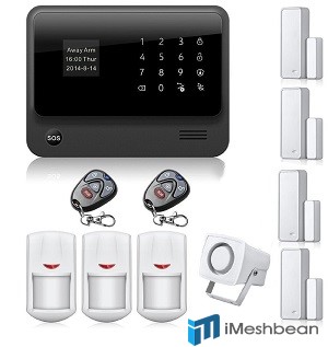

I bought this alarm system with PIR detectors, wireless siren, door window sensors.
and bought an extra camera, it works well with this system.
Very reliable:cool:
