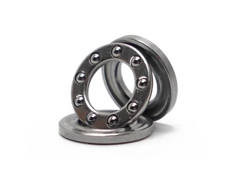

From the thread on another site a guy found these:
http://www.avidrc.com/product/13/thrust-...t-bearings.html
Seems better than mine because it does have tracks for the bearing to ride in. He said they worked well for him and I don't think there would be the same issues of the plastic carrier potentially reacting with cleaning agents or lubricants.

I did some measuring and I think the other bearing with the groves "might" work.
At the most you might have to file/stone just a tiny tad out of the center hole.
BUT I think that reducing the dia of the indicator might work best.
I Do think that the 6x12x4 bearing would work a little better
if you don't want to reduce the dia of the indicator.

I didn't do the case head method, I got a thrust bearing similar to the bearing mentioned at the RC shop. I machined up a washer that was .001" short of the thickness of the bearing assembly and reassembled the bolt and this is a huge improvement in a brand new box stock bolt.

I have the 10PC with the cocking indicator. I ordered the 5 x 12 x 4 thrust bearing from www.avidrc.com/ Sorry no pics.
The cocking indicator was about .053 to big, so we turned it down .054. We also removed the thickness of the bearing assembly from the collar. It made a nice difference it the way it cycles. I still need to polish the bearing surfaces that come into play when it cycles.

I did the thrust bearing method and decided to post some pics while I went through it.
Picked up the thrust bearing from the link earlier to Avid and measured the thickness of it all
Then went down to Coast to Coast Hardware and picked up two 14ga. Machine bushing washers that measure 1/2" I.D x 7/8" O.D
Here's what their total thickness was
Here's the complete package
Took about 10 minutes total to use black Krylon Camo paint to put a few coats on the washers and used the hair dryer between and after the coats to speed up the drying time.
Install the thrust washer set with the first plate having the groove facing up, then the bearing and finally the the last plate with the groove facing down towards the bearing.
To put the BAS in I hold the bolt upright on a table while putting downwards pressure on the allen wrench and BAS and give it enough of a turn to catch the threads then its easy to finish up tightening the BAS. Here's what it looks like put together.
And the finished bolt lift installed
Thanks again to everyone who's worked on the different options and to Axe for getting this going !
