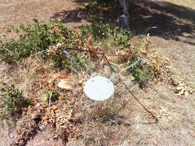

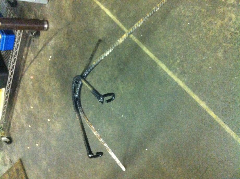

Spider targets
I been building these light weight stands I call spider targets.there free cause scrap material and I have a welder! Pretty simple lets see if I can figure out how to post a pic...

I have fire hose, bailing wire, solid stands and chain. Fire hose lasts the longest but solid stands and chain produce more noise and a better sound. Chain also moves more than hose so it's a little easier to see hits really far off.

Let us know how well it works. I am always worried about the legs and chain taking rounds.
I found some "hardened" chain at Home Depot that would solve the chain problem.
I built a target stand several years ago that used Angle iron for legs. Might just add a piece of angle iron, welded to one side of the pipe.
If the target is far enough away a hit isn't as big a deal. A .308 round at 1K has less energy than a 9mm at it's muzzle. I shoot 9mm against plain hot rolled steel plate at 25' all the time and it barely dents it.
With the angle iron only a "square on" hit would do any damage and then not much at the long range.
Fire hose, conveyor belt, etc is good but I've found that chain still makes the steel "clang" louder. The belting and hose tends to dampen the noise.
