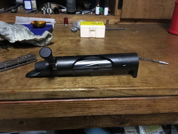

I'm thinking about getting my TL3s DLC coated. For those of you who have done it, what type of surface prep do you prefer? Blasted for a "satin" look, or as is?
I went as is on both of my actions with matte black. Went Satin for my tempest (no prep) and it has a bit of a sheen to it and wanted matte this time around. The satin finish can almost give off a gray to it in some respects.
