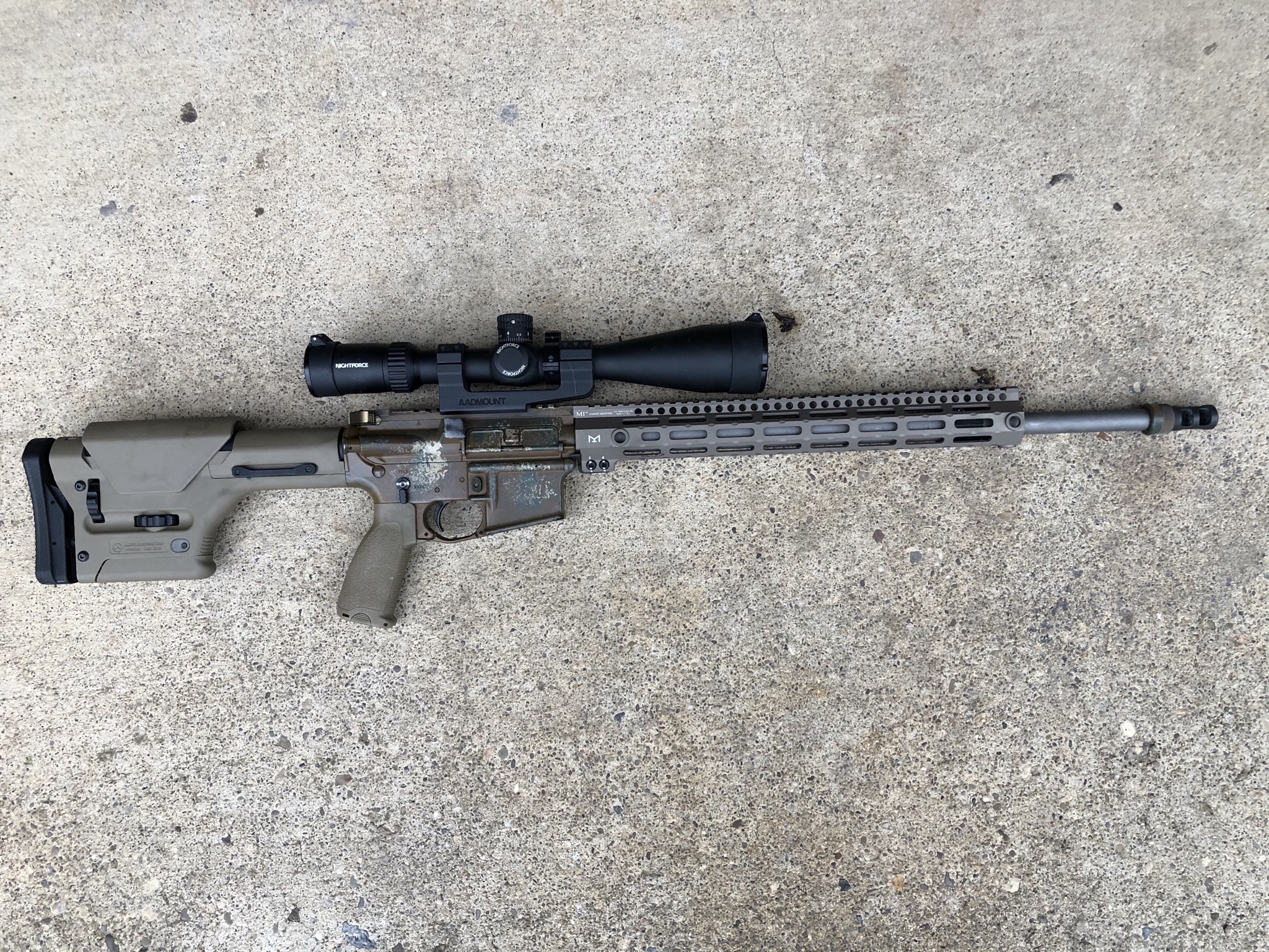

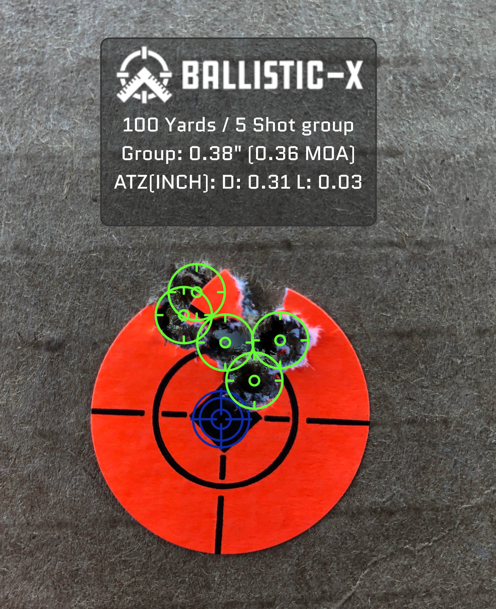

    I recently built an upper with a Rainier ultra match 20” barrel. It did not disappoint
    Reactions: The DFC and D1gger

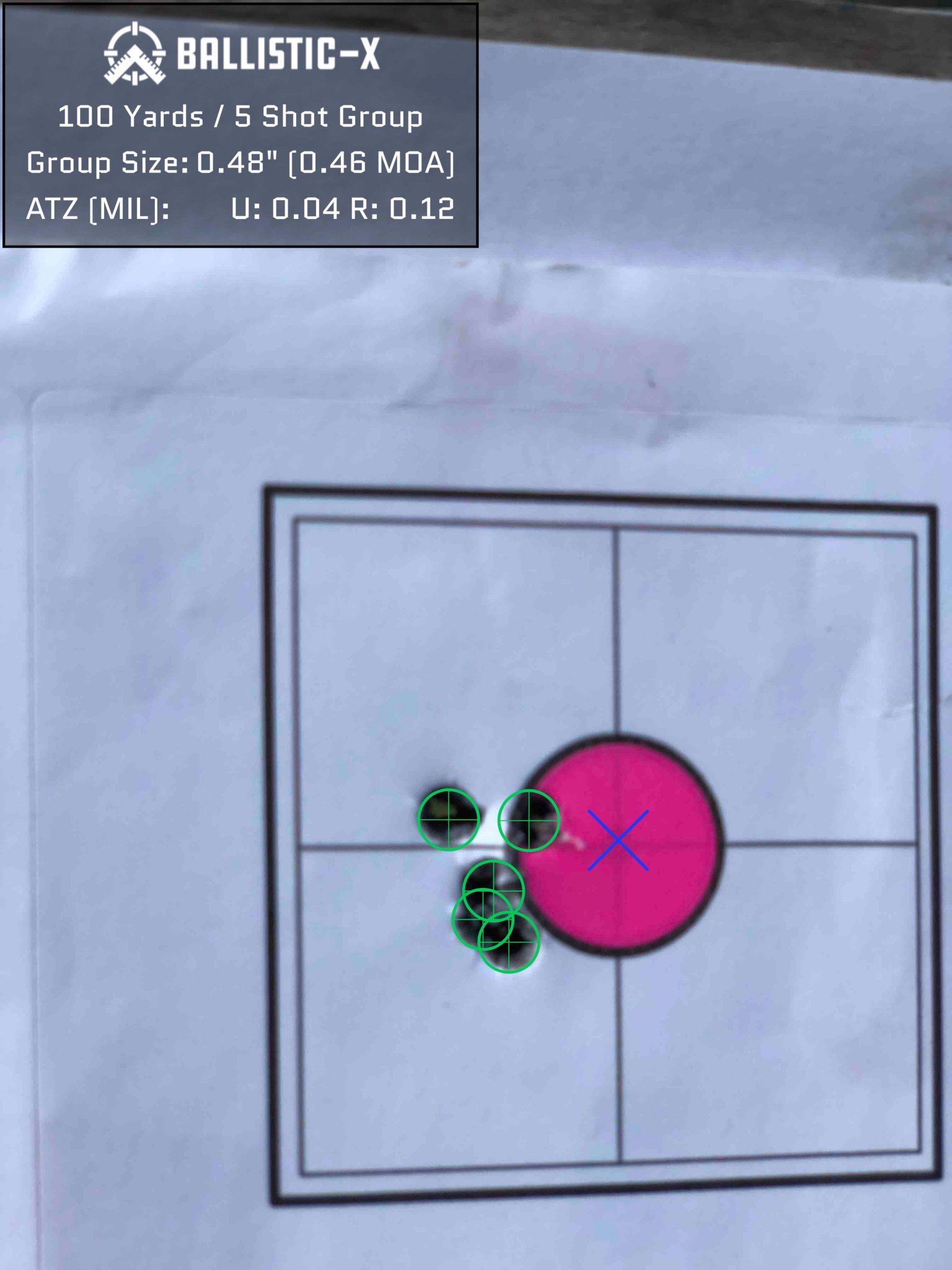

    WOA -22.4 Grn AR Comp and 77smk.
    Reactions: D1gger
