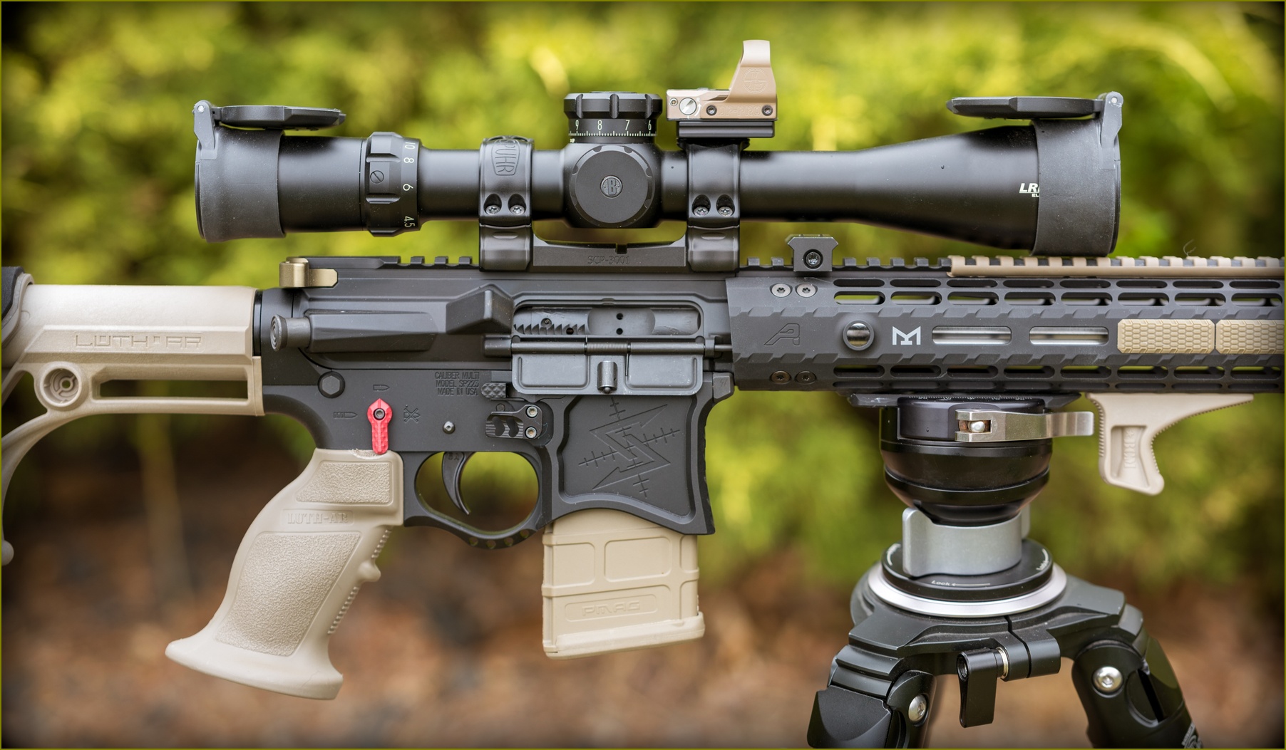

About 18 months ago, I did a lot of pairing down ... and now only have two types of rifles
Bolt guns (7.62x51 rem700, criterion 20/22 inch barrels, KRG bravo)
Stoner Rifles (Mk12 556(18) and Mk11-ish 762(20) )
So, since I only have two types of rifles, I only need two types of scopes, so I made up this scope list around Feb 2020
And surprisingly, I wouldn't change it much.
Basically I use 3-9x on the stoner rifles and 3-15x on the bolt guns.
I value light weight, short scopes, low price and ability to hit what I'm aiming at night or day, rain or shine, hot or cold.
For bolt guns I really like the NX8 2.5-20x T3 mostly due to the 2.5x on the bottom, that gives more FOV, even thought NV or Thermal clipons. And at night almost all your FOV comes from looking thru the scope (since it is dark).
For stoner rifles, I want smaller, lighter and more FOV if I can get it. My two purchases this year were the L&S mk4 2.5-8x TMR ... and I'll admit some sentiment was a factor in that one, but I have enjoyed using it, I've been testing it with a new German thermal clipon lately, the Andres Tig-IR and its working GREAT !.
And just got Trijicon Credo 2-10x MRAD-Tree, its an FFP. Some have said they can't see the reticle, fortunately, I can, so I think it will work for me.
So on a stoner, I also want to be able to pull up quick for snap shots while on the move. And that means I need a reticle I can see quickly. So before I got this credo I also looked at
NX8 1-8x
Credo 1-8x
March 1-10x
VO g3 1-10x
I ruled out the, all out based on price, as the credo 2-10x was still several hundred lower, but it was a close call with the credo 1-8x.
I currently have RMR offset dots on the mk12s and that serves to meet the requirement for a quick snap shot, but I'd like to repurpose those over to G-19 pistols. So still might move towards the 1-8x type scope for the stoner rifles eventually.
So "long distance". Well for me, for the record, I shoot out to 900yds with the 30 cal rifles and 750yds with the 556 rifles. I do shoot further, but when I'm shooting "for the record" those are the distances I max out at. And 10x magnification on top is plenty. For shooting the bolt guns out to 1200yds not for the record, the 15x top end requirement is fine. But I don't see needing more than 10x on a stoner rifle for the way I use them and FOV is more important, i.e. lower low power magnification.
But if I was using a stoner rifle like a bolt gun, then a 3-18x would make sense, in which case, if I was buying today, I'd get the NX8 2.5-20x with some reticle of choice as that gives you a little more on the low end (2.5 vs 3) and a little more on the high end (20x vs 18x) and the street price is well under $2k for most reticle choices.
My second choice would be the L&S mk6 3-18x with some reticle of choice, they are shortest and lightest in class. A new one will probably come in right around $2k street price. But I see used ones going by fairly often and I've had great experience with L&S service. They completely rebuilt my Mk6 3-18x H59 no-Illum into a 3-18x T3 with Illum for $1200 and replaced the M5B2 turrets with the M5C3 turrets as well (and you definitely want the M5C3 turrets, the B2 turrets suque !!! )
But again, first choice NX8 2.5-20x with no hesitation.

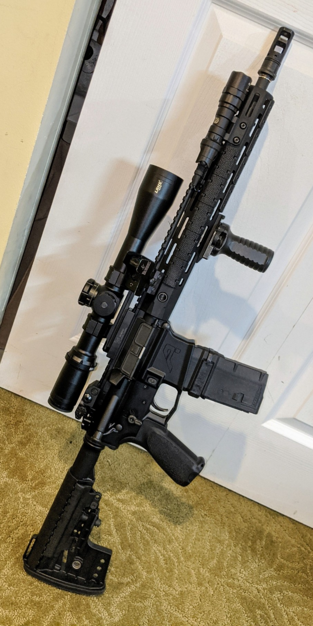

Thank you for taking the time for a very detailed response. Looking at nightforce’s website, the exit pupil on the nx8 is about half that of the nxs 2.5-10.
Do you find that it is harder to make snap shots with it? I know I won’t be getting a true 1x and LPVO style eyebox with this style optic, but I would like it to be serviceable for close up shooting. (Thinking more acog style - not as forgiving, but useable)
I’ve been considering an offset dot to help in this situation, and with passive aiming up close under nods. I’ll have to come back and ask you some clip on questions when it becomes time for that

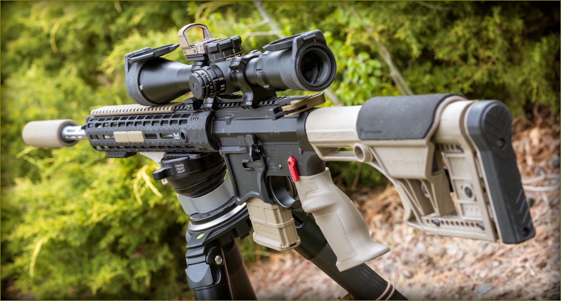

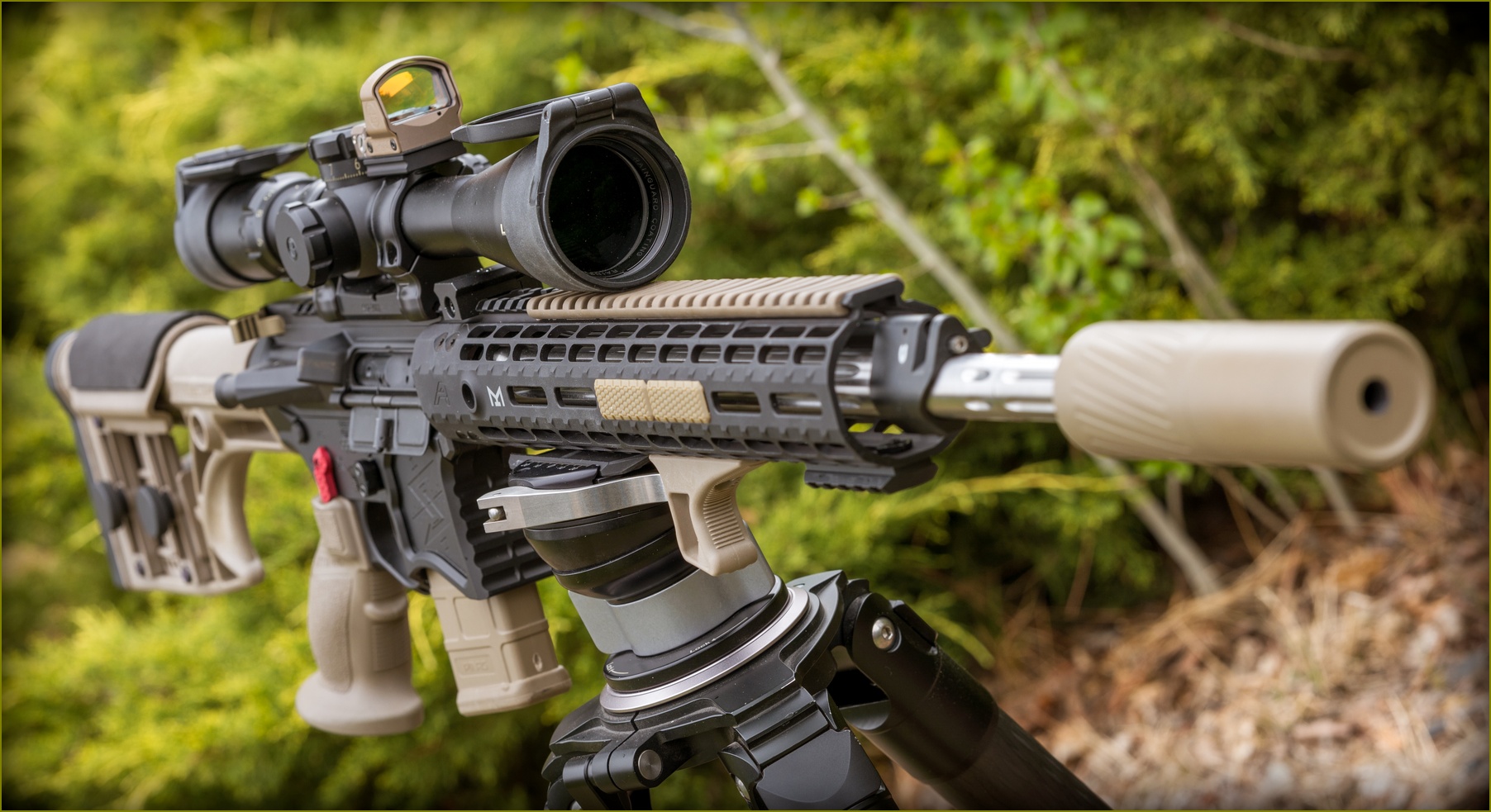

First thing you need to ensure with a gas gun that has such a heavy mass BCG is reliability/durability. So far, most of the optics discussed here surprisingly pass that very high bar, which is a good sign. When the AR-10 BCG slams back into battery every shot, it makes life extremely hard on optics.
The Vortex Gen III 1-10x is really an ideal DMR optic, if you understand DMR the way I do.
Anytime I see really high magnification, larger optics being discussed in a DMR context, I know that my definition of DMR is not on the same level as the really heavy rifles and larger optics assumption.
The main trade-off with the Vortex Gen III 1-10x is on the long range end, where you don’t have a parallax adjustment.
I just got mine last year, so it’s premature for me to make any conclusions on how I feel about that.
Once I have sufficient trigger time under it, I’ll cover down on it with a review.
So far, I’ve never felt a need for that on any of the higher performance LPVOs prior to the 1-10x factor options just hitting the market in the last few years.
I’ve used a lot of different 1-4x, 1-5x, 1-6x, and 1-8x LPVOs over the past 15 years when 1-4s started hitting the market.
For the 7.62 NATO MWS, the first thing that always pops into my mind is the weight, and how to tame it.
If this is a rifle you want to be able to pick up and move with, then consider that as a factor. It sounds like that’s what you’re looking for when snap shots are mentioned.
The Gen II RZR and NX8 1-8 come to mind for that. Those are 2 of my favorite LPVOs right now. I like the reticle options from Vortex better since you can compensate for wind holds more easily with the tree.
I like the compactness of the NX8 1-8 the best of most of them right now, without having put hands on the new March 1-10 Mini.

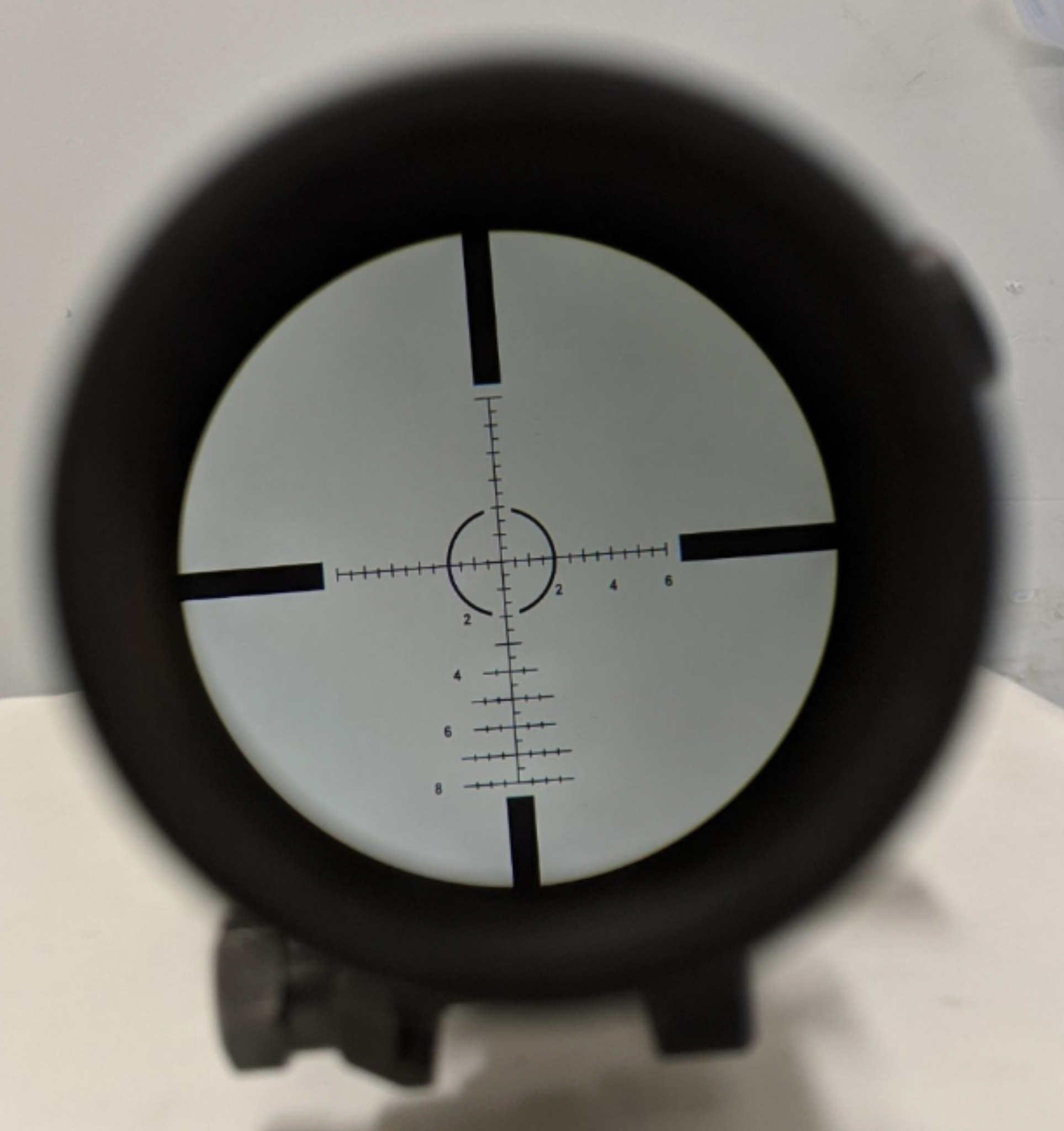

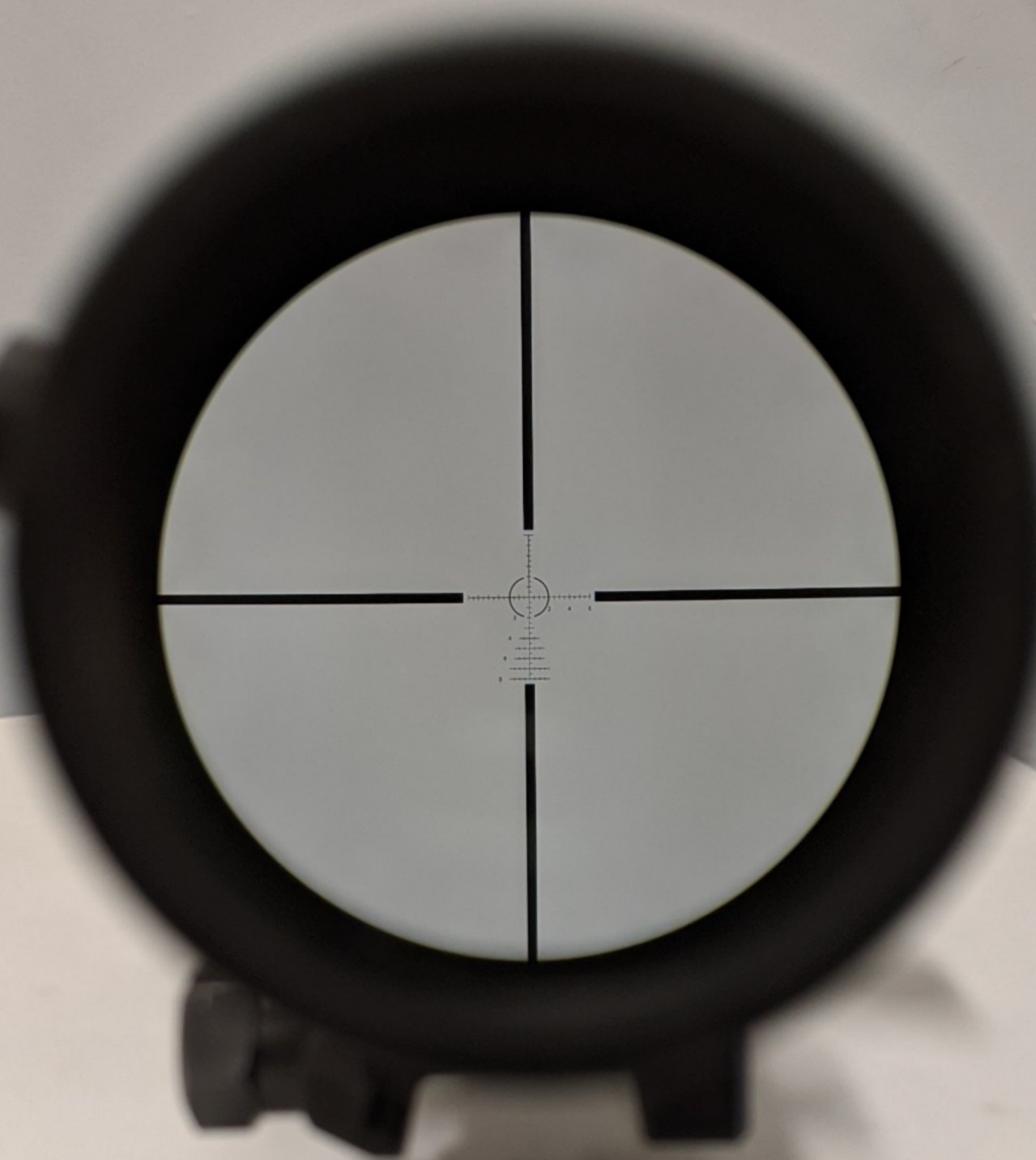

Got a bit more range time with the Credo 2-10x. Some more detail on my recommendation (it's really a great scope):
- Superior glass vs. Accupower 1-8x LPVO and both of my Vortex Viper PST Gen IIs. It's not quite ACOG clear but is noticeably better than the Accupower and PST.
- Turret tracking is spot on.
- The reticle is thin at low power, but I find the side and bottom lines to be good reference points to get you on target. Not an issue for me.
- Illumination is bright enough, but not as bright as my Accupower 1-8.

The 4.5-18 Is longer than I would prefer but the reticle makes up for it (G2H, G3). Very fast optic and solid internals. Very reliable.

May not work for everyone but I am really liking this setup. Bushnell LRHSi 4.5-18x44, Spuhr SCP-3001 and Leupold Delta Point Pro, keep in mind I do not shoot competitions but try to glean off those who do and setups that work. Need more time with this to determine if it's going to be better than a 45° offset...
