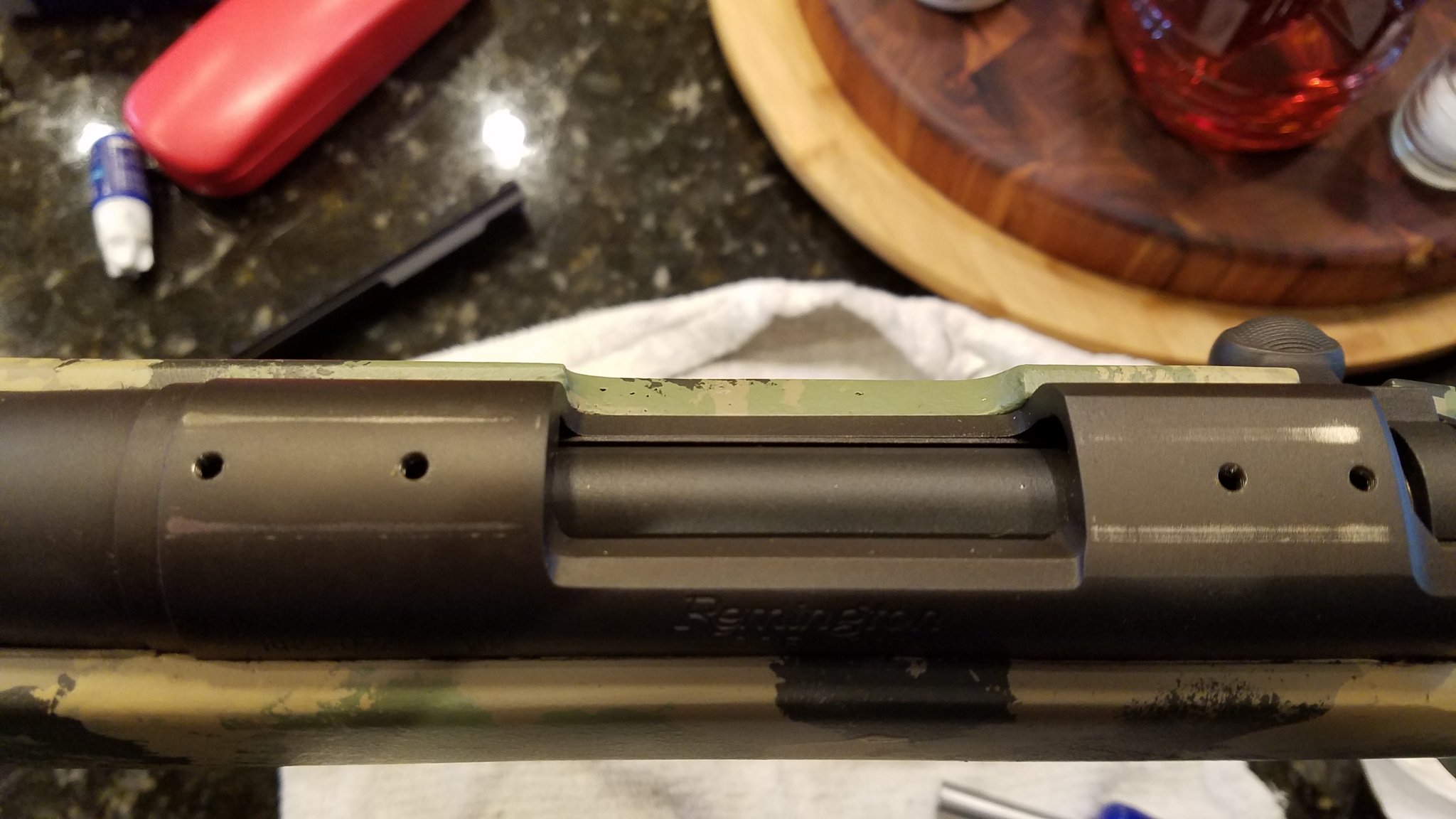

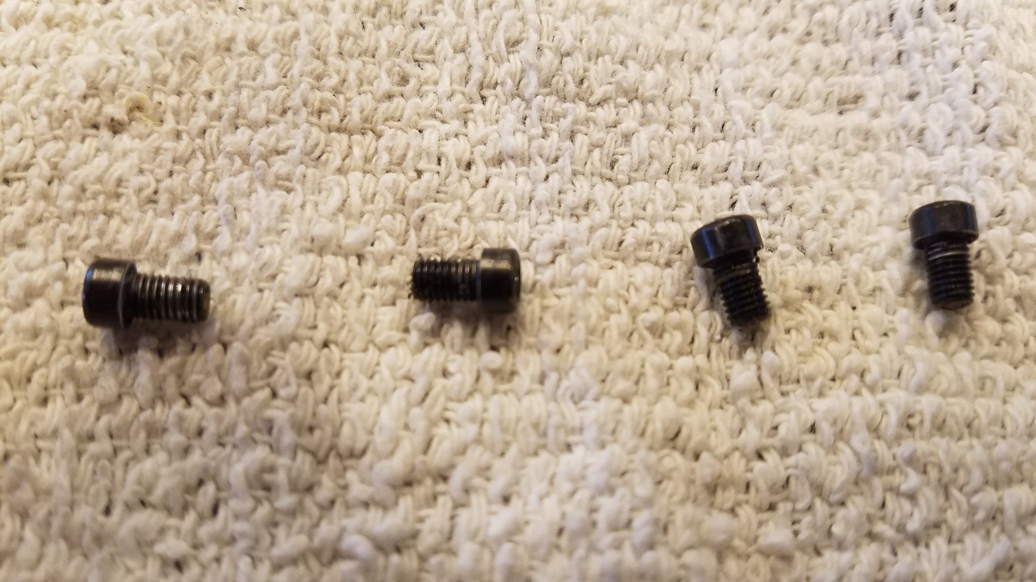

Don't just check to see if things are tight.
Pull it apart and look at things.
My Creed was giving me fits so I took it apart and found a couple of issues.
The biggest offender was a loose scope base.
I checked it the day I bought the rifle and must have broken loose the thread locker that was on it.
As you can see, it had been loose for a while.
The forward screw had been taking a beating. Look at the threads on it.
Check the bottom of your receiver and the back of the recoil lug to make sure nothing is moving.
