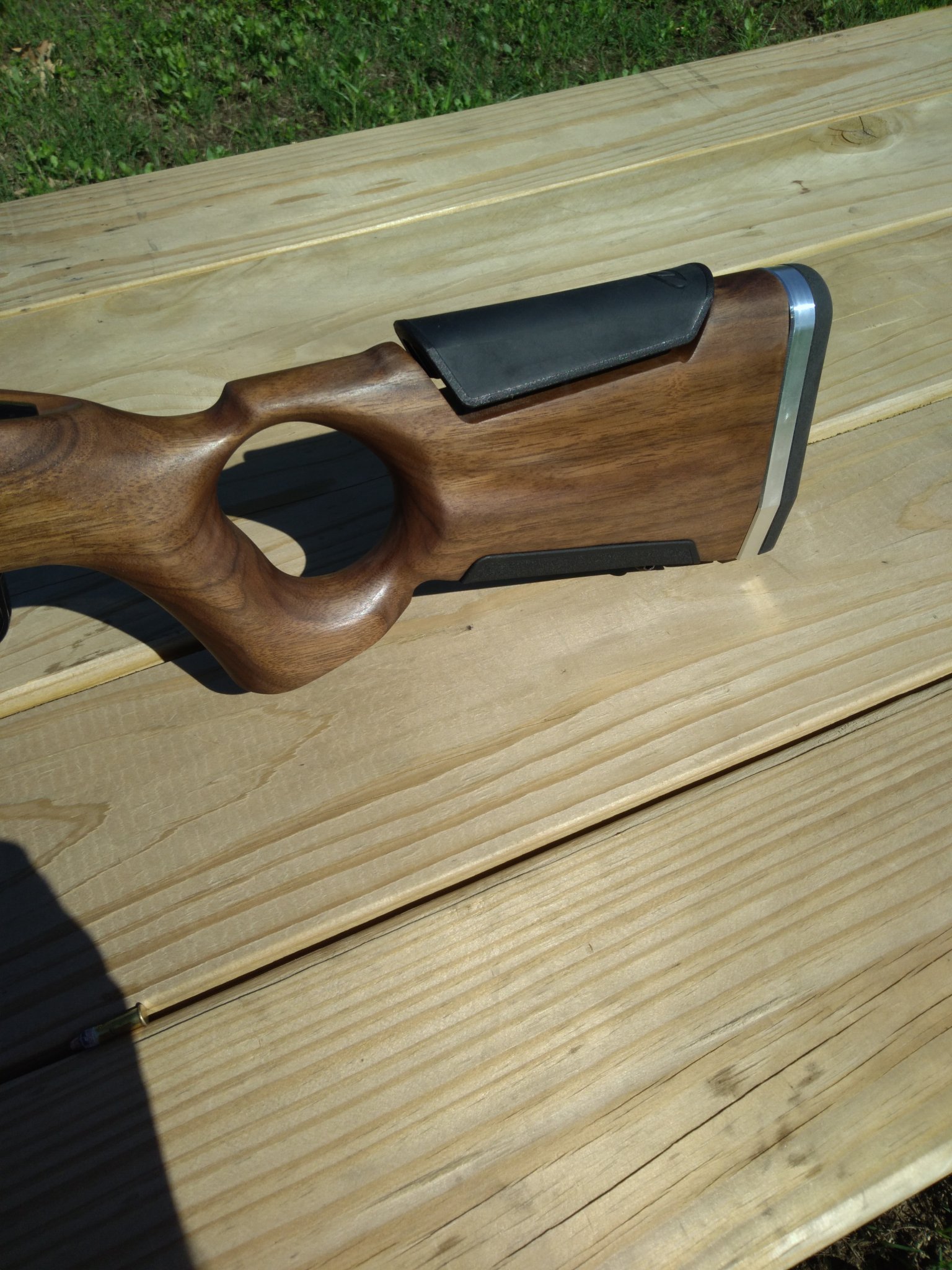

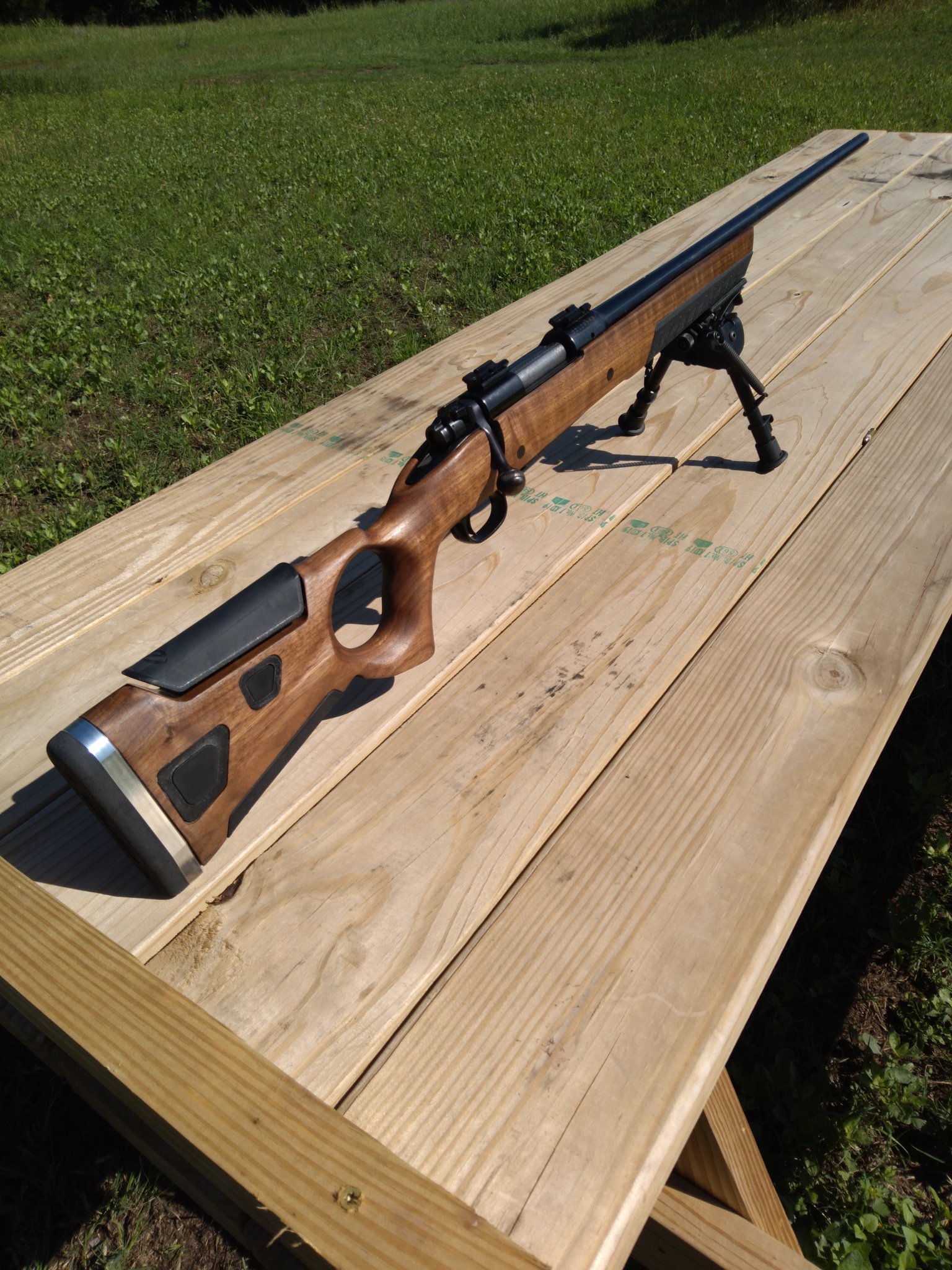

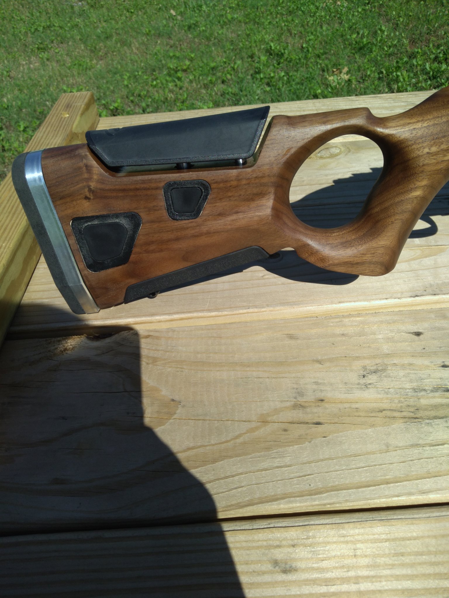

Do i need to wax?
Texasflyer
Koala Gladiator
  • Mar 3, 2021
    1,679
    1,954
    Texas
    So i wanted a little adjustability on my varmit rifle. I love wood stocks and figured a boyds at one walnut stock would be a decent way to go. The fit of the action was perfect, no inletting needed. My bitch is that it looked like walmart furniture as far as the finish is concerned. Runs and shit brown stain, all kinds of trash in it. So i cant take it and about an hour after getting it im sanding it down. This is a really pretty peice of wood. My major bitch is that you can buy their other stocks with a length of pull choice and unfinished. But the at one has no lenth of pull options and even though its adjustable is only 1/4" shorter than my original stock, and you can only get it finished. So i paid 50 bucks or so more for extra work and still have to wait a month for truoil to cure anyways. I will say that the shape of it was super rough and it needed the sanding to help shape it anyways. I just ordered some birchwood casey high luster gun stock wax, but was thinking of just using bees wax from a toilet ring. Does anybody wax their guns? What do you use?

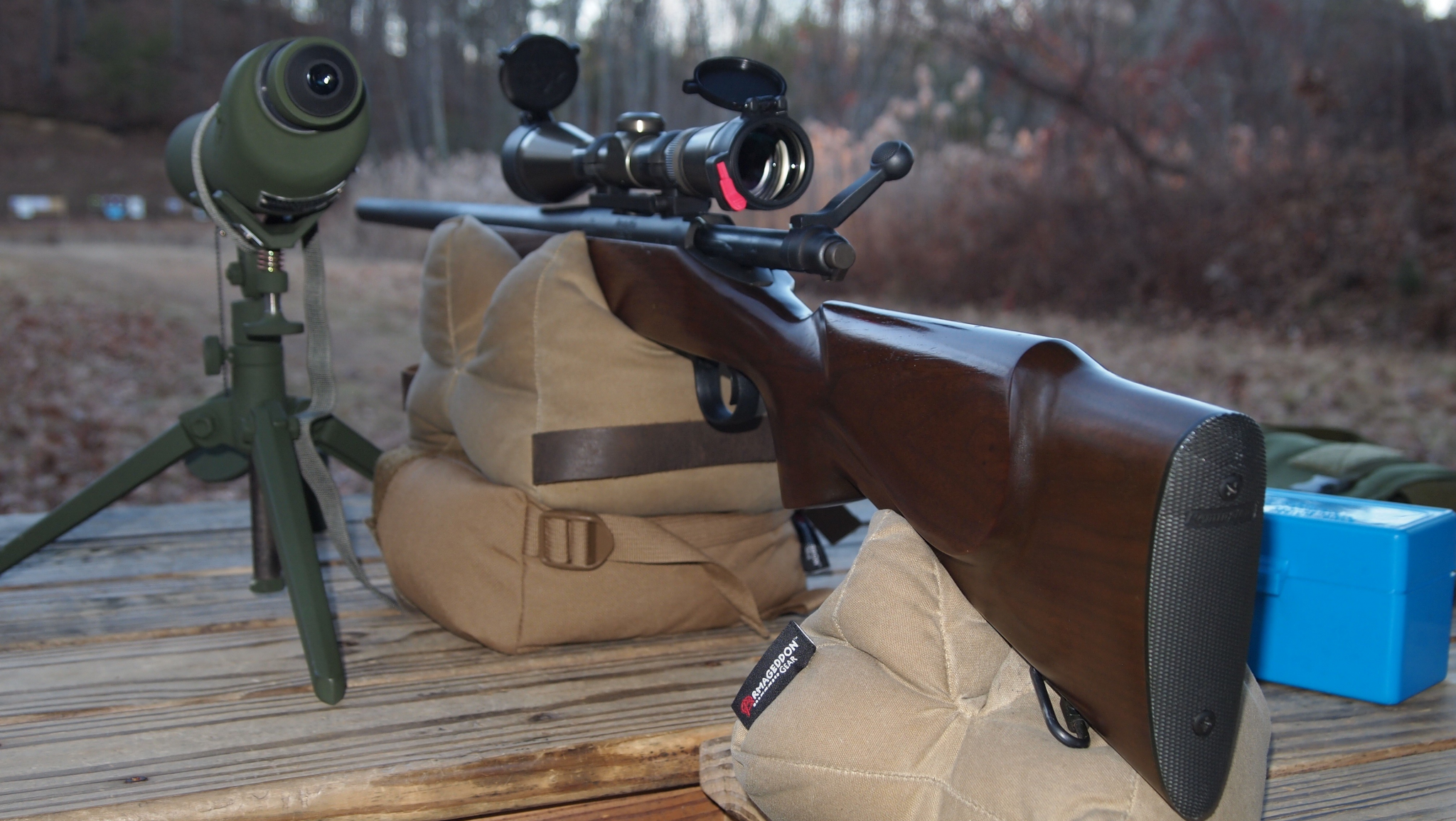

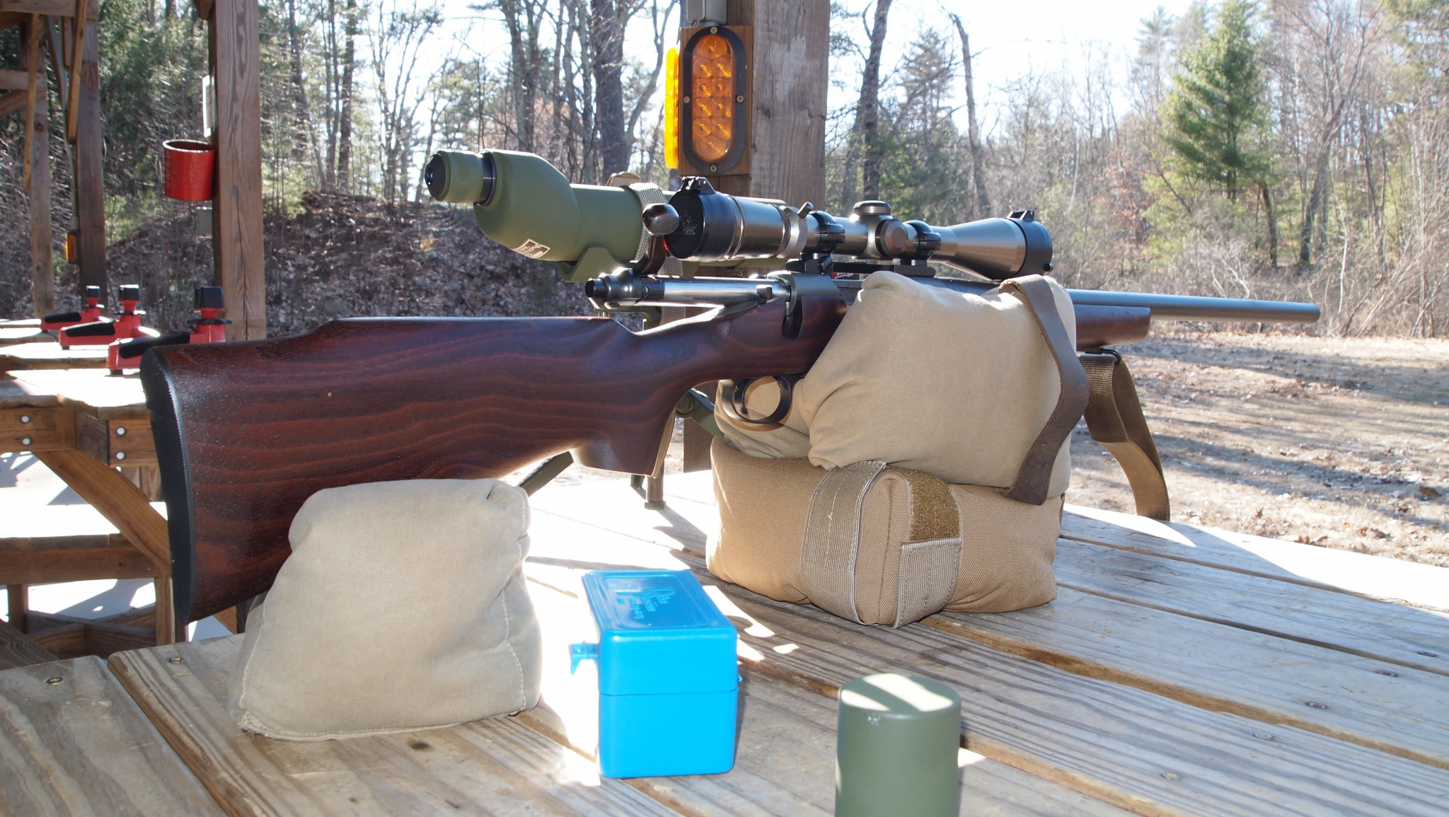

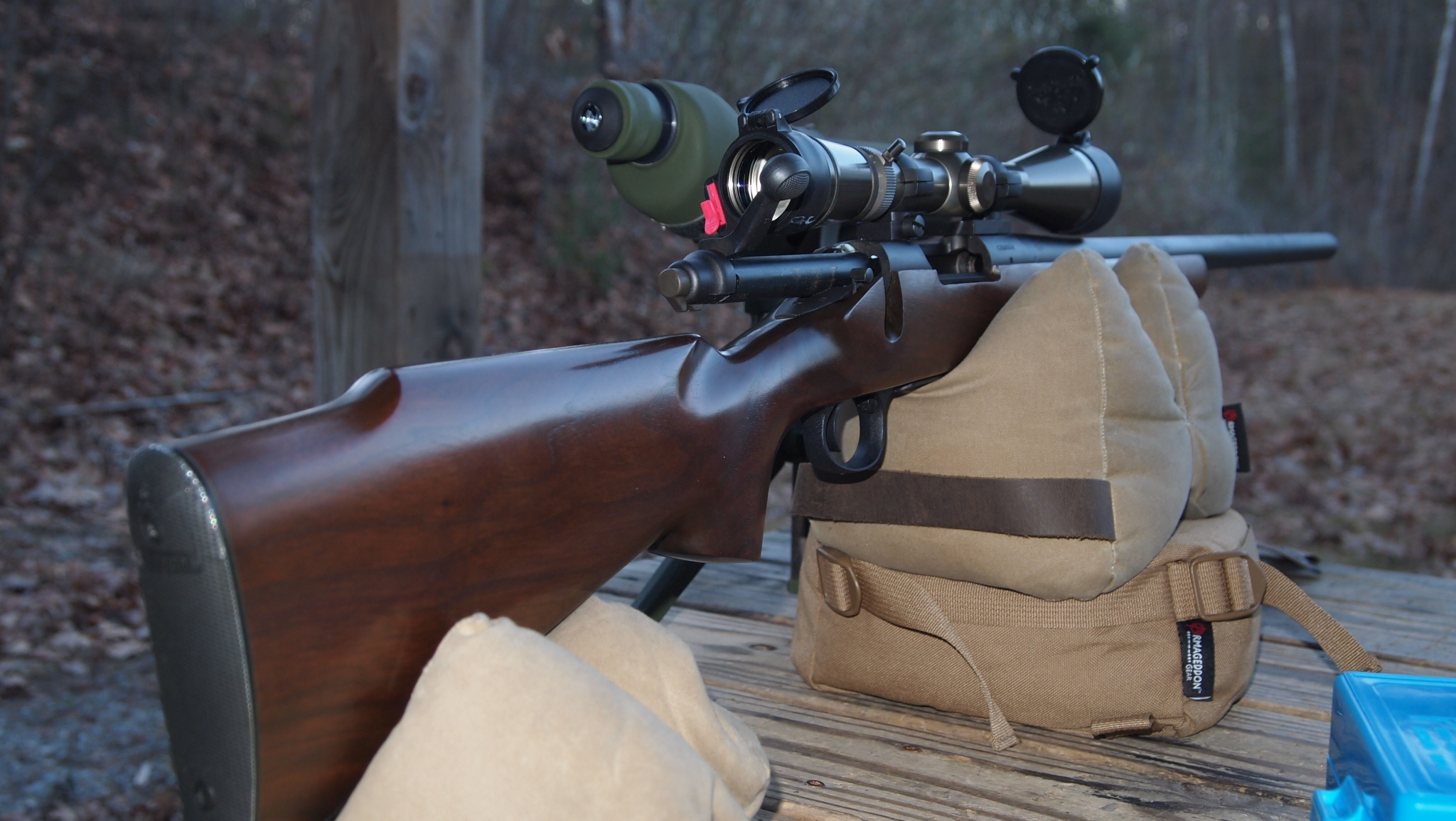

    I use this on my Cooper 57M.

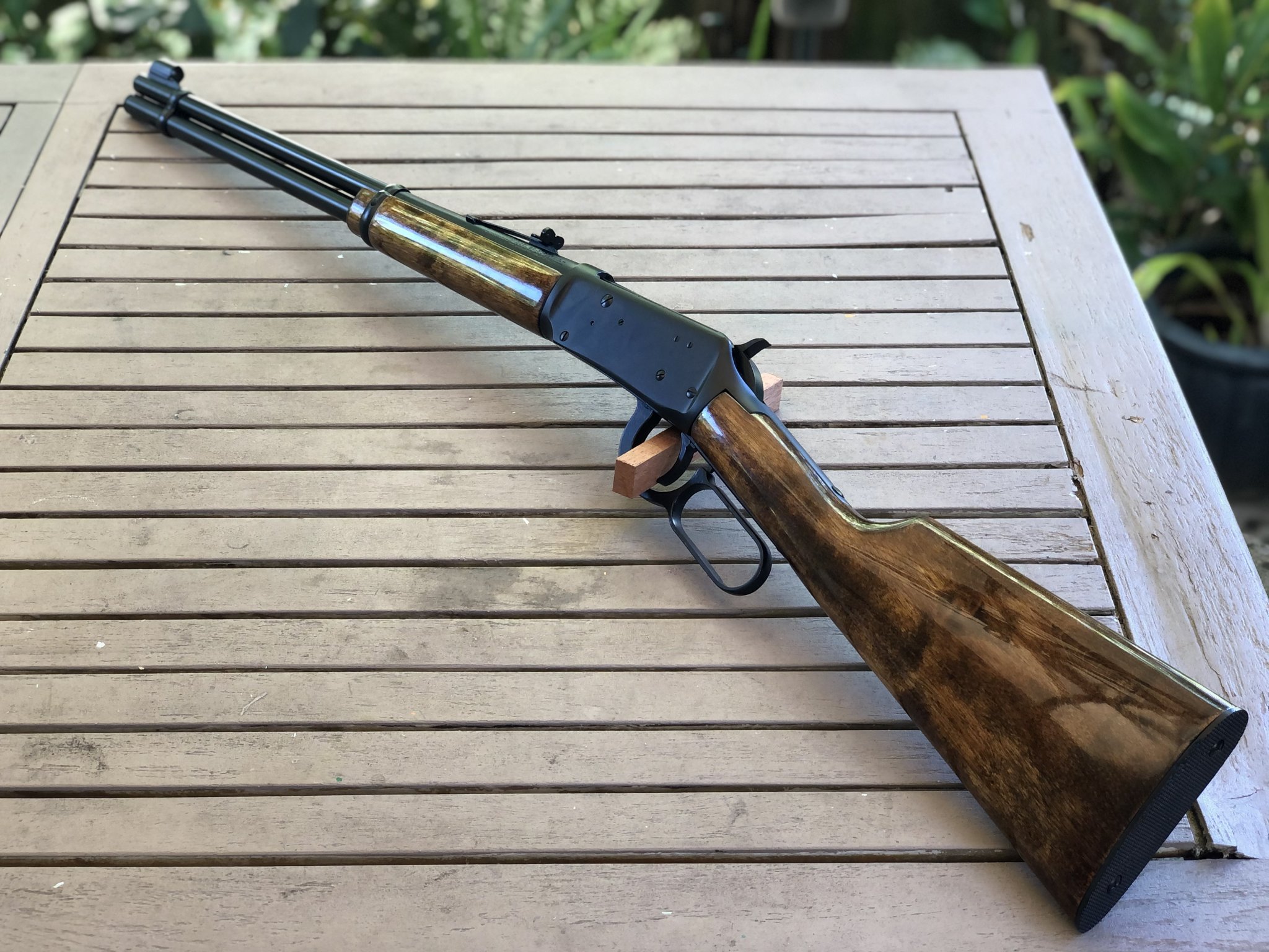

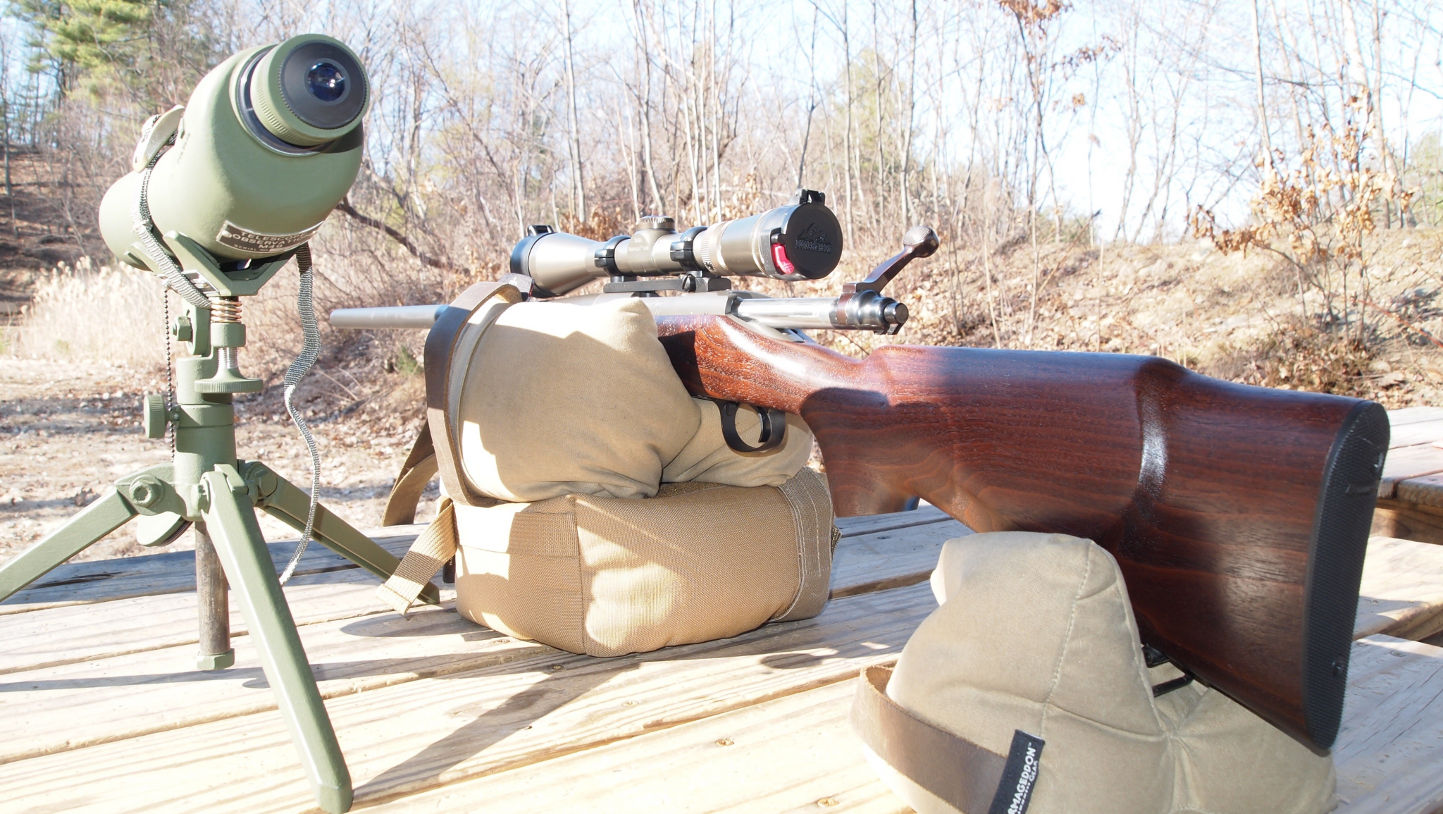

    Maxwell

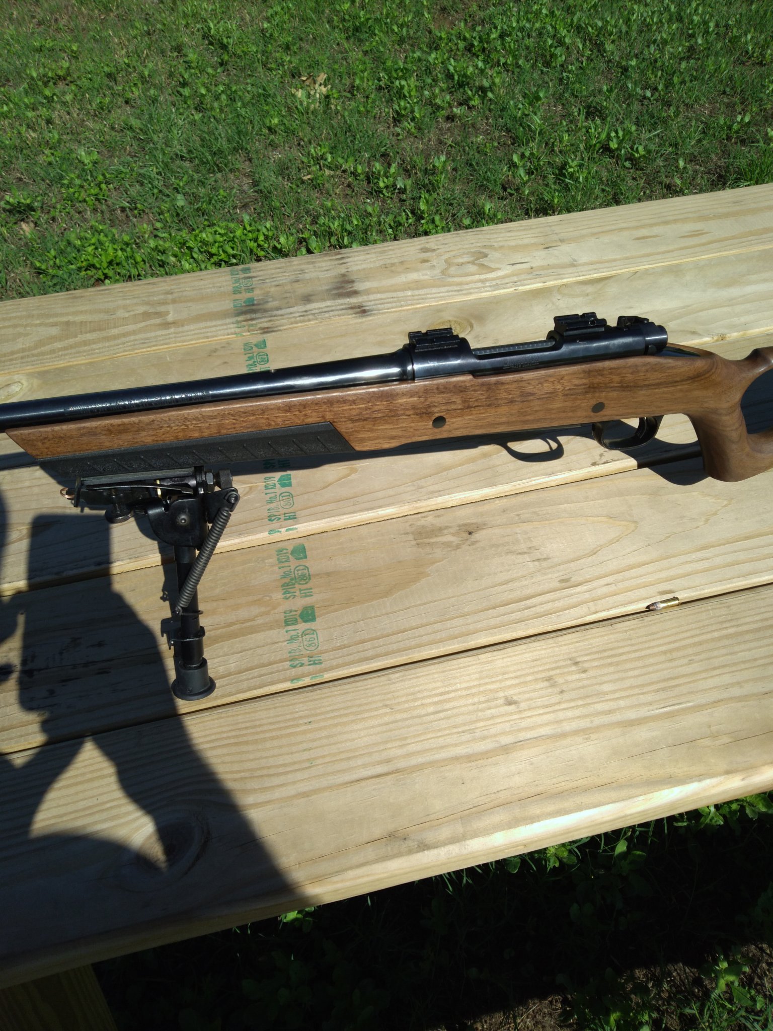

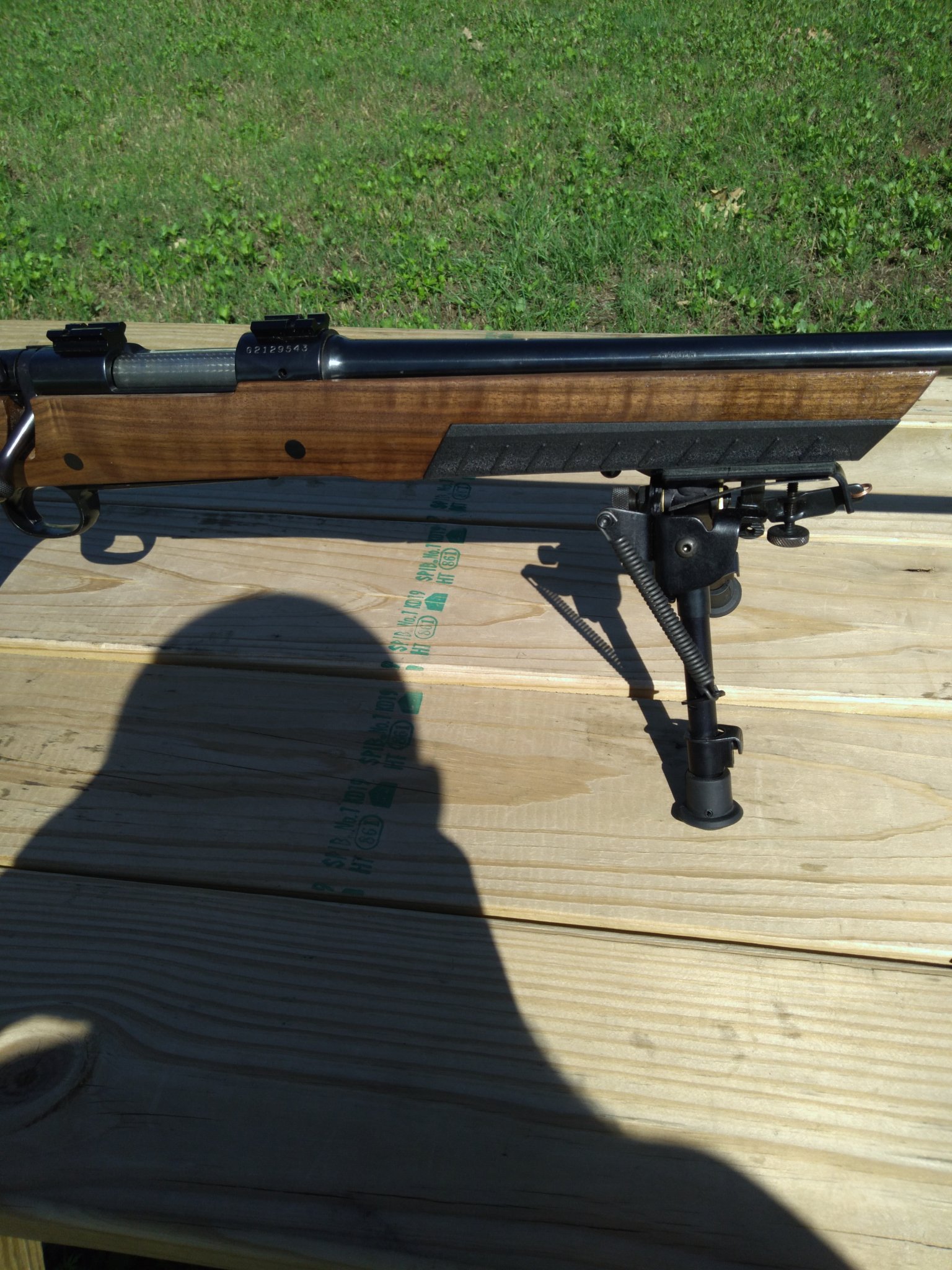

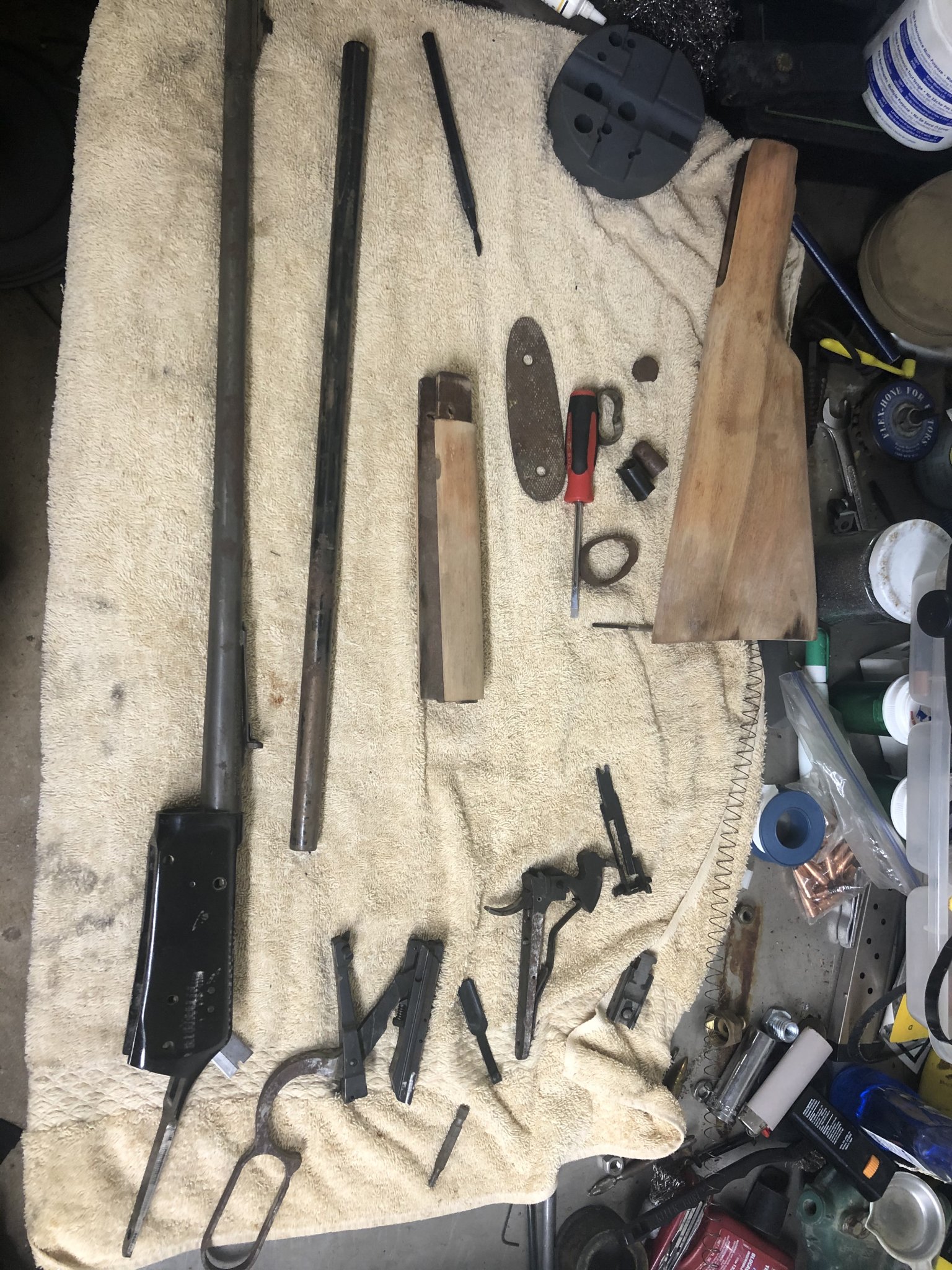

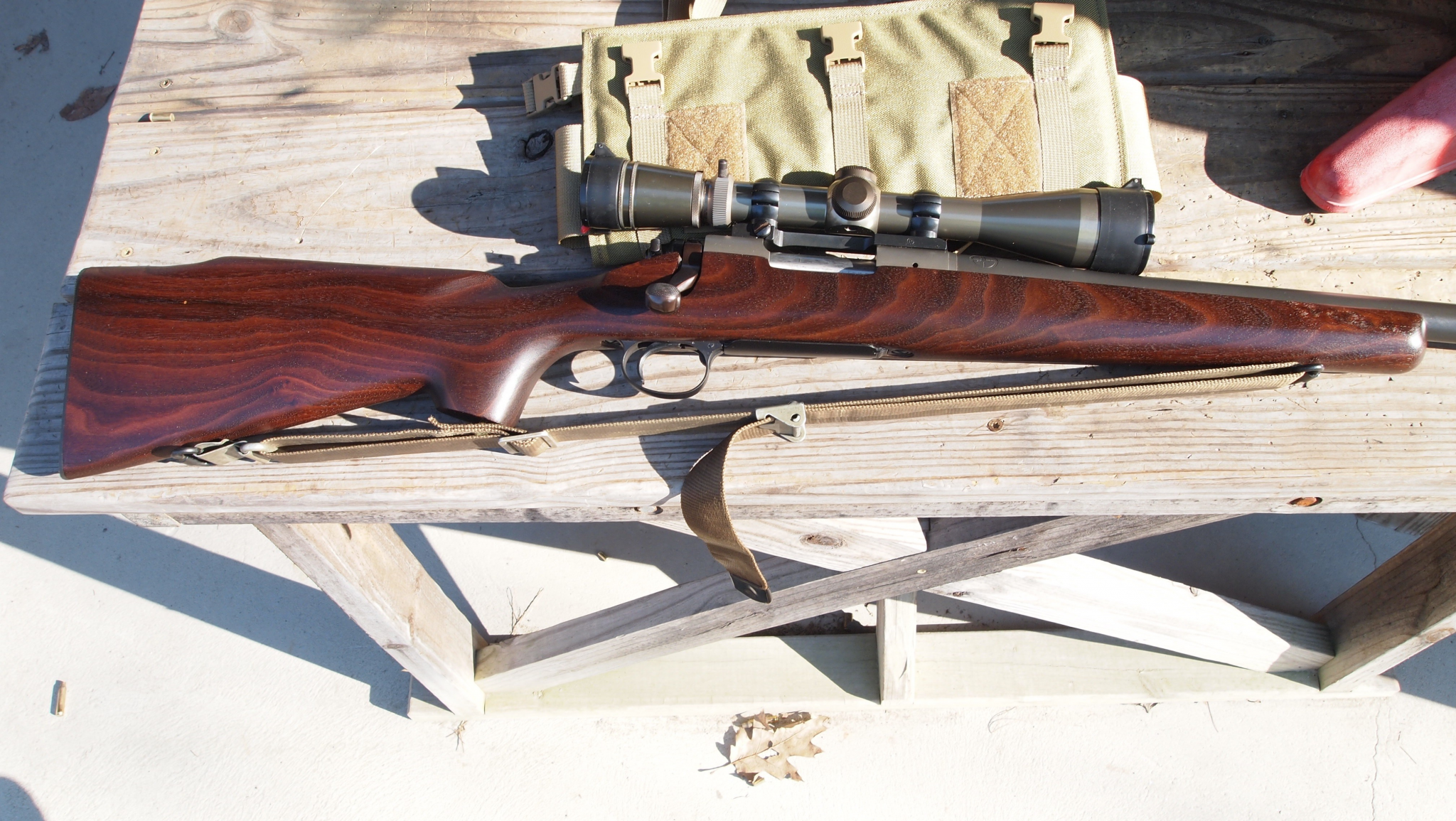

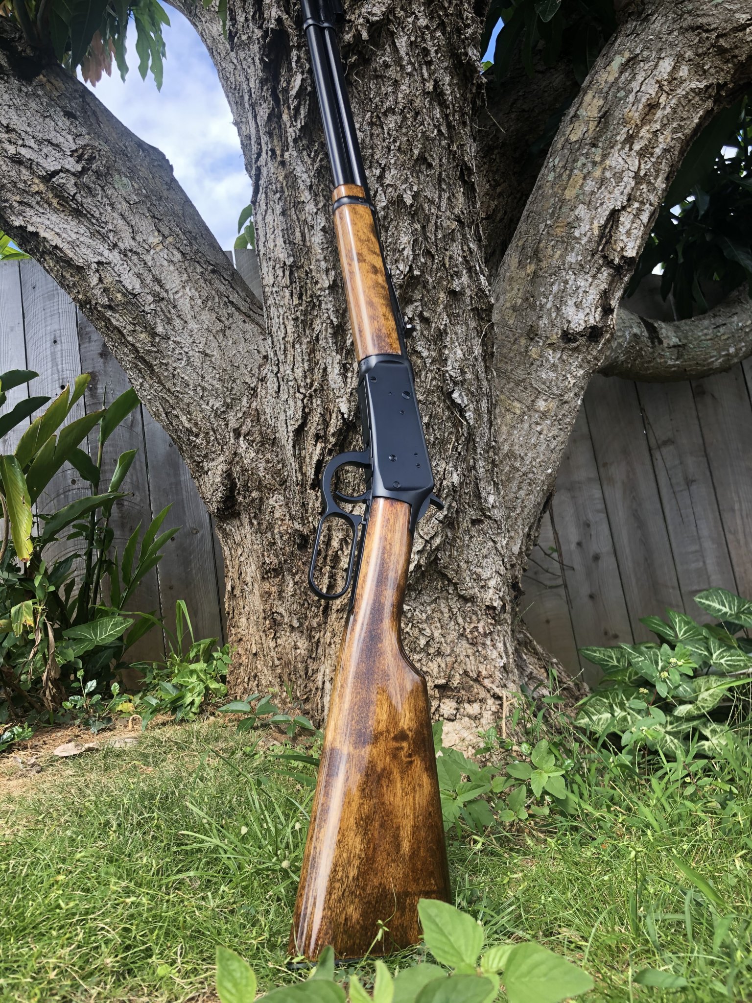

    I sanded my ADL stock to bare wood and used minwax stain and a matte poly to finish it. I think it came out pretty good, but it's what I was looking for in the first place.
    I would like to see pics of the finished product when you are done.

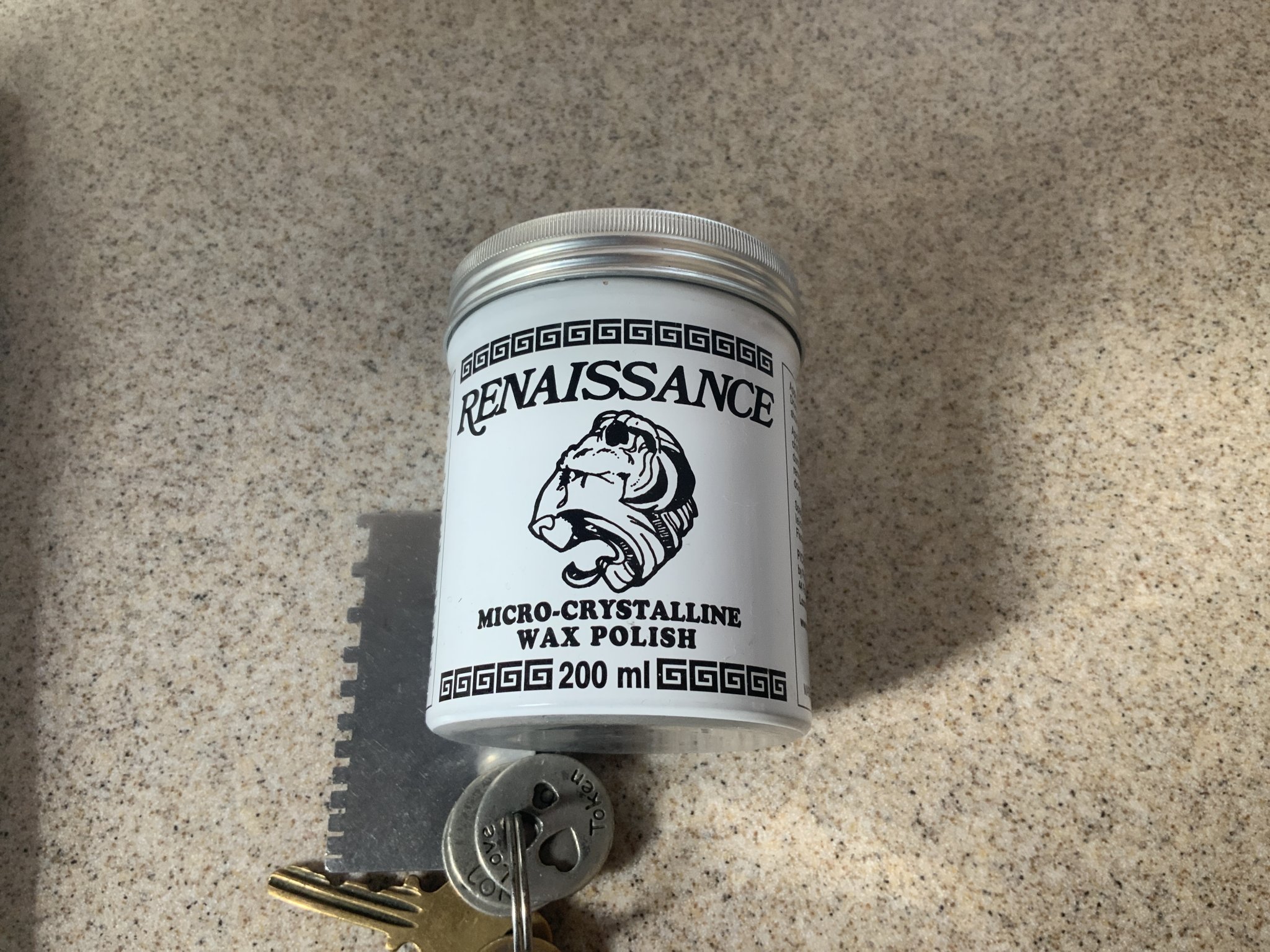

    Wax ring for a toilet?
    Geezus, just get some beeswax.
    Pretty sure its got other pooprietary ingredients besides beeswax. It may be great for bullet lube, but its sticky as shit.
    I mean it states right on the box thats its bees wax. Im gonna try the birchwood casey stock wax i ordered. I agree though it is sticky and paste like, probably make the stock feel like ya peeled an old sticker off of it everywhere

    You can see i rounded and smoothed out alot of the angular look of the stock. Im pretty happy with how its turning out. All work is done by hand, no power tools allowed except the drill press to install the bedded pillars.

    I use this for stocks that I have refinished, furniture that needs some bling and bowls or other objects I turn on a lathe.

    I will say, flushing the buttpad without the spacer is great, but i needed to trim about 3 rounds from the acme thread and the bottom slider rod had about 1/4" trimmed from it as well.
    Gonna hunt bobcats with it this weekend and finish coating it next week. Going with the high luster birchwood casey stock wax this time, but gonna try some of the crystalline wax next time fron rennisance.
    Ok, so i got the birchwood casey wax in today and tried it on a few different rifles. I will say that from now on i will wax any metal on a gun i own thats blued. Matte finish stocks wasnt a great result. But on the gloss finish it is nice, i think it does better on the metal and i like the thought of sealing it against moisture and rust.
    That is a very nice looking rifle! I prefer less gloss but to each his own, that's still a great looking job that I know took a long time and lots of effort to achieve. Kudos!
    Thank you it did take a lot of time and work it’s was pretty rough and rusty sat wrapped in a towel for over 20 years. I hear you on the satin type finish, but my friend who bought the rifle new in 66 wanted it glossy.
    believe that your gun does not need polishing; it already looks great. Such guns do not need it at all. By the way, the weapon is very cool; where can I get the same?
