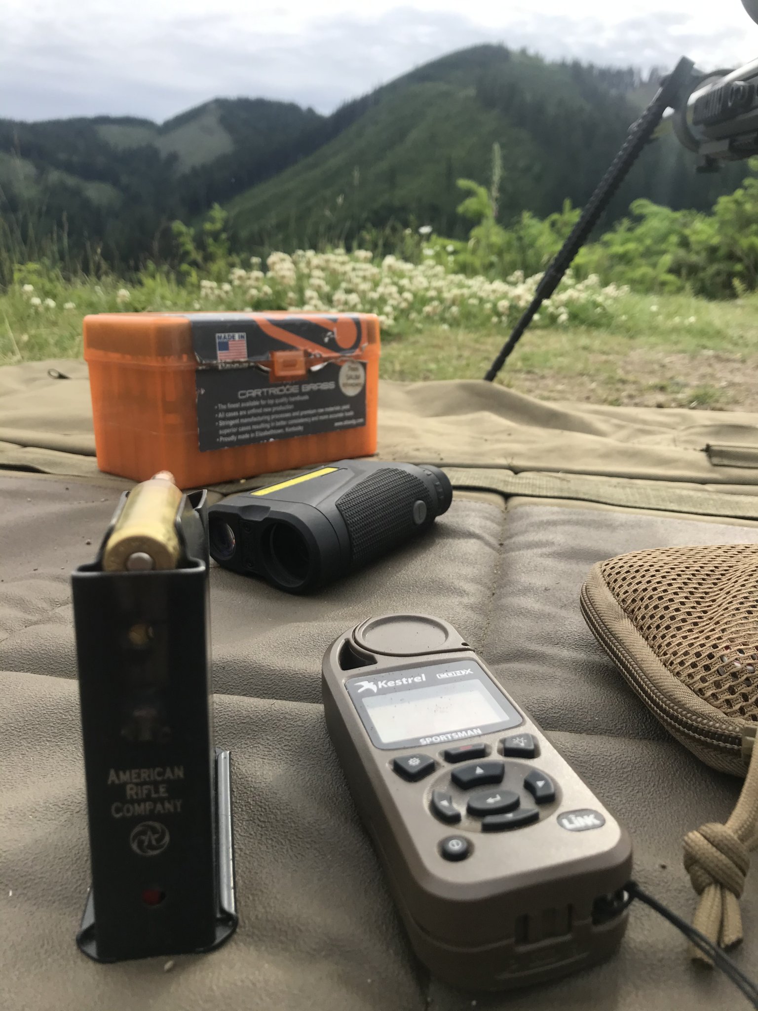

So, a few things I still have after trying most every toy and gadget possible, literally hundreds of thousands of dollars of gear. Much of it on a revolving door basis if I didn’t like it or was nuetral on it:
Kestrel 5700 elite
Swaro SLC 15x56 binos
AI-AT rifle
I have plenty of other stuff currently, but those are the three items that have consistently stayed with me.

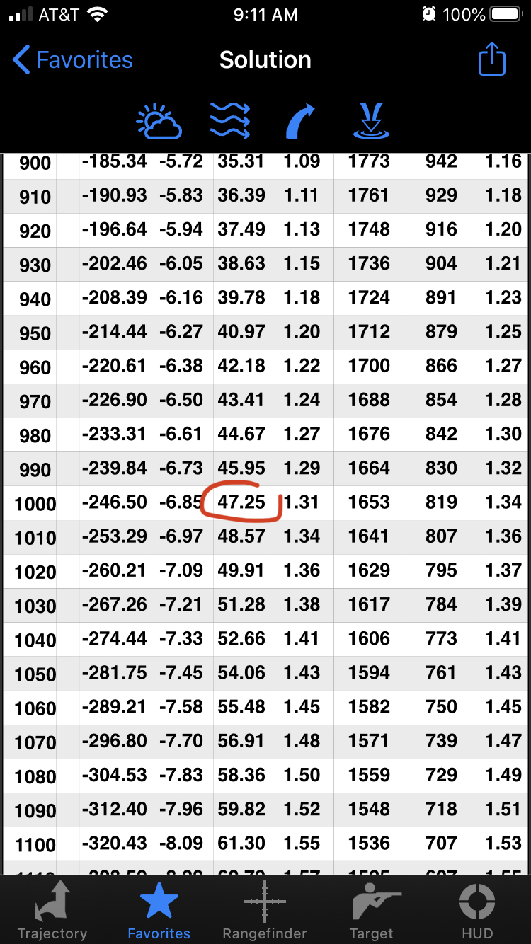

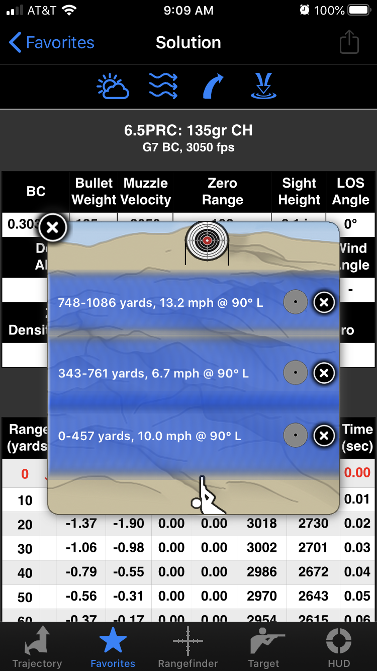

I see you've gotten a bunch of replies on this, but I'll give you my 2 cents worth as an F-Class shooter... Our range has lots of flags so you can really see what the wind is doing at different distances. (four flags on each side, over 1000 yds.) The problem I've had is our range is ALWAYS windy, predominately from the left to right and can vary considerably over short periods of time. Early on, I had real issues getting my windage setting adjusted with the few allotted "practice shots". At times, I'd start the shots, for record, not even having gotten a practice shot anywhere on the target. It was very frustrating. Then, one day I found a very nice Kestrel at a yard sale for $10 and figured what the heck. Took it to the range the next time out and checked the wind speed/direction. What I can say, is that it at least gives you a frame of reference in a concrete sense... i.e. miles per hour... Keep in mind though, that it only applies to where you are standing. For me, flags and the angle they are hanging at, was way to nebulous for me to adjust my scope for a cross wind, unless I have a "number" to relate to it. The wind speed measurement gives you this.
One of my pet peeves is how difficult it is to find any data on the effect of cross wind on the particular bullet you use. I've e-mailed bullet makers to ask how much drift there is in "inches per miles per hour of wind at 1000 yards" for example. I've yet to receive a reply, which to me is a little disingenuous since they certainly must have a pretty good idea. Bullet drop vs. distance, I get. Wind drift is another story. So, I've made a dope sheet for 90 deg crosswind speed vs bullet drift using my bullets, my load and I relate it to the Kestrel wind speed reading. Its not the end all solution but it aid in, at least, getting you on the target without firing a half a box of ammo. I pretty much have it etched into my mind now so I can just take a preliminary wind reading, prior to shooting, and dial my wind setting into my scope.
A ballistic app tells you what the drift is for your bullet in inches/mils/moa/whatever...u can adjust the wind values and look once you have your BC trued up
the problem is the wind isn’t constant or consistent... so even tho you know what the “theoretical” drift should be, it won’t always match...there are even apps u can put in various wind zones, but how accurately can u measure them? Unless you’re rockin real time lidar, you’re just taking single points of reference and making the best guess
the range/terrain conditions you shoot in will also skew how accurate your inputs are
the red circle below is inches...you can adjust the wind values from the first pic to 1 mph for the entire 0-1000 yds and it’ll tell you how much it drifts @ any range for that 1mph
