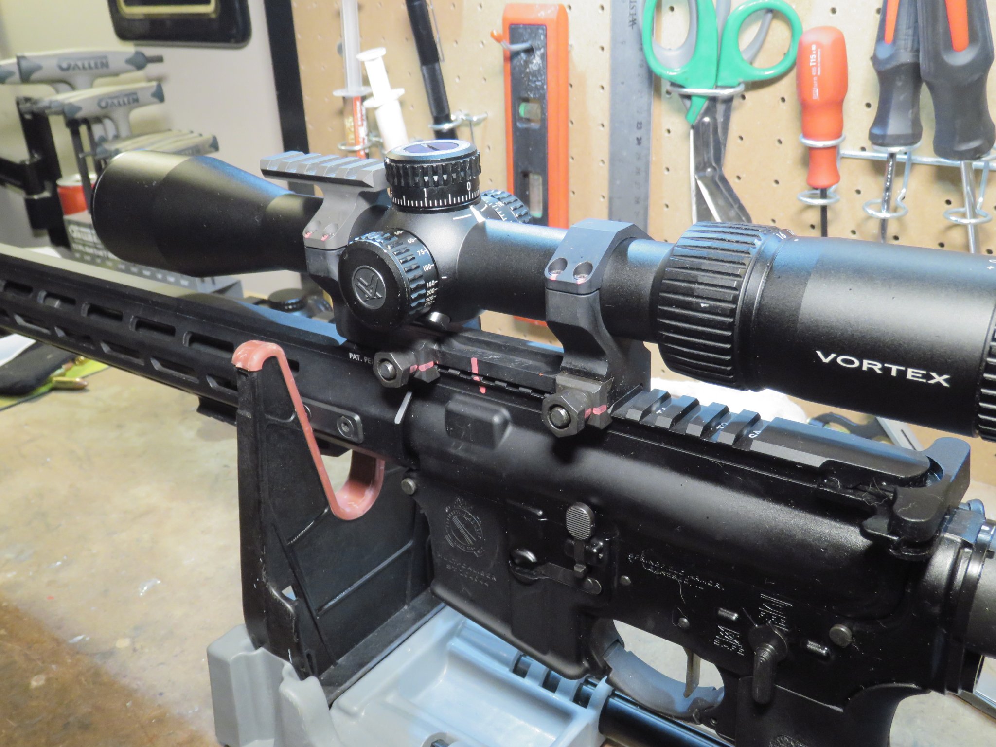

Witness marks are a great idea, if you are worried about them coming loose or moving then that's an easy way to tell.

Witness marks are the way to go if one doesn't want to take things to the (il)logical extreme with safety wire; it's deemed to be an adequate and effective measure for many areas of a race car that don't merit mechanical retention. But if someone wants to get serious:

I do not use Loctite on my Spuhr mount. I apply the specified amount of torque "correctly", there is a right way to apply torque, to the fasteners and witness mark. I check the witness marks before heading to the range. I have not had any loosening.
