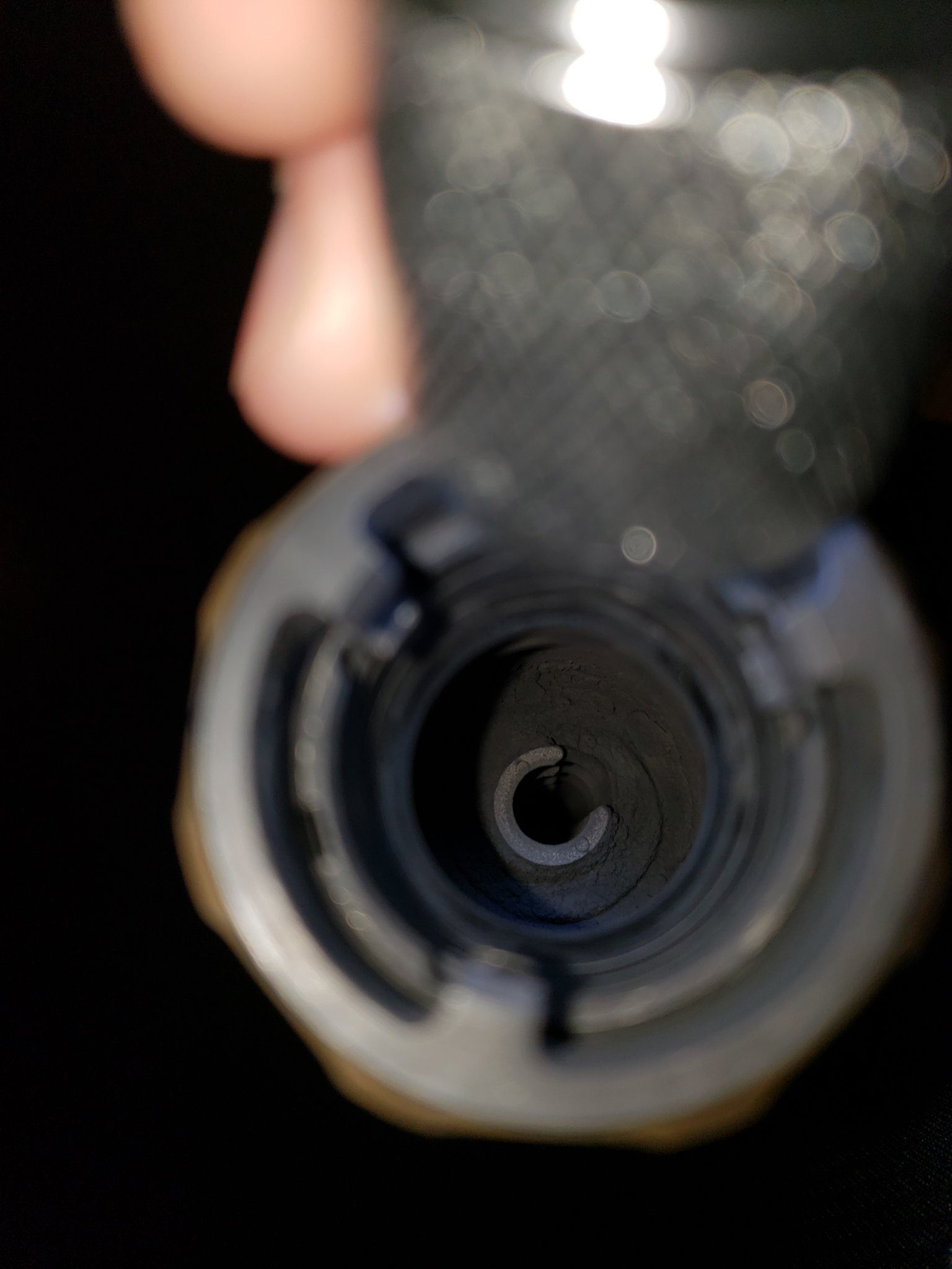

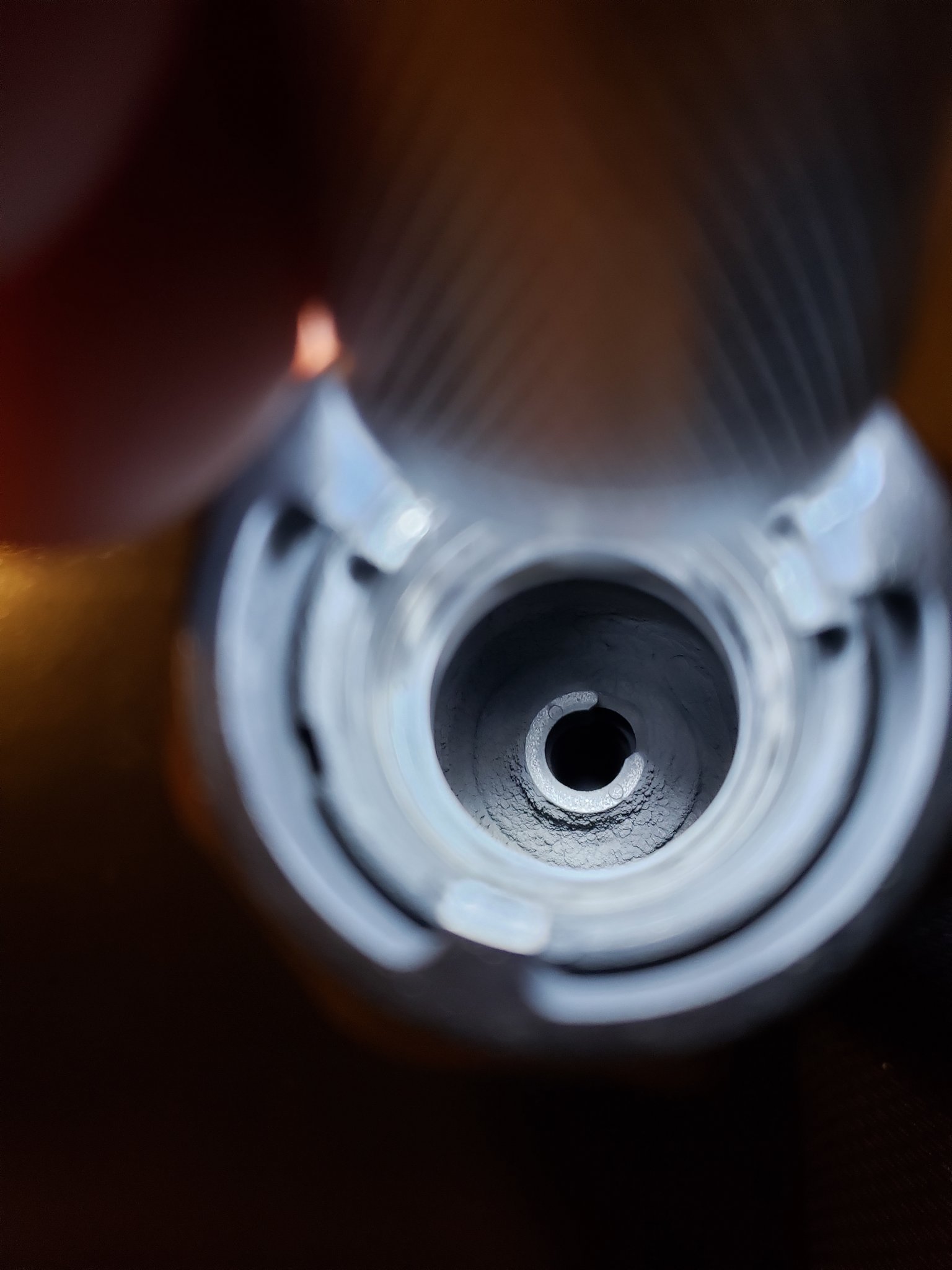

Found it!
Reactions: smoooth1
Meh... I’m filling mine with Hoppes tonight and leaving it for 24 hours as they said. I’ll rinse and blow it out with my air compressor.
if that doesn’t do enough, this guy seemed to have great success with little work.
My sleeve is still intact, but Ill cross that bridge when I get there.
