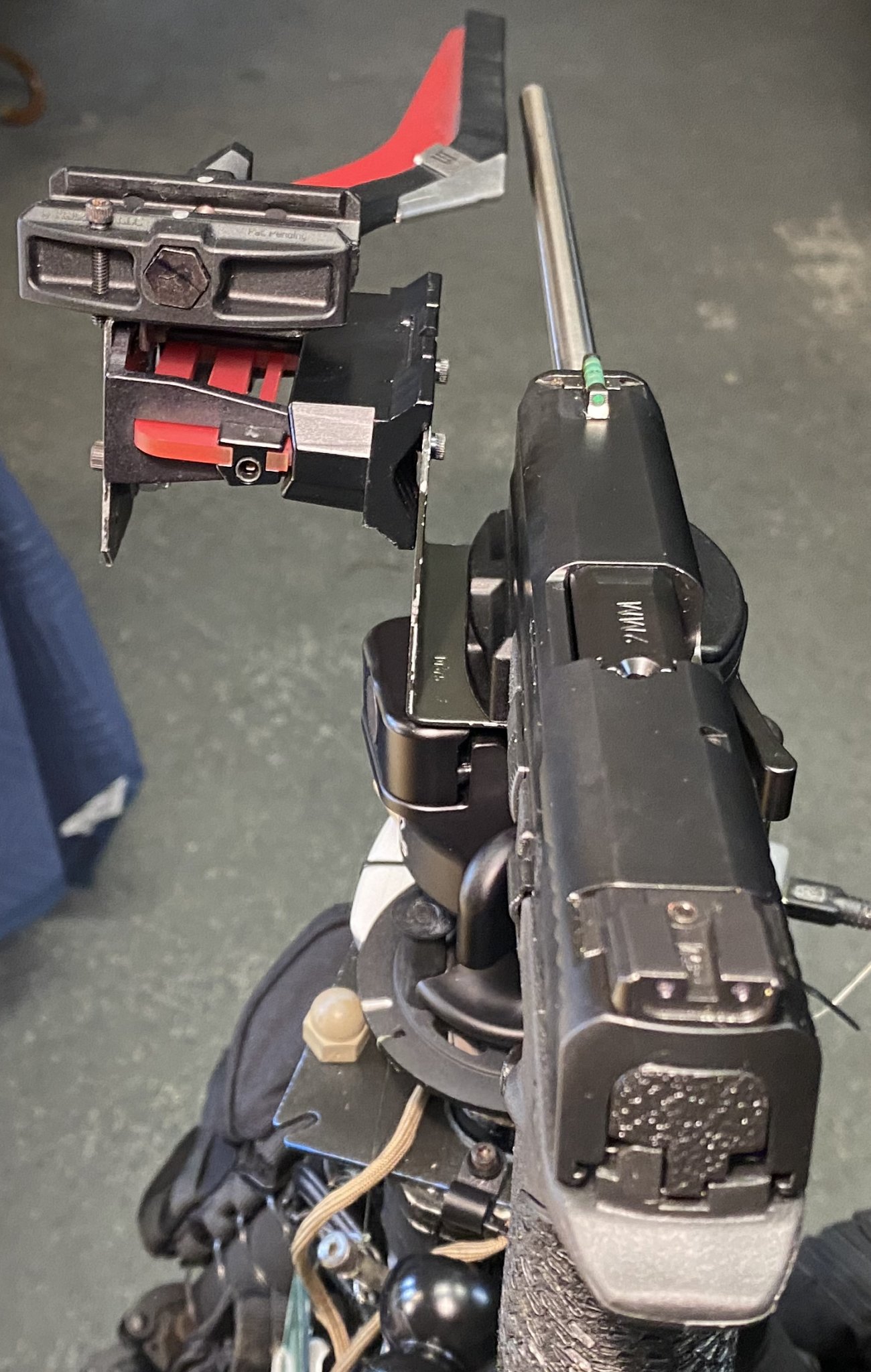

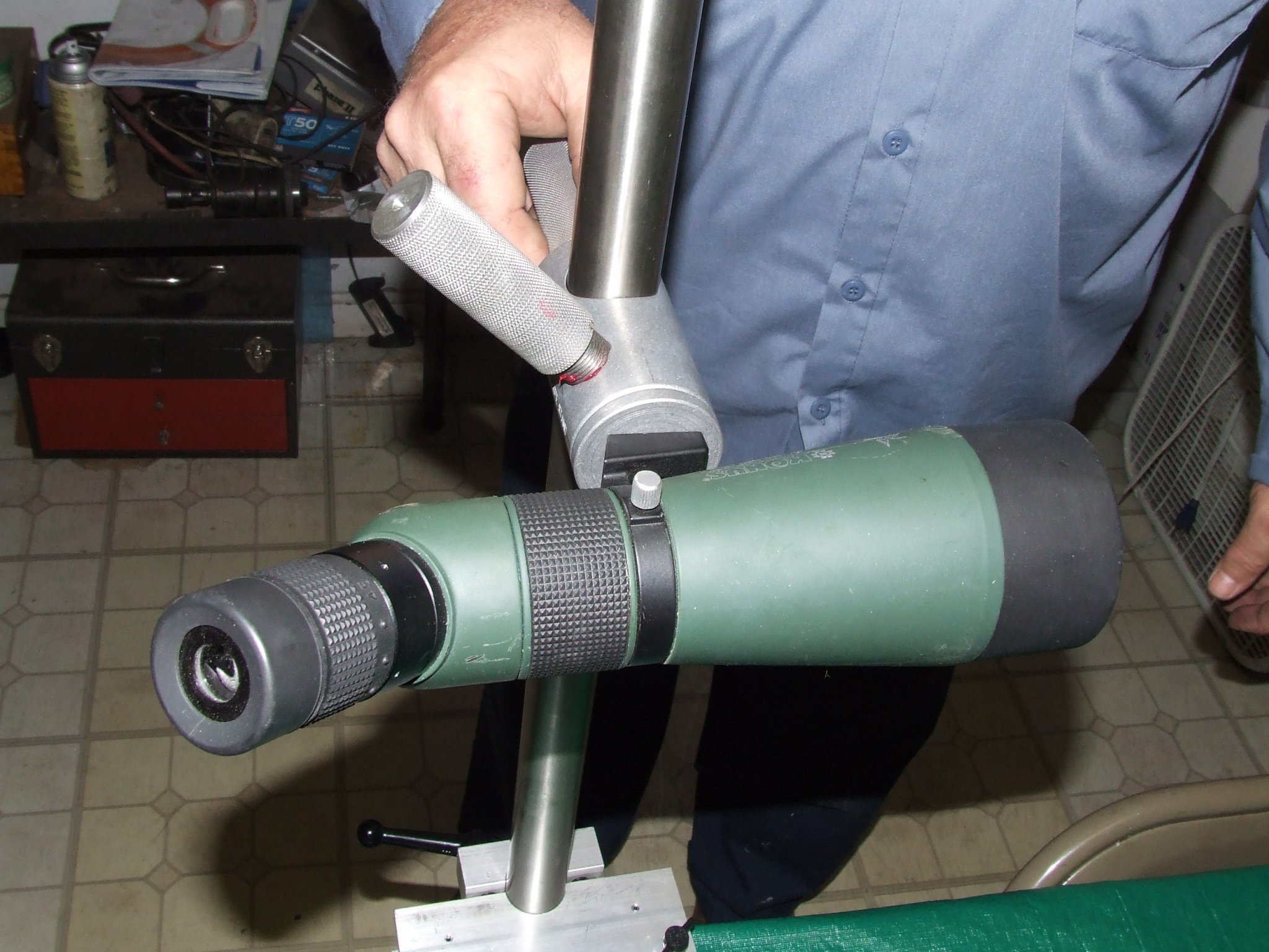

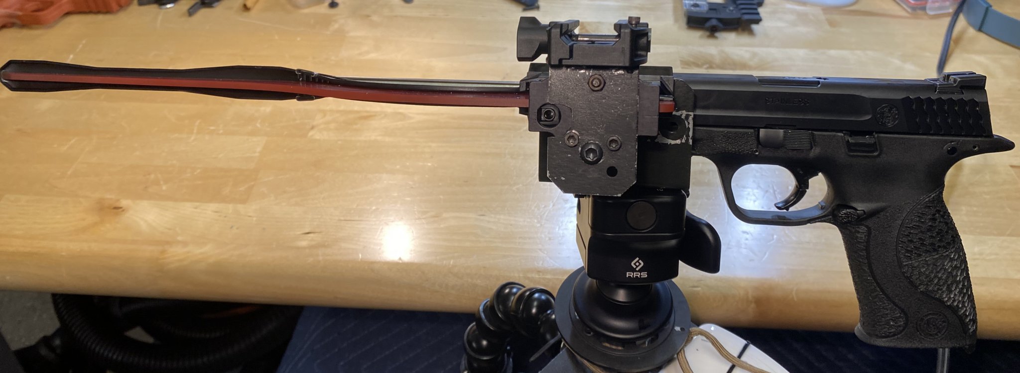

One of the range regulars had 3-d printed a crude iron sight that screws into the top divot on the Labradar. With that little peep sight set up, the radar hasn't been giving me any issues.

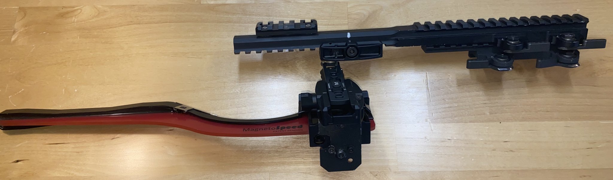

I started with the MSV1 then quickly adopted the V3 when it was available.....strap hanging the device from the suppressor complicated things for mechanical stability. Soon thereafter began developing a rigid 4-axis adjustable free float rail system to accommodate suppressed shooting ( a number of forum members were also parallel developing their own versions for all the same reasons). It was a marked improvement, not bomb-proof as I still managed to whack a V3 bayonet when I was too lazy to check the muzzle-bayonet deck clearance every 5-10 shots. Also, the V3 has a pathetic and very limited method to use with pistols, so this year I fabricated a pistol mount connecting the V3 that was also able to be mounted to a tripod for precise zeroing of red dot optic fitted pistols. Was able to finally get a LabRadar in April after 6 months of looking, contacted the company and was informed a supply-chain shortage of software chips was bottlenecking production. They hinted at their largest distributors would be getting a shipment in early April, they were accurate with that forecast. Snatched one up, a few hours later, none to be sourced. I used the LabRadar with JKL Precision trigger so I don't need to be concerned about device-muzzle location relationships; it's worked very well to date; using in conjunction with LongSHot 2 mile high definition target camera, the combination is very user friendly.
I prefer the LabRadar for simplicity of setup, although have not used it with pistols yet.

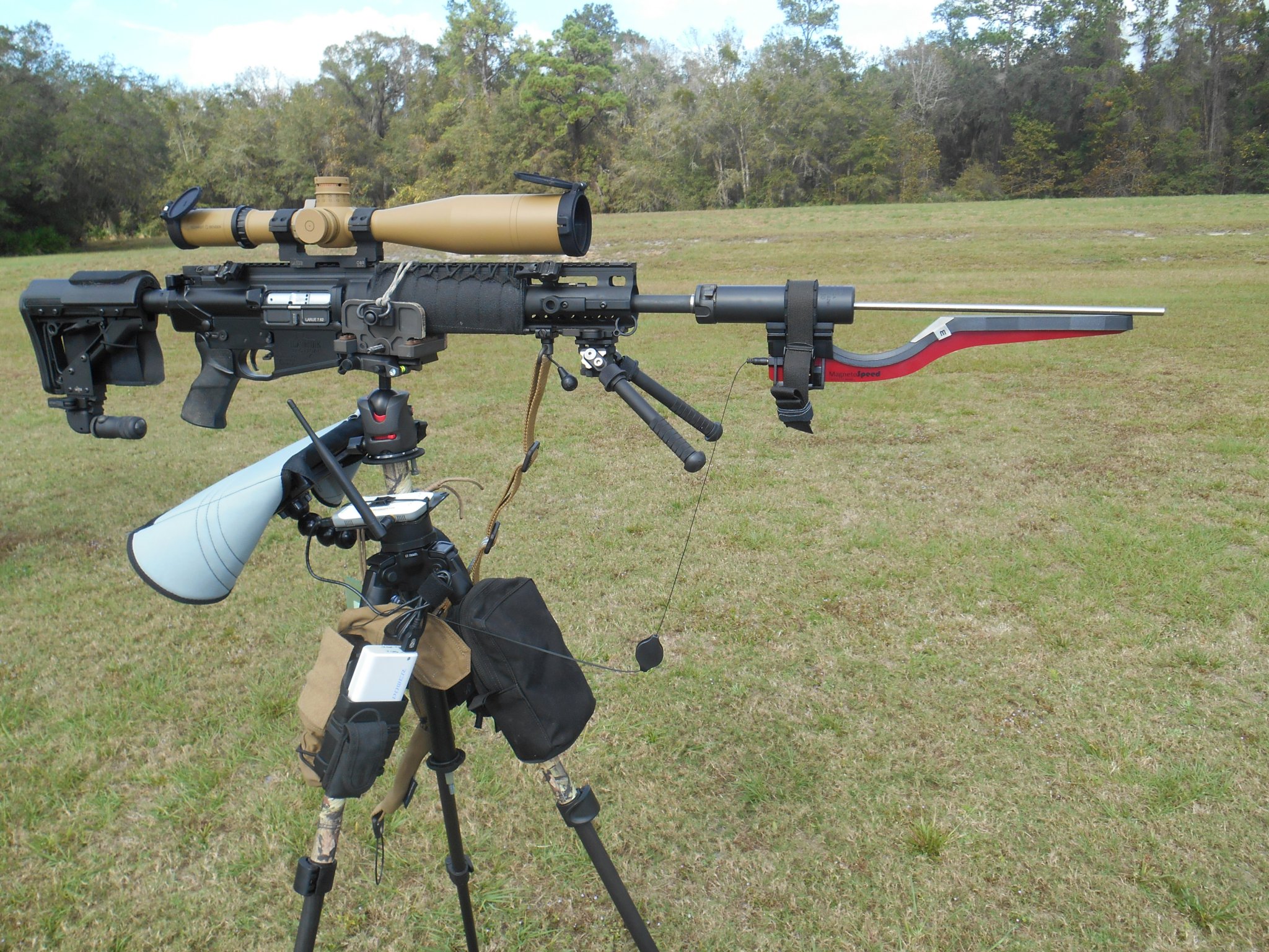

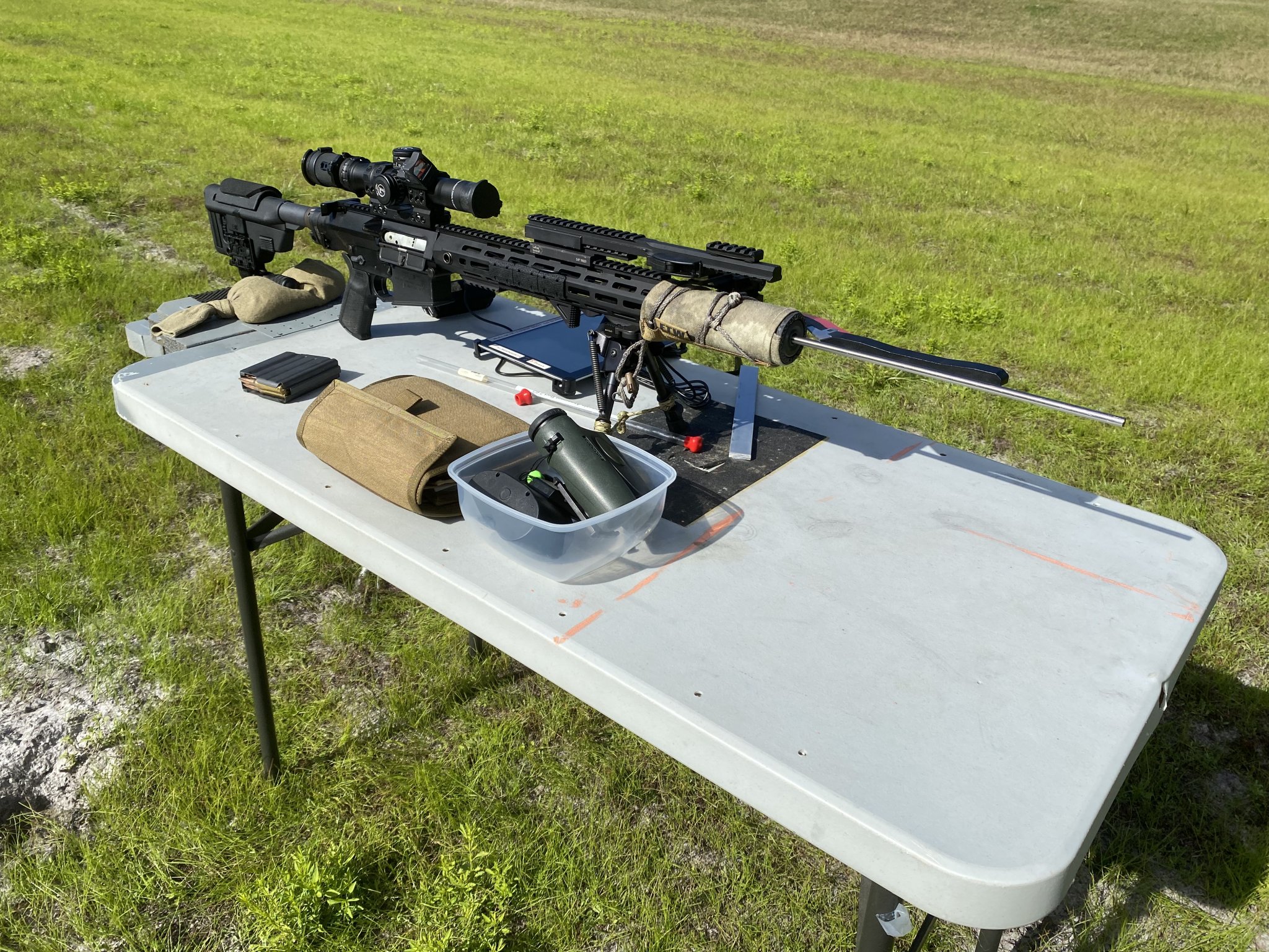

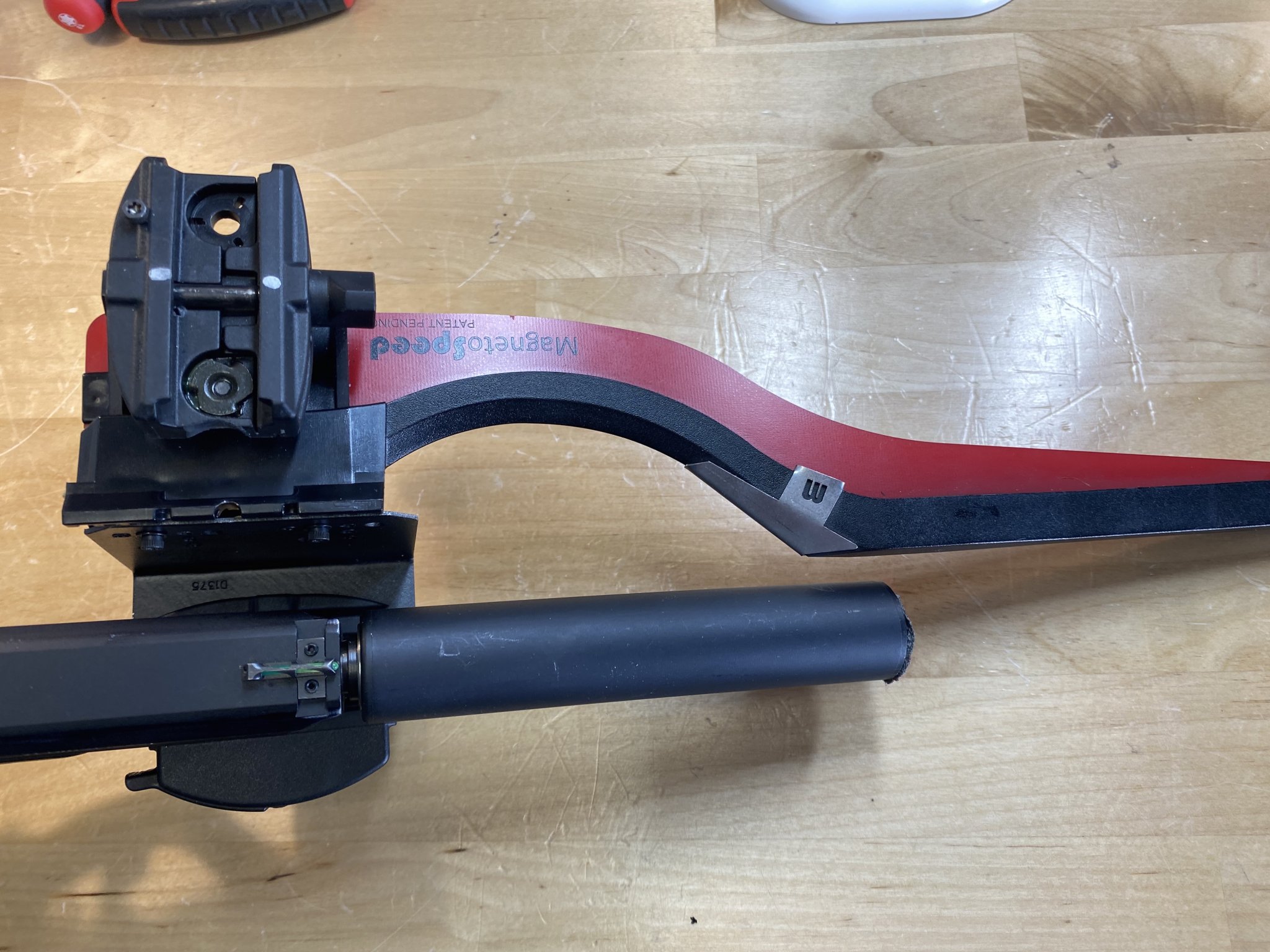

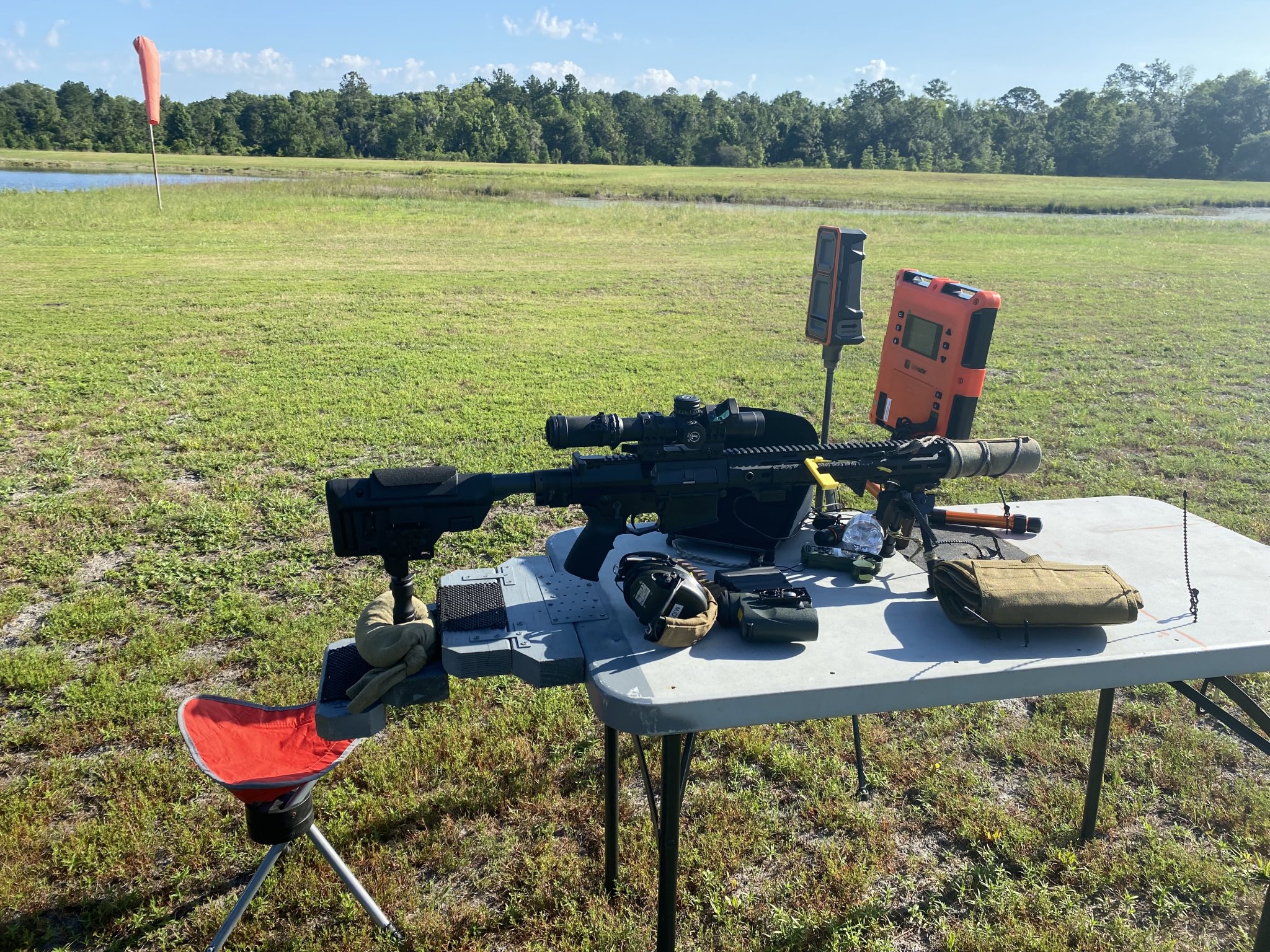

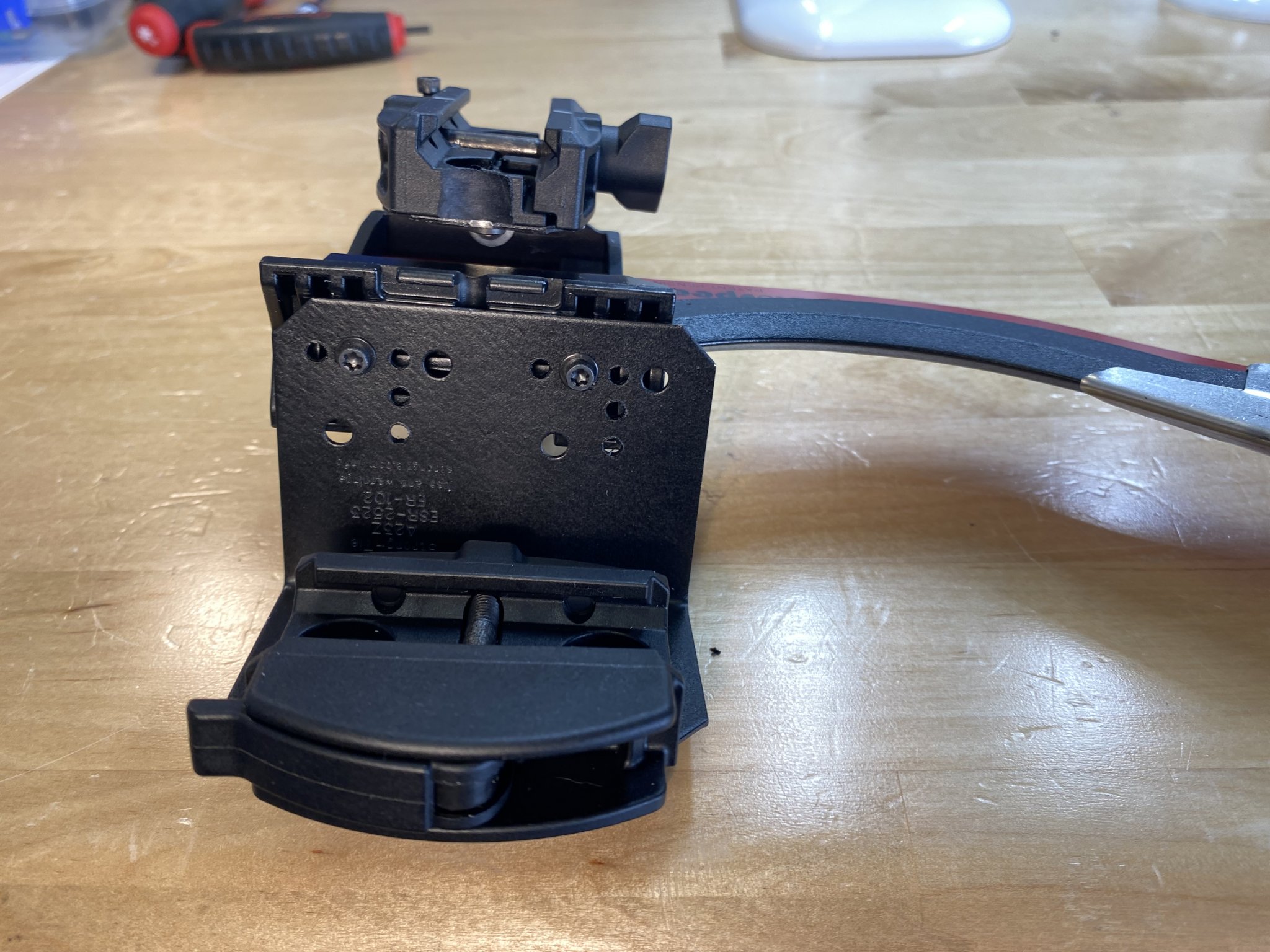

A few photos of the journey.
16" LaRue OBR
KAC 14.5" ACC
Pistol-V3-RRS tripod setup

IMG_0432KAC SR-25 MagnetoSpeed V3 Mount Modifications for No Gap Suppressor-Rail Photos 08.17....jpg

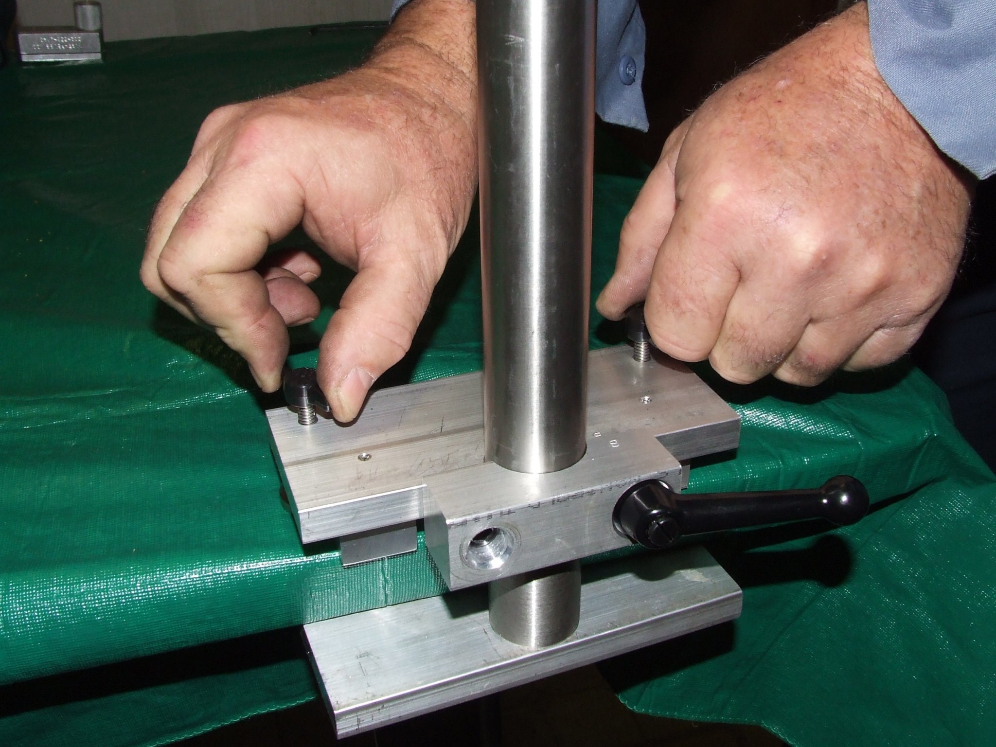

I have my Magnetospeed installed on a Wiser Precision mount. Everything is pre-adjusted. I promise you I can slap it on the arca rail and ready to record in less than 10 seconds.
yep, for sure. With the mount, it's stupid simple.

You should. I have used my Magnetospeed for years on the barrel but recently got the Wiser Precision mount and kick myself for not doing it earlier.
Reactions: rijndael
That new Wiser mount looks a lot nicer than the one I have, it was the prior generation. I got sick of it and I’m now using an MK mount.
Not sure about the older version but this one is super easy to use and adjusting height of bayonet is super simple and you can adjust angle back at the Arca mount area. It’s really a great tool.

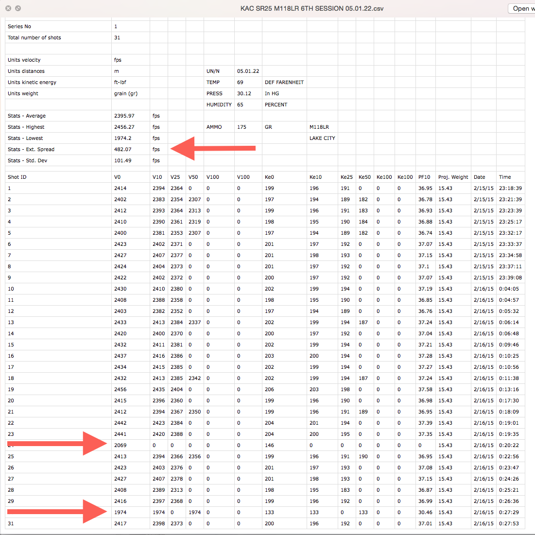

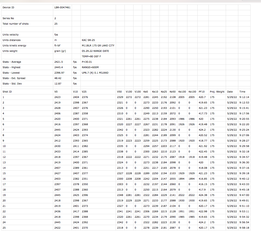

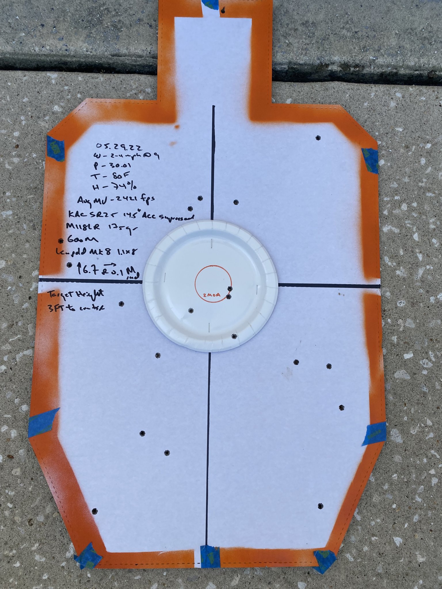

Thoughts ?? about this recent LabRadar data set; KAC SR-25 14.5" suppressed; Lake City new M118LR 175 gr all from same bunch; 2 outlier data points 400 fps off the anticipated MV (~ 2410 fps) based on same / rifle / environmental conditions / lot # of ammo ....aiming for the head @ 600M and hitting the target in the big toe with those rounds.

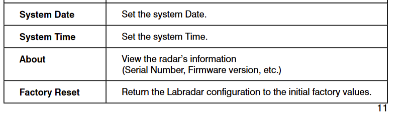

Does anyone know how to correct the factory default time / date in the last two columns of the data output?

Thoughts ?? about this recent LabRadar data set; KAC SR-25 14.5" suppressed; Lake City new M118LR 175 gr all from same bunch; 2 outlier data points 400 fps off the anticipated MV based on same / rifle / environmental conditions / lot # of ammo ....aiming for the head @ 600M and hitting the target in the big toe.
Clean your data up, both of those are invalid.
If using a recoil trigger you can get these, the clue is no 2nd yardage or repeating velocity at multiple distances.
With a semi get in the habit of disarming the unit when changing mags or manually operating the bolt.
Also for what it is worth you have very poor alignment of the radar to the target unless the lane was just that cluttered. a .30 cal should have little issue returning readings well past 100 yards.
ETA:
And yes not really the thread for this.
RTFM

If you're using a Labradar the sight will pay for itself. Many print them after I started selling, none are to the quality nor durability of my MJF prints. I DID NOT come up with the smart idea of the Labradar sight, but I do feel my version is the best mousetrap and highly refined!

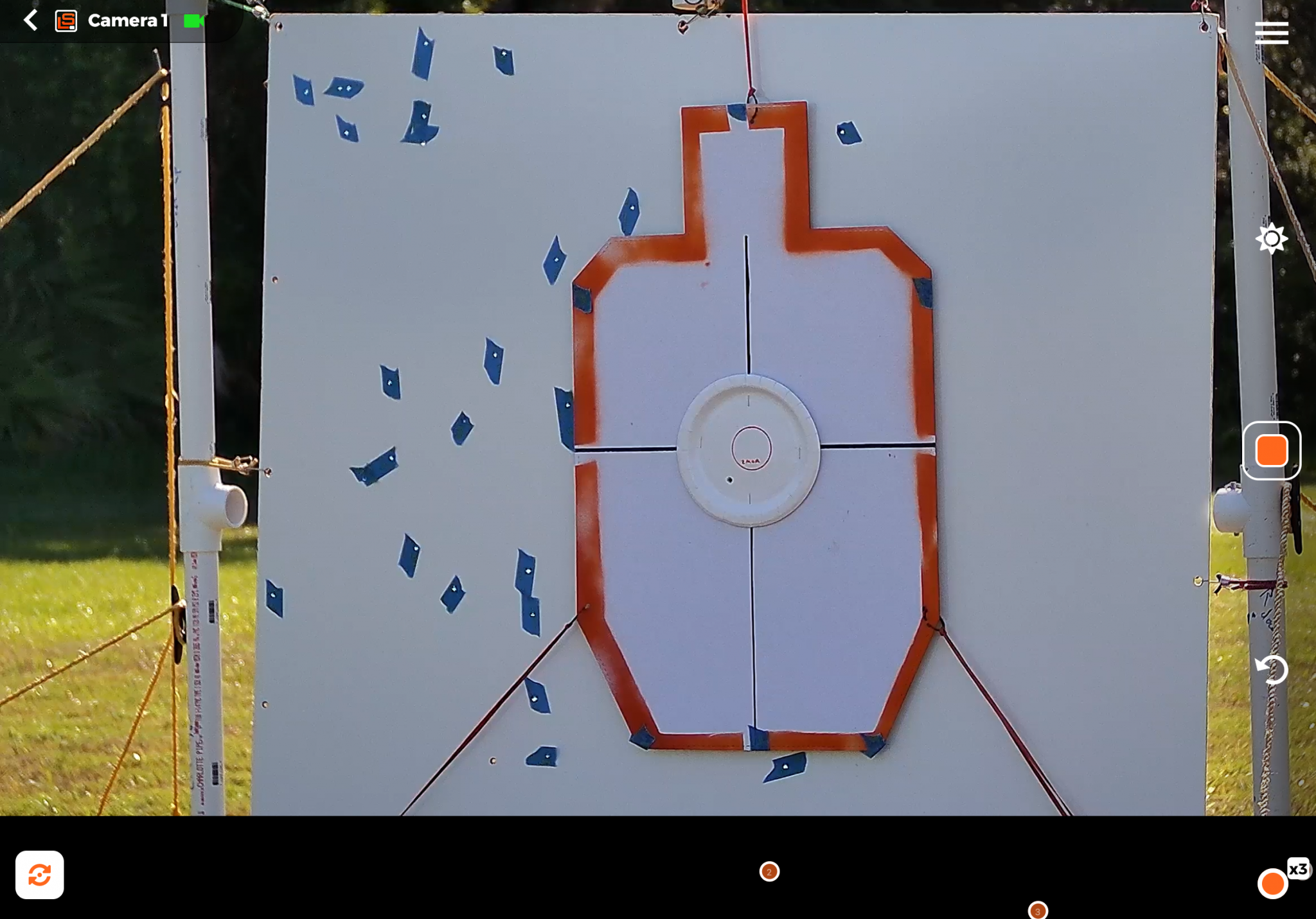

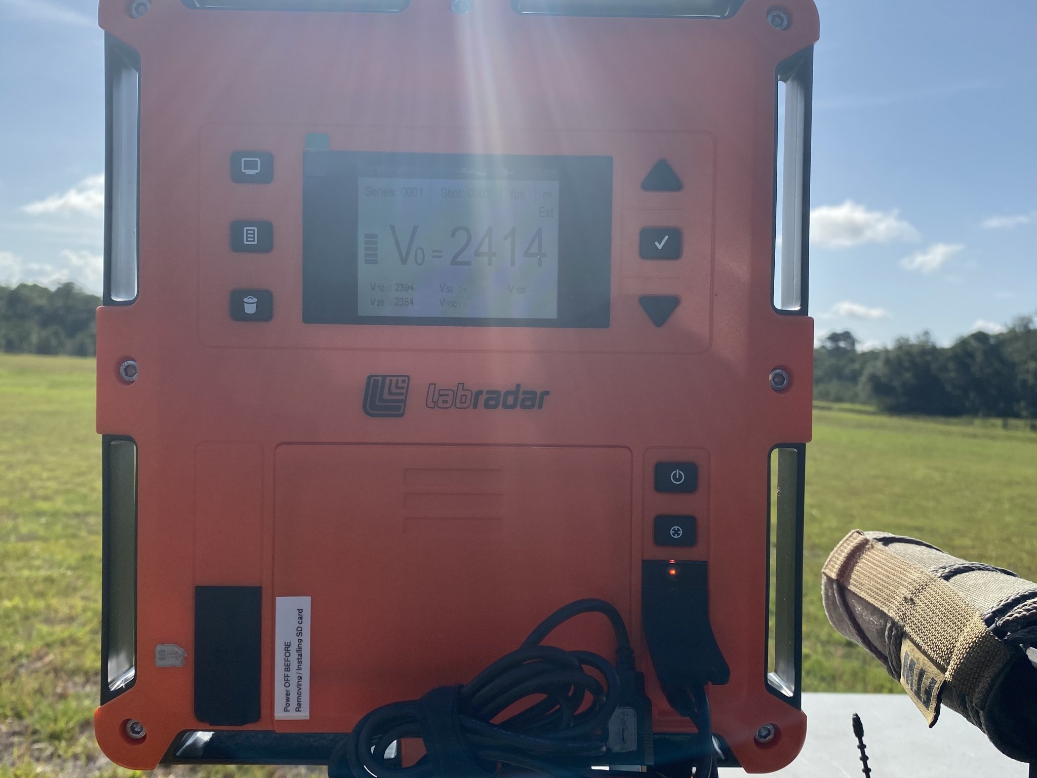

Only the second time to the range with LR. During setup, implemented the advice of above members; this weekend much improved velocity down range acquisitions. Only 11/25 measurements @ 100 meters, which is inconsequential to my purposes, but a nice improvement nonetheless. It seems duplicative ? is the output supposed to list 2 columns of v100 ? First cold-bore shot pretty good. Thanks to those that advised.

Only the second time to the range with LR. Implemented the advice during use of above members; this weekend much improved velocity down range acquisitions. Only 11/25 measurements @ 100 meters, which is inconsequential to my purposes, but a nice improvement nonetheless. It seems duplicative ? is the output supposed to list 2 columns of v100 ? Thanks to those that advised. View attachment 7881835
On the unit or in the app you listed 100 yards twice. It is merely a filter of what it displays on the screen, in the app and in that report. Chose another yardage.
If you look in the TRK folder at the individual shot records you will see every distance/time/SNR it got a velocity reading at.
Correct-a-mongo!.....l thought there where only 4 down range distance selections. Wrong. There's five, so i had input 100M choice twice.. corrected it today to include 75M & 100M. Thanks!

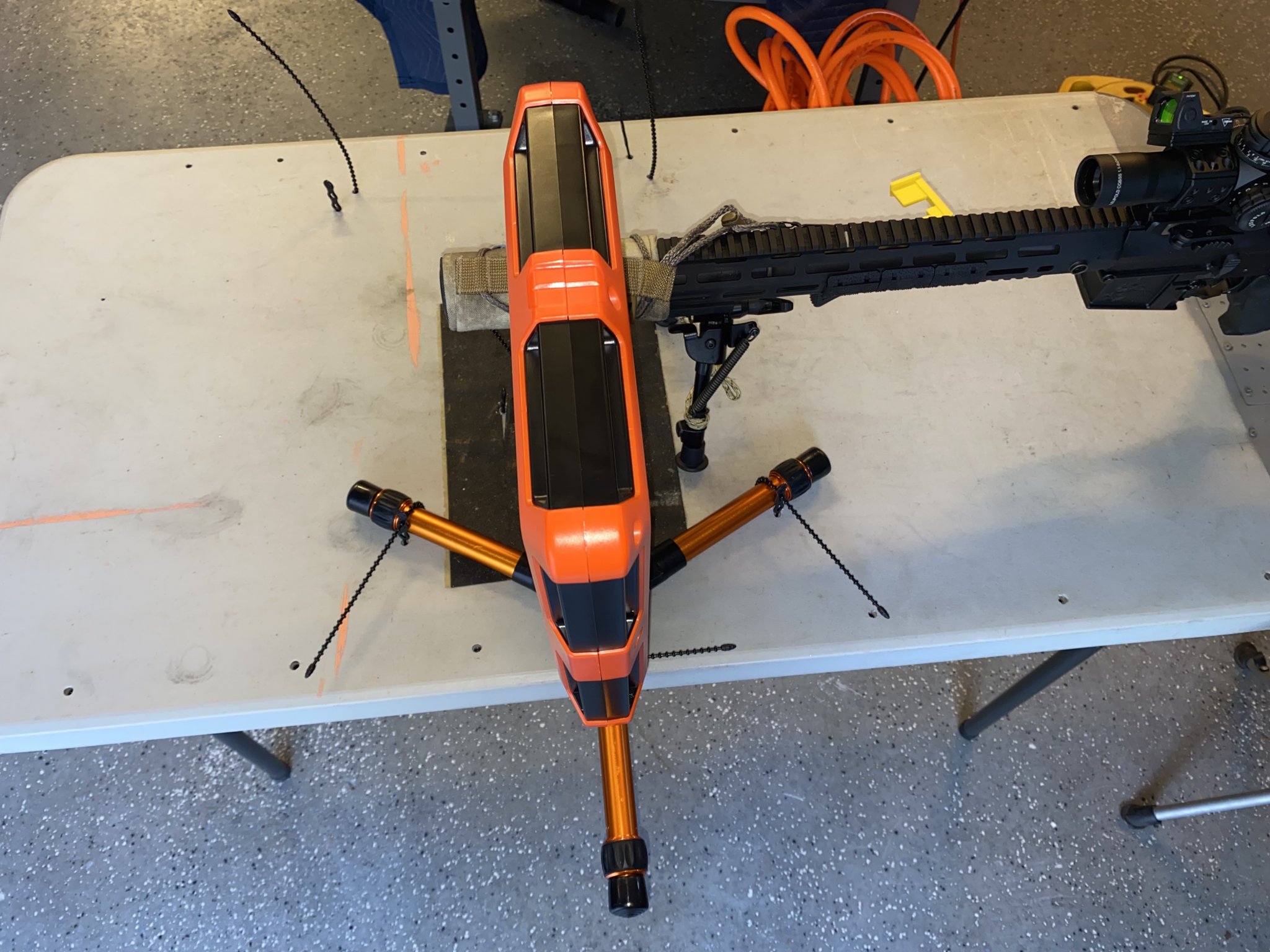

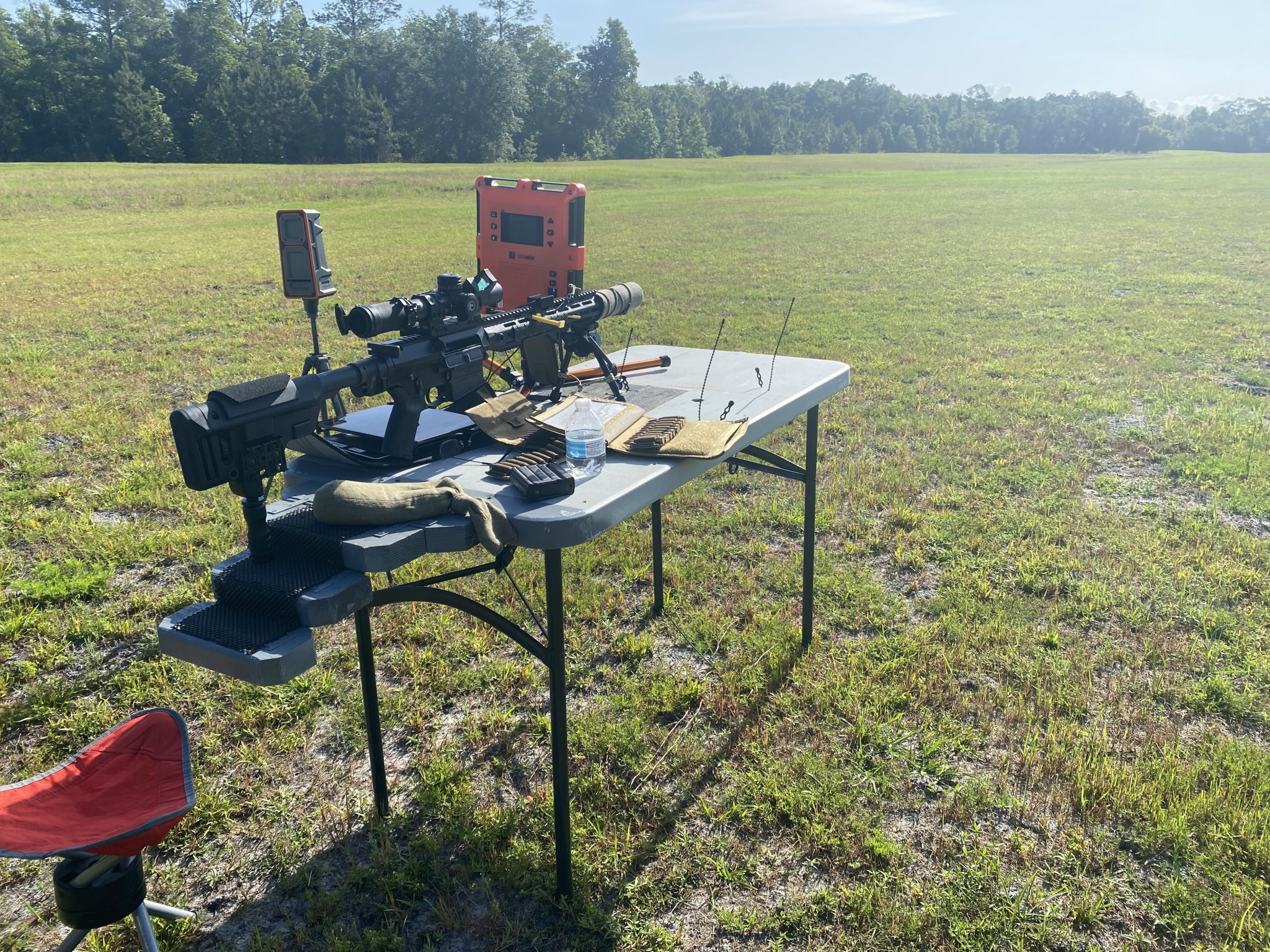

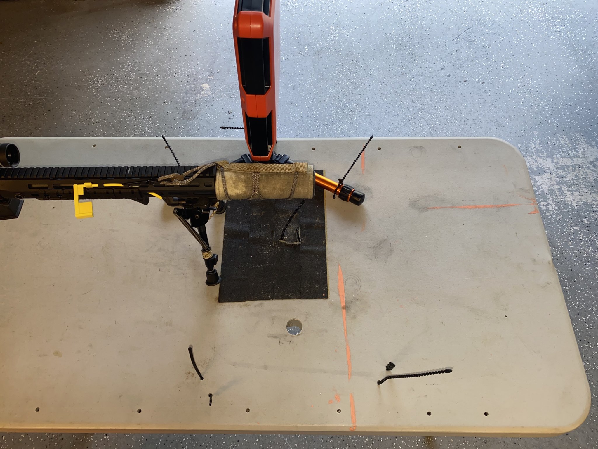

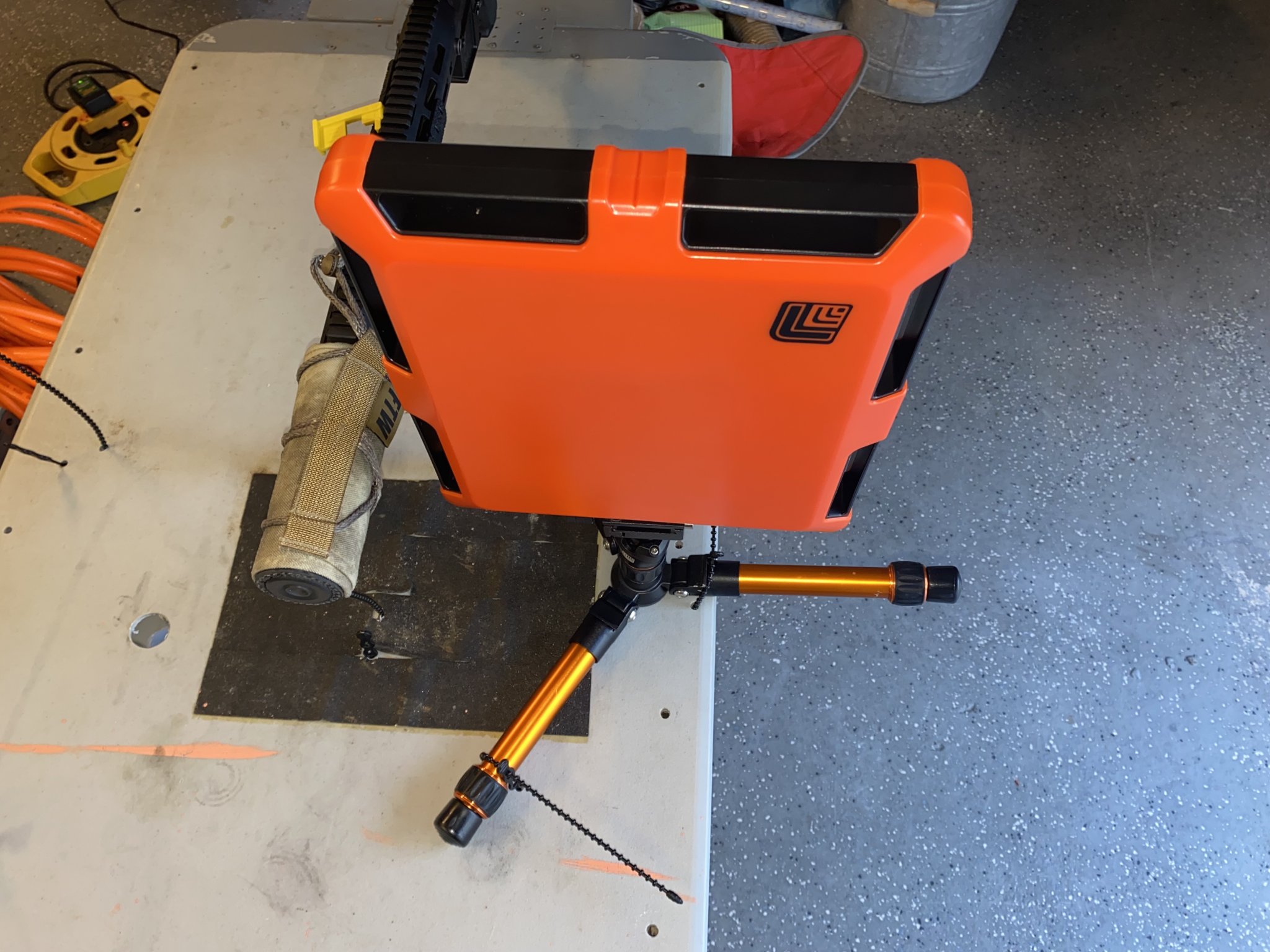

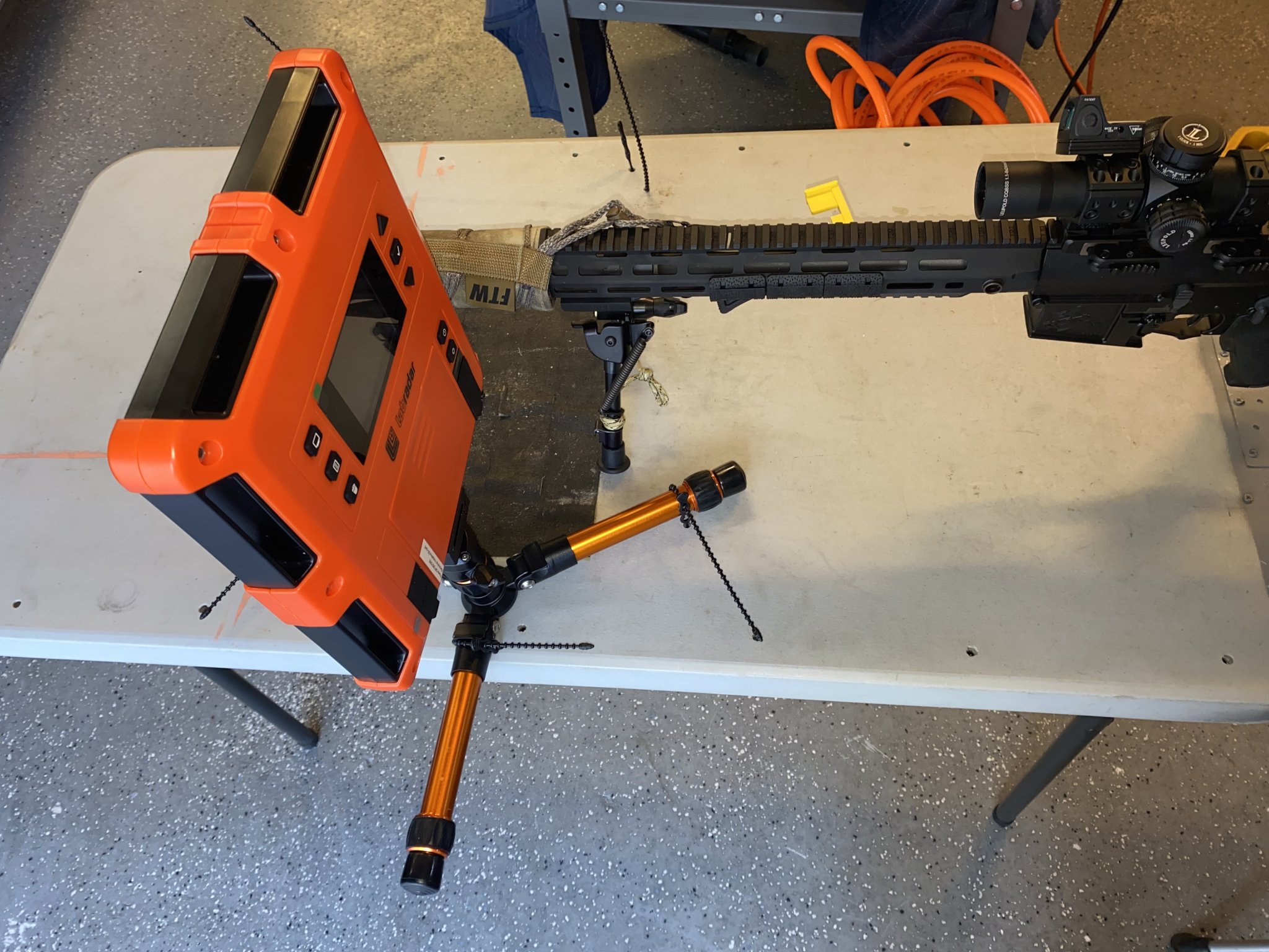

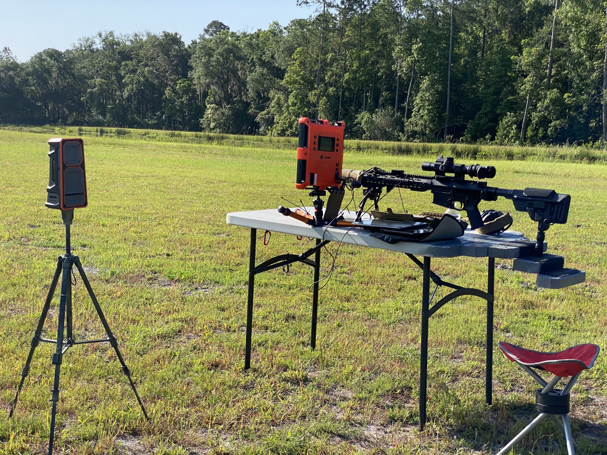

I am using a trigger for the LR, so I was deciding between mounting it on my shooting table or adjacent on a tripod. Decided on just mounting it on the table within easy reach from shooting position to "arm" the system with support hand; bored a hole to accommodate the LR tripod center column and used marine grade tie wraps to hold down the legs of the tripod.

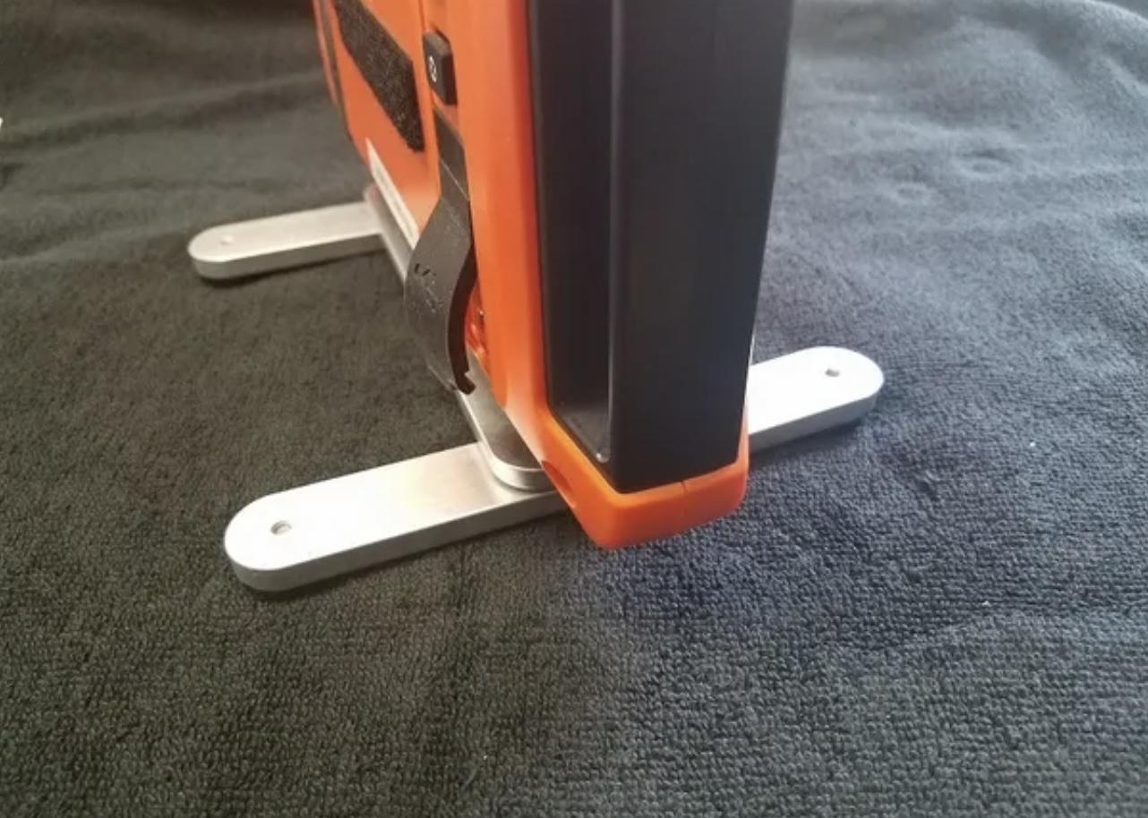

Ok, I don’t even have either of these devices but I dug around and found this base that one could also clamp to the bench so the Labradar won’t blow off.
The following is discontinued, but nothing’s stopping one from DIY.

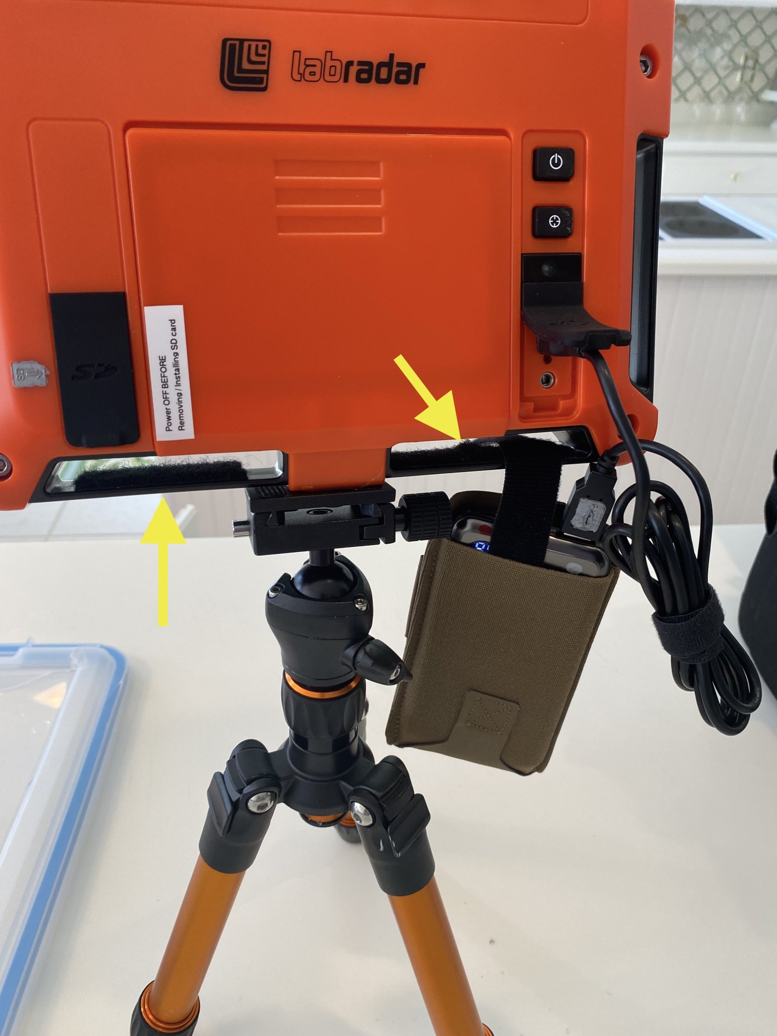

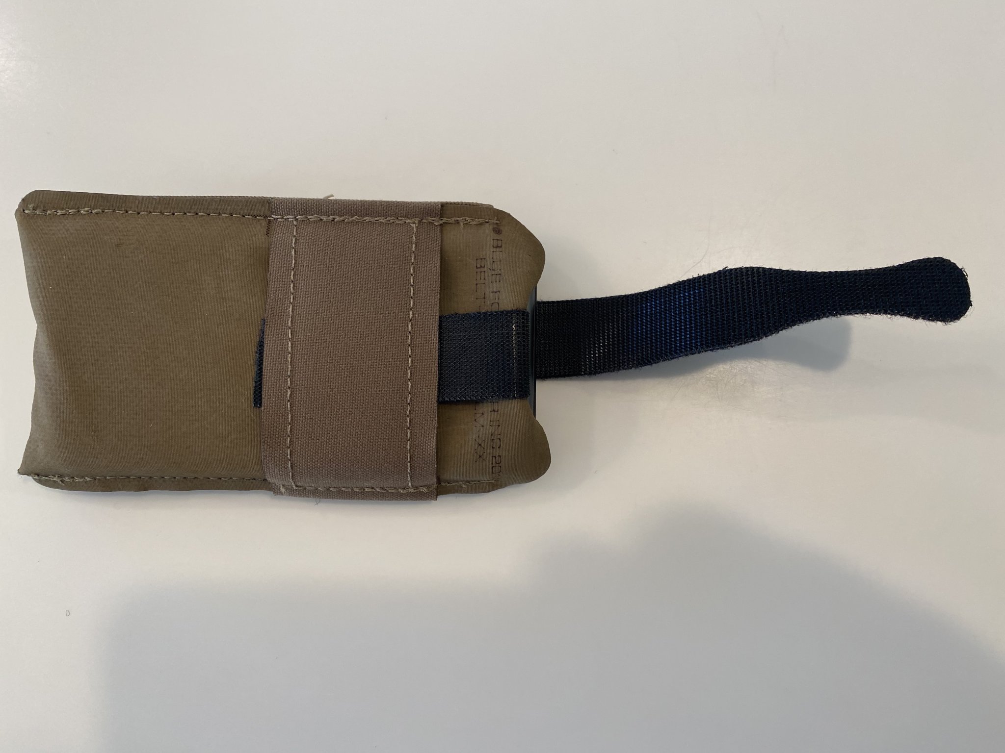

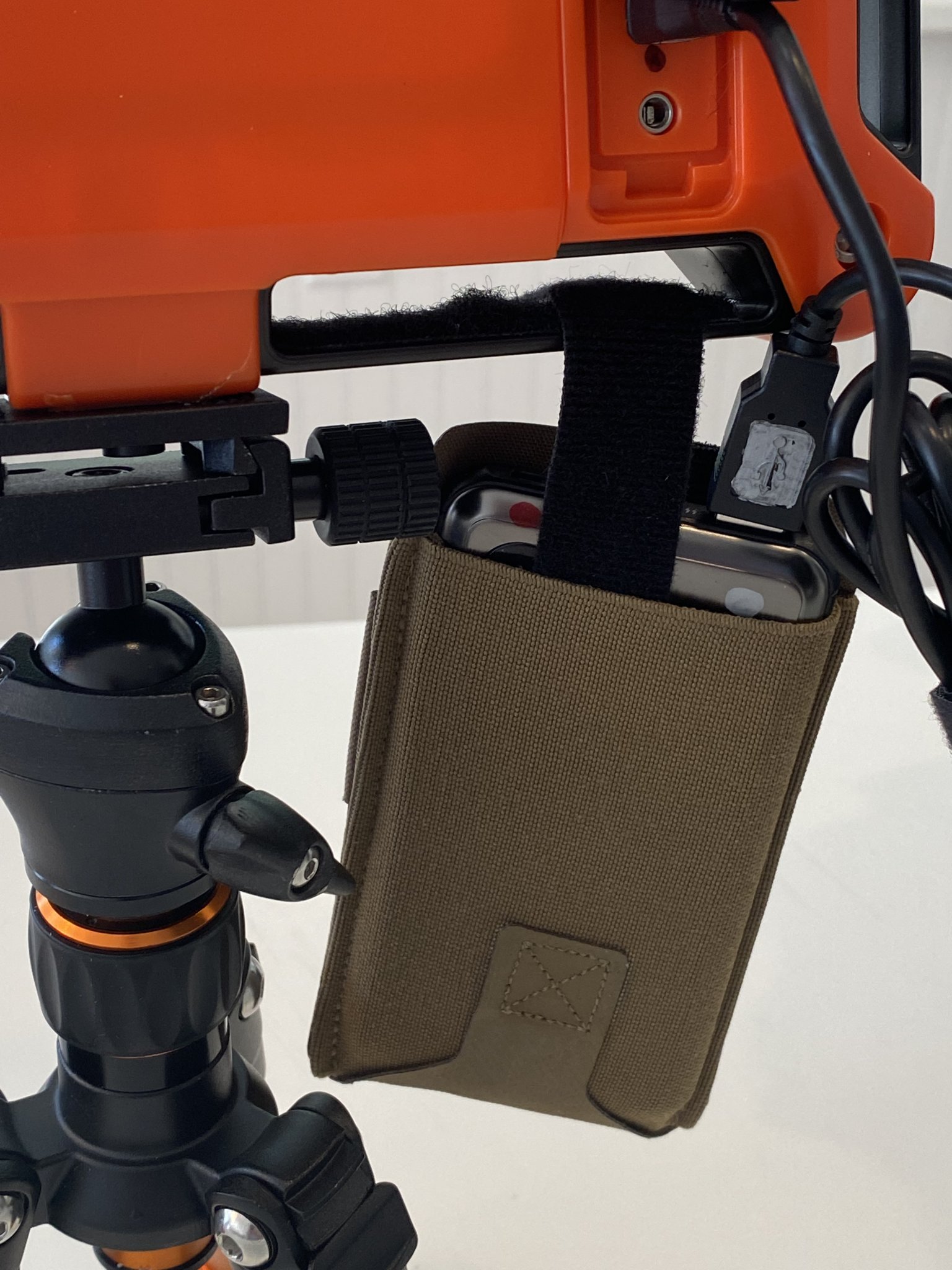

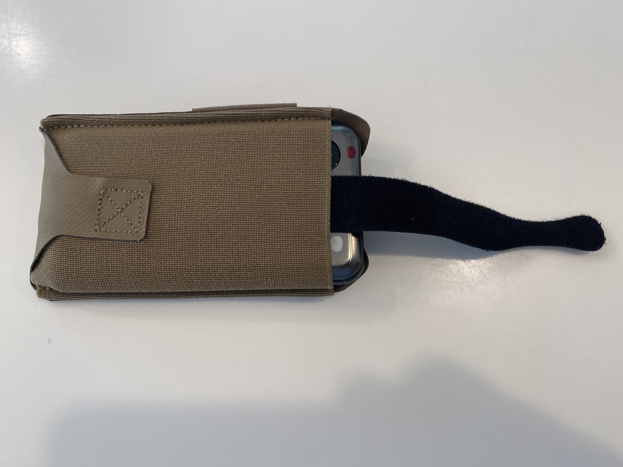

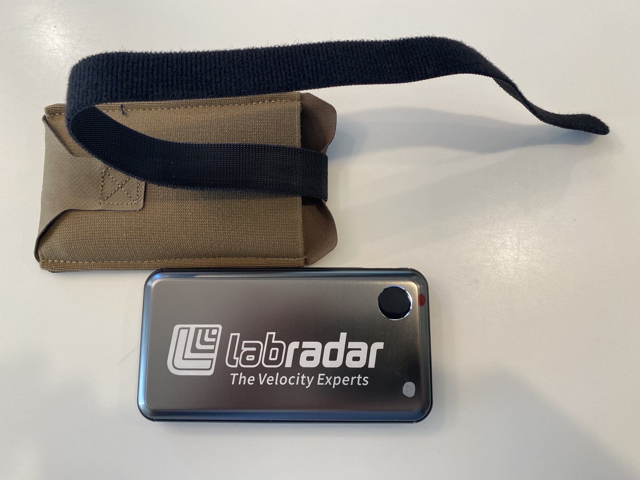

To hold the battery I used a Blue Force Gear pouch with a self-retaining velcro strap that also served to remove the battery from the tight fitting pouch; underside of frame heavy duty fuzzy side velcro attachment points. Didn't like the idea of LR sticky sided velcro to battery attaching to housing. When it gets really hot such tape usually starts separating from its plastic attachments.
