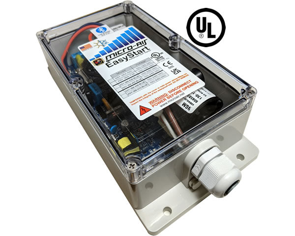

Just to be clear, my "capacitor" thing was specific for the HVAC compressor only. I don't know if they make them for a well pump, but I'm sure that could be easily researched.
Reduced starting systems are made for larger motors, but soft starts are made for all motors & applications. Or you can field fabricate one if you know how. Unless you know where to source the Cap/s ect cheaply you're better off just buying off the shelf. All you need is the motor specs, or in most home applications just the motor size or HP & voltage. The smaller home usage ones can be found on Gay-Bay or Amazon. Many electrical supply houses carry them as well.
re: soft start
I put one of these on the heat pump compressor.
Dropped the starting LRA (Locked Rotor Amps) from 132A to 38A.
Now the genset and solar can start the thing easily.

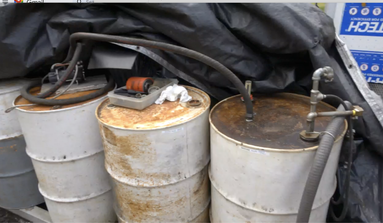

My family would travel every summer from the NY/NJ area to Martha's Vineyard for vacation. Of course, we'd have to take the ferry across from Woods Hole.
In the earlier days, the "Woods Hole, Martha's Vineyard and Nantucket Steamship Authority" ("Steamship Authority") actually still ran steamers back and forth (they're all diesel powered now). The last steamer in service (the SS "Naushon" , formerly the SS Nantucket), was fueled with #6 Bunker C. It had to be heated to 135˚F before it could be pumped off the truck. I happened to be there once as the Naushon was preparing to leave port for the first time that day and saw the #6 Bunker C truck delivering fuel to the vessel.
These days, the terminal itself gets a delivery of diesel fuel from the "Diesel Direct" truck 3 times a week. It appears to be delivered to a central storage tank underground. I am therefore curious as to how the fuel gets from that storage tank to the boats. I never see any of them fueling. Furthermore, for the boats that stay overnight on the islands, how do hey get fueled?
Woods Hole Terminal. The Diesel Direct truck usually gets there between 7:30a - 8:00a, MWF.

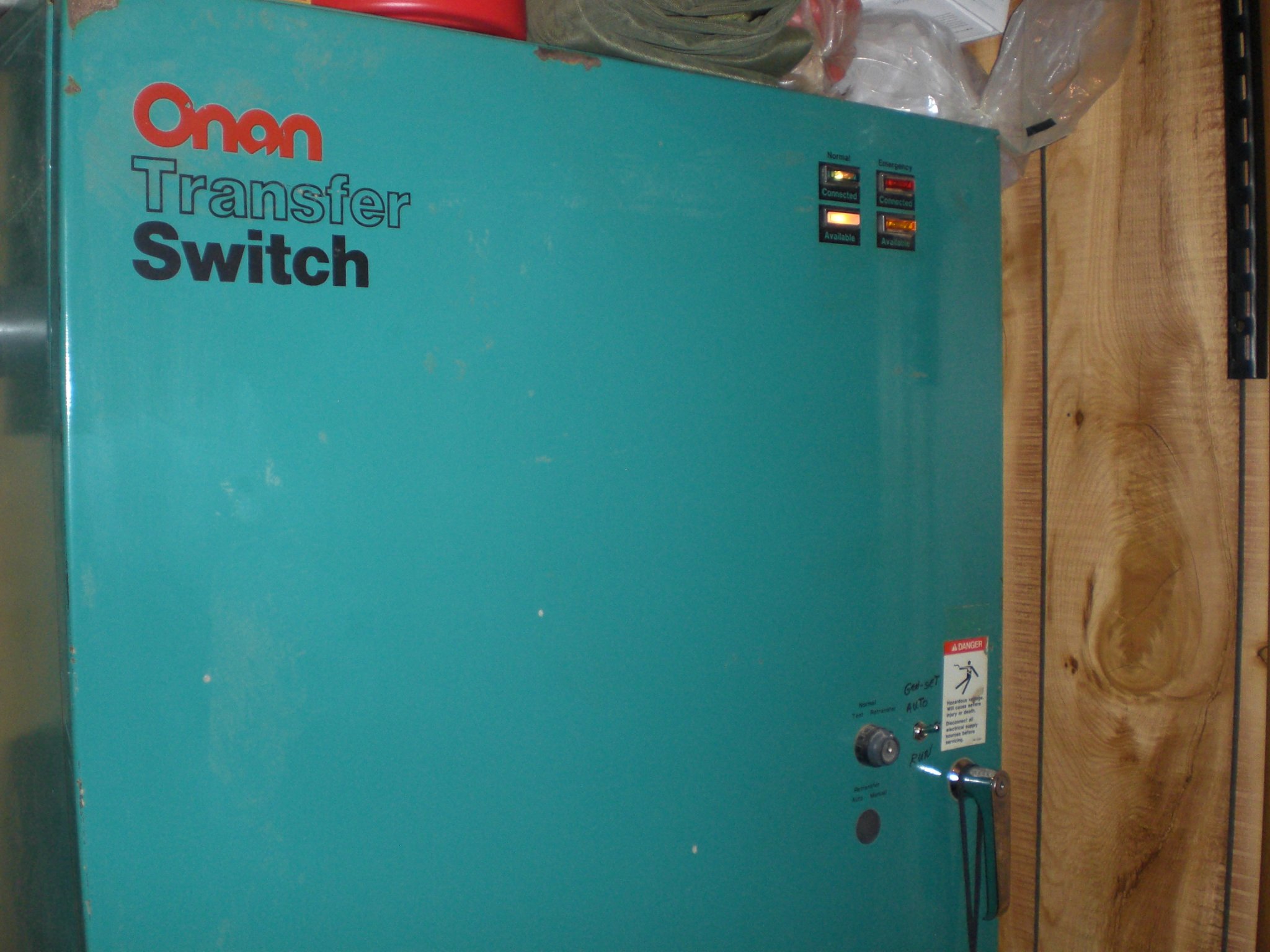

The transfer switch and wiring it with auto and all can be tricky and is often done wrong.
That is an understatement even in the commercial & to some extent industrial side. I was in the field for over 50 years on rope to compressed air start. Mostly all black start but some otherwise. Some things I would find on commissioning would curl your hair, and just when you think you had seen it all, along came a new papered E/E or E/contractor that would prove you wrong.

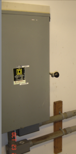

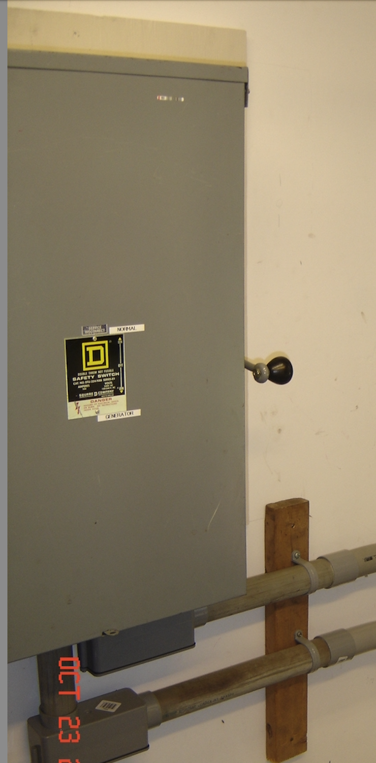

I did the electrical on the Fire Station #1 in Melissa, Texas. They had a portable (on wheels) generator.
And a manual transfer switch. That may sound hick or stupid but I think it is excellent. What if power problems were fluctuating? No automatic TS to mess things up. Also a good idea because that fire station is also the Emergency Command Center when needed.
A properly set up ATS will not return to normal until the power is stable for X time target that is set on the return to normal timer. Also many ATS's and especially the 4 pole's that break the neutral have a demand or preferred source option. This allows the facility to be completely off the grid when bad storms are coming or passing threw. EPG (electrical power generation) has a level technology than most out side of the industry are unaware of. Even if all the control's are smoked in an automatic transfer switch, quality units can still be used as a manual switch. Service entrance rated switches, and many others have a ton of options to include Automatic load shedding/adding, phase sequence, power factor, all the voltage & hertz target safety's, reverse current, neutral current set points, elevator call ect. When buying EPG gear its like buying hay for a horse, you can buy it before it goes thru the horse or after. When people buy based upon a price point, get the shovel out you're going to need it, normally at the worst time.
Yeah I like that a lot. That's basically what my set up is I just do it with a twist lock plug and of course they have a much bigger genny but there's a LOT less to go wrong with a manual switch.

Yeah, the hvac units that we put in our super high efficiency homes have the ability to detect genny power vs reg power and only run at 20% or whatever you set it to. There's lots that can be done but there's not a lot of folks that know how to set up the bigger transfer switches and all that stuff correctly. They are really cool when they work correctly but every added feature or programing ect is another thing to break or go wrong when you need it to be right too, so I have some mixed feelings on it all

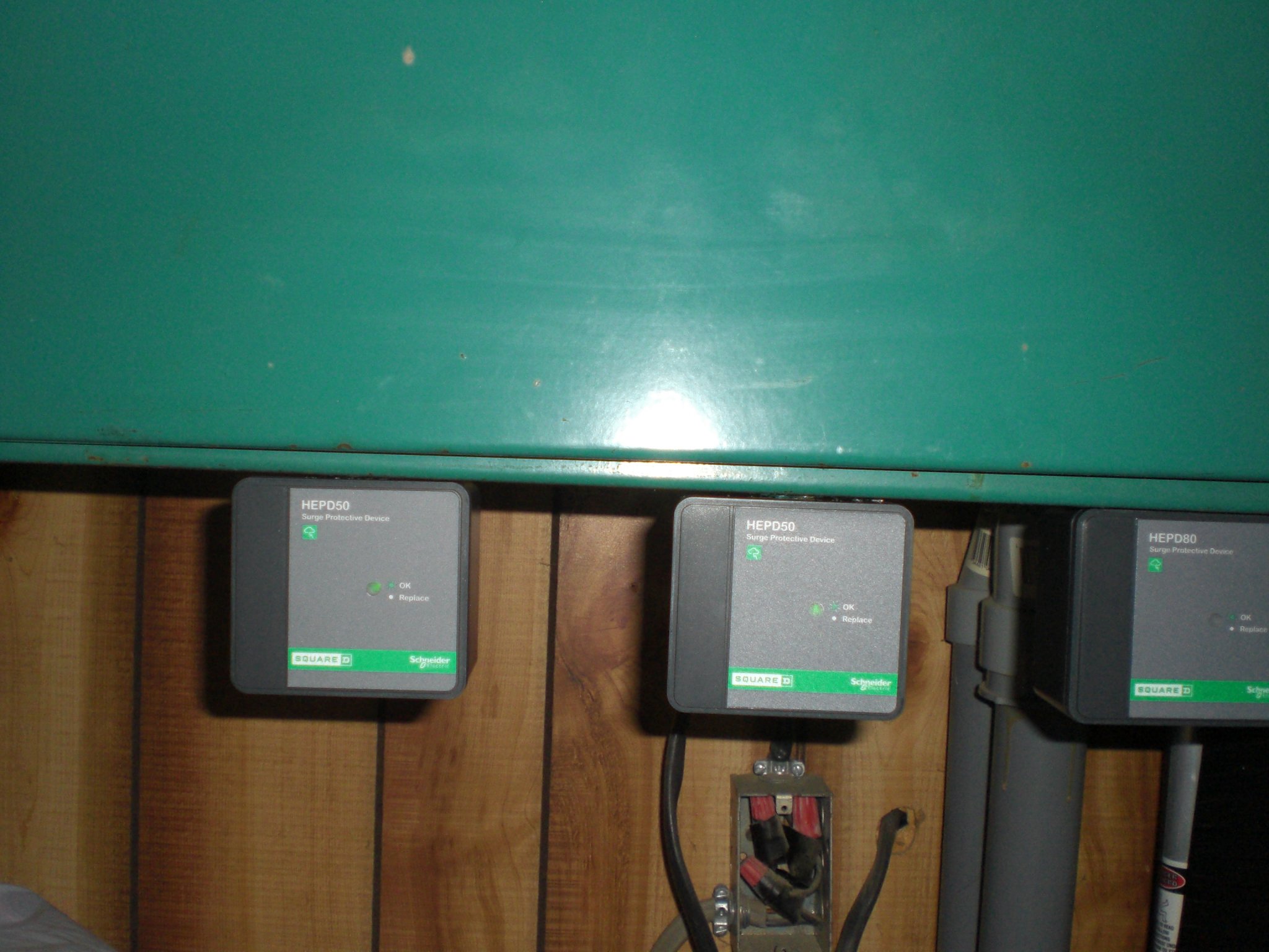

Naw, setting up a ATS is easy. The one that is in my home has been here for over 30 years and its never given trouble, even with up dated controls. Then again its a quality switch, also. The biggest issue with any ATS is improper or improperly installed lightening protection. You'll see three surge units on the bottom of mine, one each for Normal power, Load, & Generator power. These need to be changed out at least every 8-10 years, or when the status indicators read a fail. They should be tested each ATS service but most people never service their ATS let alone the surge units. What most power company's install on their poles are just about worthless. A quality switch gives little trouble, even if set somewhat wrong, but the cheap stuff even set per spec is trouble some even with quality service.
Reactions: W54/XM-388

With my ATS I also have a big twist lock tied into my panel in the garage which I can back feed if the ATS shits the bed.
I can take 75amps 220 from the front of the enclosure and plug it right in., there is some smaller stuff too but that the biggest plug in there
And a fuck as all heavy length of s cord to go from genset to garage spooled up and tied up.
Close off the street power and still pull enough to do almost anything you need with in reason.

Decades ago, I had a WINCO (Ward Leonard controls) ATS connecting the house/grid/genset.
When parts for repairs (contactors & related) became crazy expensive,
I replaced it with a Square-D manual transfer switch.
For a small residential application, sometimes simple is good!
