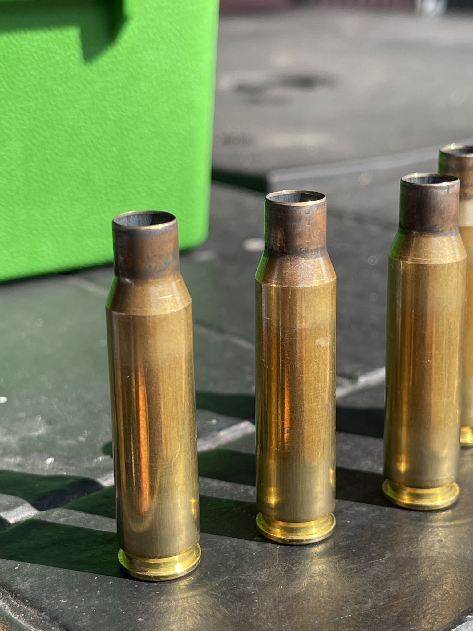

Whats the fired neck diameter of the case?
Fired Case .341
Loaded round .337

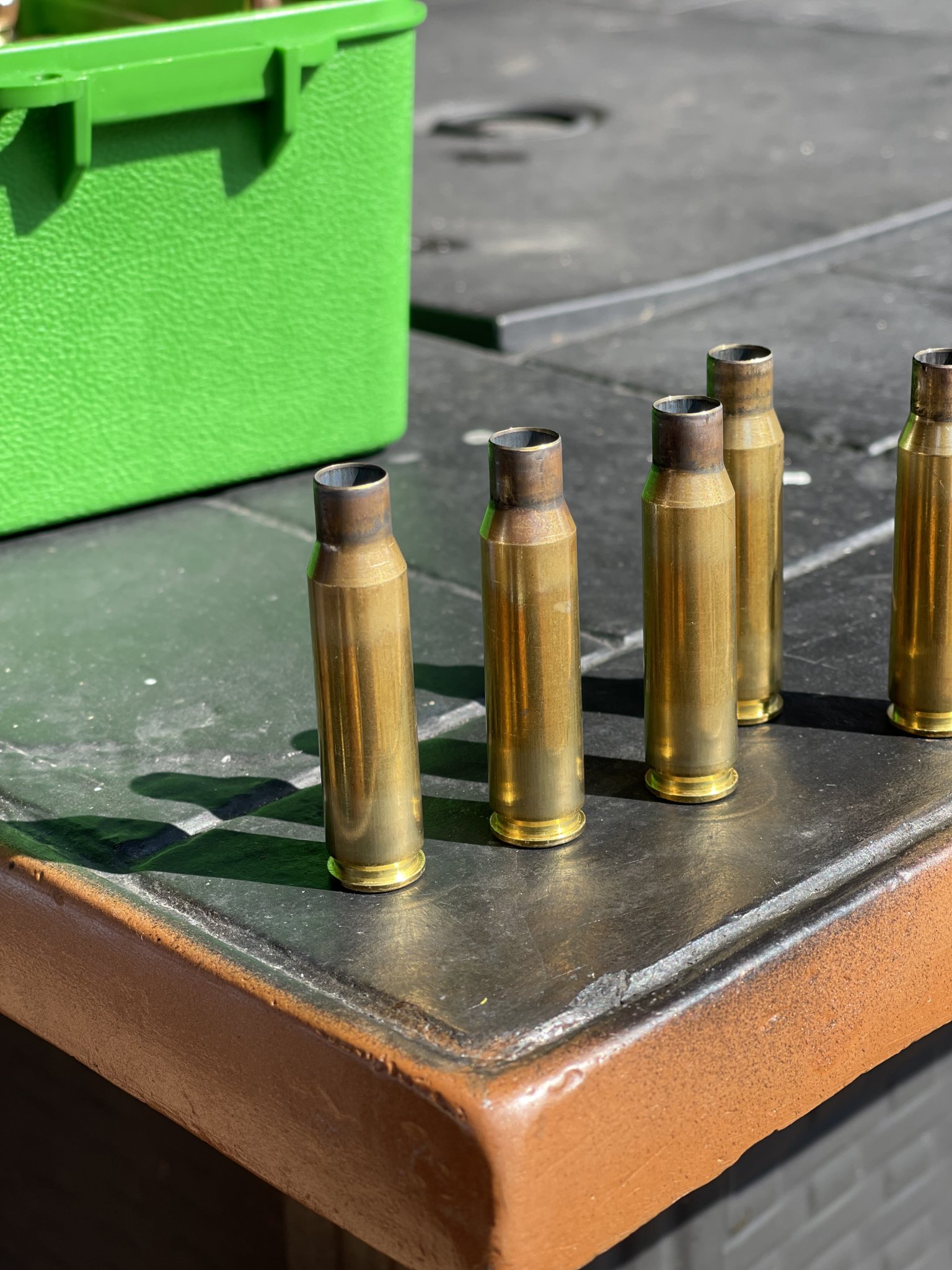

Carbon is heavier than what I’m used to, and it’s all the way around my necks. Some are making it to the shoulder after firing.
Fired Case .341
Loaded round .337
We can safely say the neck isnt too large in diameter. SAAMI .308 neck is ~.344, and youre likely .342 or thereabouts, as necks typically spring back .001 or so after firing.
Sooty necks are usually caused by work hardened necks, too little chamber pressure, or just dirty powder. What I see in your pics doesn't look bad to me though.
Whats the load recipe exactly, how many firings on the brass, hows it shoot, etc?

Your reamer has a 0.342" neck diameter.
It may not be the reamer. It could be rifling, crown or another issue.
The carbon on the necks doesn’t appear to show any issue with the chamber or the brass.

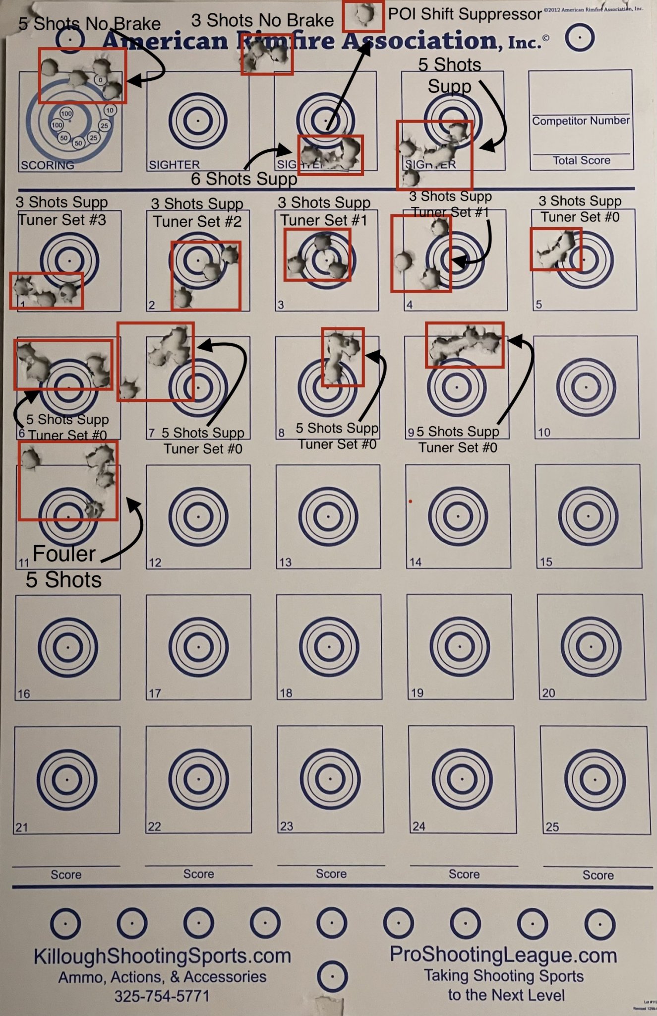

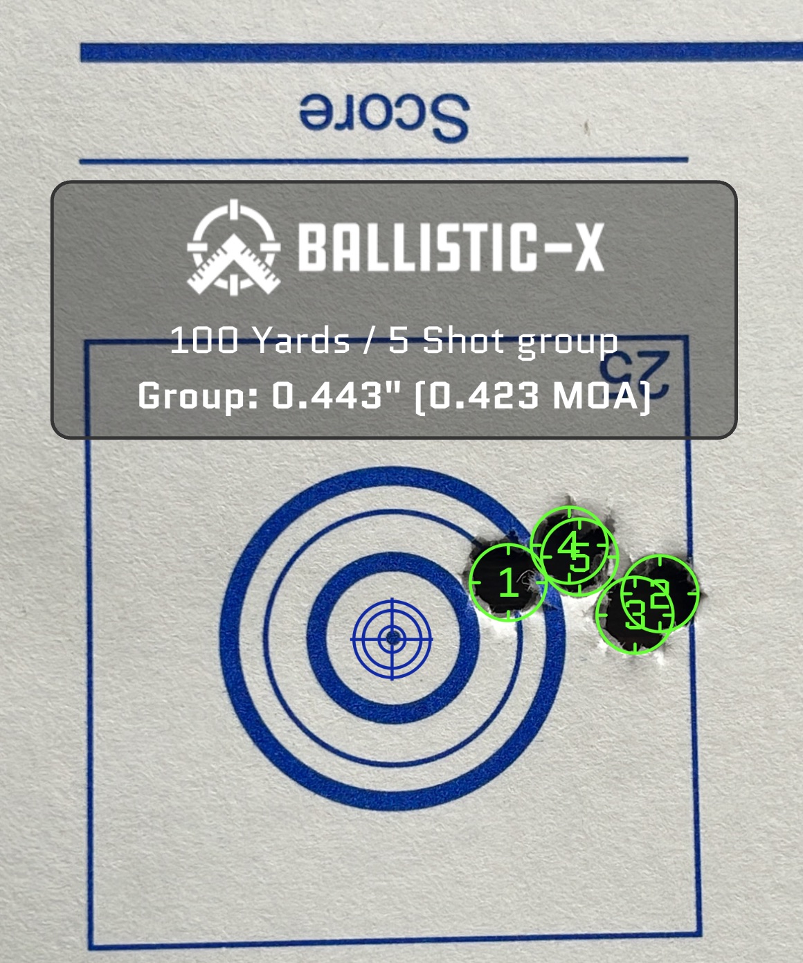

I wanted to get out and shoot yesterday due to inclement weather today.
I forgot my neighbor was getting ready for a party so ended up putting my suppressor on after the 3 shot group no brake.
Taking the muzzle device off resulted in a decent POI shift. 2 targets low, and 2 left. That was the fouler group bottom row far left.
I adjusted the scope and started the groups top row far left working towards the right.
Top row 3rd from the left was when I put the suppressor on. POI shifted back up about 2.5 targets. I was aiming at the second row as I anticipated a shift back up with the weight be added back. Adjusted scope and shot 3 shots it was the small cluster on the right. I loaded 3 more and kept shooting the same point.
It was looking decent so I loaded 5 more and shot another group to the right.
It opened up so I decided to adjust barrel tuner to see if I could tighten up and get some consistent consecutive groups.
The second row down is all tuner adjusting/testing. Then the 3rd row down is confirming. The setting 0 was double grouping. However all of these are much better than what I was getting before. Must have been a loose brake or scope.
Rifle weighs 11lbs and the 308 punches much more than in my previous 20lb rigs. Perhaps things loosened up a bit. Before each time I’ll be sure to tighten everything. I’ll go back to load development and see what happens.

Here’s the follow up.
Changed scopes and still shot between .35-1” groups with FGMM. No consistency whatsoever.
So this is where I’m at.
Off with the 308, back to the 6BR. This 6BR barrel belongs to another Impact action that I have out to a gun smith.
Im putting it on here and using all of the same gear to see if it still shoots well. If all is good then I can isolate the issue to something with the barrel.
I’m sure the load will need to be tweaked a bit. But still have some ammo loaded up, so I’ll start there.
Here’s a group I shot with the 6BR on my other action.
Ballistic-X-Export-2023-01-01 19:58:53.990453.jpeg
Here are the group that lead to the decision….
I measured the best and the worst group for reference.
Ballistic-X-Export-2023-09-24 10:49:57.388479.jpeg

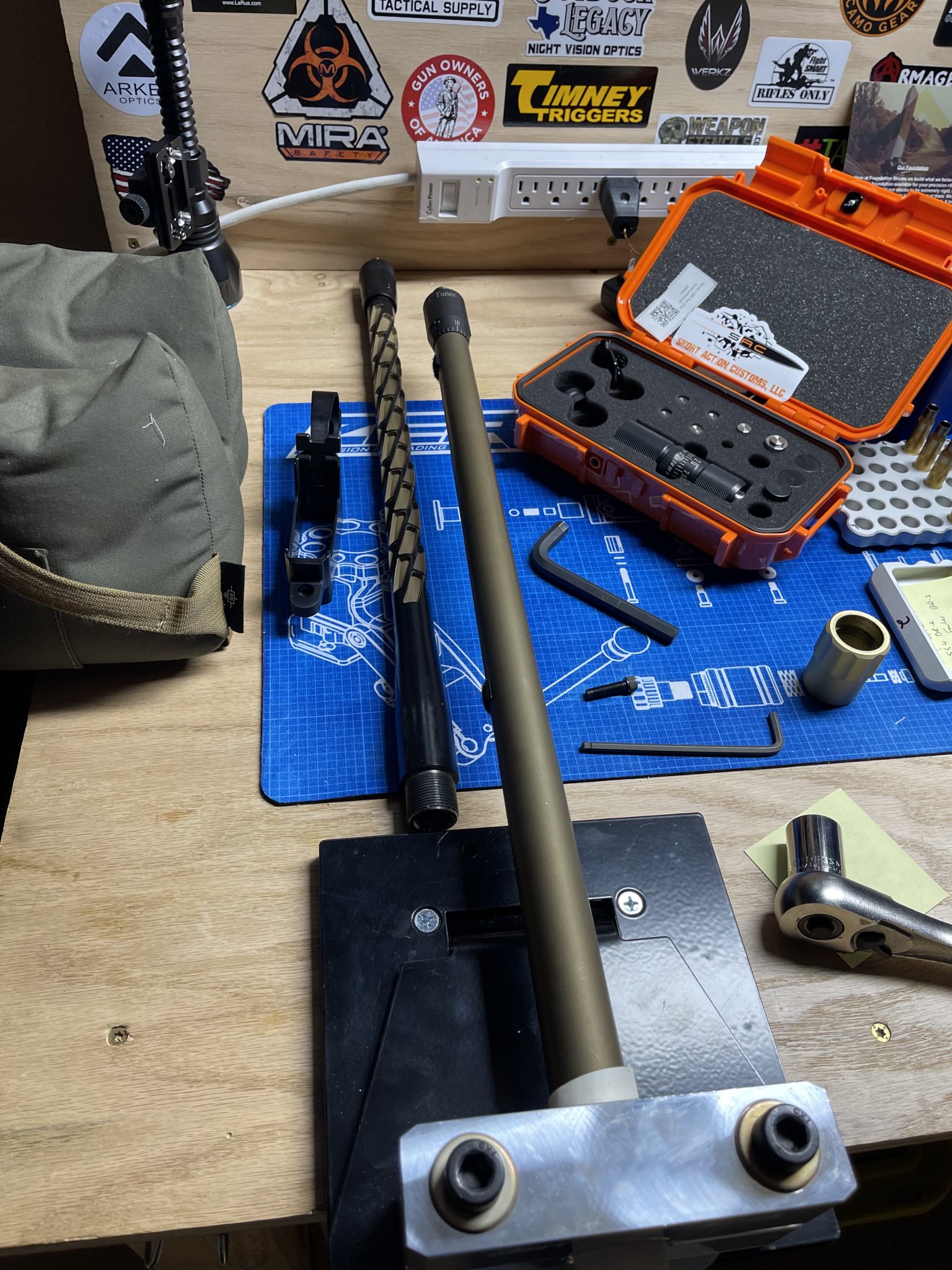

The fluting wasn’t aesthetic, although I tried to make it that way after it was done. I was after weight reduction for a lighter weight hunting rifle.
I did see an interview with Frank Green and Erik Cortina that helped me understand the stressing induced to the barrel, which can effect the barrel. Unfortunately this was all done before I saw that video.

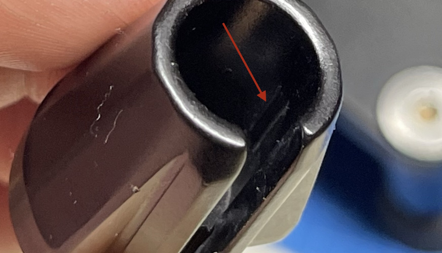

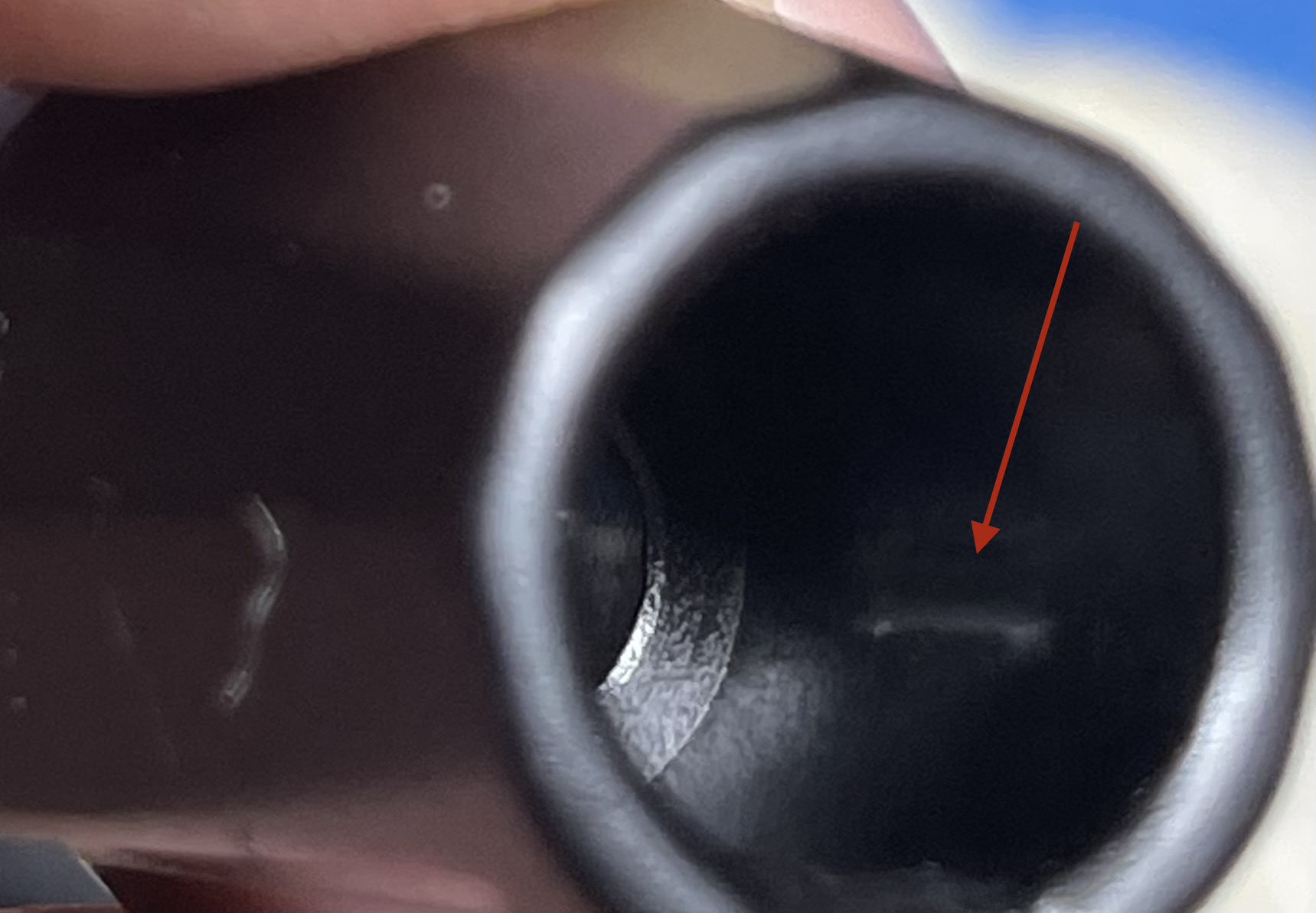

**Update
I was cleaning by bolt and discovered some drag that was taking place. Looks like it was the roll pin. In a few weeks I may spin the 308 barrel back on and see if that was the culprit.
I didn’t notice that before, but perhaps after more firing’s it was enough to make the mark. My 6BR barrel I spun on was not performing as well as it did before. That led me to further inspection and I discovered the dragging.

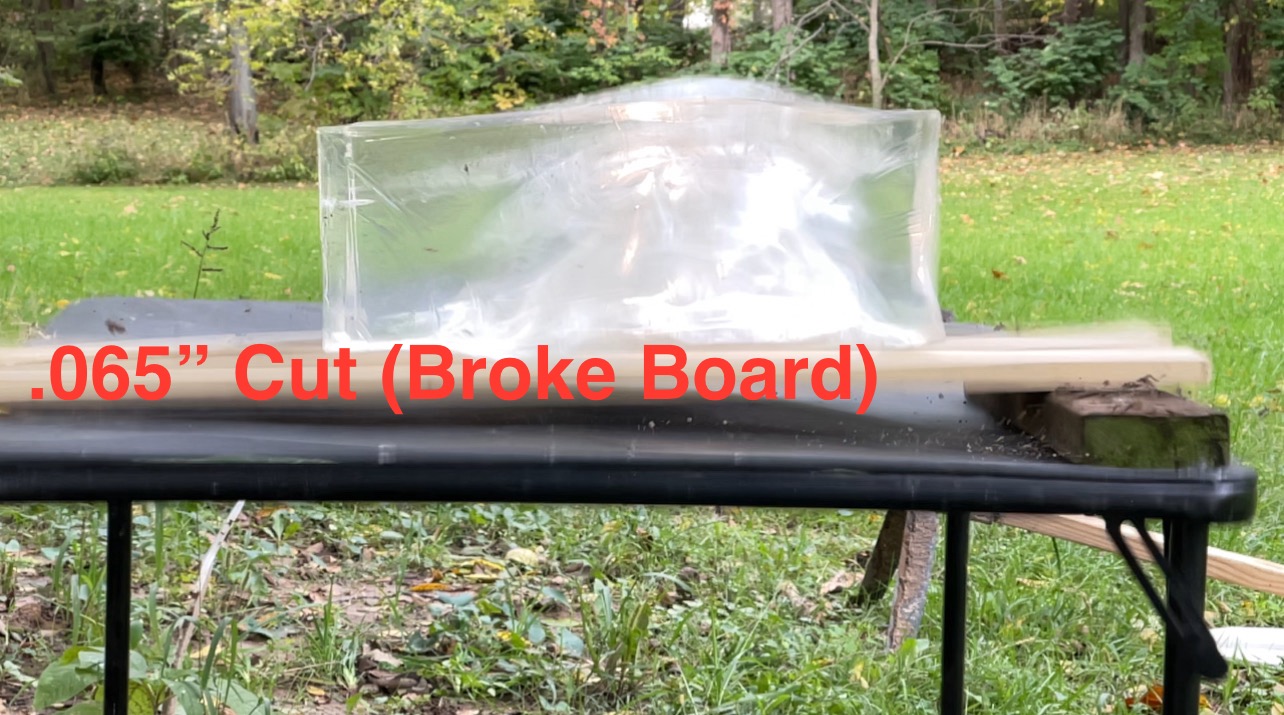

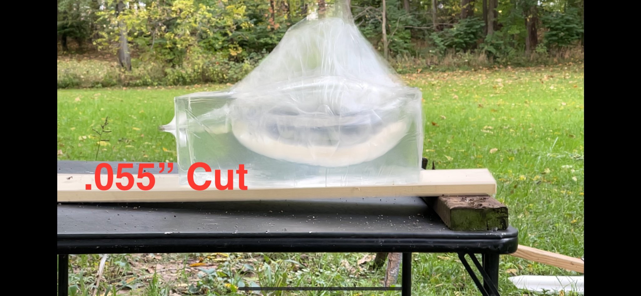

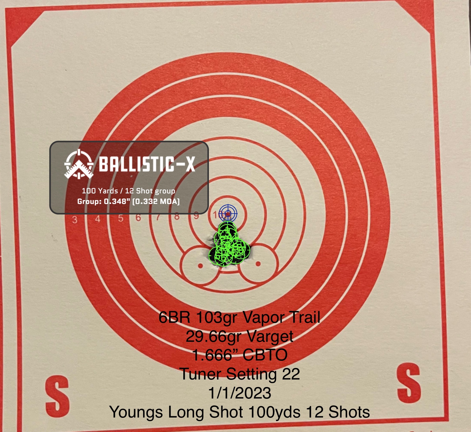

Got out to do some testing with ballistic gel today for the Tubb Nose ring tool on some 103gr 6mm vapor trails. While doing that I was also Chronographing all the shots and shot a couple groups.

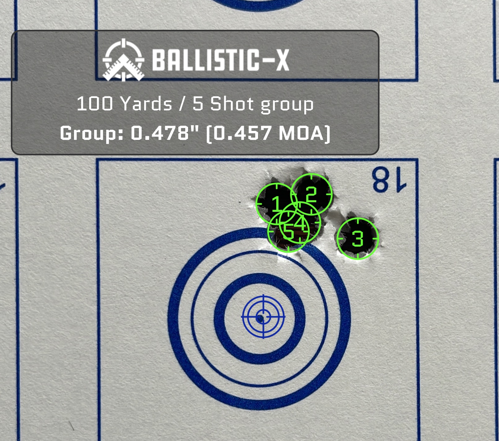

I can’t speak for the 308 barrel yet but the 6BR barrel was substantially better. The outing before I noticed the drag marks my groups were 3/4-1” which was way out of line for the BR barrel. Also SD was 12 es 52.
Shot 18 rounds today SD 5.9 ES 18, shot 2 groups which I’ll post below both just under 1/2”. Which was very happy with considering the load was worked up on a different action.
The action this was devolved on is on its way back to me. Once it comes back I’ll put the BR barrel back, then spin the 308 back on and see how it performs.

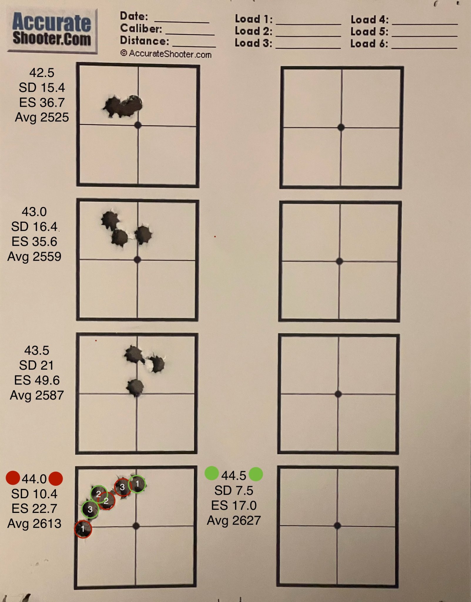

Got my action back from Speedy so I am putting this barrel back on to see if I can get it to shoot.
Also, I recently switched from Cortina/Satterlee method, to a OCW style for load development.
Load for this is as follows:
Lapua LRP
CCI BR-2
Berger 185 Jug
VV N150
The printing on paper looks good @ 42.5-43.0 as far as impact area. However looking at the 44.0-44.5 the diagonal is something I question, but the SD/ES looks great there. Can that be tuned out with seating depth?
Thoughts and feedback are appreciated.

Others may have better advice, but I would do a 5 or 10 shot group with the 42.5. If that group holds near to that then go with it - load, seating depth, etc. seems like you have found a good combo there.
Reactions: mike_srt4
Your sd is super high. Thats not a good sign about your brass prep. I dont see a group for the 44.5 but even without it based on the numbers id start there and do a seating test. From .005 off to as far as .120 off in .003 increments. Obviously thats a lot of shooting so you can do it in .010 and see if a certain place shows promise then tune from there. Or you could chalk it up as a bad barrel and just use it for practice. Dont waste 1k$ on bullets to save a 700$ barrel

Well I got out and shot some Federal GMM 168gr. Shot through a box and a half with an SD of 6.8. Stacked several in the same hole. I was sighting in for a shot on a fox at 194 yds. (Going after my chickens).
I used the Tubb nose ring and made a .055” cut. Barrel worked great for that!
