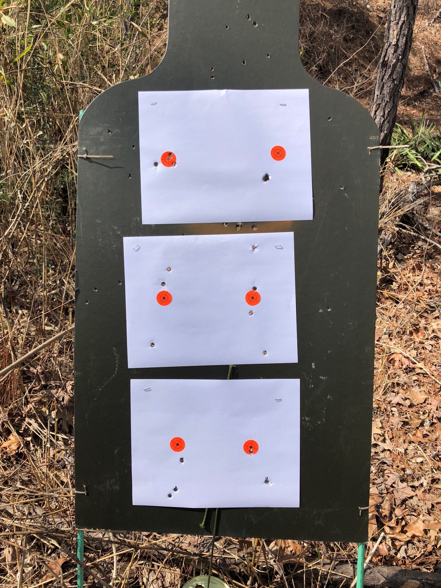

The accuracy and reliability differences between self protection rounds is quite astounding. I didn’t do a side by side test until just a few years ago. Now I do it with every gun I carry. I could really not care much less about expansion or terminal performance. Gotta put the rounds where they matter, cycle the gun and keep doing that until the threat is taken care of.
ETA, here is the actual test that woke me up, three types of ammo think it was 10 or 12 yards.

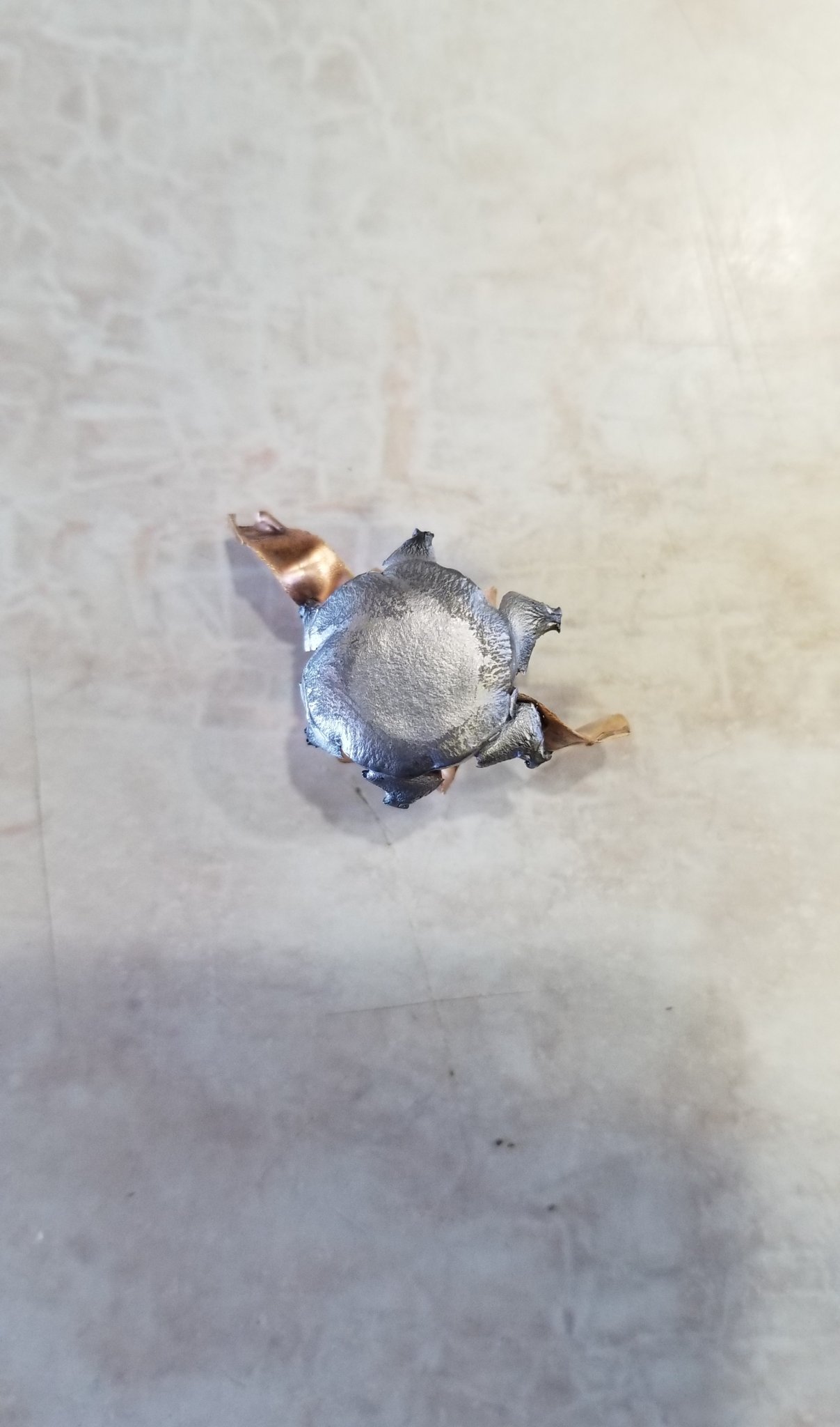

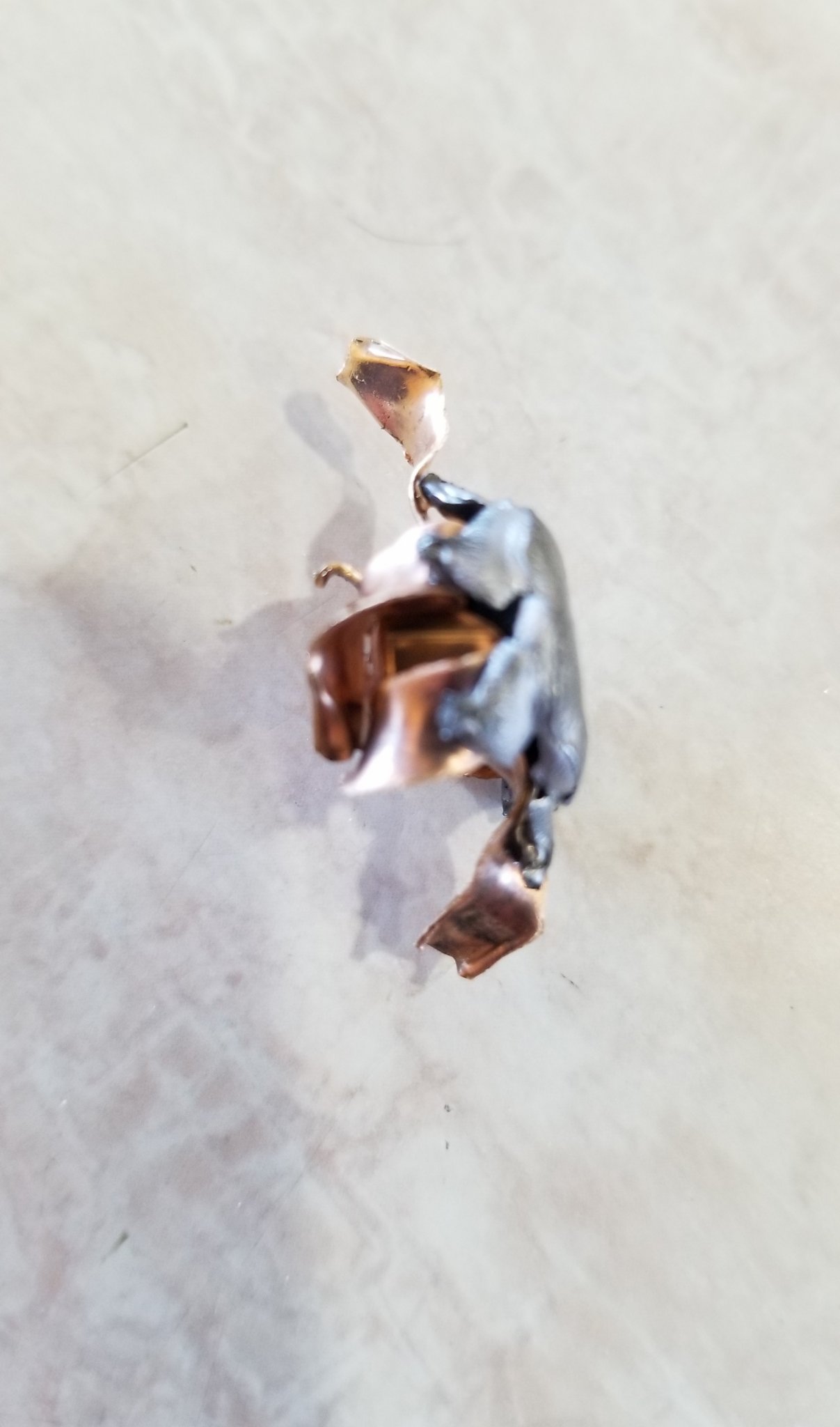

In case anyone is curious...
Reactions: Swatman and louu
There's no fucking way that lack of accuracy is ammo related
Not at that distance

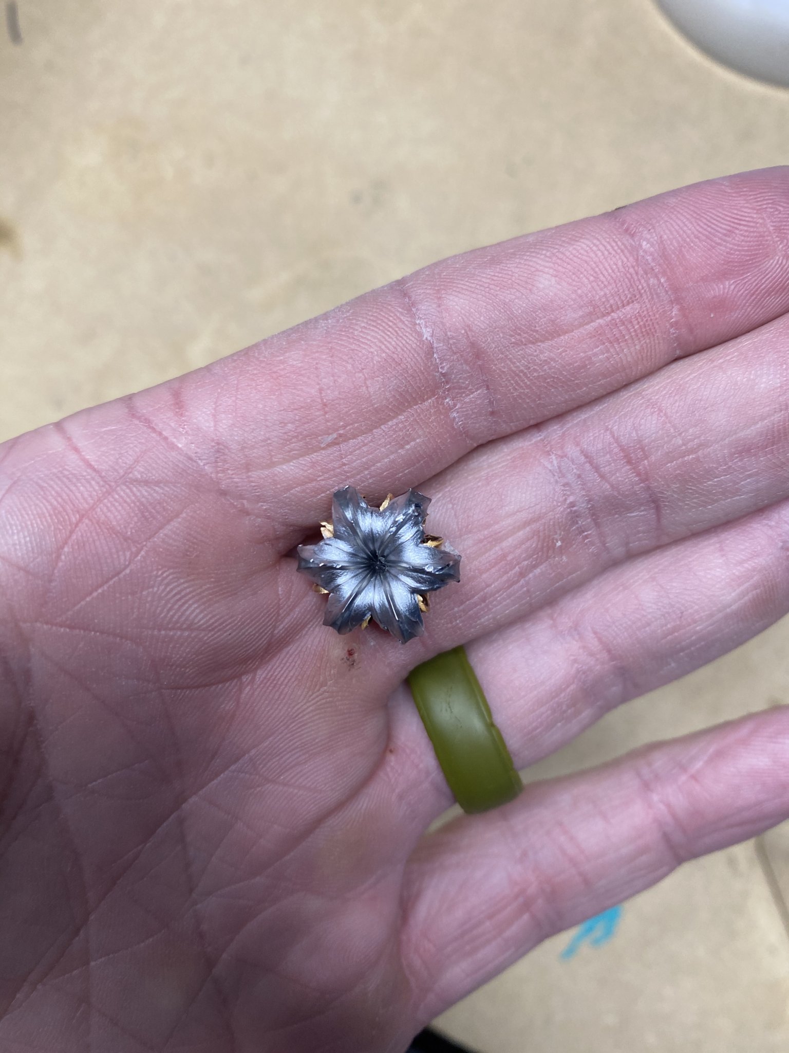

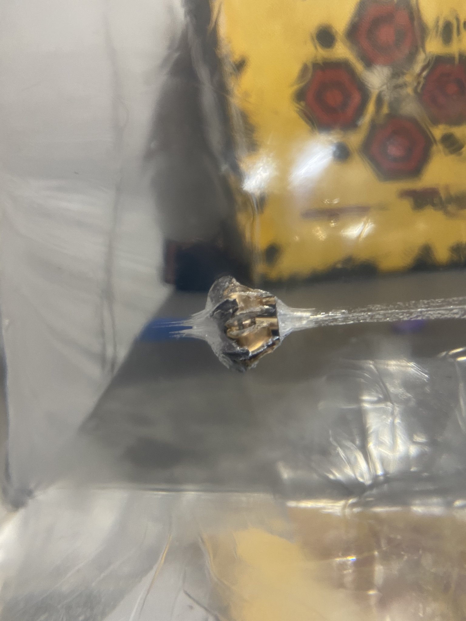

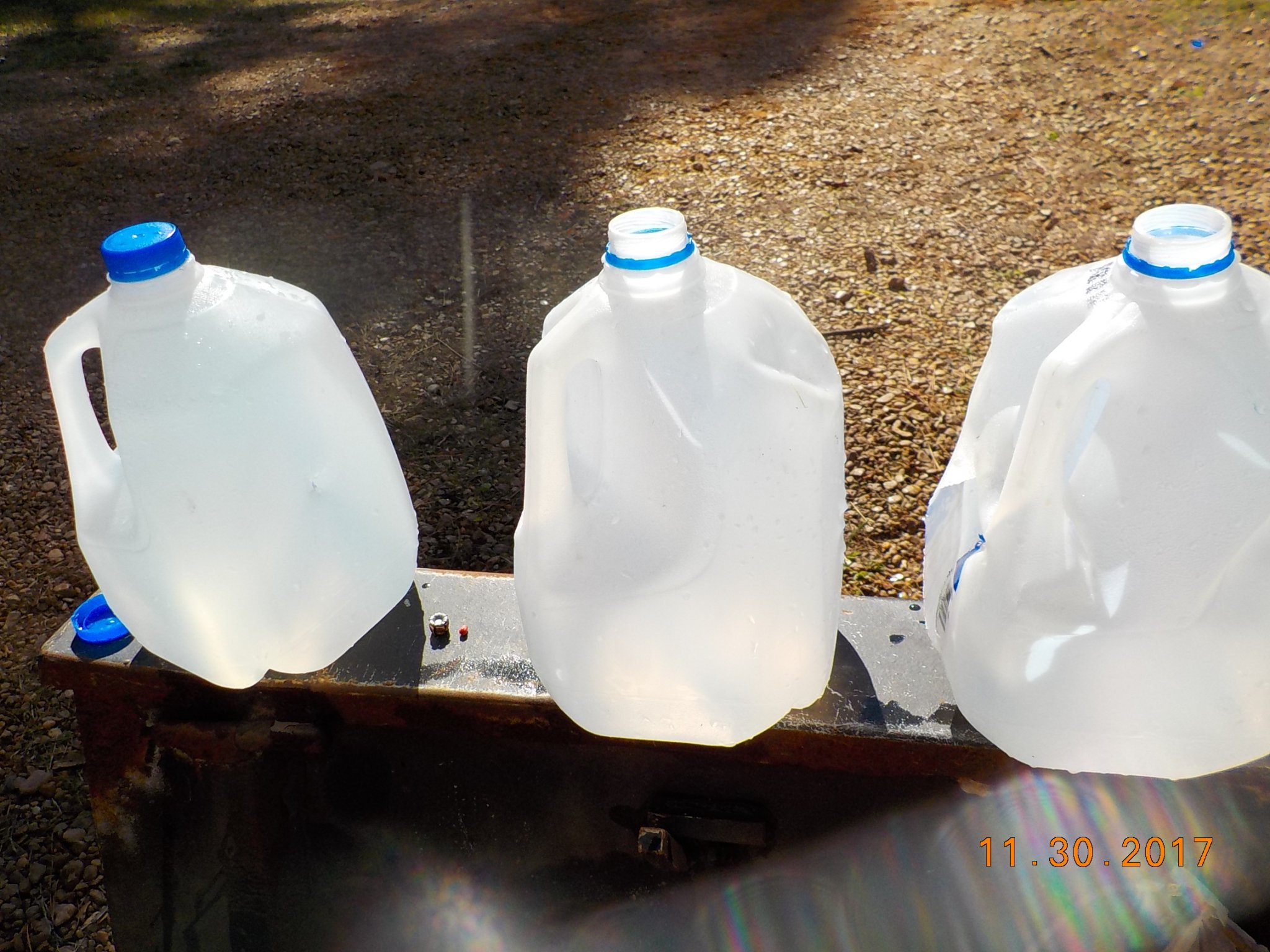

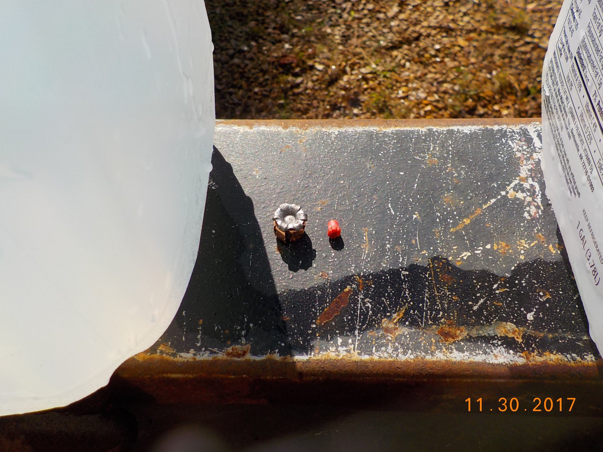

When testing my HP reloads, I fill milk jugs with water and line 5 or 6 of them up back to back. Shoot through them and the bullet usually stops in the 3rd or 4th jug after completely exploding the first 2. The round in the pictures is a Hornady Critical Defense .380
Interesting. Would you expand the your method of testing, slow fire, rapid fire , two hand grip... Major difference in groups. What do you think makes the difference? Bad QC at the factory?
So that was four years ago but as I recall I loaded three rounds fired, changed ammo, repeat through the types. I may have done both three shot groups back to back but I don’t think so. What I do recall is one type had a stove pipe and didn’t lock back on last round at all and wasn’t shot again. The other type I think I burnt the box on steel but that was it. This was a 9mm 1911 so it was picky on ammo anyway, had probably just under 500 rounds through it at the time. Both bad groups were not typical of what it was/is shooting like so couldn’t tell you what the major issue with those bullets were. I’m not gonna badmouth any of the ammo, the 320 likes it all the same. I’m just saying test your ammo.
Thank you. I have had ammo group like that, though not quality ammo.;) I find impacts go higher or lower due to bullet/powder combo which are significant enough to warrant testing.
These were all quality. Top group and another group are actually the same manufacturer, different rounds.
