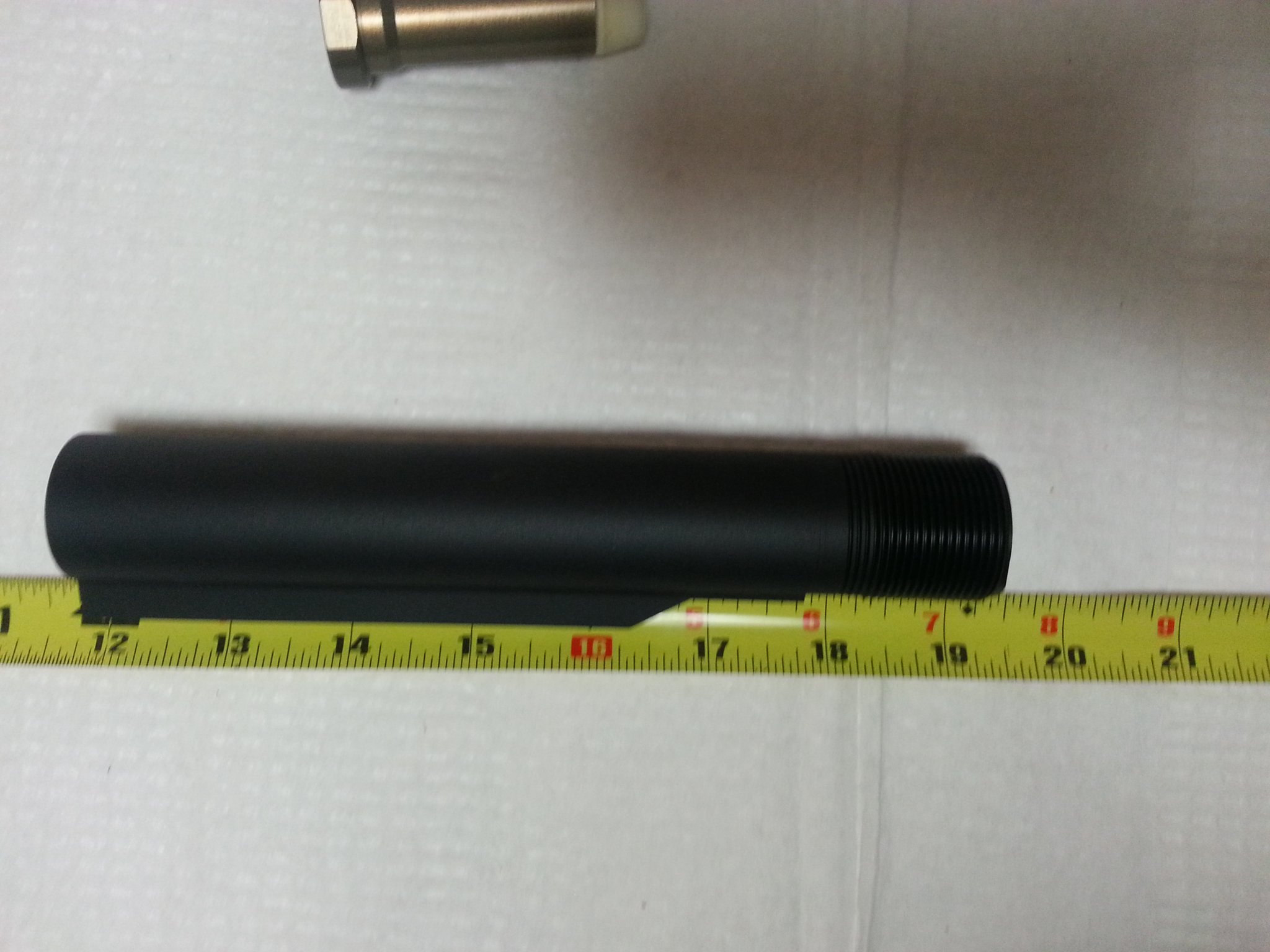

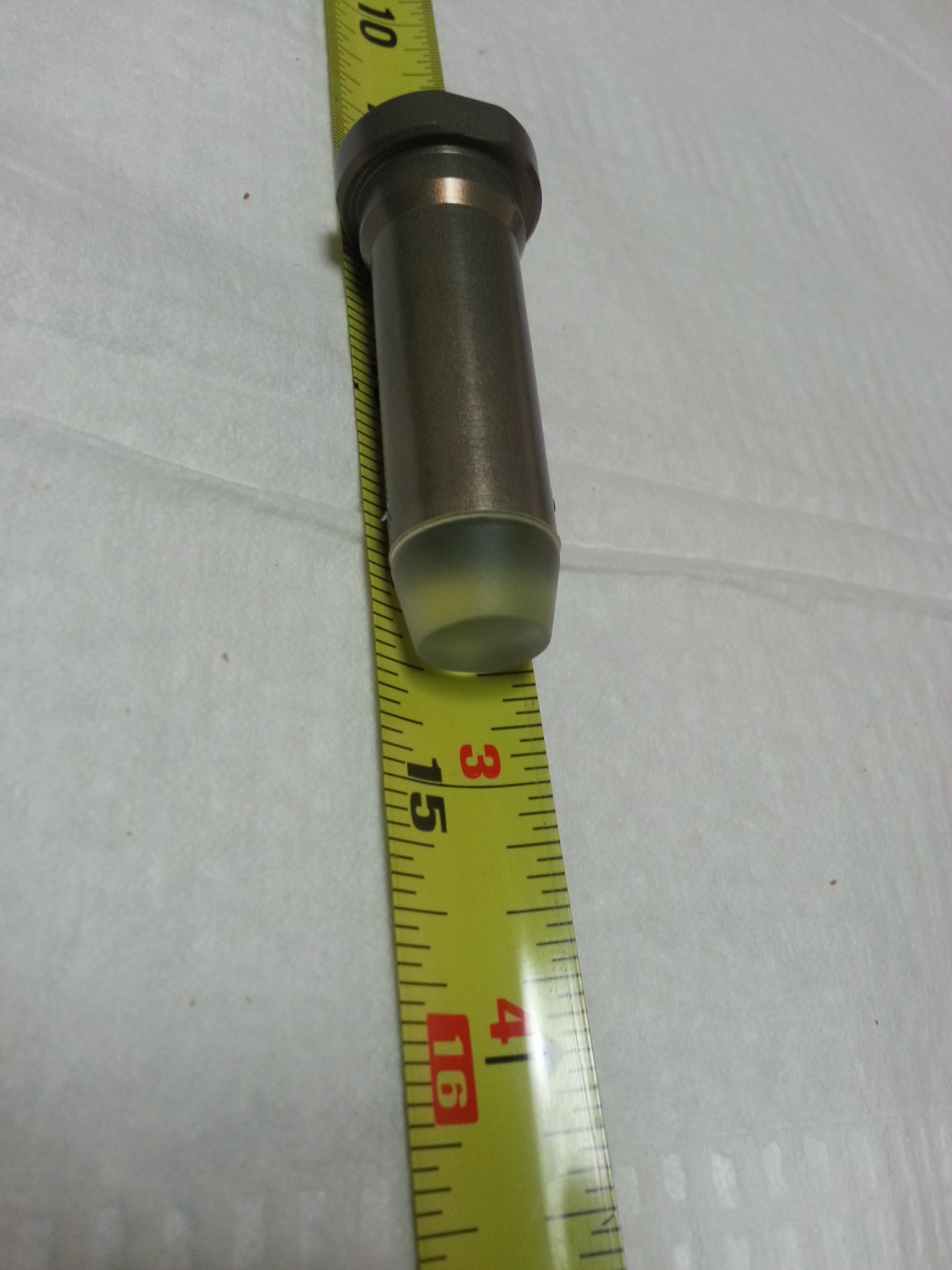

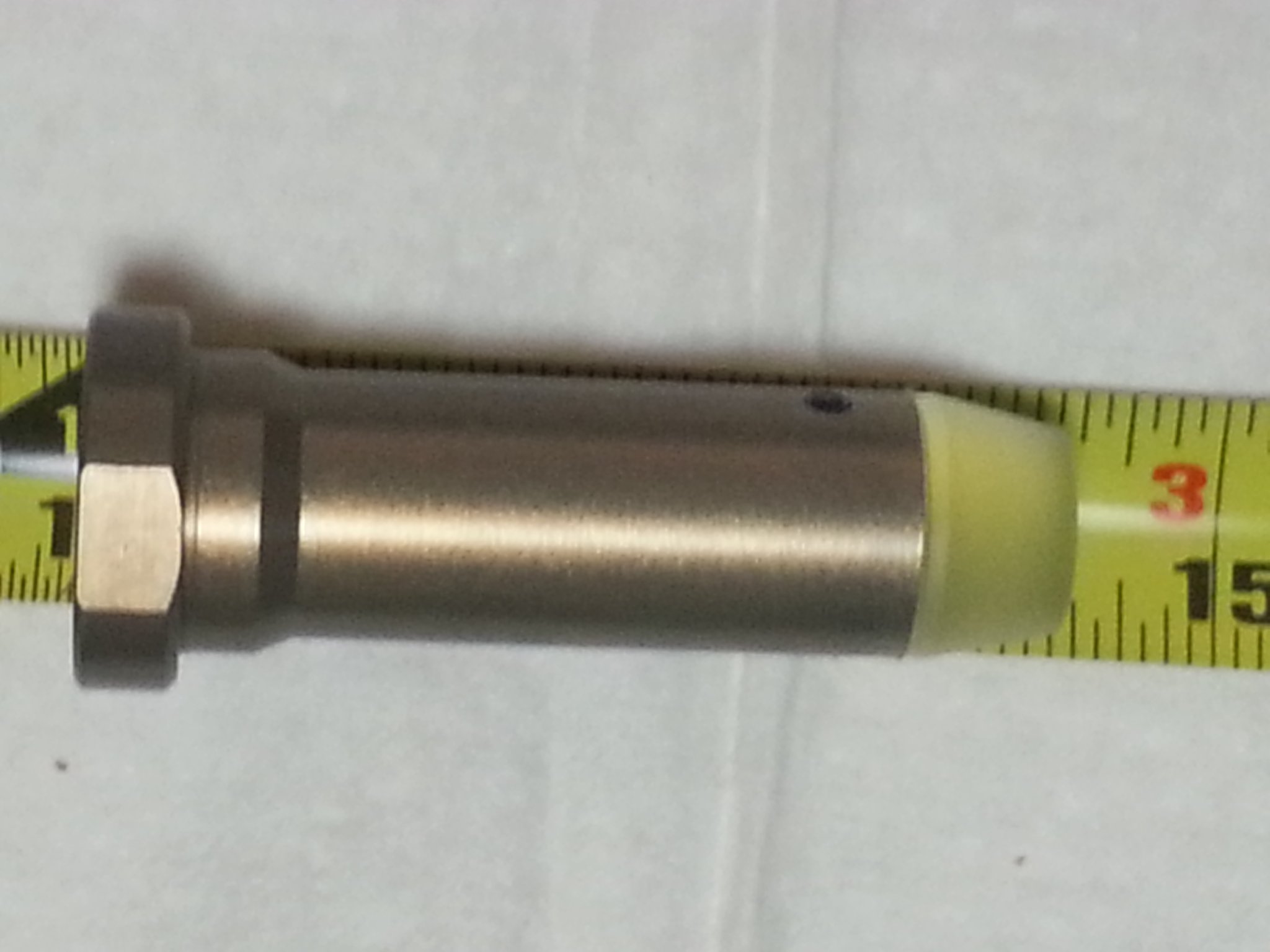

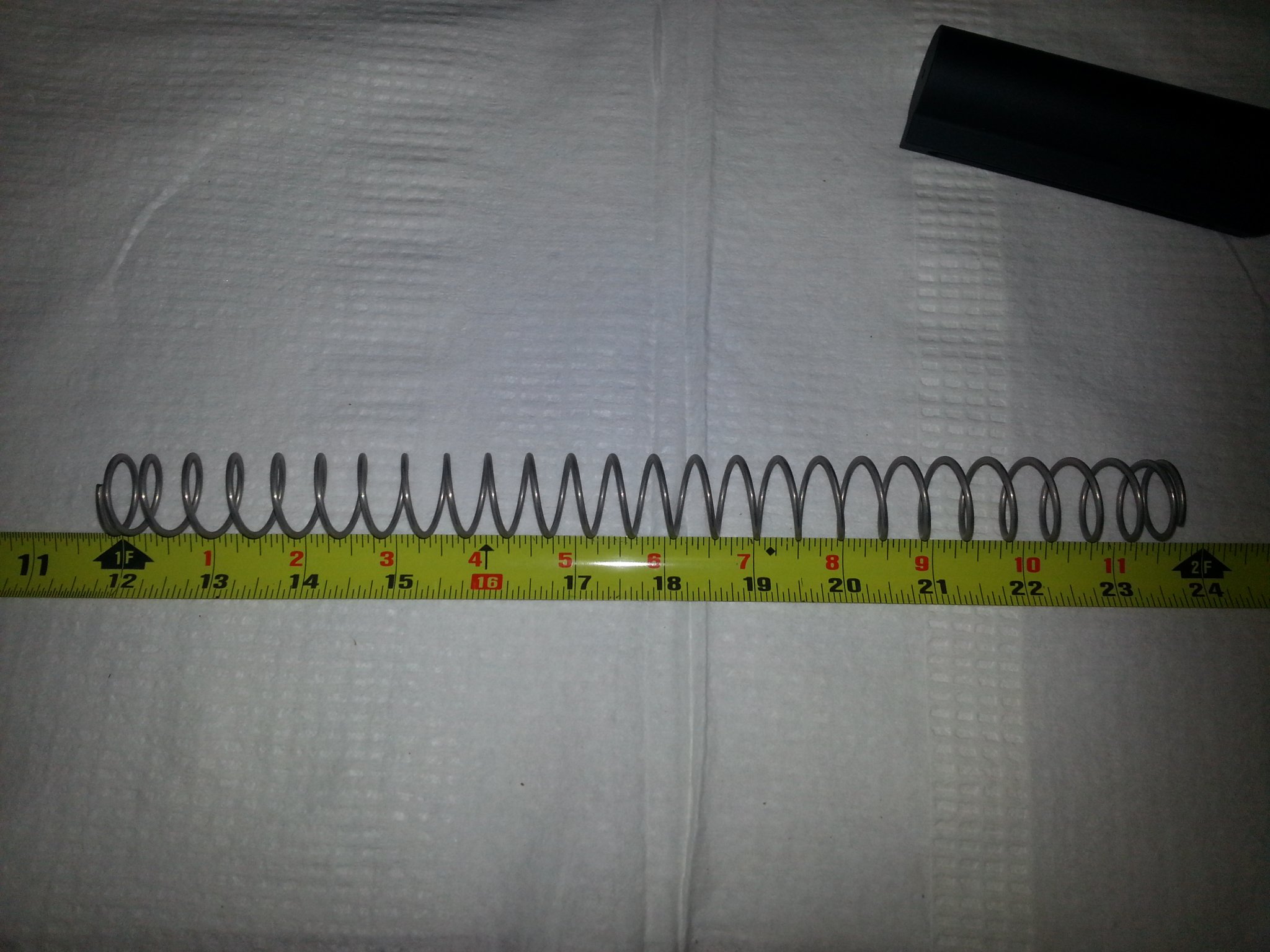

    I sourced a standard issue strike industries ar15 carbine buffer tube, aero's ar308 buffer spring, and odin works ar308 adjustable buffer.

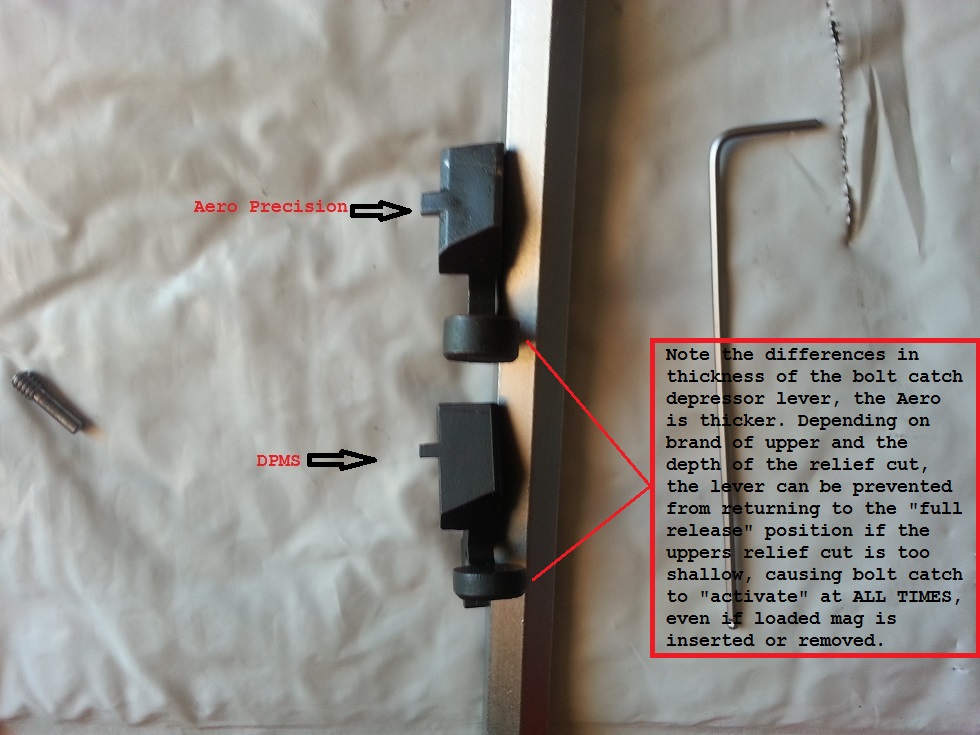

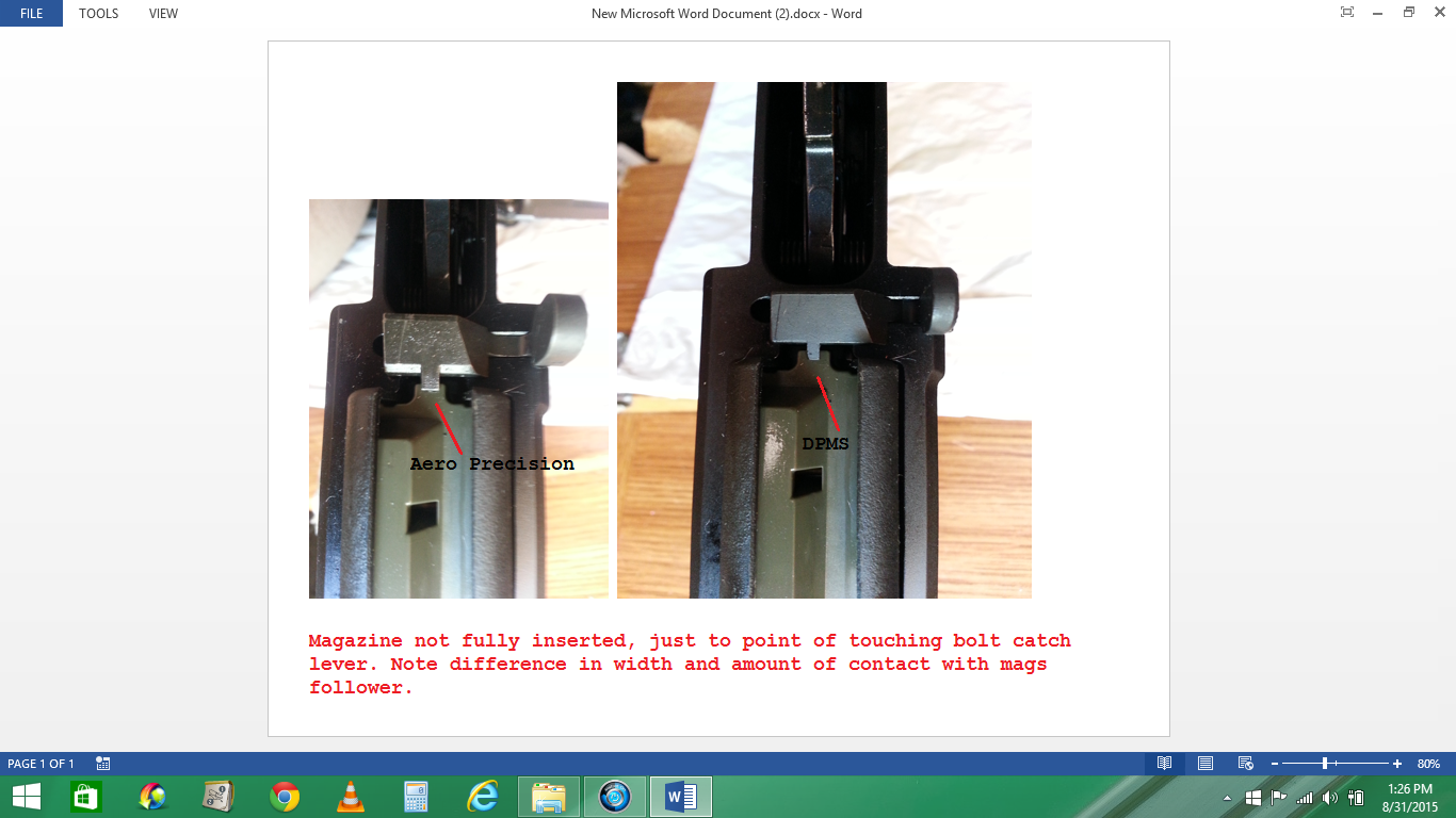

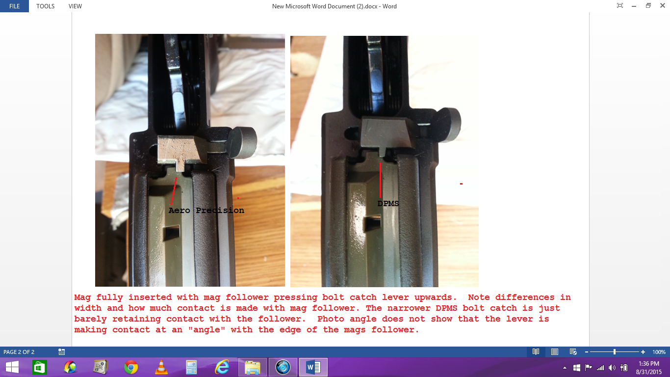

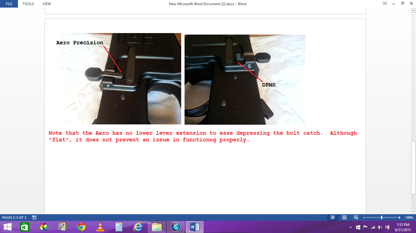

    ...here are some pics of the Aero parts from 2015. My M5 build has worked flawlessly since day one using M118, FGGM 168, various handloads in 155-178gn loads down a 16" CLGS tube w/SLR AGB.
    There are also some potential "reliable functioning" issues related to choice of bolt catch.
    YMMV

    On that buffer; is that beginning on the 13" mark?

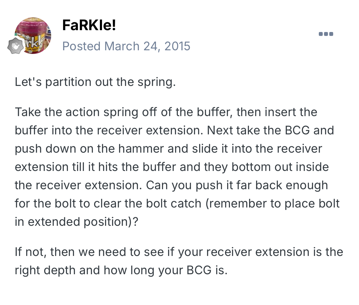

    Remove the buffer and spring. Use a ruler or tape to measure the inside depth of the buffer tube.
    A std AR15 carbine tube should be very close to 7" deep inside. (6-15/16 is the Armalite spec) If this is what you have on a 308 carbine, then the buffer has to be 2 1/2" long. The spring must be for a 308 carbine, NOT an AR15 spring. The AR15 spring will prevent the BCG from traveling far enough back to get past the bolt catch.
    IMO-the better option on buffer tubes will have a 7-5/8" internal depth. This tube will use a std length AR15 carbine buffer which is 3-1/4" long. H3 weight with a rifle-length 308 spring. This will get you there all in 1 kit:

    Aero carbine receiver extensions/buffer tubes are 7". You use a buffer longer than they sell and you got your problems.

    FWIW, my small frame AR10 has the above components. Except, the H3 buffer is on the heavy side at 5.7 ounces. However, it throws brass exactly where it should.
