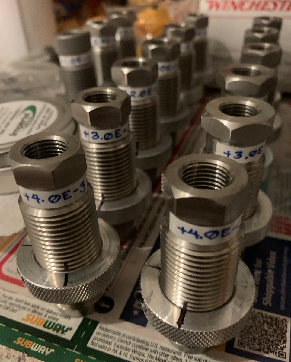

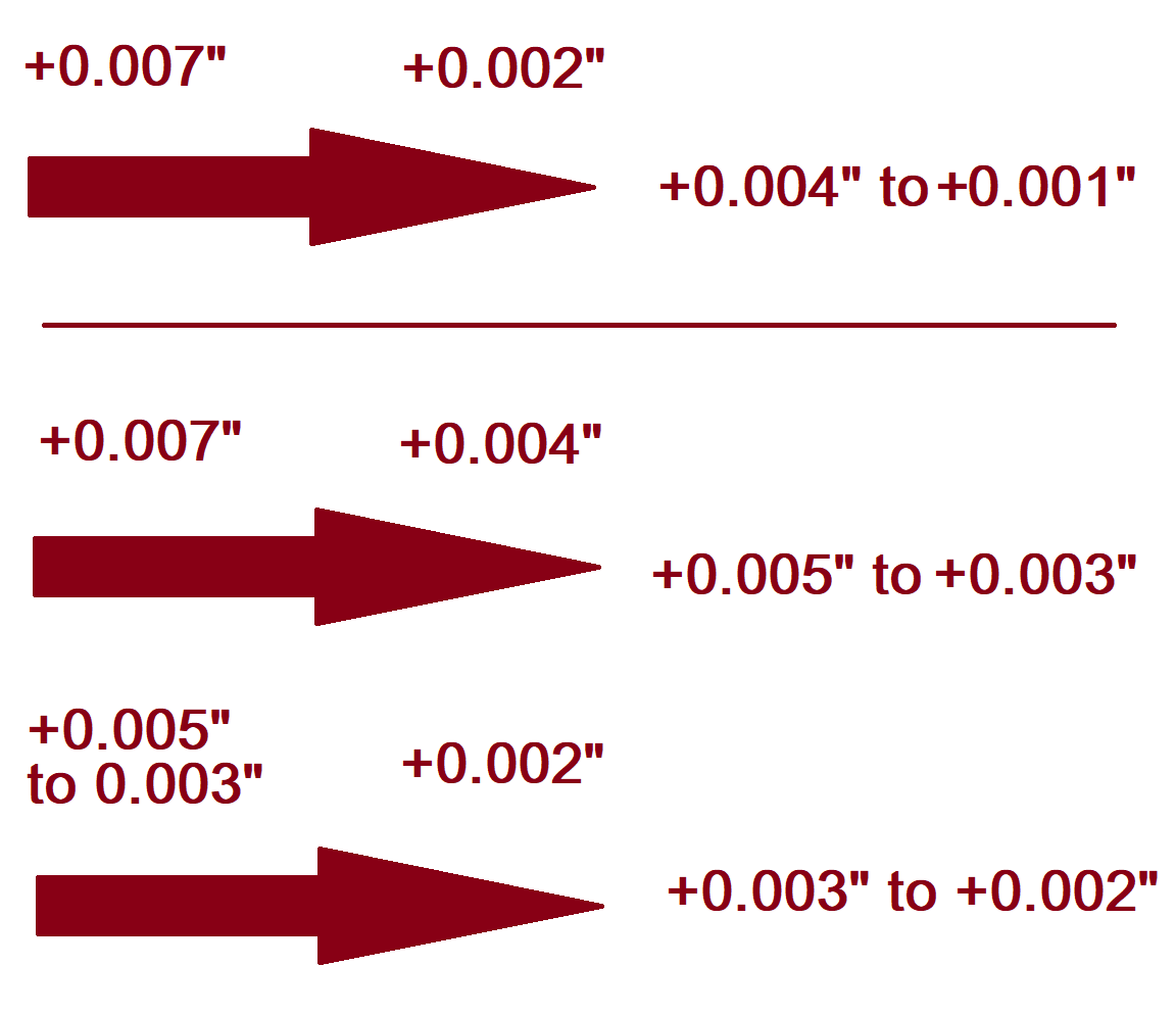

Had some fun playing around with different sizing steps...
Personally, I've gotten it down to where the last thing I had to deal with was the inconsistency in the amount of wax that I've been applying.
Paraphrasing one of the comments in the papers on "forming" and "springback" - "the final state is dependent on the initial state." You want to achieve an asymptotic response to successive sizing interventions. I suppose you can say that you are deliberately trying to achieve a state of "diminishing returns."
Duh duh duh duh.
1. Large Shoulder Bumps = large variation in headspace
2. Small Shoulder Bumps = less variation and more predictability in headspace
Use two dies.
First die does the large sizing step, aiming for a headspace consistently "taller" than the goal, across varied range pickup brass.
Don't wipe wax off after the first die.
Second die always has a consistent layer or thickness of wax as a result; I believe this matters more than one would think.
Second die does the minuscule sizing step, aiming for a headspace that does not exceed the goal (or only by a little bit, depending on how you like the "feel" of your bolt closure).
Headspace is pretty consistent and predictable after the minuscule sizing step.
3. Using one die twice was considered, but the headspace goal was often exceeded.
Hope this helps...
Duh duh duh duh.
Use two dies.
Hope this helps...

Holy Christ you managed to find a way to make brass prep even more tedious, time consuming, and irritating. Well done, sir!
It's just an extra Full Length Sizing die, that's all?
If you have annoying brass, use two steps instead of one.
No different from using a regular die prior to a small base die for difficult 7.62x51mm Lake City brass.
Am I missing something?
I guess I’ve never tried to achieve an “asymptotic response to sizing intervention.”
2 sizing dies is a new one on me. If I ever had to small base, it would be the one and only sizing die I used.
I will agree that case lube variation is a source of sizing variability.
Case lube type is a source of variability. Imperial sizing wax doesn’t have any issues when you hard stop the die against the shell holder. Other lubes cause variance. Use imperial.
Reactions: OREGUN
It just means that if you keep slamming your brass into one sizing die repeatedly, you'll reach a point where you'll size no more no more no more no more...
But naturally, you can't do that - because you lose lube and end up with a jam; and if you were to reintroduce lube, you cause inconsistencies.
So you size it close to your goal with a yuuuge squeeze, then you squeeze it "with precision" by following up with a wee squeeze.
Yuuuge Squeeze = inconsistent headspace with high variability (like stuff you try to size from an M240)
Wee Squeeze = predictable headspace with much less variability (like stuff that barely requires any work, from my bolt gun)
By no means am I saying this is some end - all approach, just that there are some documented physical properties that support the idea, and it seems to work well for my brass, my chambers, my loads; your mileage for your brass, your chambers, and your loads may vary...
Just something I'm throwing out there for others to try, hopefully with success.
Or, I'm just pulling all your legs for some malicious fun, go figure.
Please excuse the use of the pronoun "I" and possessive determiner "my" in these narratives. We handloaders are so in love with our own methodologies and voodoo, and are blinded by self - perceived individualistic exceptionalism that we consider our personal methods as divine gospel :ROFLMAO:
Reactions: aam

We made this too complicated. Now we're trying to bump brass so that it has a perfect fit to the chamber, blah blah. The first sub-moa loads I made were in new brass I only chamfered and then just used a FL RCBS die to size after firing. I had no idea what the shoulder bump was. And you can say that it's to save brass life, but look at the other costs.
You have guys who are buying new brass, loading it, "fire forming" it, and then obsessing over the shoulder bump. Using these is extensive as I will get: https://www.midwayusa.com/product/101253343
You setup the die, you size with one shell holder and try chambering it, and change to another size if needed. I usually remove all "crush" feel. Am I killing brass life? Maybe, but I'm not obsessing over it.
