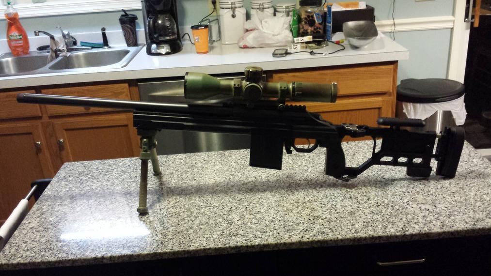

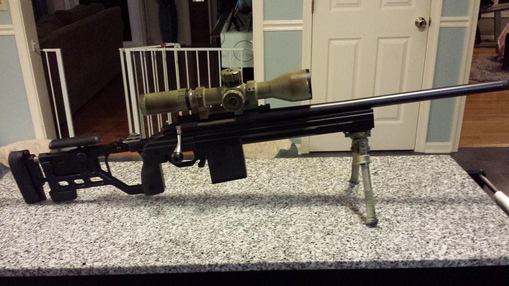

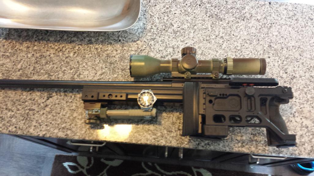

    Found a Used, but never shot Sporter in 260, in the process of selling off the old stock, and dropped in into a WC3 this week.
    Out of all the Rifles I have owned, this is going to be my favorate. Here are some pics.

    Thanks for the pics man! I am glad to see that it can be done. Where did you buy your AICS mags from? That is next on the purchase list. Any problems with mag retention in the chassis? Also, just to clarify, the W3 is compatible with the standard AICS 5 and 10 round mags, correct?
    I say "Do It!", as well. If KRG was able to make the W3 for the T3 that accepted long action AI mags (mine is 6.5x55), I would have done the same thing. I went McMillan and I love it, but the W3 would have been my first choice. The factory barrel/action are awesome, but if I had the cash, right now, I wouldn't even hesitate to go the SAC route. You're talking minimum/no difference in price to get a custom and the wait time would be far less than piecing it together, yourself. That, in itself is worth it. It took, me a year and a half to put mine together and the waiting sucked!
    Edit: Yes, the W3 will take AI 5 and 10 round mags.
