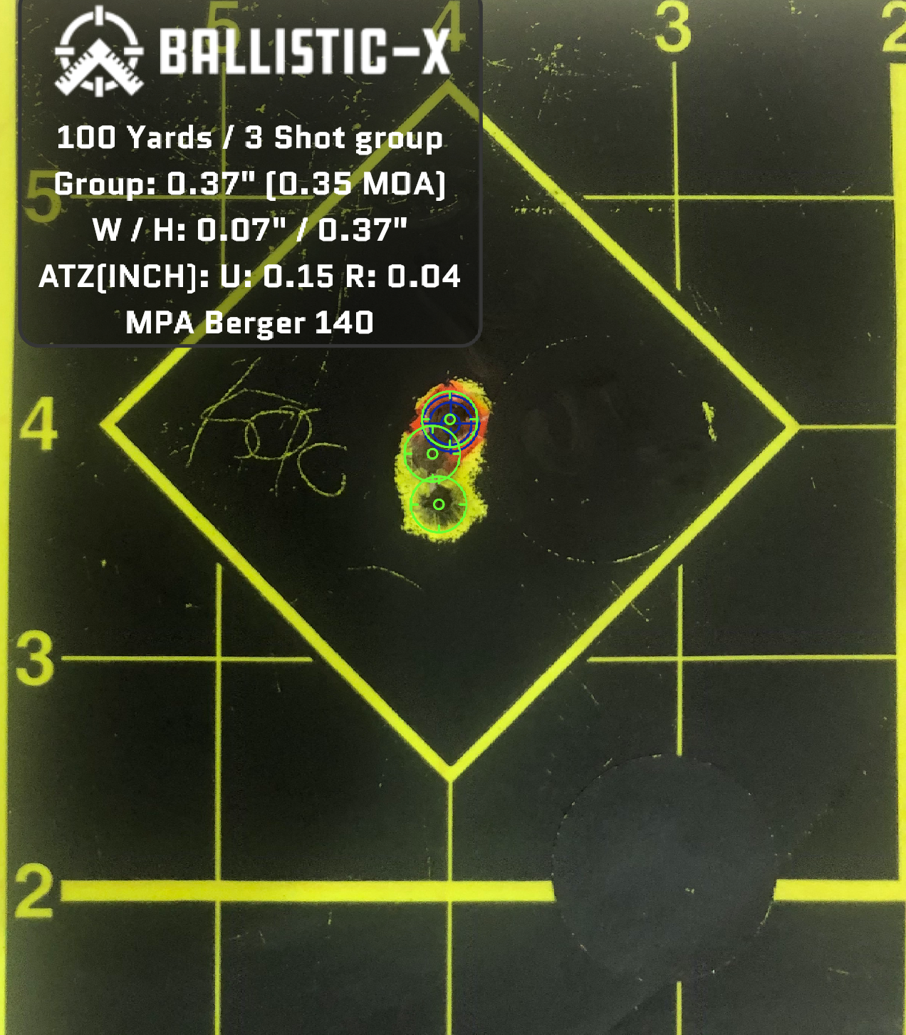

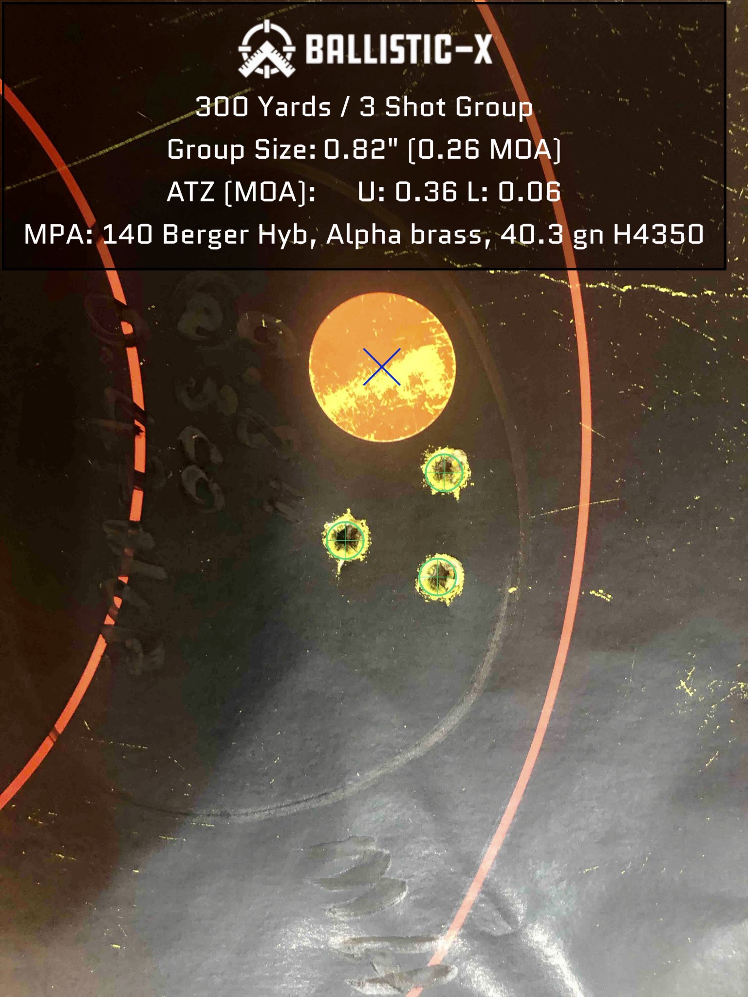

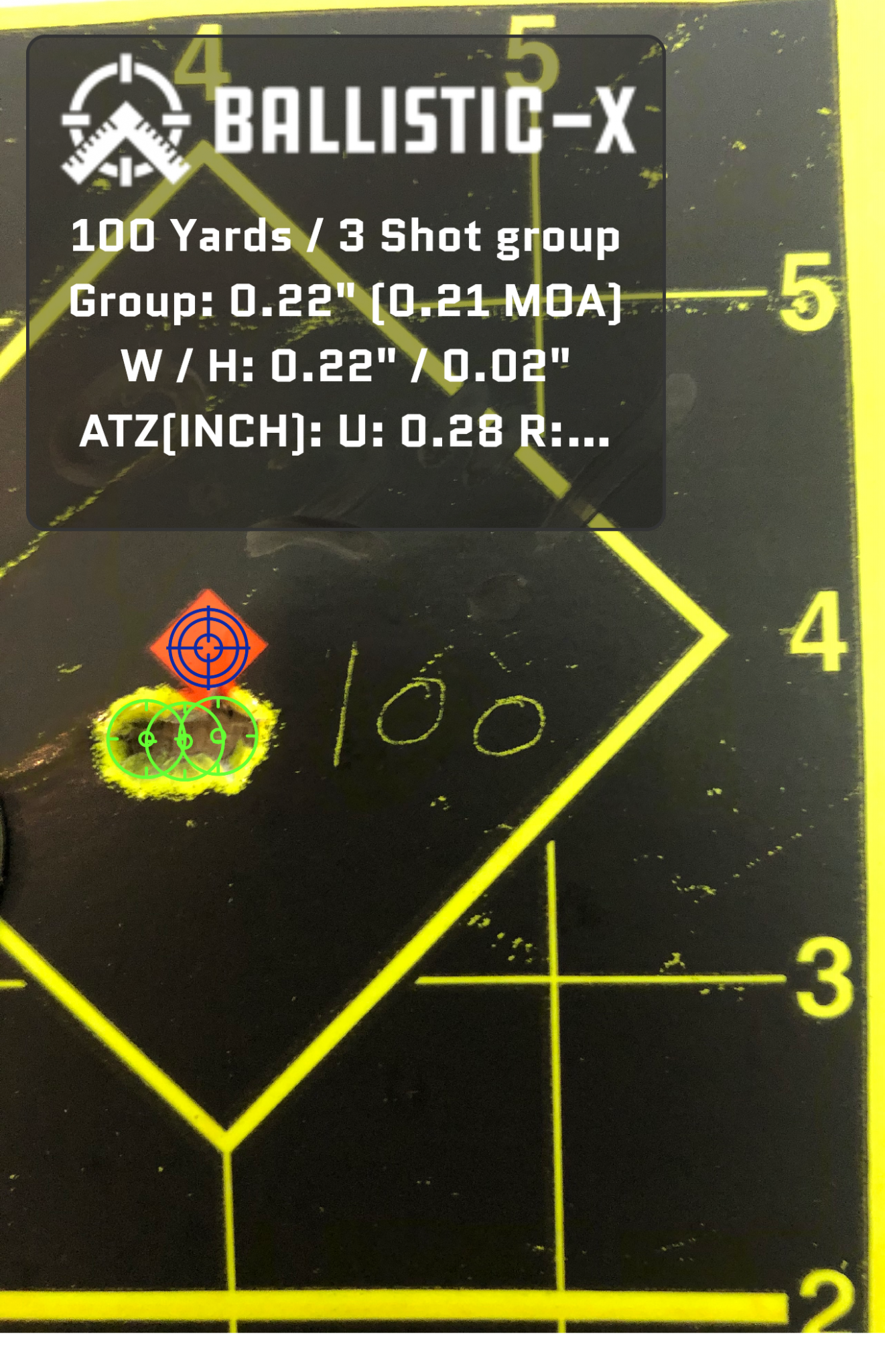

The MPA is a new, about 250 rounds so far, gun shoots like a champ, out to 300 yards. Even with Hornady 140 Match and Berger factory ammo, with groups around 0.4”.
Hand loads: Group size is on average 0.25” to 0.35” MOA, so very happy with the gun. Some vertical stringing issues at longer distances. Want to get ES down below 25 fps (so looking for a 30% improvement). SD is good enough, but usually 2-3 rounds that end up exceptionally slow or fast. Scrubbed out a minor carbon ring. Brass has all been trimmed shorter than trim length (1.905”) to keep it consistent as some came out if the blue Lapua box shorter than they should be...

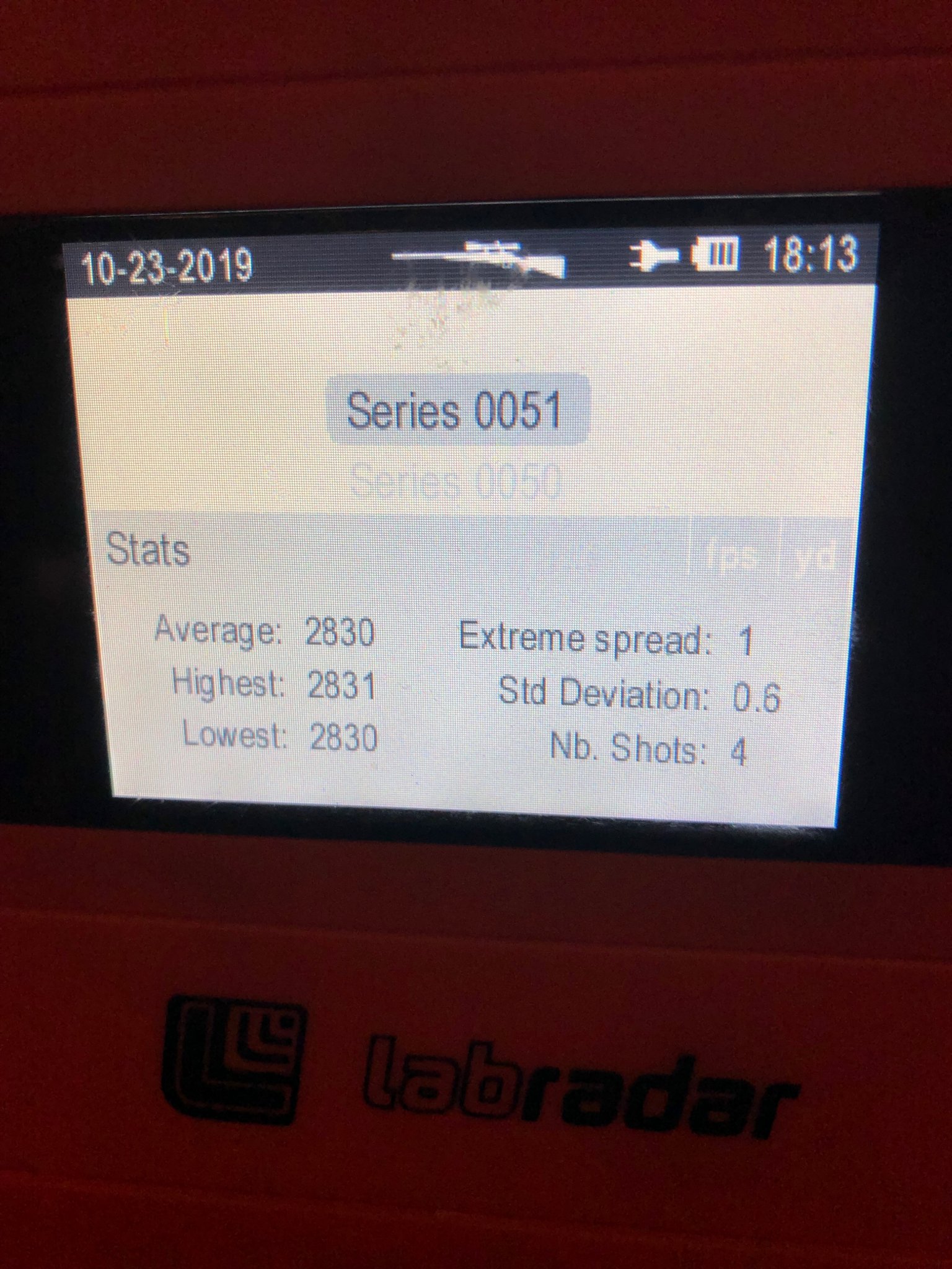

Labrador, compared it before with a MagnetoSpeed and they were close.
Hornady 140 match ammo shot around 2730 fps, Berger 140 was much faster around 2820. Only tested them at 100 and they shot well, with SD between 8-12 fps. ES around 35 fps.
My hand loads have SD of 6-9 fps, but ES is similar to factory ammo... around 32-36 fps. If i delete the 2-3 bad apples, i get SD of 4-5 and ES of 20-25. Trying to find the reason for the bad apples!

N: I don’t think it is the MPA rifle. It shoots rediculously small groups at 100. All four of my barrels have given the same high ES. Must be the ammo, or my lack of periodic cleaning.... or a ghost in the machine!
Nah man you’re doing way more that I am and my old 2400rd creed has had two kids it’s entire life. Not sub 10es. If your seating depth is consistent I might have a Smith look at the rifle. Now this is second hand knowledge and I’m not going to stand by it but I e heard that some mpa factory cut chambers have sucked. Not sucked to the point of new barrel so to speak but definitely needed attention. I’d hate to tell you to drop that thing off at a smith but dude your handloads should do better than 30es with everything your doing.
N: Thanks for the reply. I had a good bore scope in the chamber, and all looks well to my untrained eye.... MPA rifle shoots 0.2 to 0.3” three shot groups at 100, and 0.35-0.45” five shot groups. Second most accurate rifle i have ever owned. [Aside: Best three shot group measured 0.08” but that was likely just luck. One single good three shot group does not count. Five shot aggregate is 0.41” so far, which is ‘good’ given my current skill level and total lack of wind reading skills....]
Even 300 yard groups are often 0.3-0.4 MOA, but at 300 (Edit: My apologies, 600 was a typo) there is a lot of vertical stringing, around 6-8”. Either ES is too high (likely the primary cause), or my amateur attempt at positive compensations needs to be redone....
Edit: First two pics are three shot groups at 100 in a 6-8 mph wind if i recall correctly, last one is a three shot group at 300 (NOT 600!) yards. Same wind. Yes these are amongst my best results so far. [I did not bother to take a photo of the 0.08” group, it was slightly oval, looked like a 2 shot group, and everybody will call me a damn liar... ?]
BTW: I find that i aim more accurately if i shoot at diamond shaped targets or very small circles, rather than large circles. Helped my groups to improve about 0.15 MOA.... Try it!
If you are shooting quarter inch groups at 300, not sure how a seat depth change can benefit too much. If your spread is vertical, adj your charge. If it is horizontal, shoot farther and group the rifle. If it is still grouping great, find a different chrono to measure your speeds, and rule that out.
If your load shoots great to 800-1k, numbers no longer matter
No, i probably explained badly, i get 1/4-1/3” groups at 100, 1-1.5” groups at 300 yards (0.3 to 0.5 MOA). Sorry for the confusion.

Sorry, I misspoke (mistyped) - my SD (not ES) is usually around 4, with ESs in the 8-10 range. With that said, with a couple loads that didn't group as well, I would routinely get ES in the 5-6 range and SDs in the 2-3 range. This was with a 29.2 gr (H4895 - 105 Hybrid) load. I took a pic of the Labradar on one particularly good group during testing - also, I usually shoot 5-shot groups during validation, one shot in this string didn't register.
Based on just SD/ES, this should be a winner, right? This load grouped just "okay" though, so this is when I went back to the drawing board and played with seating depth. Landed on .025" then went back to the beginning of load development. Finally landed on 30.7 gr - I like the velocity a lot more with this load at ~2950 fps than the 2830 I got with the lower load. This new load gives me those SDs in the 4 range. Not nearly as consistent as the 29.2 load, but then I'm getting groups like this at 300 yards.

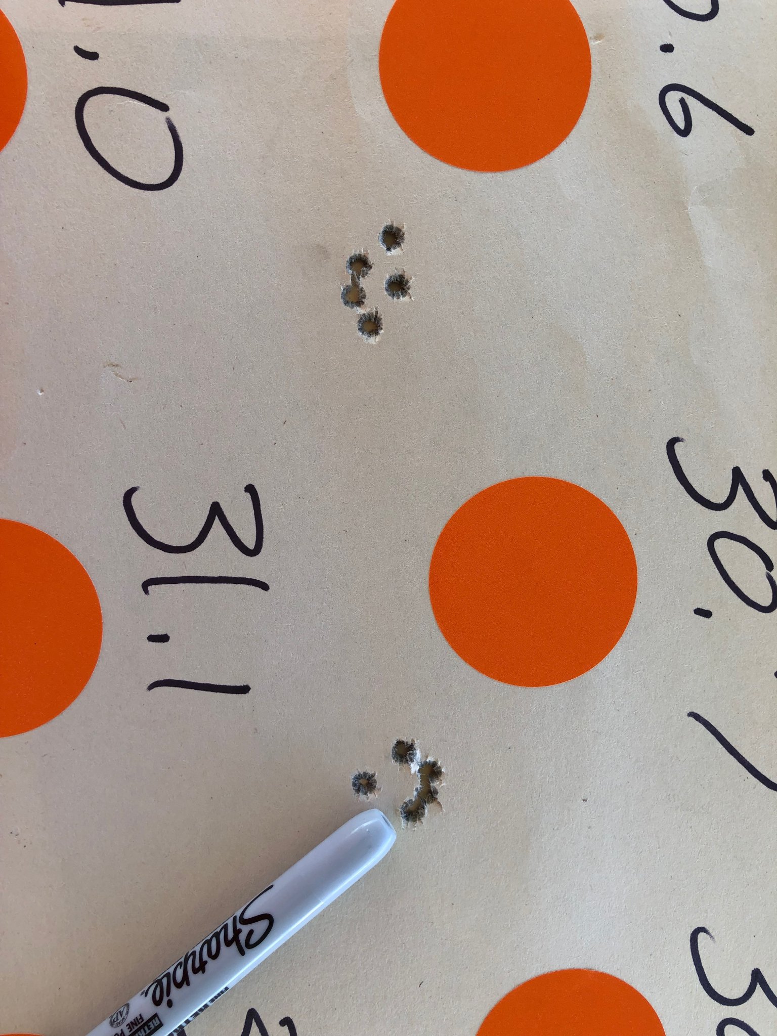

More food for thought:
A friend of mine was having some fits with ES on his new 338. He did the same thing that I did with finding a decent load then shoot groups for seating depth. His numbers went from truly abysmal to somewhat egregious to the numbers you're shooting for in fifteen thousandths (.005 increments).
