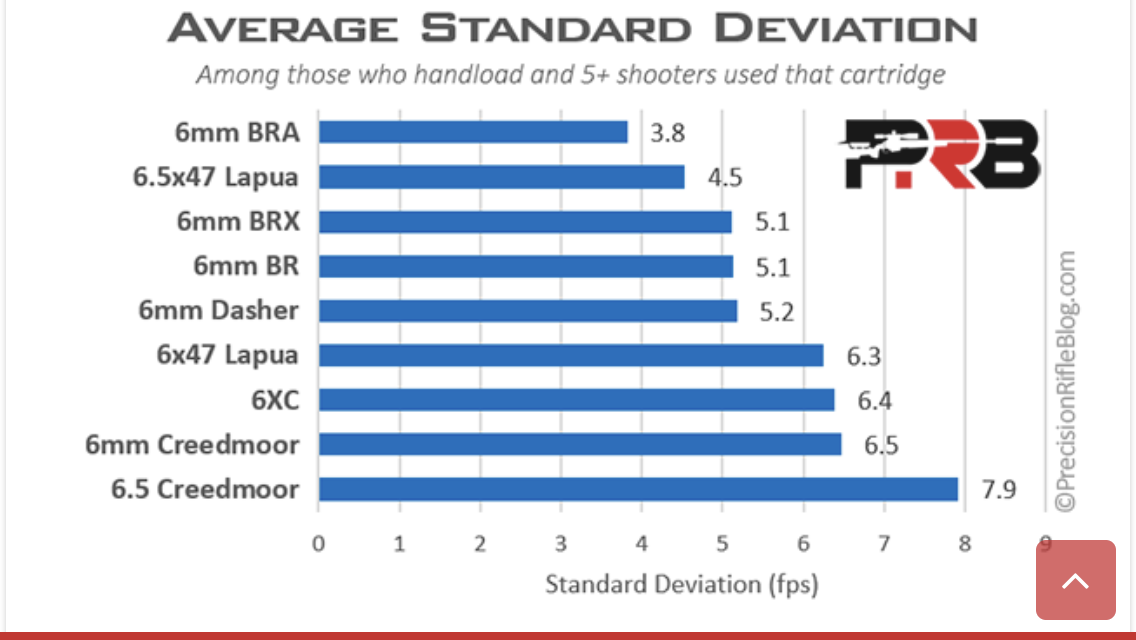

I sometimes hear that the good / “best” 6 mm cartridges like 6BRA tends to get better ES than 6.5 CM. Am i chasing an unrealistic ES goal with the 6.5 caliber? Should i switch caliber... pretty major investment though....
A key factor in my choosing the 6 BRA was that it had the lowest reported SD by top PRS shooters - good article comparing cartridges in the Precision Rifle Blog.
Now, with that said, is it worth switching? I don't think so, especially if you have a lot of barrel life left. There is another article on the same site that talks about the practical difference between different SDs - the difference between a 5 SD and 3 SD is minimal. Being an ex-NASA engineer, I geek out on optimizing things, so I like the challenge of lowering it, but I don't harbor any illusions that I'm getting dramatically meaningful benefits.

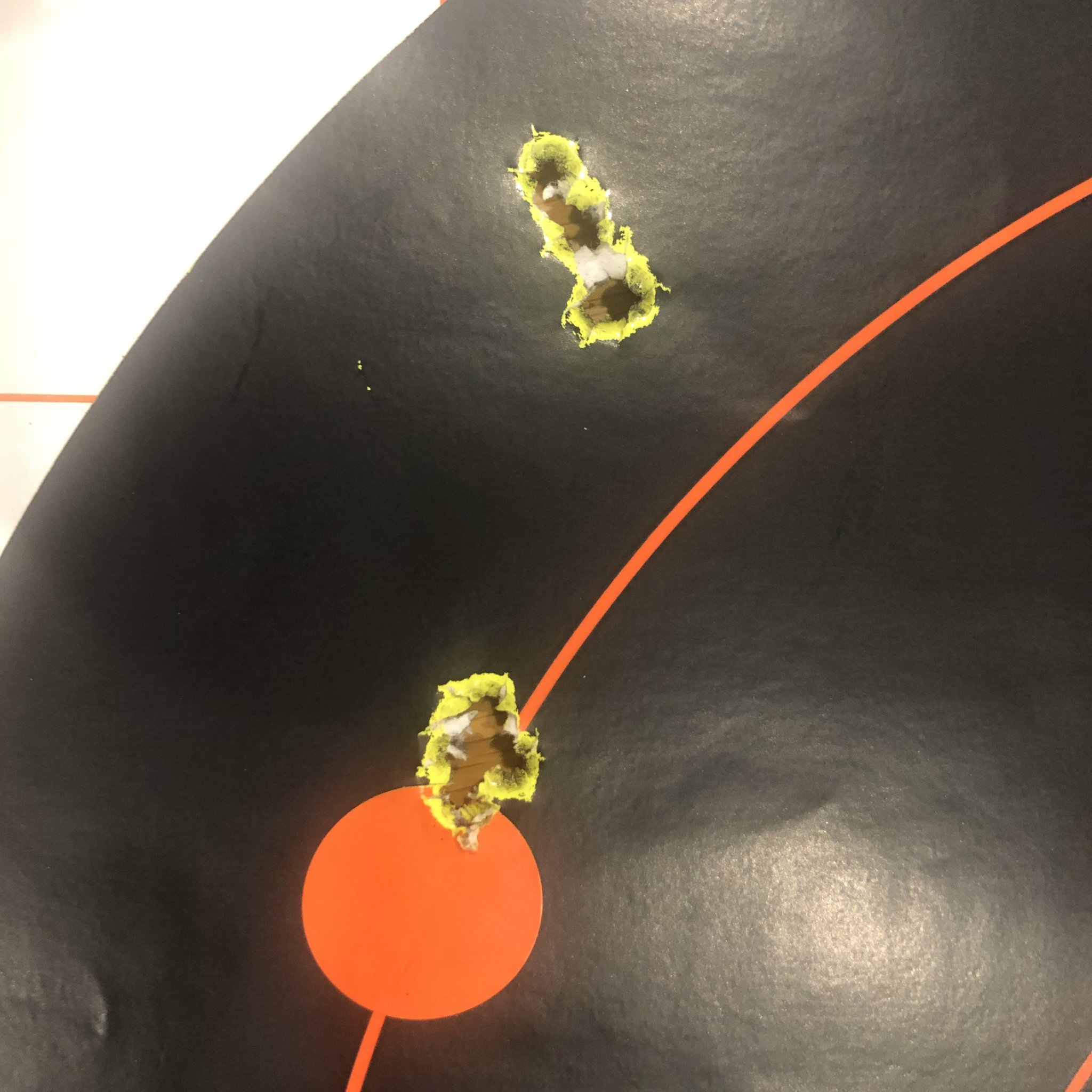

BTW: Reseated a batch of ammo i built a month ago (140 ELD in Lapua brass with H4350), using the arbor press and inline Wilson seater die. About 90% of them reseated smoothly, and felt totally normal. The other 10% seated with a noticeable thunk. Very high resistance (2x higher than original seating force), and then it suddenly came loose, and left an indentation on the nose of the bullet.
Soooo..... I think i might not have fully cured the bullet weld problem i had before! Clearly better, but not gone. I wonder if the humid Gulf Coast climate has anything to do with it... Might have to reseat at the range from now on.
HOW do you folks cure bullet weld, i want it 100% gone!

BTW: Reseated a batch of ammo i built a month ago (140 ELD in Lapua brass with H4350), using the arbor press and inline seater die. About 90% of them reseated smoothly, and felt totally normal. The other 10% seated with a noticeable thunk. Very high resistance (2x higher than original seating force), and then it suddenly comes loose, and left an indentation on the nose of the bullet.
Soooo..... I think i might not have fully cured the bullet weld problem i had before! Clearly better, but not gone. I wonder if the humid climate has anything to do with it... Might have to reseat at the range from now on. And HOW do you folks cure bullet weld, i want it 100% gone!

Found the post and it is very interesting:
So my SD of 6-8 fps is slightly better than what these PRS shooters provided (it is an average of several shooters). Makes me think i will not get much more of an improvement....

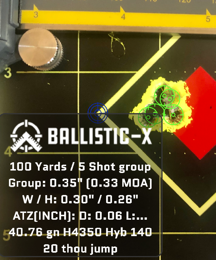

Got this load optimized for powder charge and seating depth today:
Speed values for the winning 0.35” five shot group were: 2723, 2724, 2722, 2716, 2719.

PS: Today’s best Berger Hybrid groups with 15 thou and 20 thou jump: 0.35” and 0.58” all five shot groups at 100. SDs of 7 and 9 fps.
This load is done. So 0.015” jump it is then.
