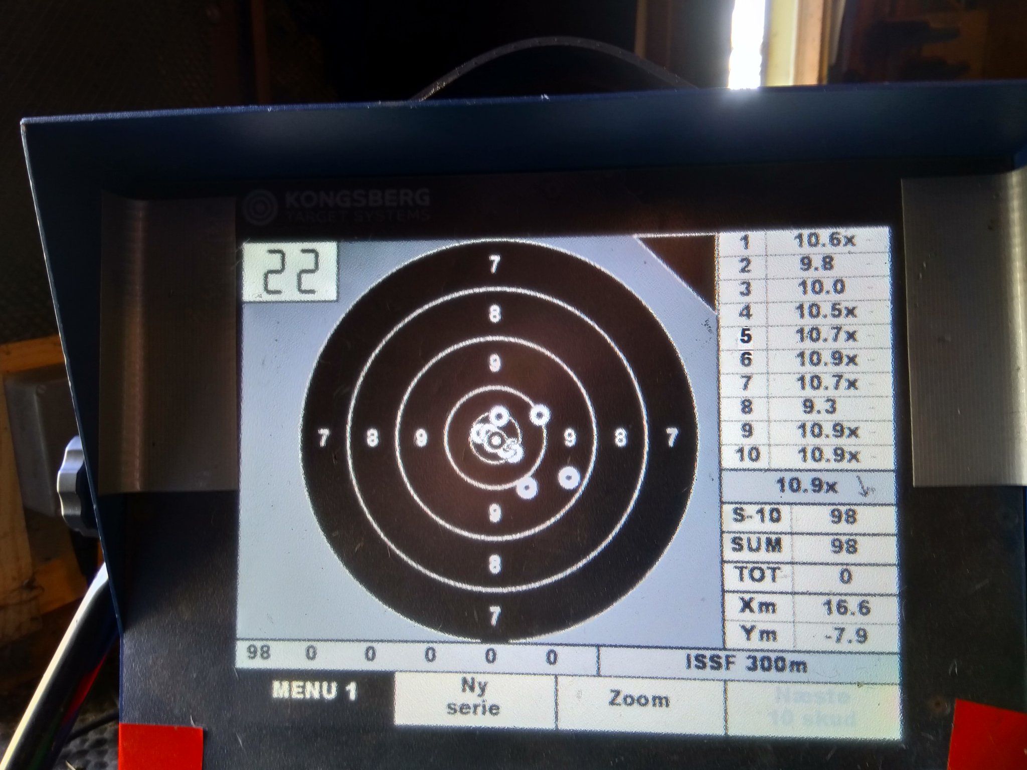

I have a relatively new CTR in .260 and i had some trouble, working up a load for it, due to the short barrel, but at last, it worked out just fine.
Apart from the trigger flinching, this 300 meter training went well.
SD are in the tens and ES in the thirties
Reactions: Near miss
