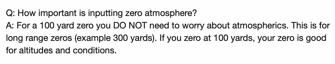

For reference, here is the response to a Q&A with Applied Ballistics:

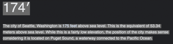

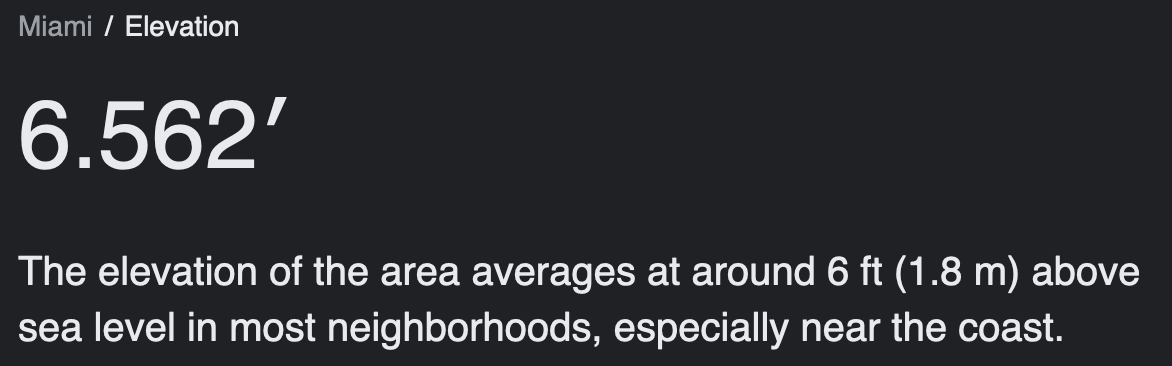

Miami (2m) and seattle (53m) are both at the functional equivalent of "at sea level ..."
