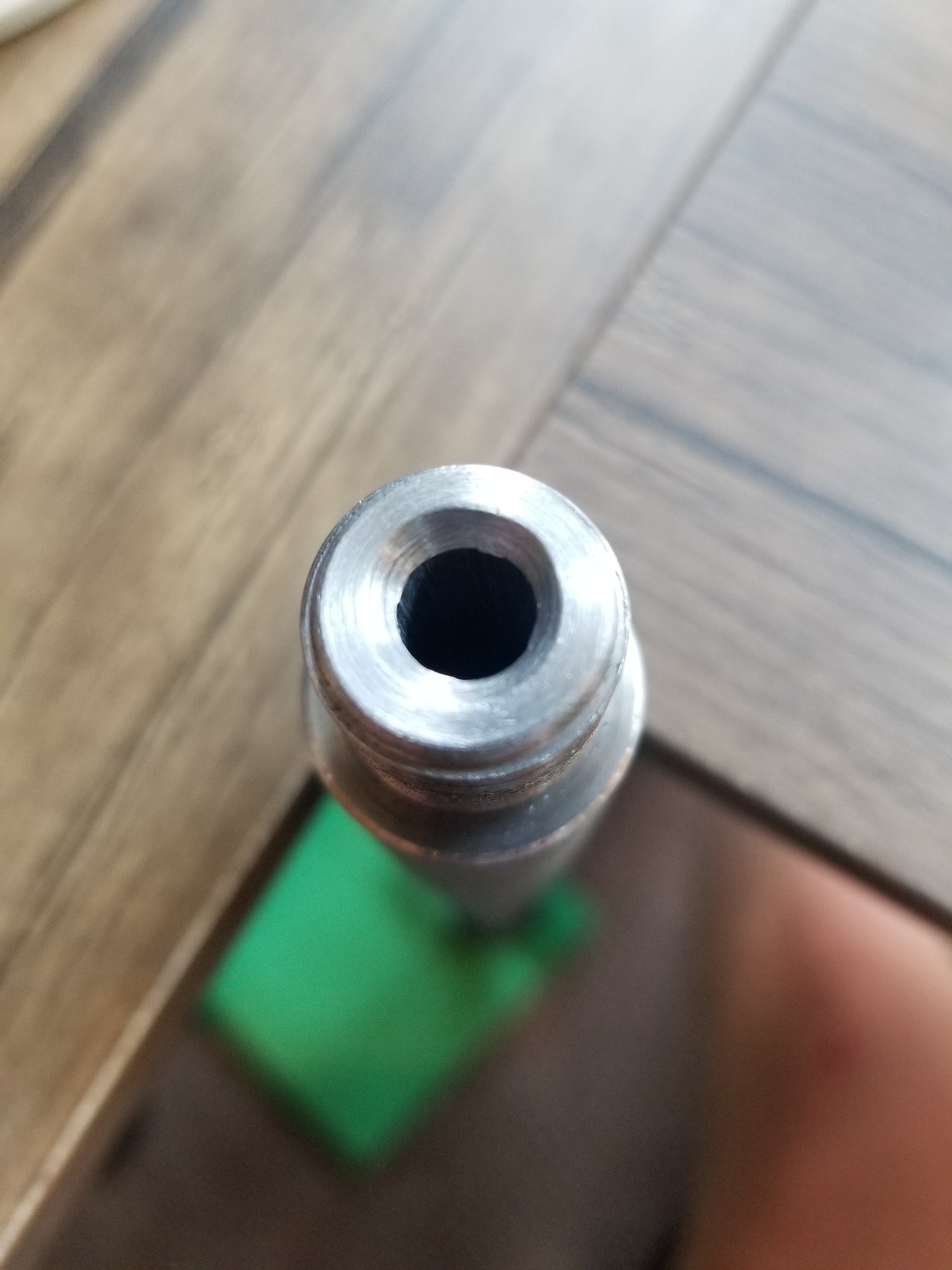

Hello! I recently had a local gunsmith spin me up a barrel for my first full custom build. It appears that the muzzle crown was poorly done with the initial taper not being concentric. Before i spend all the money on components breaking it in and developing a load, i want to know if this will affect to accuracy. I want this to be a half minute or better gun. Hoping to use your guys experience on whether this is a no go and needs redone or if she's good to shoot. Appreciate the help

You always have to wonder about the concentricity of the work when the guy can’t even manage the basic details. That’s IDGAF level of work there.
Exactly!!! Cutting a decent looking crown is one of the easiest parts of the process. The threads also look pretty crappy. Makes you wonder how much care was put into some of the more detailed parts of the machine work.
After zooming in on the phone the crown does look oblong. Kinda weird.
Thread the muzzle break on and see if it threads smooth and if shooting suppressed if definitely check with a rod.
Or you can take it back to him and see what he says.
Reactions: nikonNUT
Was a dremel involved?
More than likely a DeWalt cordless. I'm speculating but that crown looks like it was gone after with a brass crown lapping tool by someone that didn't know what they were doing.
All of that can probably be cleaned up on a lathe without having to chop the barrel back and start over.
@Ohioguy47 Is that a Hawk Hill barrel?
Reactions: DJL2

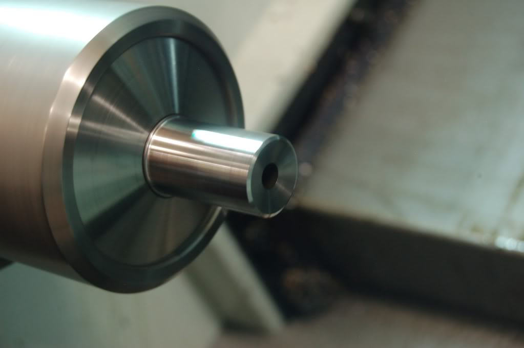

Look up either an 82 or 90 degree multi flute countersink. Machine tool vendors sell them. My guess is that work was done either with a cordless drill or a tail stock that has a bunch of backlash on the feed screw.
-Your muzzle got to star in its own snuff film because of it.
Notice how the outer circumference isn't really round? This is because with a multi flute tool on a garbage setup it is virtually impossible to deliver a consistent feed pressure so that all the flutes engage the material equally. The tool starts to hop on top of the material. When it does engage, it gouges the snot out of it and the circumference goes to hell.
Will it shoot worth a darn? Bullets always tell the truth. Is it up to par? Ask your wallet...
If you'd like it fixed, I'd be happy to help.

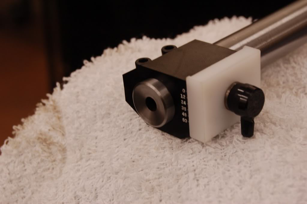

Some examples of a single point machined barrel crown.

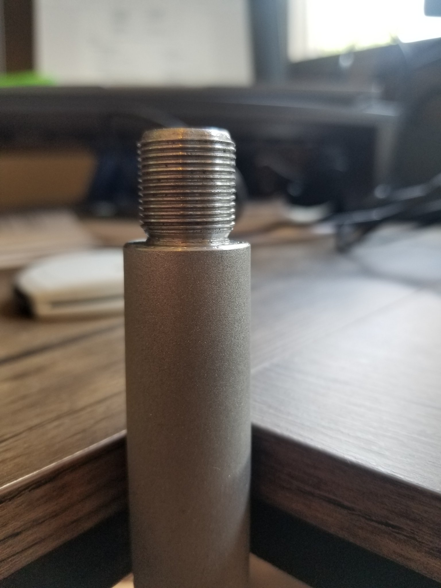

As a rifle builder of both LE and personal hunting firearms, that's poor workmanship and I certainly wouldn't happy with that as a builder.
It does beg for an "explanation" from the builder for sure. & a "redo" IMO.
100% you got a gomer to thread that. I’d stick an alignment rod in there with the can on and check it before ever pulling the trigger on a live round.
Then I’d find a new smitty…
Reactions: MarshallDodge
1) a crown has almost 0 impact on accuracy.
2) how much did you pay this guy?.....$100-$150 ide say you got what you paid for.
It doesn't look great, but ide at least shoot it before I got upset about it.
No impact? Really. So that’s why it’s just as good to cut the muzzle with a hack saw?
Never heard any gunsmith say that.
OP - take it to a different…real… gunsmith and it can be easily cleaned up. Checking the chamber job this jamoke did would prob be well advised

1000% a Dremel was involved somewhere.

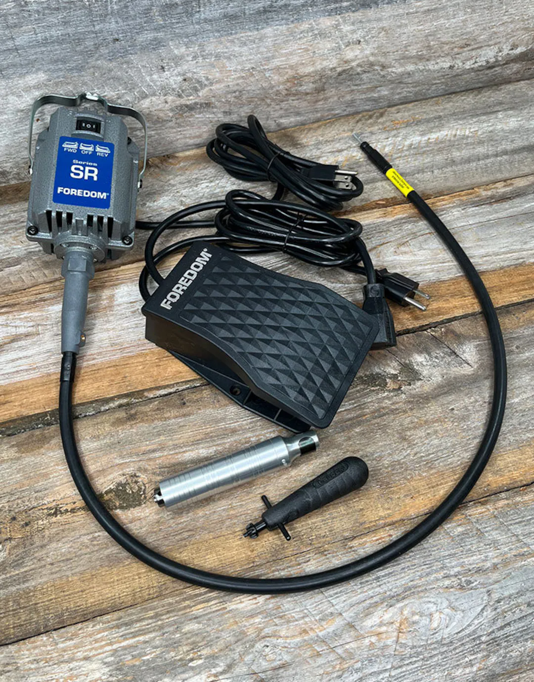

No self respecting gunsmith uses a Dremel. The really good ones use a Foredom because Dremels are too slow. If it doesn't have a foot control for speed it isn't a real flexible shaft grinder. I use mine for everything from gunsmithing, to dental work, to tune ups, and in the kitchen.

All that being said, the crown in the OP photos sucks.

If it hasn't already been brought up, you should check if the muzzle threads were indexed off the bore or the OD of the barrel. The bevel of the crown is good indicator of what was done, but not absolute. This will also become apparent if you use a suppressor or certain brakes without checking bore alignment.
Genuinely curious,
Is that bevel or whatever you’d call it between the shoulder and threads normal? Most I’ve seen come straight down at base of threads or even have a slight shoulder there. Seems it would create a weak spot thinning the barrel like that if not needed
